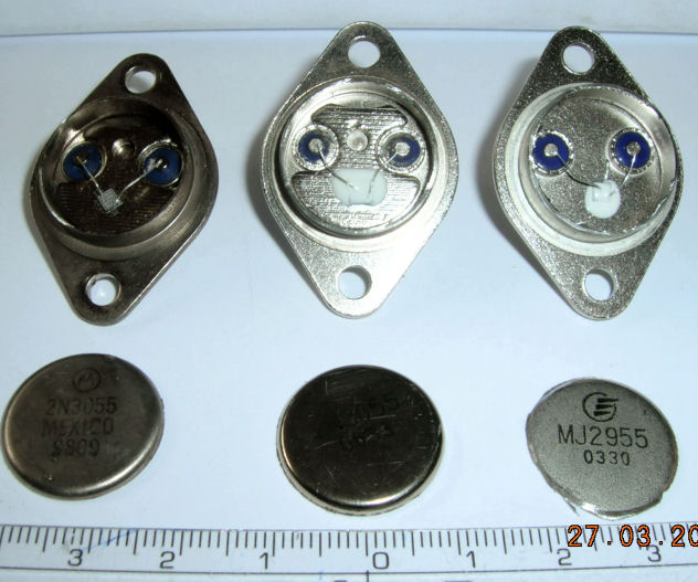

IsakAlexander said:They are fakes... cracked one open, white gue inside.
You can't tell without having a reference. Maybe Matsushita build them with glue/white plastic. But the die size is suspect. It is quite small for a 150w device.

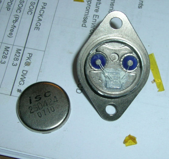

this makes me believe that it is a fake:
- absence of copper pad
- chip of the same sketch of the "red label" Toshiba
Also for remove the withe silicon :
- 24 hours of soak in (premium) gasoline to soften the glue
- steel brush to remove residues
- washing and cleaning with toothpaste
(the only disadvantage is that they detach him the threads)
Fake or True ?
every suggestion is very appreciated...
bye
Fake or True ?
bye
Gold_xyz said:Fake or True ?
Neither!
As it does not claim to be an original OnSemi/Motorola it can't be fake. But it is also not an original, just manufactured by someone else.
It is obviously not the quality of an original, but not necessarily useless.
I don't remember the logo, but being a real manufacturer, he will not produce useless parts.
I believe you can use these parts.

I imagine that the logo corresponds to a firm
and that this firm publishes the datasheets...
That interests me is the correspondence to electric parameters
I am sure that the silicon works but I have buy this as MJ15015.
to soon
Gold_xyz said:but i have buy this as MJ15015
Which it likely is, just not an original.
That yours is Chinese manufacture does not necessarily make it inferior, the slow mode 2n3055 and it's sturdier versions are produced by a whole bunch of semi companies.
Toshiba China likely manufactures semis like these, stuff that Toshiba Japan has no appetite for producing anymore.
The same applies to several higher grade semi numbers which Toshiba licensed to Korean facilities, manufactured there nowadays but not anymore in Japan.
Securing the die and connections with a dab of silicon does not immediately label it a fake, merely a different manufacturing approach.
Had it been labelled a 15003 or a 15024, then it would have been a counterfeit device.

not a transistor but also a semiconductor.....
I have already installed it on the PCB and then I noticed it looked funny so I took it out to take pictures so it hasn't seen power.
if you ask me, the one on the right screams "FAKE!!!". the tab is only 0.5mm thick!!!
what do you guys think?
