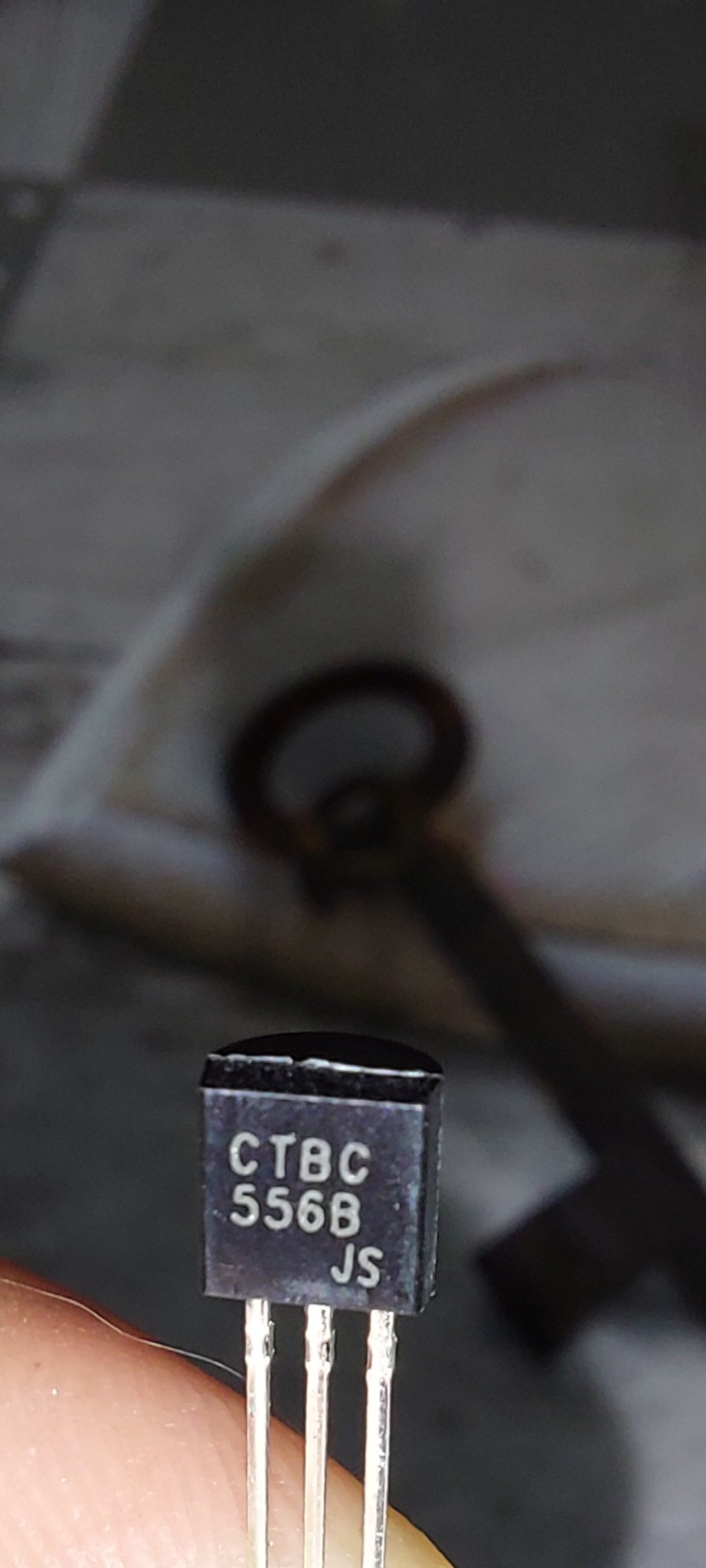

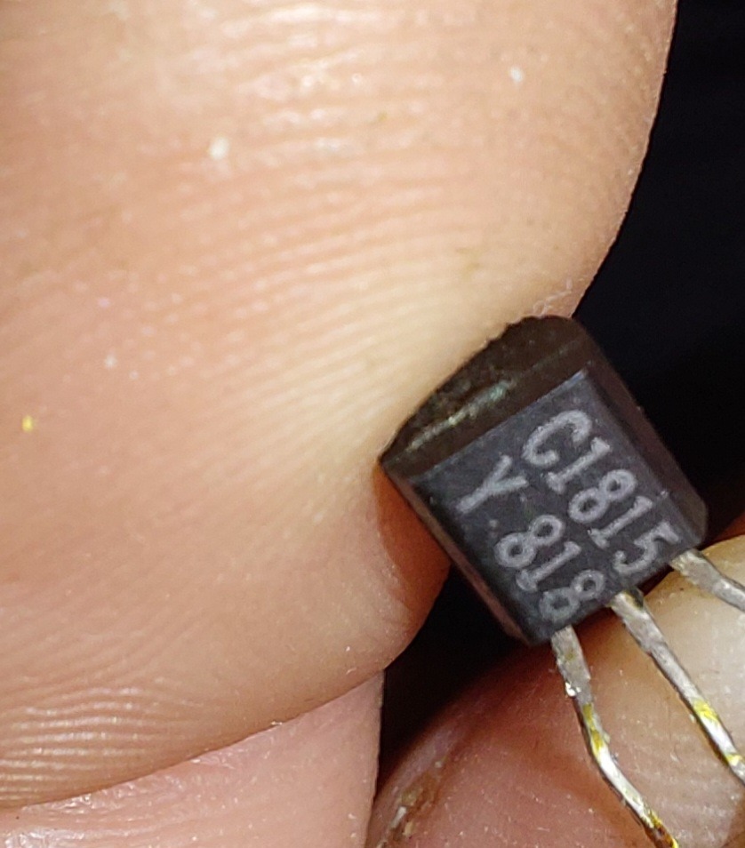

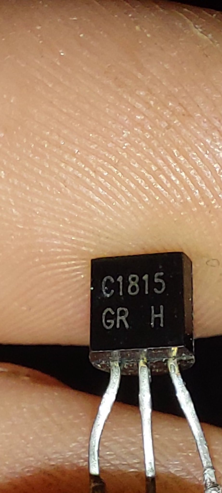

Found these in some old stuff, are they genuine to you? Hfe looks right.

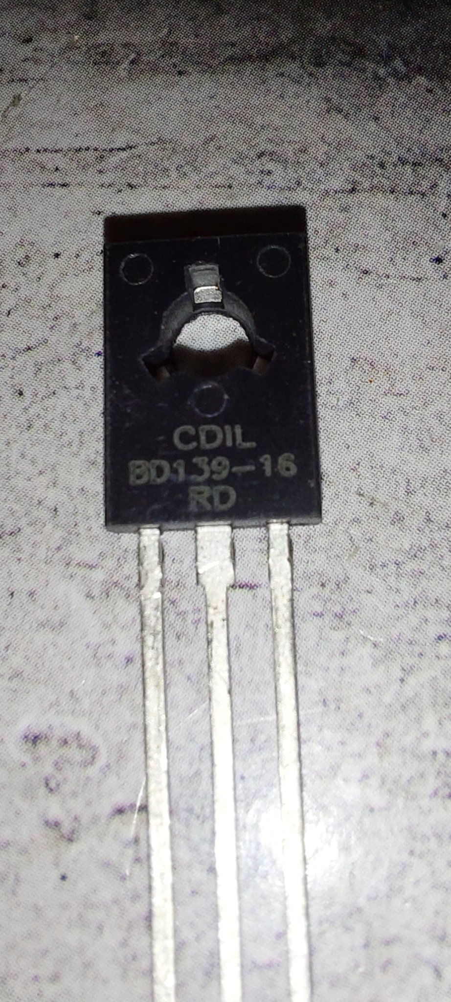

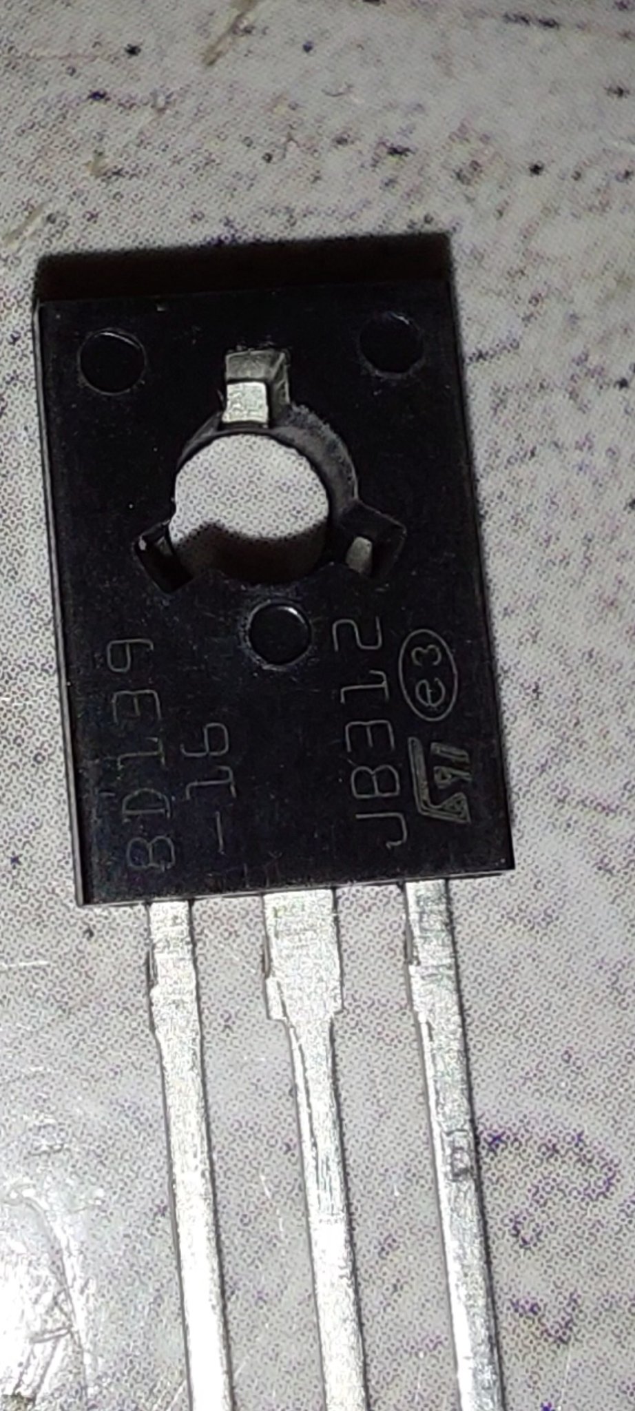

Got some new parts from TME.
These are from ST and CDIL .
Genuine or not ? .
Thank you.
- Bruno.

While they may be genuine from CDIL, I wouldn't trust them to be in compliance with the original types. This isn't a knock on CDIL, but it is a knock on all new manufactures of old part numbers discontinued by the original manufacturers. What are they really? I mean electrically exact, or similar? If similar, they really are a different part and should be labelled as such. You should also be looking at consistency from any manufacturer as that is a direct indicator of quality.
Honestly, the only parts you should ever use are old part numbers made by the original licensed manufacturers, or current parts made by licensed manufacturers. If I see any part that isn't from the original manufacturers in equipment - out they go! I just pulled one from a Hafler DH-200 last night. Did it work? Yes, but it may have impacted reliability or performance. It got an original part, the previous "tech" also used off-brand capacitors (out they went). Now this equipment will perform as it was intended to, along with having the same long service life expected of it.
It simply is not worth using parts not first quality. Use junk, and you will get substandard performance or reliability - or both. The equipment it therefore no longer what the name plate says it is. A total waste.
So use either guaranteed genuine original parts, or something current from proper distribution sources. Do it right, there is zero excuse to use anything but correct parts. Sometimes if people can't afford a proper repair, it is better the equipment remains not working. A poor repair can damage other equipment (speakers) and at best represent wasted money - which by definition they cannot afford. Then the equipment is again not working, plus possible more serious damage or damage caused by a person through poor workmanship. IN the best scenario, the equipment never performs to spec, and the customer may as well have traded that equipment for stuff that is less than they bought. That is almost theft (well, it is theft in my book).

Are the ST " in compliance with the originals ? " . Do mine look genuine ST ?.
I don't know reliable sources to buy parts,
TME and Adelaida ( Romanian shop for parts, ) seem to be " legit" . you guys buy from Mouser?. I'll have to try them, when I buy more things because of the delivery price to be worth.
Administrator
Joined 2004
ST are fine and made to high standards.
