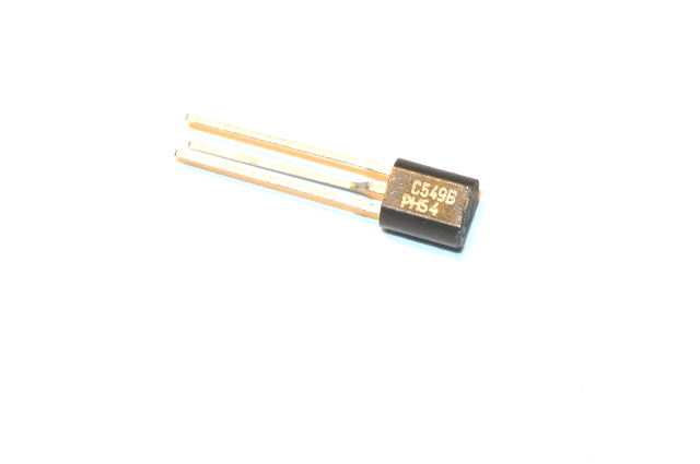

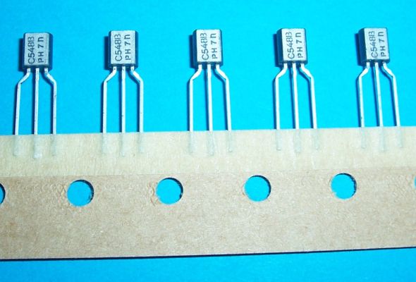

question about BC54... and BC55.... series made by Philips
I was sure , all BC series small transistors made by Philips got silver face plate with black letter marking , but lately faced with
BC549B transistors ( supplier claim it genuine Philips ) which are completely different means:
- no silver front paint
- smaller plastic package ( pictures attached)
Any experience how should original Philips small transistors BC54.. and BC55... series look like??

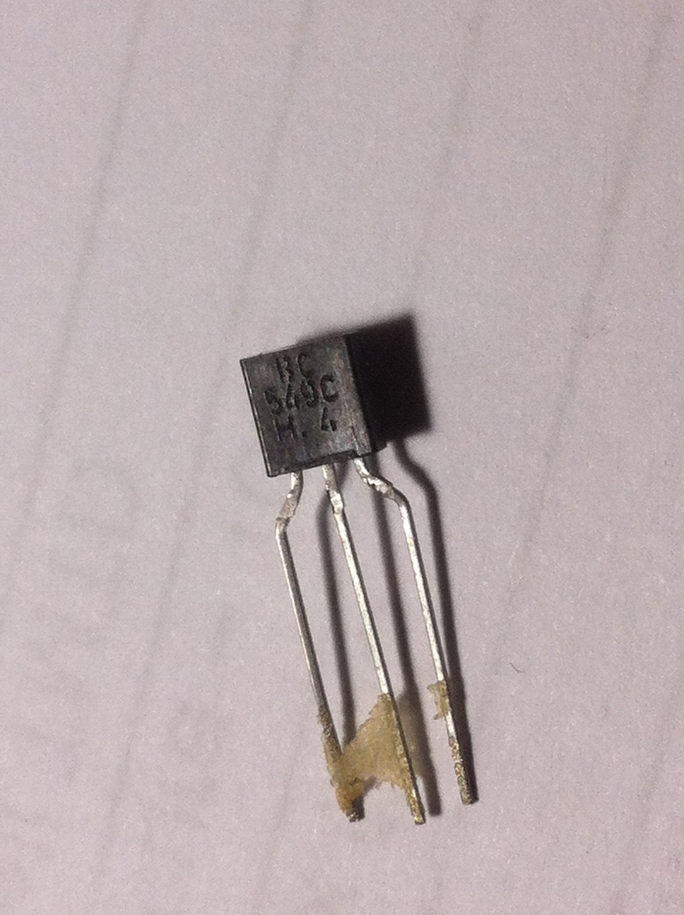

I do have a problem to recognize manufacturer of the BC549C transistor
"H." would suggest HARRIS , but did they ever manufactured BC5... small signal transistors ??
On the other hand, marking text is laser trimmed , so I doubt someone would use such way of labeling for fake transistors.
The seller claims those are very old genuine Philips BC549 series
Does someone know , which producer trimmed with laser marking of the BC5.... small signal transistors ??
Absolutely not Philips or TI ... their transistors put a moulding depressed dot on the printed surface. The face would be absolutely smooth and the identification would be printed. On the back is commonly a 2 or 3 stripe coloured paint code indicating the gain group and type (used by TI and Philips (Mullard). I have very old Philips transistors and they ain't nuthin' like that!
That transistor looks like it has a ground face prior to laser etching. The BCxx9 series transistors are not cheap compared with some of junk GP transistors.
Test its characteristics ... Gain will probably be the major giveaway that all is not normal.

The letter 'H' stands for "Hi-Sincerity Microelectronics Corp". Hope this helps.

hi,
they both are genuine philips
the later one without silver facing is from 90's
regards
ravs
