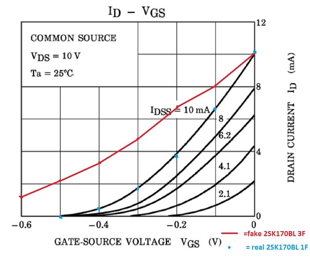

Oh, no bought fakes again.... 2SK170BL
First I ordered 10 pieces, they were the real stuff, so I bought another 100.....fakes.
Good fakes though, laserprinted, Yfs = 18 -19 mS, V ( pinch off) = -0.85V instead of max. -0.5V.
See picture... good one, fake one...
I'm not very familiar with JFETs and their parameter spreads. However I bought several '170s some time ago, so please excuse my curiosity. The Toshiba datasheet states a max. VGS(off) of -1.5V. So your transistors are still inside specifications?

Ah, here is the graph....

Don't buy them, most probably fake, 2sj74 is even harder to get than 2sk170....

All 50 fakes! The picture on Ebay is of a real Toshiba part, for sure.
But what they sent me looks different, and they measure bad.
They look a lot like what I bought in the German shop, think he is getting them from Ebay too.
