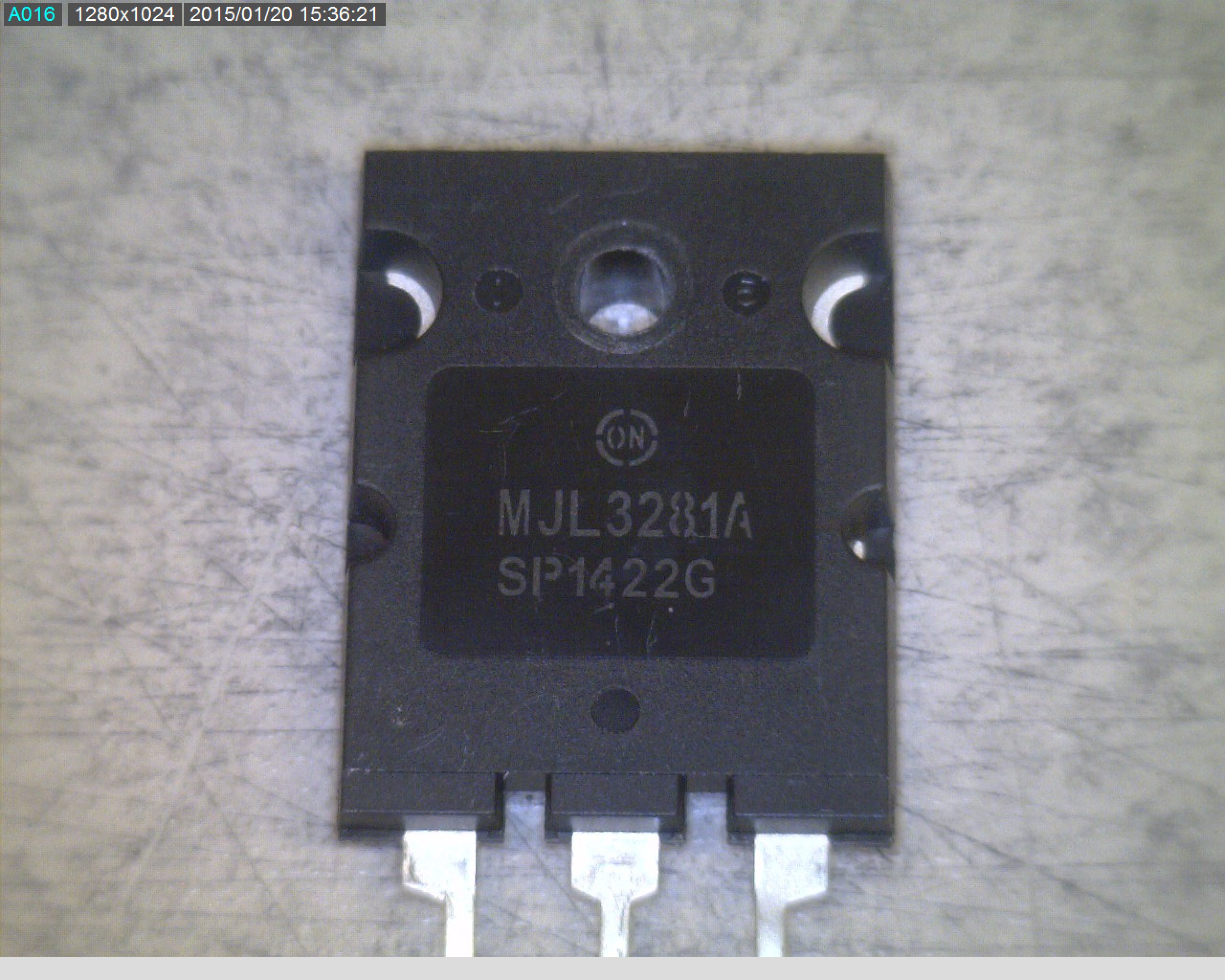

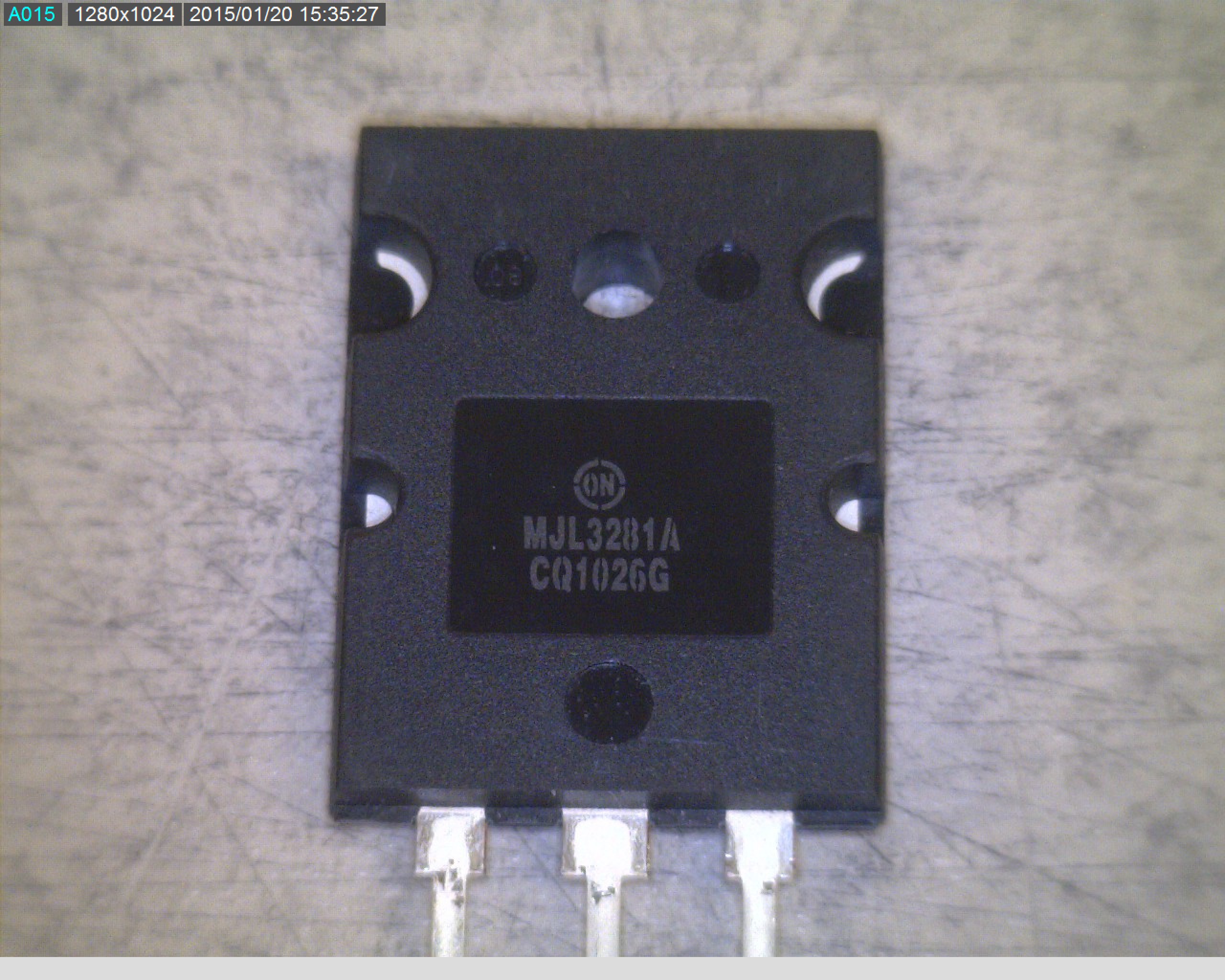

In addition to my previous post, I took some photographs of a MJL3281A "old style" and "new style". I just noticed that the new version is type A again, rather than AG. Last year I thought I found that the A was going obsolete.
The change happened at the end of 2012. From then on we've used hundreds of these and never saw the old style again.

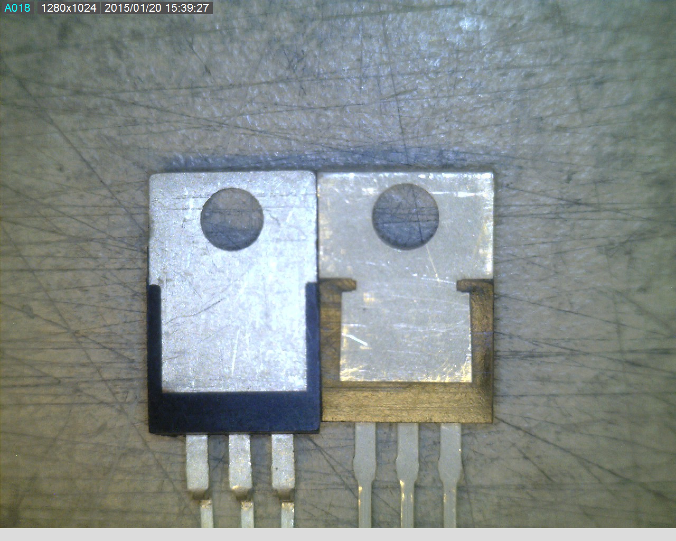

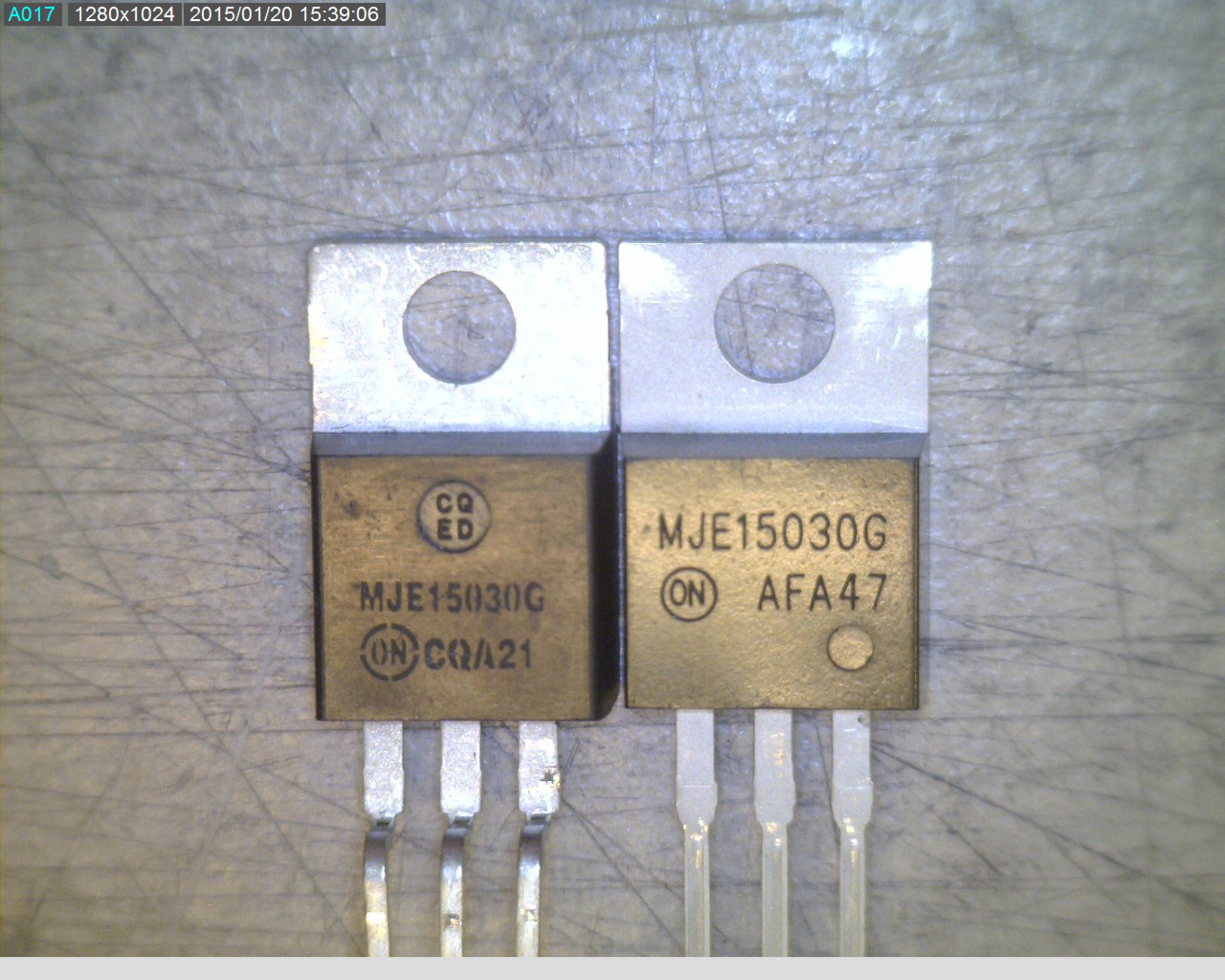

Also some pics of an MJE15030 old style and new style. The datecode seems to indicate a change in 2010 as the most recent batch carries E47, presumably meaning week 47 of 2014. If so, counting backwards must mean that A = 2010.
Again, after the change the old style was never seen again, so if you're dealing with these that have a datcode of > 2010, but look like the one on the left, I'd say it's a fake.
The change in how they look must be the result of moving the production location. In both cases the first two letters were changed. From some research on OnSemi's LM337 (because of a problematic batch), the first letter indicates the plant at which they were assembled. E.g. on the LM337, lot trace codes starting with "R" mean they were assembled at a plant in Roznov, Czech Republic.

Datecodes starting with A = 2011, not 2010. The change from old to new style with the TO-220 was somewhere during 2011. For the TO-264 it was during 2012.
Newest datecodes on the current work in progress could therefore never have been starting with E (they're actually C, i.e. 2013).

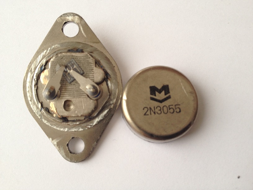

Anyone recognise the maker ?
Probably Magnatec, which now makes some of the highest SOAR-rated BJTs in production by any company anywhere.

The die size looks OK as does the heat spreader.

Do people also be carefull when open these transtistors? it can contain Beryllium oxide, and is is very dangerous.
Most is afcourse found in HF transistors but a warning is on his place here, special when fakes.
I doubt it as Magnatec's logo seems to be:
I agree with Anatech, no datecode doesn't instill any confidence, however good this one may appear visually.
