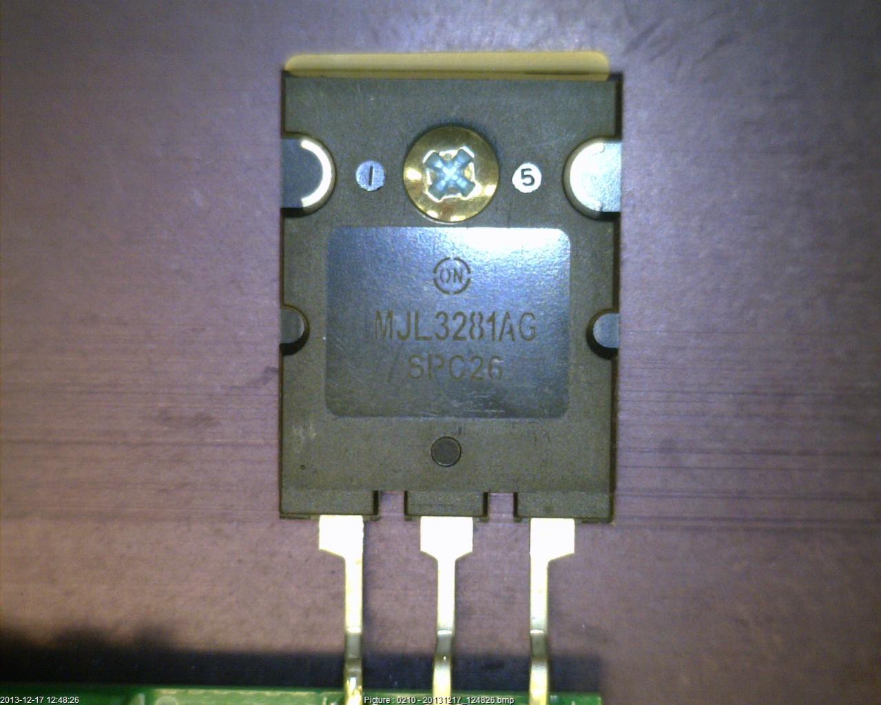

It is time for an update of my answer in post #382 of this thread in which I wrote:
Some of the transistors manufactured by OnSemi have a different appearance with datecodes of 2012 and on. Genuine MJL1302/3281 (and possibly many other OnSemi transistors of the same shape) should now look like the MJL3281 in the attachment.
Compared to the "old" version, almost everything looks subtly different. They also seem to weigh a little less.
At work I have seen thousands of the ON MJL1302/MJL3281 over the years. Without fail they have always looked like the top and bottom left transistors in your photograph right down to the font, size and position of the printing.
Normally I am careful not to judge by looks alone, but in this case I'd be fairly certain that the bottom right one is indeed a fake.
Mechanically it conforms to the Mechanical Case Outline document. That document hasn't changed, though, it's from December 2004.
The datecoding system has changed from YYWW to YWW, where in the latter case the year is now indicated by a letter. C26 presumably means week 26 of 2013. This does not conform to the document.
The most striking differences are narrower leads (but spec allows for quite some variation: 0.93-1.48 mm) and the plastic body is no longer continuous near the leads but has "air gaps". The latter feature is not specified in the drawing.
A little correction to my previous post: 2012 can still be found "old style", the "new style" were on the market around the end of 2012. The very first I've come across had datecode B50 (week 50, 2012).
According to OnSemi, the MJL3281A is becoming obsolete (status: "last shipments", it's replaced by this MJL3281AG (status: "active").

i would be suspicious of any devices not conforming to the official marking specs. counterfeiters take advantage of the ambiguities...... that's why so many counterfeits are labeled with the last valid date code of a particular part number..... find out directly from ON if you can what date code transitioned from the "A" series, and the "AG" series so others won't get burned.
I have no doubt that the new style MJL1302AG/MJL3281AG we've used over the past year (several hundreds) are genuine as they were acquired from an authorized dealer.
The last datecodes of the A-version we received were 1225. The first of the AG-version were B50.
The "new" datecoding system is now the same as seen on the smaller transistors (e.g. BD140, MJE15030 etc.), where there was already a single letter indicating the year.
