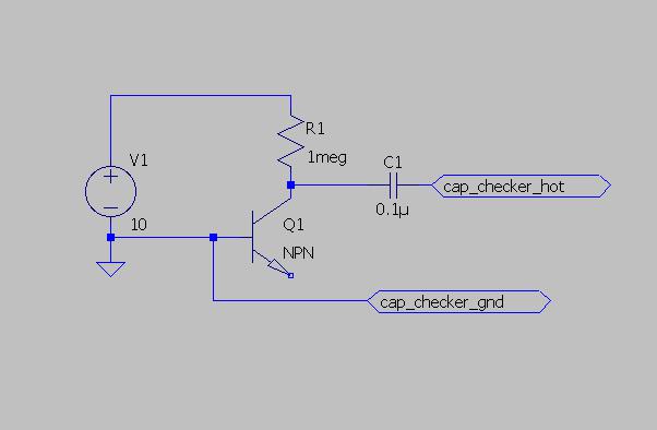

see my previous post. a curve tracer with the ability to detect the second breakdown region (nondestructively) is the best bet. i'll post a B-C capacitance test circuit if you like, it's rather simple.
the circuit shown is for npn transistors. reverse the supply for pnp. the 0.1uf cap is a mylar or other non-electrolytic type.

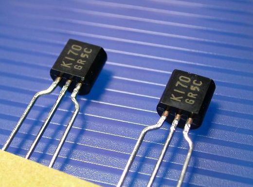

those look like genuine current production...
it must be 10V because that's the condition in the data sheet. if it's 9V the reading will be about 10% higher., since the voltage affects the depletion layer thickness. the B-C junction is acting like a varactor. the bias voltage is to a) establish a repeatable reference point for the test, and b) to move the test voltage far enough away from 0V to keep the capacitance tester from forward biasing the junction, causing faulty readings (because the capacitance gets very nonlinear as you approach conduction)

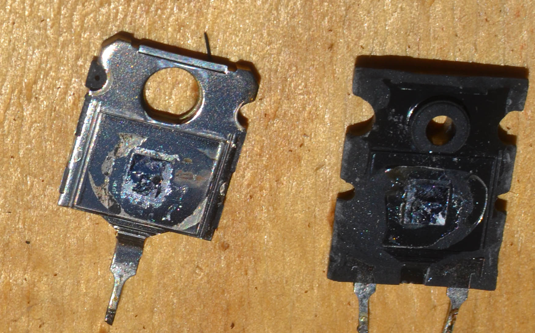

Some time ago I (see post 405) I asked for opinions about whether my Toshiba sc5200s were genuine. The answer seemed to be that they were. More recently I had a bad amplifier driver transistor failure which I am trying to troubleshoot. One possible cause was bad power transistors )the sc5200's I had asked about.
I have split open 2 of them after the failure and to me the internals do look genuine. But I'm hoping someone with more expertise can give me their opinion.
big die, looks about right. what is that about 5 or 6mm? that's what it should be, and as your picture shows, no goo on top of the die.
Thank you for the reassurance unclejed613. I also came to the conclusion that they were ok. I had split open some other similar power transistors which I knew to be genuine and when I compared them to the sc5200s they all looked much the same.
In the future, if I am in any doubt at all about the pedigree of power transistors, then I will buy one or two extra ones, split one open and look inside.
I think sacrificing one device is the most practical way to check. It is cheap insurance because a power transistor which fails and creates an output short circuit can have dreadful consequences to both the amp and speakers.

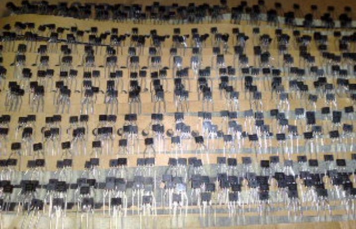

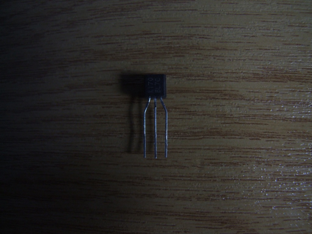

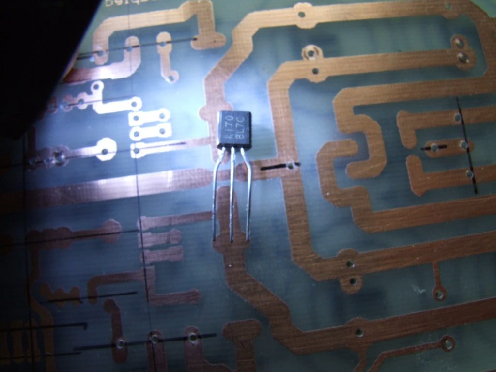

Why do you think that they are fakes? Have you measured them? And?
DEFINITELY FAKES. Idss measures at 2mA for the badged 2SK170BL.
Idss should be between 6 and 12mA. Even the devices look re-badged. Look at the wiping marks on the face of the devices.
Dalbani were very quick to replace them.
Funny how the whole batch were low Idss whereas a previous order were well within spec.
