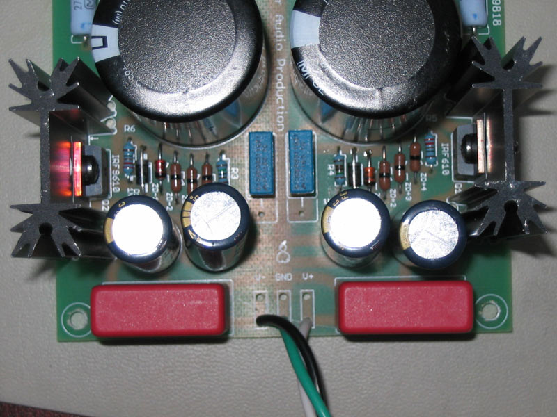

Actually guy's i found the error SOME HOW i did it to both psu's I put the 75V zener on the neg rail witch did NOTHING at all and put the 24V on the positive rail. so in the end i blew up a pair of fets 2 resistors. Small price to pay. In any event i have posted a picture of the diodes. Please be extra careful people as it is a simple mistake.

R5 literally blew up ('ahem' 221R). I think one or more of my fets were shorted to ground. D'oh! I'll return to it in a couple of days when the smoke subsides.

R5 is the one that needs to be changed out to 10K. A few folks had a problem with that resistor running too hot.
