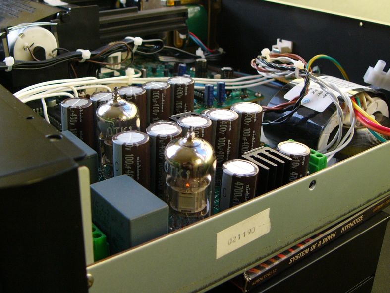

I just finished a major (by my standards) project today, an SRPP (totem pole) triode output stage for a CD player. This idea has been around for a long time, and this has been done before. I was particularly inspired by Lukasz Fikus and his site Lampizator.

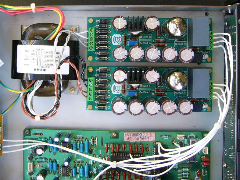

I took the core SRPP circuit values from Lukasz's site, and combined it with a straightforward LM1086T-ADJ regulated filament supply and a small signal relay based mute (to replace the functionality of the muting transistors in a player's original output stage). By default it suits a TDA1541A, but it could be adapted to suit almost any DAC. This DAC is still my favourite, not just for it's sound, but for the beautifully made radial arm laser mechanisms it tends to be paired with.
I installed it in my otherwise stock Rotel RCD-855. The sound is pretty good (don't ask me to describe it more than that, airy, shimmery, what?), but not light years from what can be achieved with a carefully designed opamp based stage. It's dead silent when it should be, with a background noise level lower than the integrated amp I tested it with, which I'd credit to the tight layout and good filament supply. I'm really pleased, as this is the first project I have done with tubes, and I really had no idea of what to expect.
The only disappointment would have to be the muting relay, it's not as effective as I'd like it to be. There is still a slight power on crack, and a medium sized power off thump. I don't know if the relay is just a bit slow, or that the mute signal that drives it (which was designed for an opamp stage) just isn't present for long enough to cover the undesirable noises in a tube stage.

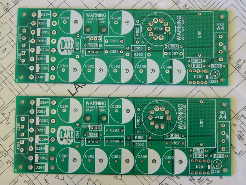

I designed the PCB using DipTrace, a program I would recommend. Some basic specs for the PCB:
- 140 x 50 mm in size
- 101 holes
- 2 layers

- Electrolytic capacitors : Nichicon PS and PT, good quality capacitors at a reasonable price. I did have a couple of 'teething problems' (actually small fires) with the PTs in the HV supply, as they weren't very fresh and I ran them pretty close to there ratings (320 V on 400 V rated caps). Forming them by running the whole stage for a while on my 240 V to 120 V stepdown autotransformer solved that problem though.
