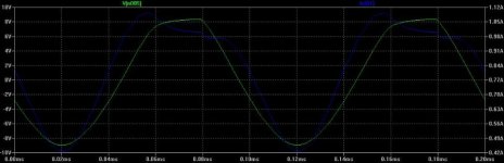

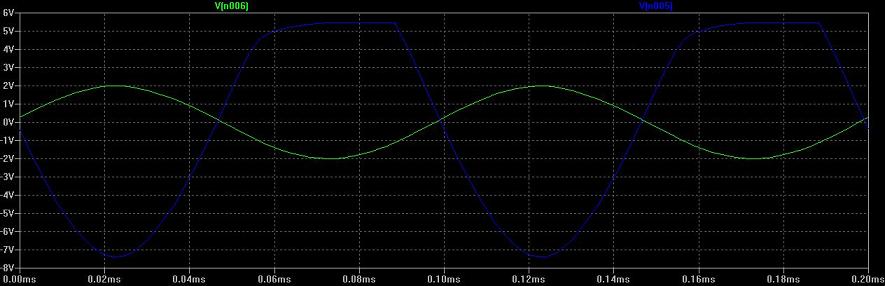

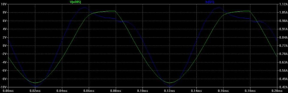

Since I'm bored I might as well just throw another setup with this output stage that worked well. Frequency comp values were trial and error on the proto type circuit but it performed excellent. It sims very low thd, and the sound is very, well plain to me, i like the harmonic generator amps i suppose . But still it was a very good performer.
And before I forget, The clipping issue can be attributed to the voltage level at the emitter of the input transistor. It can not swing any further negative than this point. I also found this behavior. Clipping point will happen at different voltage input based on the gain of the input transistor which is probably self explanitory.
Its the positive half of the output im haveing clipping problems with..
Checking with signal generator and osciliscope gives very similar results to what i get in the sim so i'll post a screenshot of what im talking about..
I have removed the emmiter resistor from the output in my prototype, dosnt apear to affect performance atall acording to my measurements, there isnt really any change in the sound either so i think i'll leave it out (keep it as simple as possible at the moment)..
if i decrease the value of R9.. The clipping gets better.. to the point that eventually it goes away (but the current through the output stage ends up at stupid levelss even for a class A)... You can see exactly what is going on in teh following diagram (this is with R9 at 280Ohm) blue is current through Q1 and green is output...
DoomPixie said:and now it works....
but i hate to think what the idle current through the output stage is going to be like....
first,
right you are,
the emitter resistor of upper output transistor
is not good for much ... it is not necessary.
Such an emitter resistor in Q2, would have a bit more effect.
But I am not sure if is necessary to put one in Q2 emitter.
Probably can work without.
But one thing could be useful, at least while experimenting (you can remove 0R1 resistor later):
If measure voltage across 0R1 emitter resistor, you can see what current is in OUTstage.
second,
Your Trick with C3, is great thing! (AKSA uses this bootstraping CAP in his amp kits)
third,
R1 + R9 and R4 values, will all effect the current in output
-> lowering R1+R9 values, will increase CURRENT
-> lowering R4, will decrease, make less current in output
One way would be:
Make R1+R9 such as you get a bit TOO MUCH current in output.
Then replace R4 with
for example:
one resistor 470 Ohm + one trim pot 470 Ohm (=940 Ohm total )
Then you turn down value of Trimpotentiometer,
until you get a 'normal bias level' in output.

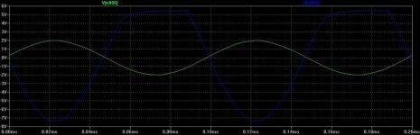

the only way i found to get rid of the clipping useing the transistors i chose was to increase the current..
I am thinking mabey it would work better with different transistors though, to be honest i just put it all in the sim useing transistors i know i have and then i built it around them.. i think it is Q3 that could do with changeing, the signal after Q4 is always good, it is when it goes through Q3 that i get problems..
any ideas?

What is the voltage sitting between the output trans. The only trouble I could find would be vout sitting too high causing the postive end to clip. The point at q1's base also sits a vbe drop above and will clip slightly before the vas. I would recommend adding a high value pot 220k or more above r7 to adjust vout and lower the value r7 say 47k or lower or higher to get the adjustment range needed depending on the beta of q4. Your increase in current probably lowered where vout is sitting which remedied the clipping. also increase r4 to 2.7k, this biases q2 higher and will help lower vout as well. Vout is optimal at 1/2 supply plus the voltage at the emitter of q4. As for the bootstrap choose a value for r9, say 220 ohms and replace r1 with 300 ohm pot to adjust bias setting, then adjust vout with the pot added above r7 when you have the idle current you want.
As for the power supply the only thing you need to worry about other than your transformer supplying enough voltage and current is filtering. I used a simple CLC which was effective, but for best results if you plan to keep the circuit in its simplest form, the best supply would be regulated supply.
