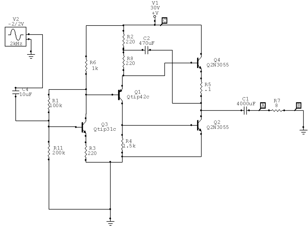

My simple class a approach
As measured the lower output trans supplies about 2/3 of the total ac current through the load. At full output with 1.5 amps through the load, about 1 amp flows from the collector of the lower trans to the load and 500 milliamps from the emitter of the top trans. So what am I missing about how the output works :confused:

Saw the bootstrapping on your sim and checked it out. Seems that bootstrapping equals the ac current from both to push pull output. Will have to mod one of my circuits to try it out.
By the way, I am using the models from On Semi website in my sims. The actuall outputs I,m using are mje3055t's.
Modified one of my built circuits with a bootstrap. It still sounds very good but seems to have lost some of that wonderful sparkle in the treble the other circuit has. Although it is only a minmal loss it may be a good trade off for a more consistant bias.
oops typo on the schematic, 200k resistor should still be 100k.

Anyways.. you should really read Rod Elliots commented article about the JHL 10Watt Class A amp.. it helps to get a good understanding of the topology..
meanwhile I have attached a variation that not only has no negative (loop-) feedback.. but also solves the idle Vout setting..
regards, Thijs
