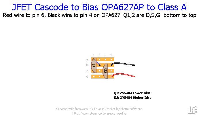

I don't prefer CCS biasing the output stage to class A , but for those that do, try a 2n5486 as the "top" cascode fet. It is a high Idss 2n5484, so to speak.

Here is something I put together with two 2N5484 JFETs. I just had to measure the Idss to make sure the higher Idss transistor was Q2. However, as you suggest, you can use the 2N5486 as Q2 instead. But you still need to know the Idss. When you make a pair of these, the exact amount of mA biasing isn't that important, just that both cascodes have the exact amount of biasing (mA) or is real close.
Let me also say that above 1mA and below 3mA is ideal with a cascode for the 627. Some people push it past that but I don't know what the results of that are.
The pair I made with only 2N5484s has mA values of 1.209 mA and 1.269 mA. I should have tested the Idss before assembling these for a closer match but the learning experoence was invaluable. So I am going to order a bunch at 12 cents each, measure them and pair them off to enhance my creation (FrankenCD Player). I should say that two guys in the forum really helped me to understand this. Thanks guys!
Attached is the layout for my cascodes.
I hope some will give it a try, the lone resistor is not the way to go, especially under load.
Regards//Keith
