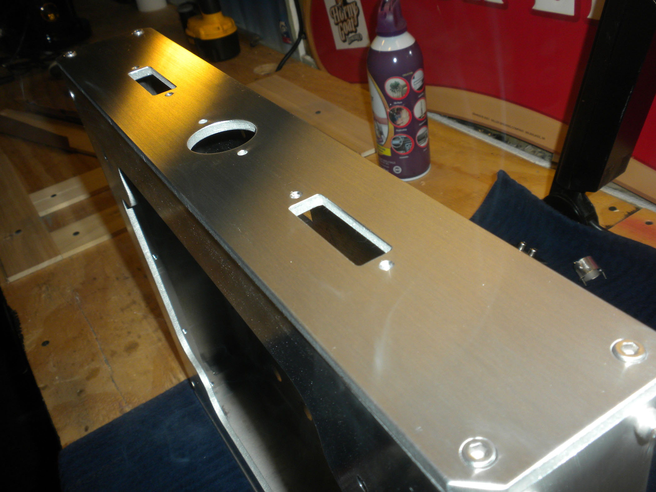

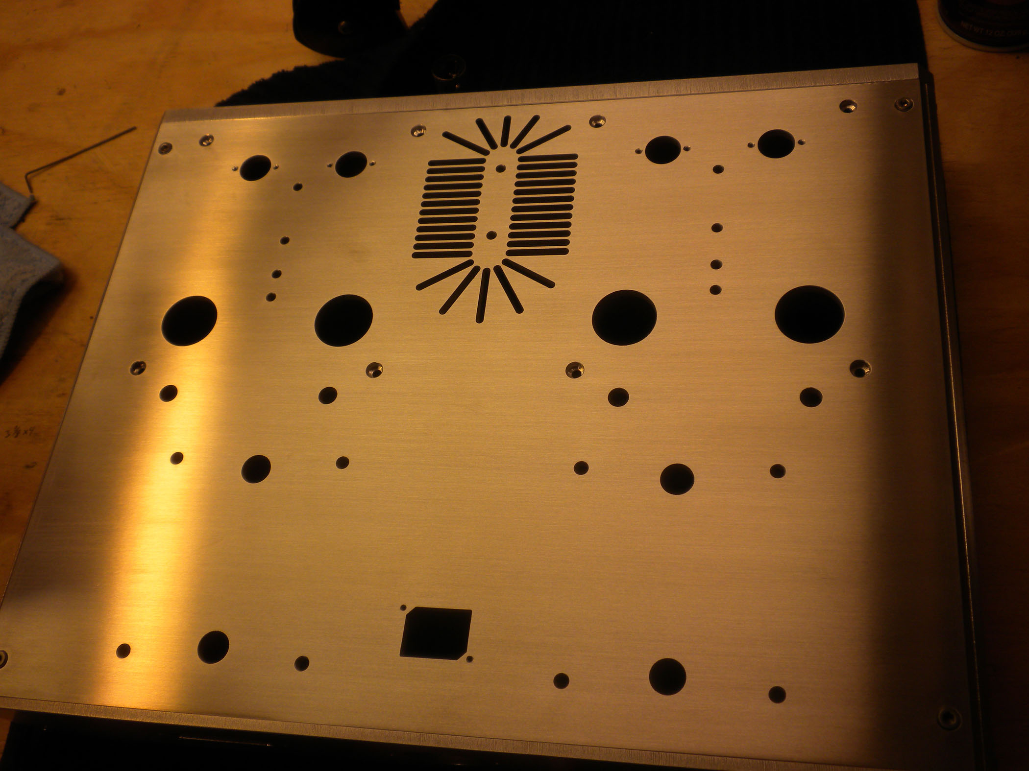

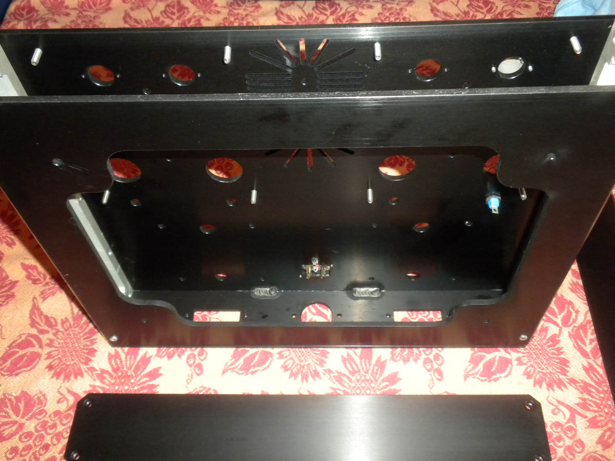

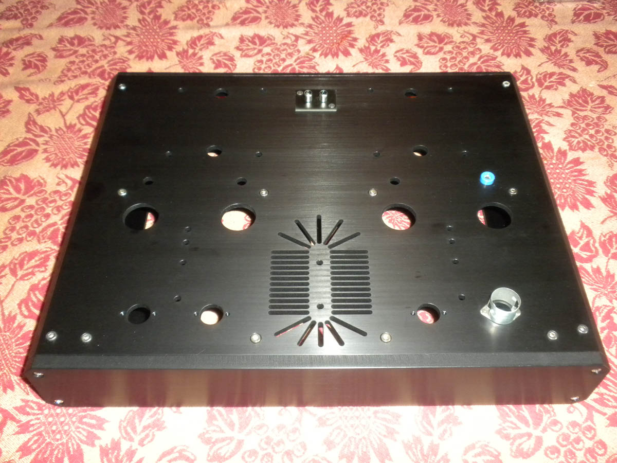

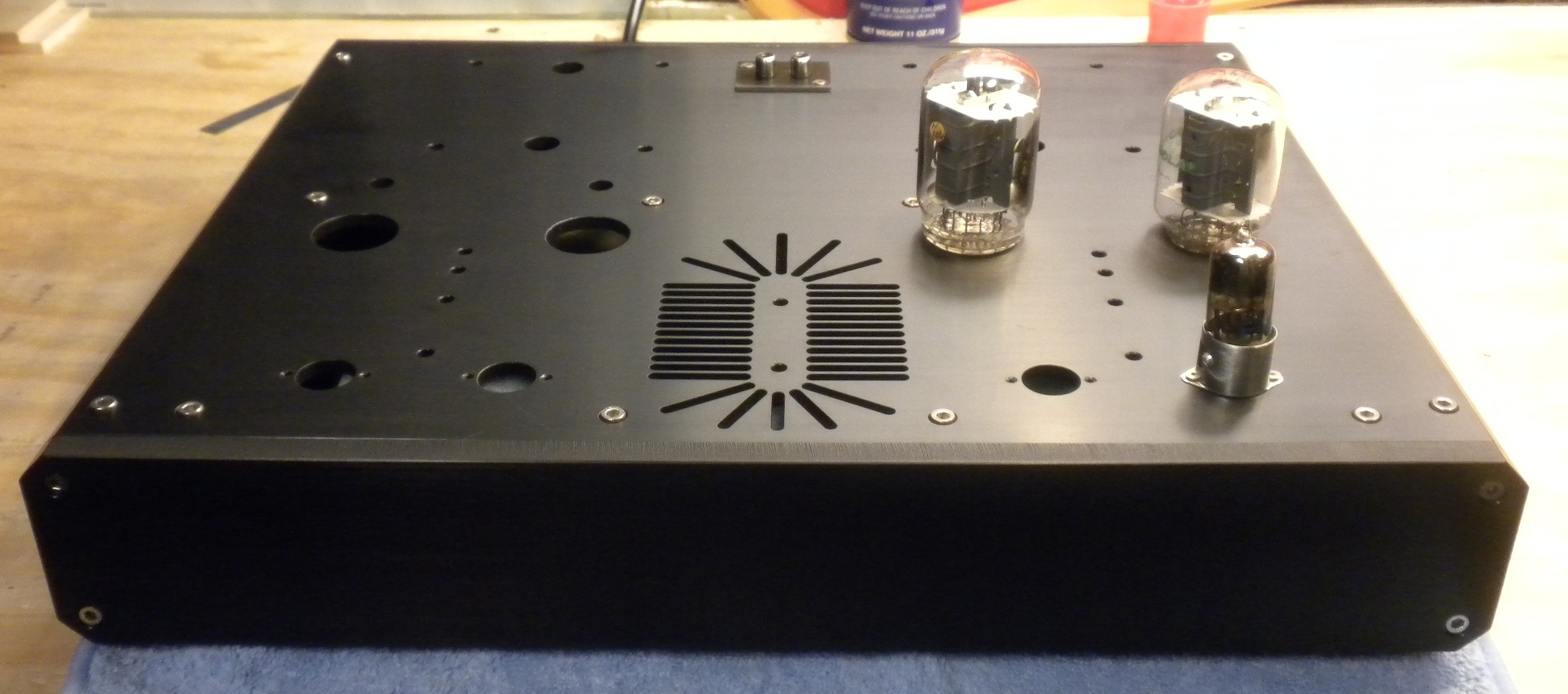

Greetings everyone,
Just wanted to show you my "Red board" chassis before it gets stuffed. My plan is a separate power supply. If anyone has any questions, you can get me at rsumperl@hhk.com
Ray

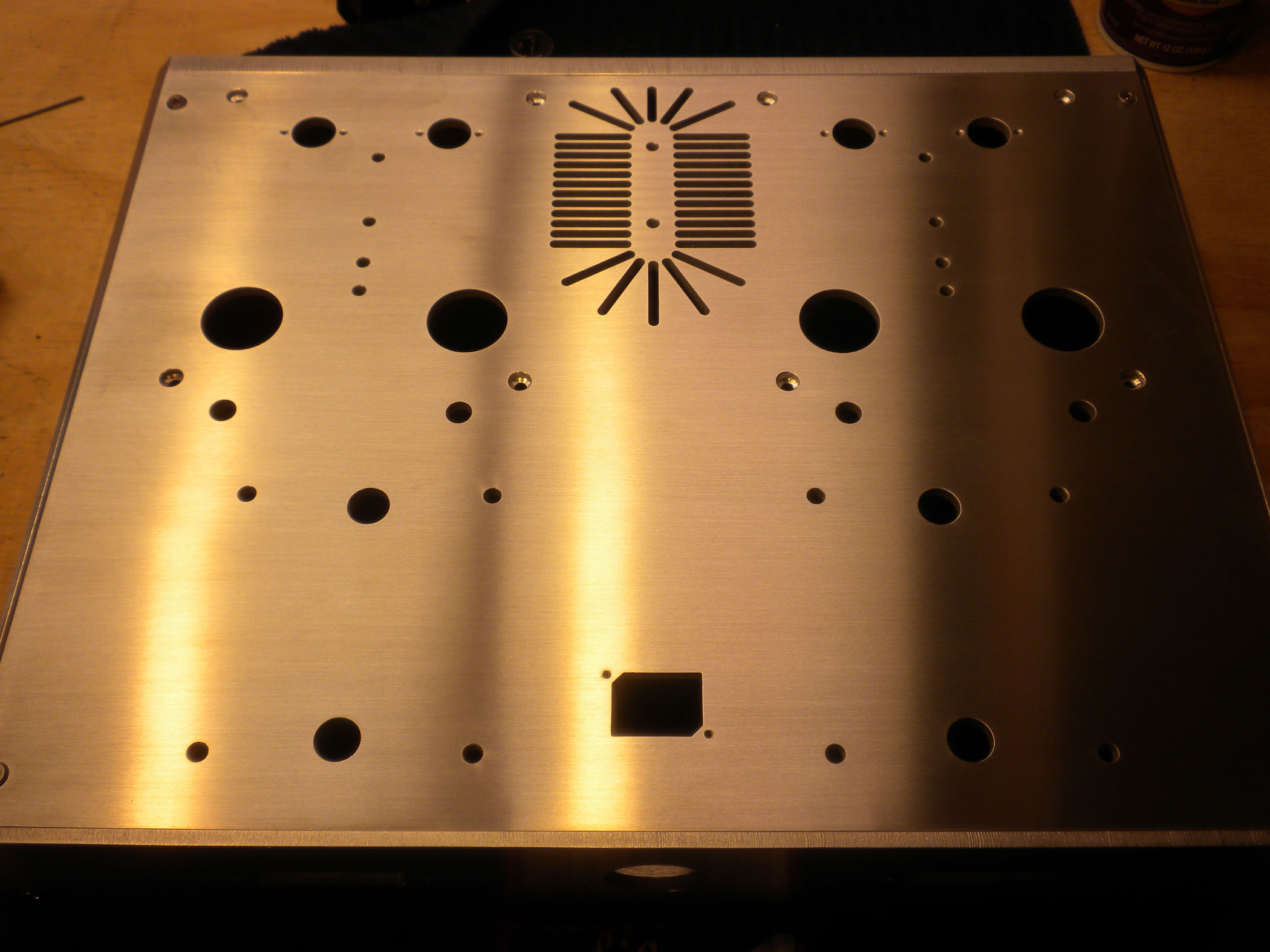

Actually Stuart, I wish I had the machinery to do it, love doing that kind of stuff, must be the male power tool thing, but alas, I drew it out and sent it to a shop in Chicago.

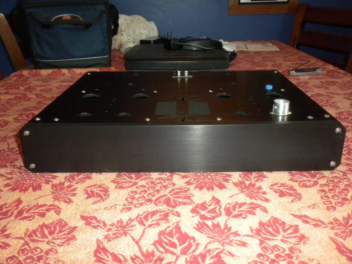

Big red board.

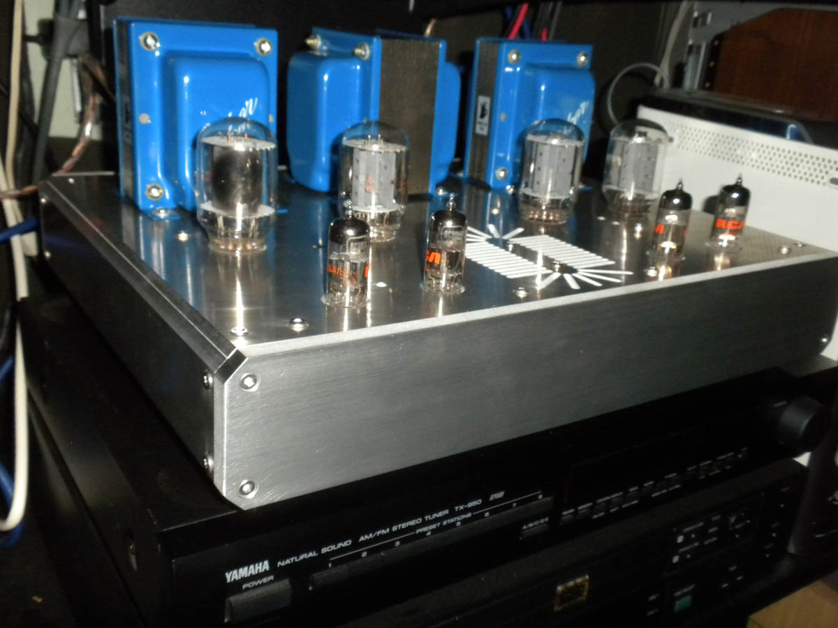

Looks sweet, can't wait to see it stuffed. What iron and tubes have you selected??

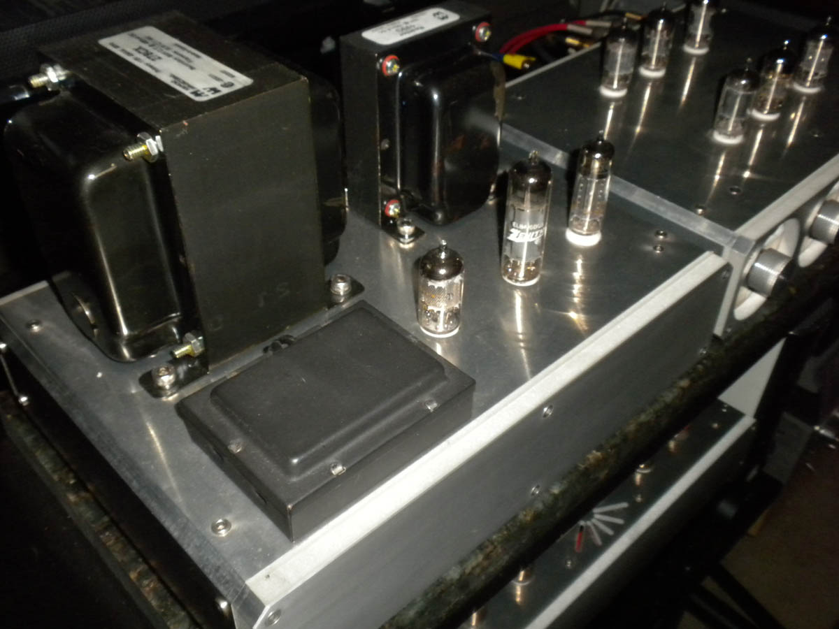

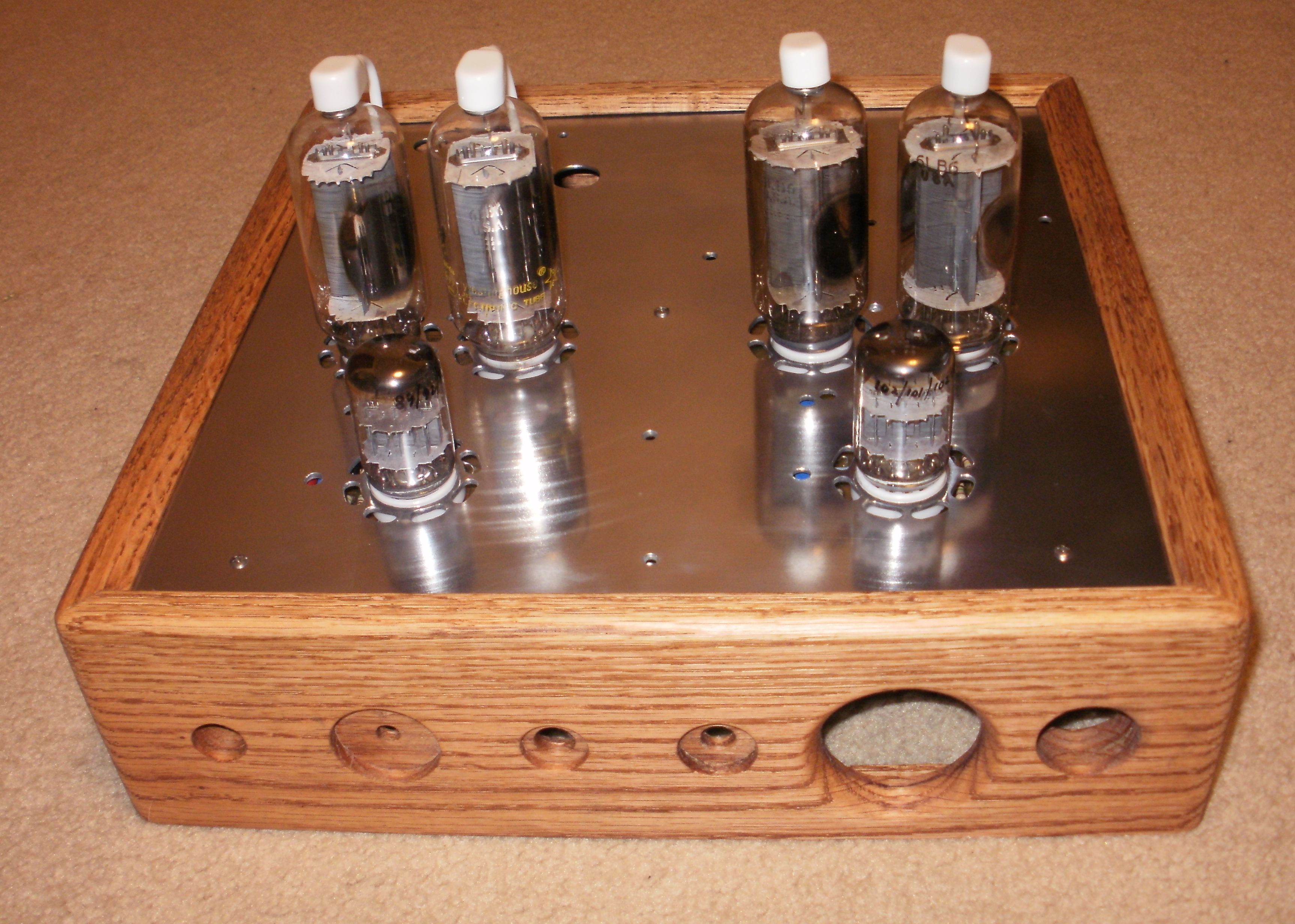

I went wood with the second amp. Just was able to get the wood stained and the plate buffed. Head to China tomorrow.
I received the knobs that I ordered before Christmas so I was able to finish the first one as designed. The other knobs were a little tacky.

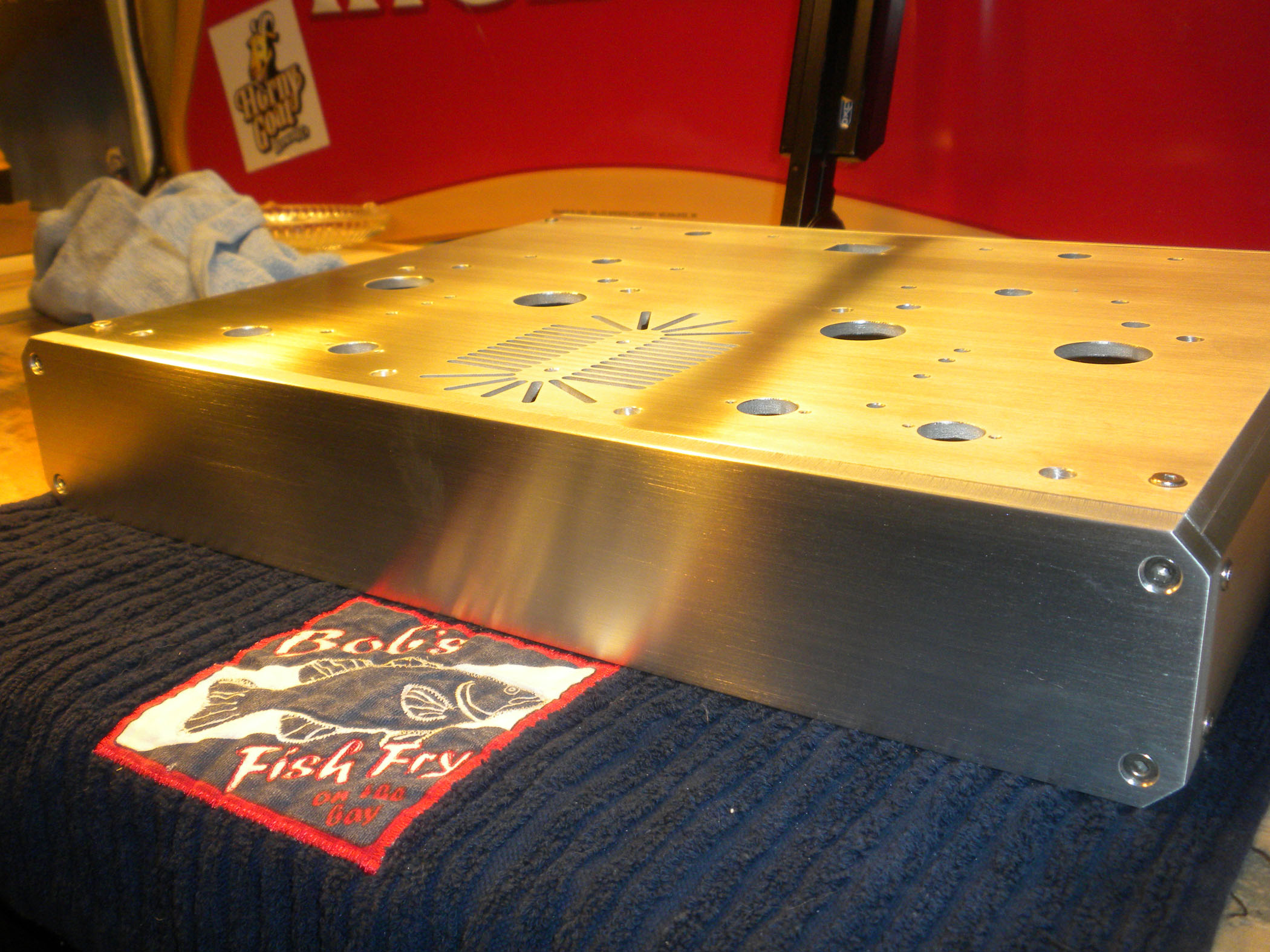

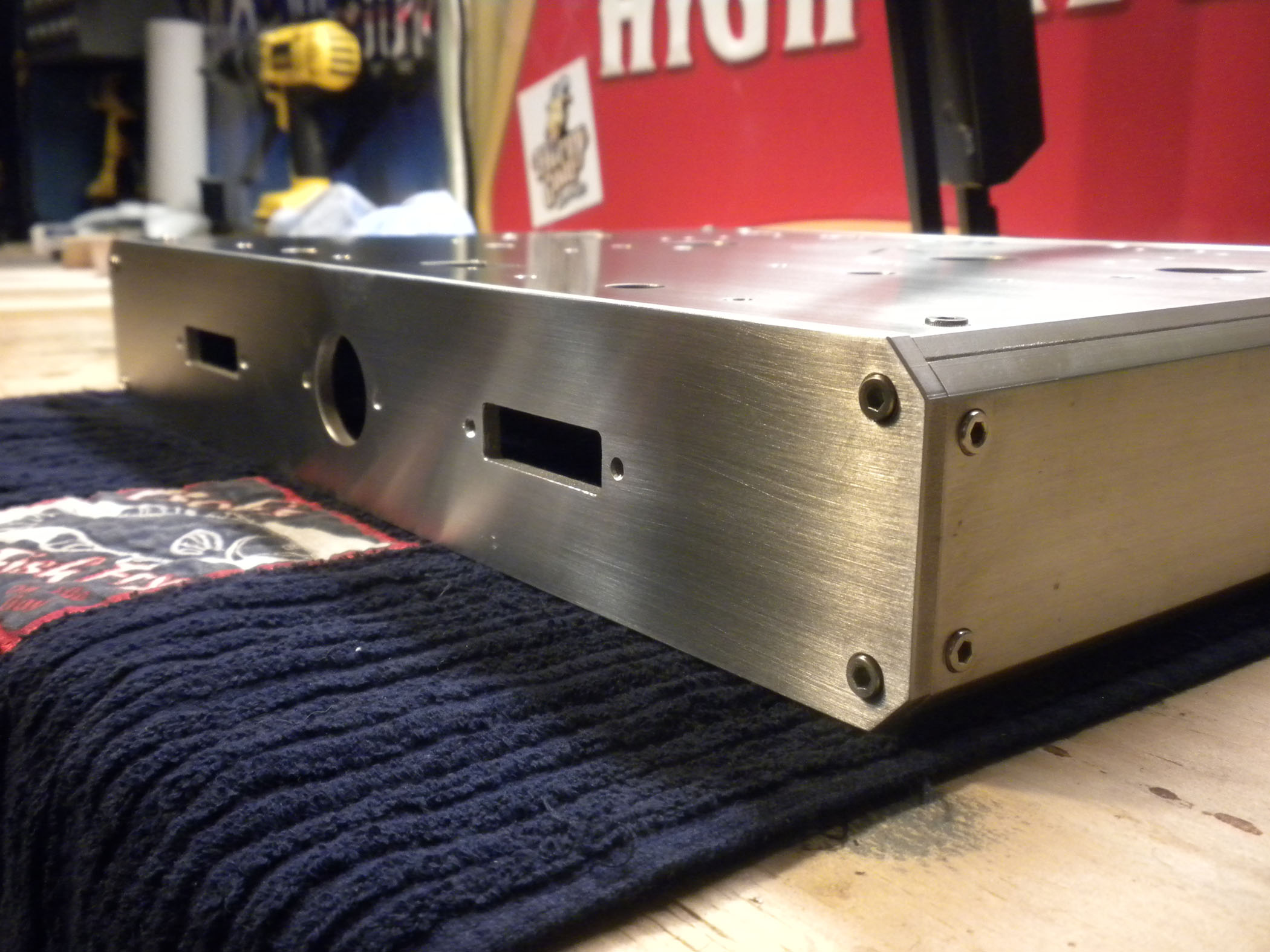

That chassis looks quite good. Is it completely custom or does somebody make that base chassis minus custom machining?
The detail that really sells it for me is what looks like tight tolerances on the beveled edges and the fact that the panels look nice and thick.

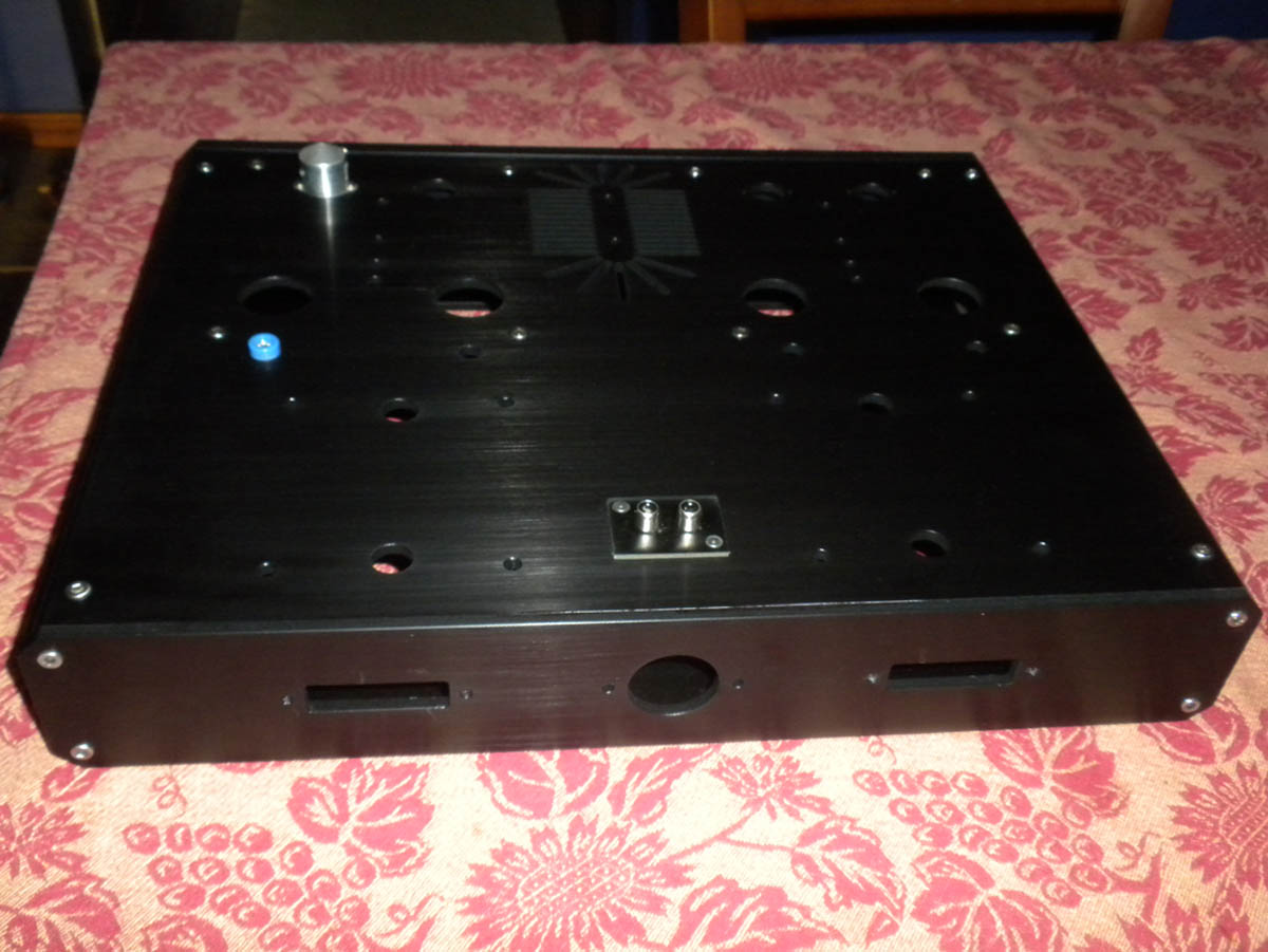

I built this chassis for Ray. If anyone is interested in this, read my posts to follow and I will post detailed pics of the chassis frame. Trust me it's a lot cooler than it looks in previous pics.
And yes, I will build custom, plain, or ???

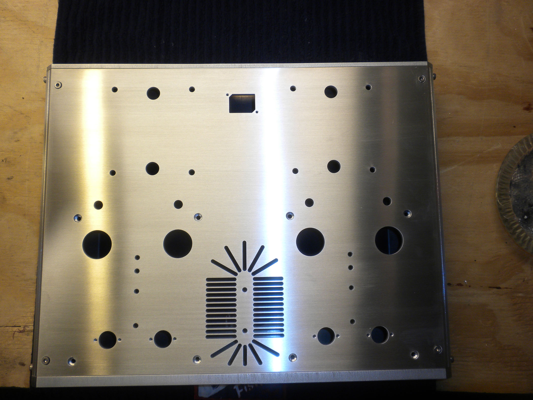

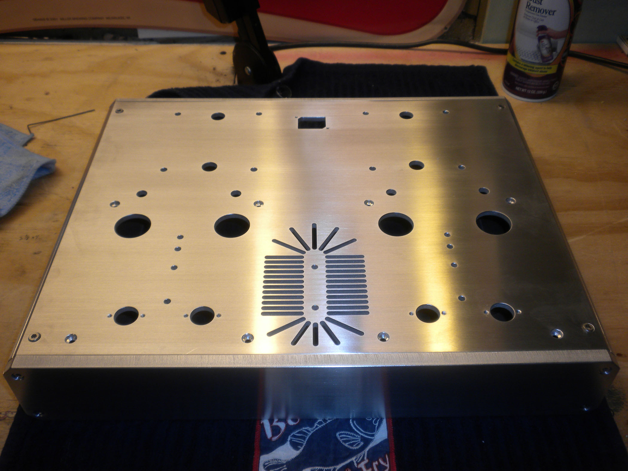

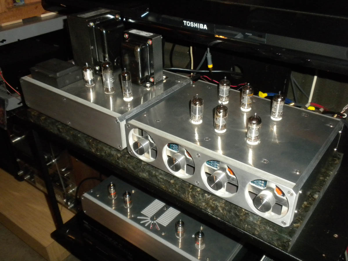

The chassis

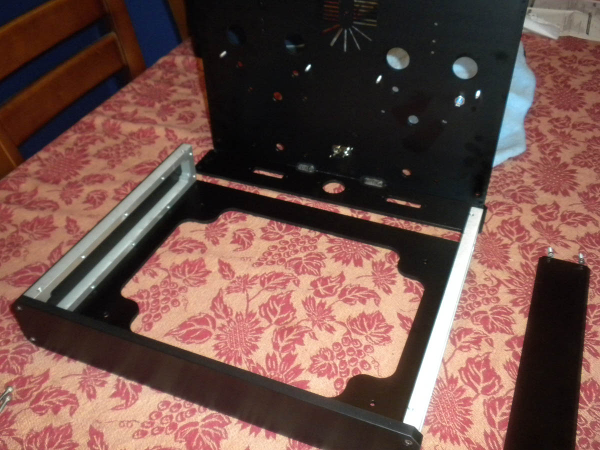

So here's the low down on this chassis.

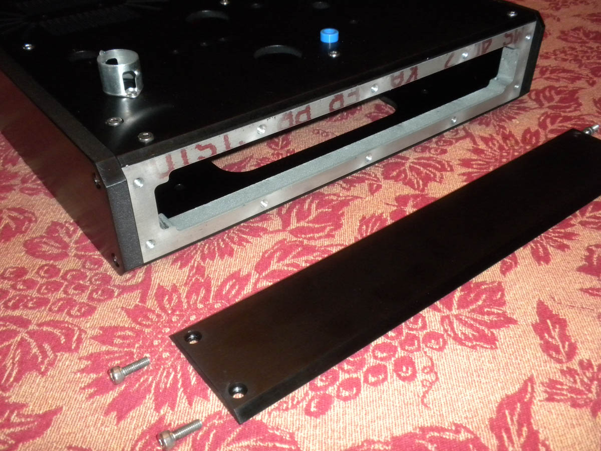

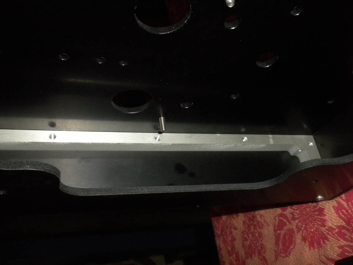

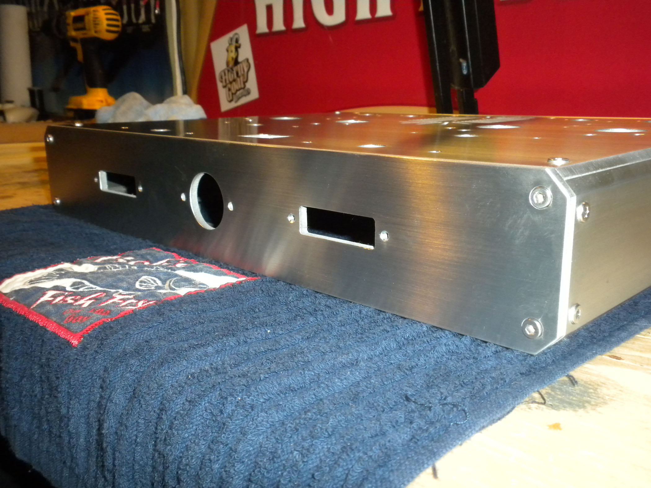

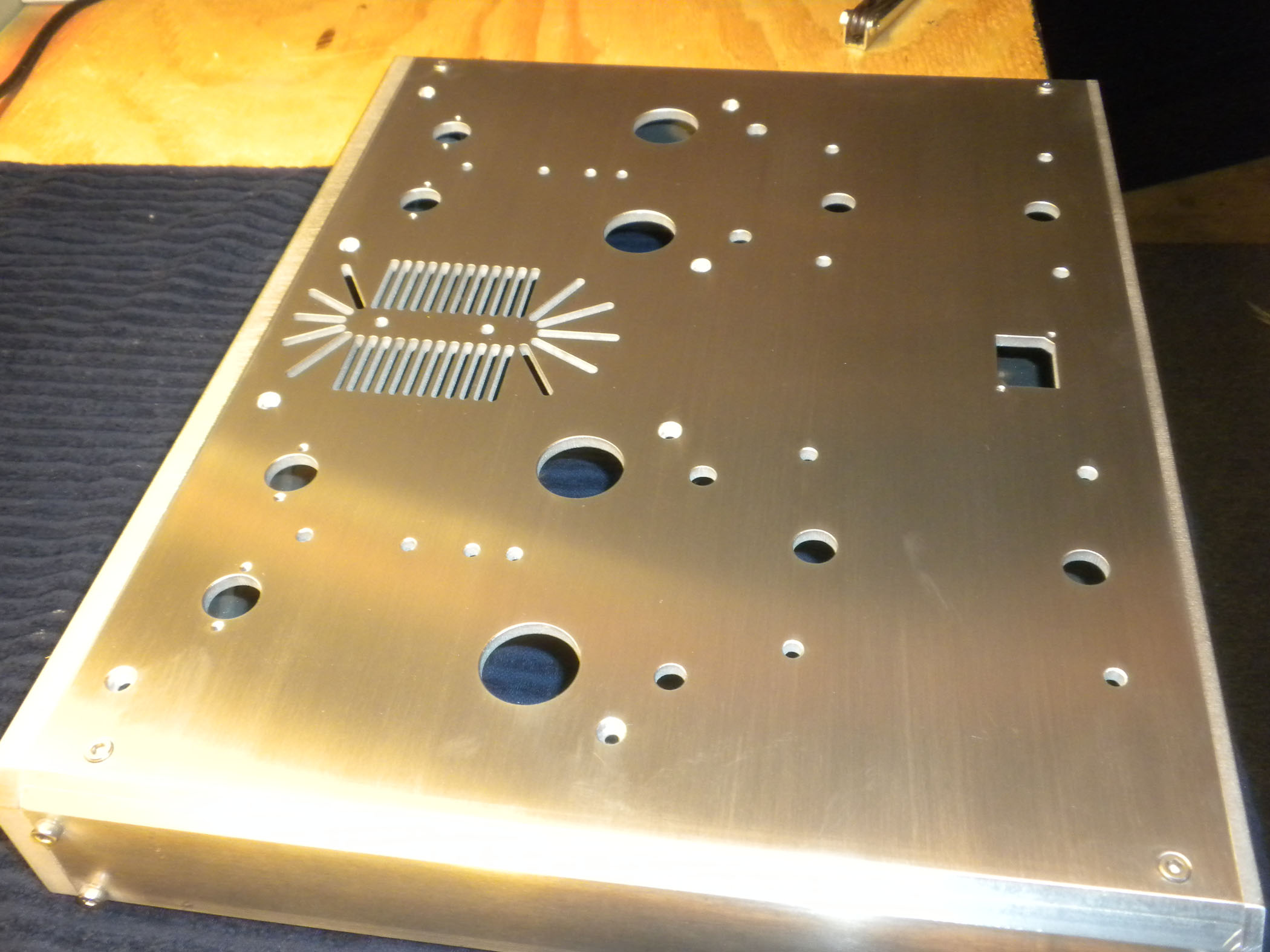

In the pics you will notice more than a few features that set it apart from your standard thin sheet metal boxes.
First, all panels are removable.
The top and rear are attached with two small welds which means you can remove all of your components from the chassis, work on them, and reinstall easily.
Removing either side panel exposes the chassis frame, which is common to both sides. There are also several tapped holes in each frame that can be used for wire holders or a buss bar or barrier strips (actually the spacing top to bottom is designed for a 4 position barrier strip available at any "Radio Shack")allowing you to easily change output taps or set bias or what ever you want to use them for.
All panels are made from 3/16" Alum except for the front which is 3/8". This makes the chassis, as a whole, very solid and as you would expect minimally resonant, especially compared to thin sheet metal.
This design is also scaleable as you can see in some of the last pics which are showing my Pre and PS.
The chassis's I have built to date have been built by hand for the most part. I found for single units it's the only way to control the quality.
I could do a production run if someone wanted, any more than 4 could be done on our CNC mills which would reduce the price. Obviously more units per order means less cost per unit.
