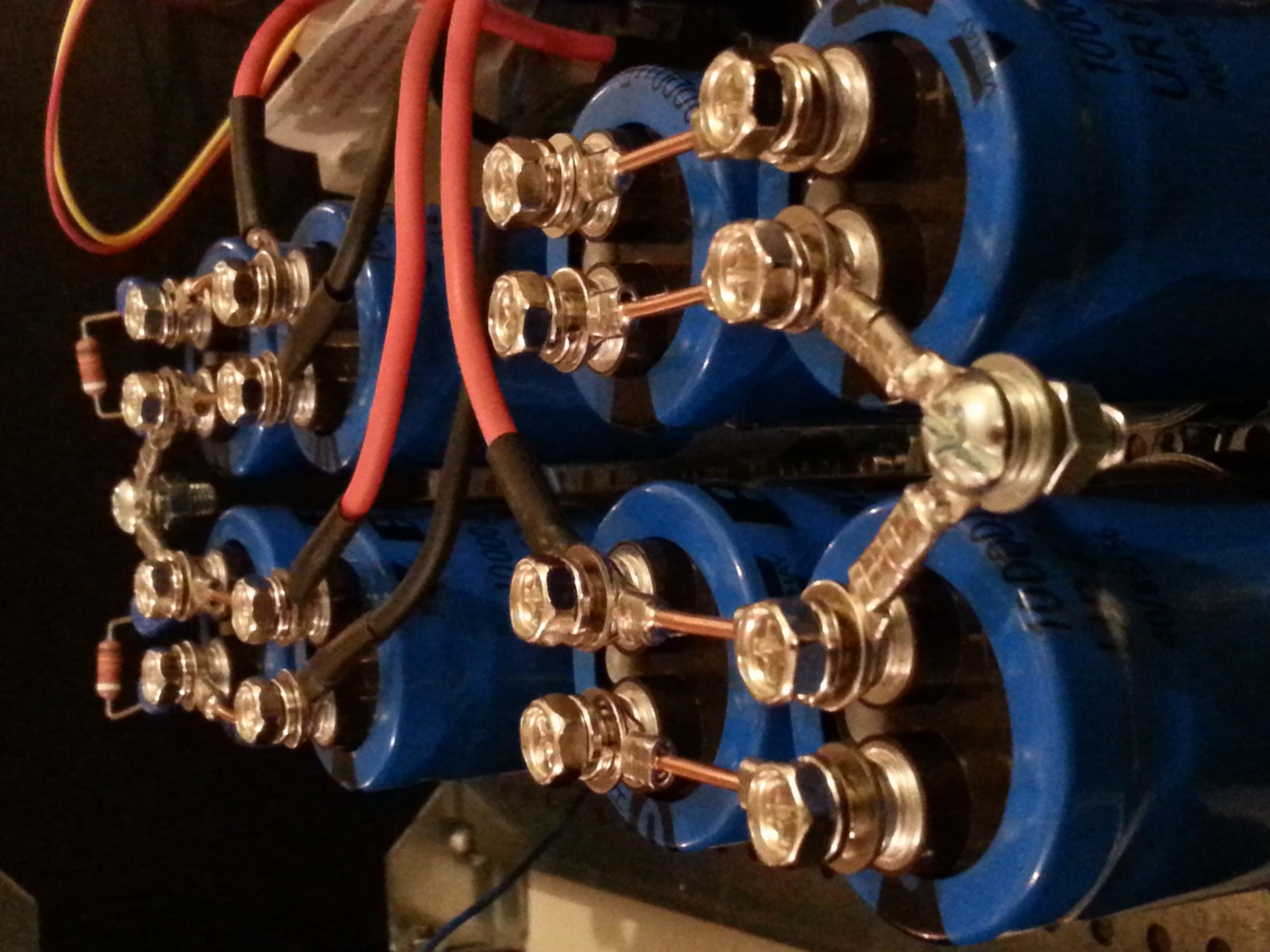

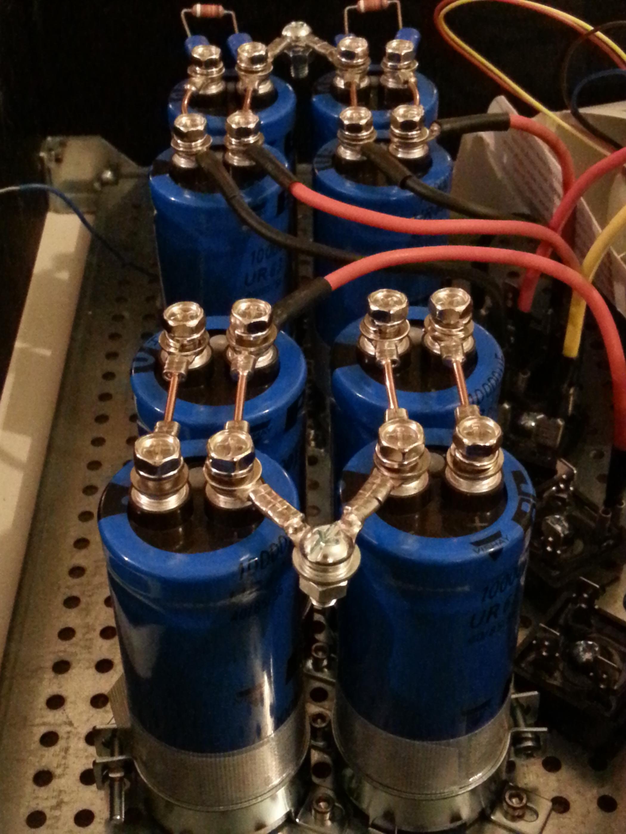

Try to upload photo again - always rotated when I post from my phone.
What are the values of those resistors on the caps? On first look they seem a bit small (in wattage).
Hey Delange. Am using 0.5W resistors, 13kR. Actual dissipation is about 233 mW each when feeding from 55V.
Haven't figured out final location for bleeders yet.
