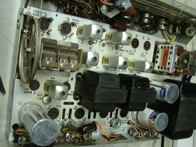

'Caps' are capacitors, which in your unit look like;
- Big silver cylindrical cans sticking up near the transformers.
- Brownish 'tootsie-rolls' with leads out of both ends and names like sprague and markings that have 'uf' 'nf' or 'pf'
- Lighter brown discs
- possibly some brown red or black boxes with colored dots on them.
Time to steal some photos and point this out -
See the big cans by the transformers that say Sprague? (and the one in the lower left...) Figure out what they say on the side and post it here, someone will help you find the replacements.
Also in this photo, do you see the row of dual round things in the upper right? behind where the knobs would be? Those are the pots that need cleaning with the stuff from radioshack. Spray a little in there and move the knob back and forth a bunch.

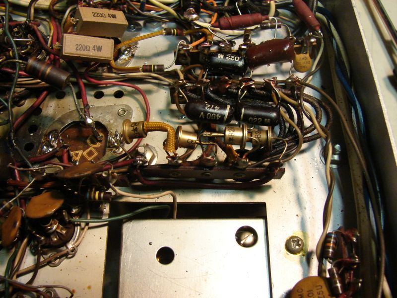

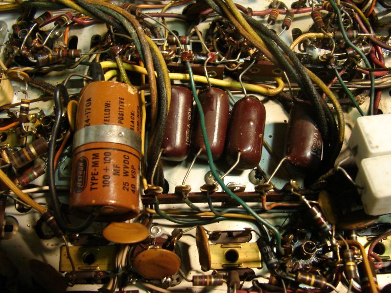

There is no doubt that all the big cans must be replaced. They are too old to be working properly anymore. There are also some paper ones under the chassis that are also shot. (it's a function of age) like the one on the left in this photo -
The row of 4 darker ones next to it should also be replaced. Those are most likely the output tube coupling caps.
You also have another problem - the Selenium rectifiers. These guys:
They also age themselves to death and need to be replaced. The problem is that there is no direct replacement and you will need to add a resistor after the bridge to get your supply voltages correct.

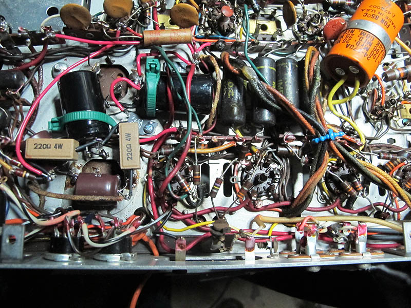

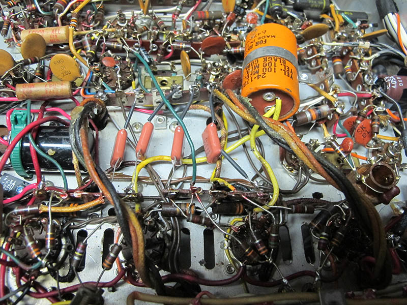

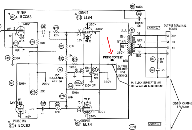

Interesting find, the center tap of the output transformers are wired to the screen grid pin of the 6BQ5's. This means that the screen potential might even be higher than the anode. Apparently, someone forgot to tell the soldering mavens that the red-yellow wire was to be connected to the junction of the 100R/40uF capacitor.

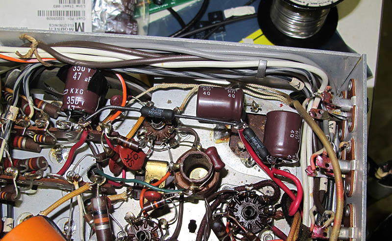

Diodes replaced with UF4007, so will pick up ~4V.
All the can electrolytics are shot, so replaced with new.

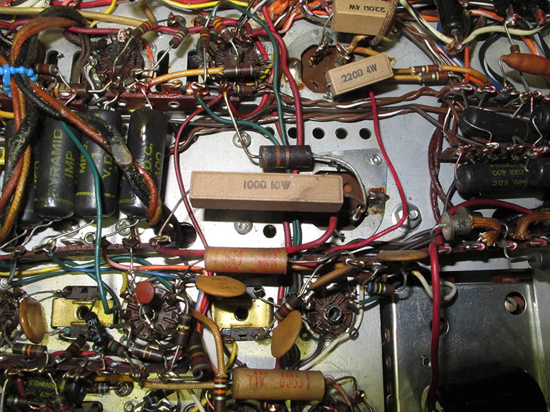

100R 10W resistor replaced with a Caddock affixed to the chassis -- this will remove some of the heat from the under-compartment.

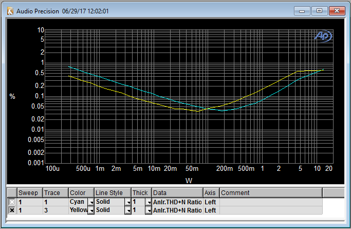

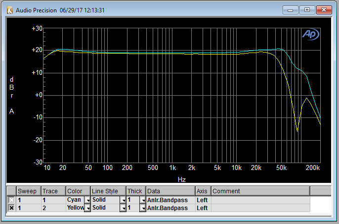

First tests -- had to replace one of the ECC83's, the bypass caps from the phase splitter were replaced with 0.1u/630V Panasonic polypropylenes as the old film caps were leaky. One of the DC balance pots was completely shot and replaced with a spare CTS unit found in the junk box.
1W, 1kHz THD 0.1%
I think that the 100uF cathode bypass cap has to go...
