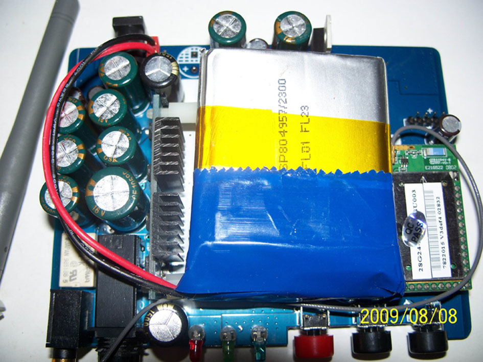

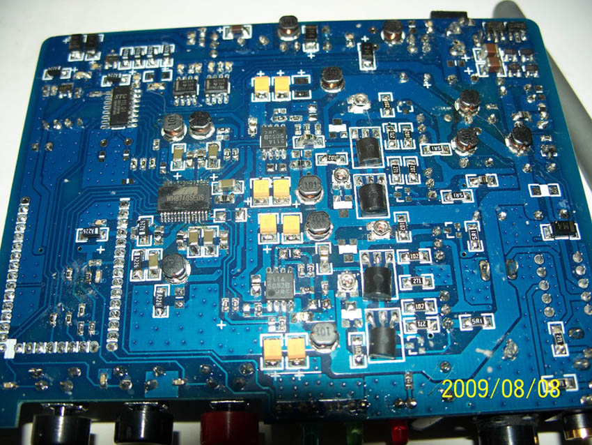

My Portable Wireless Headphone Amplifier & DAC

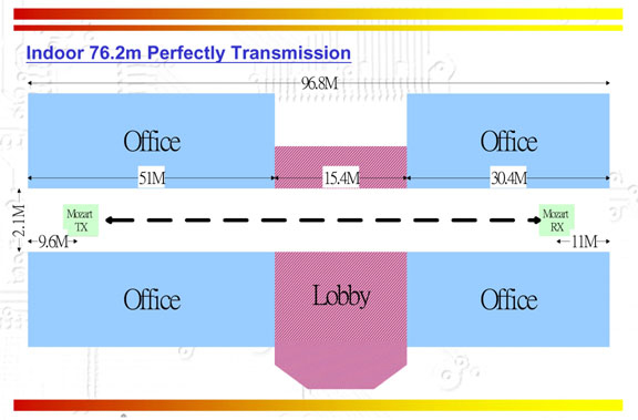

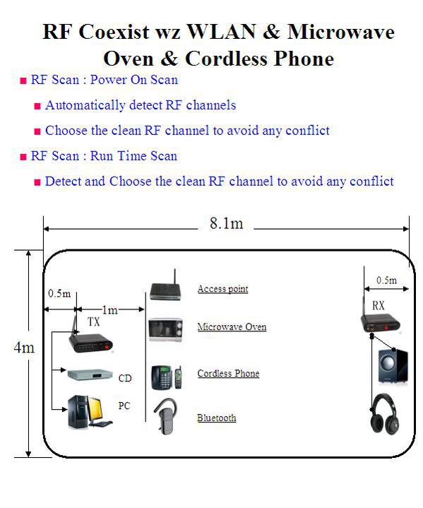

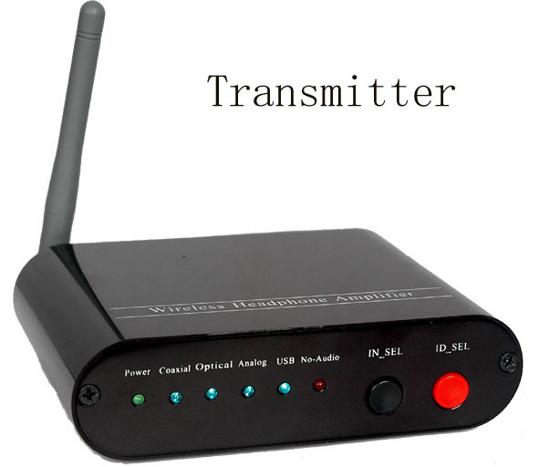

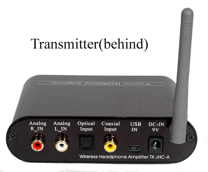

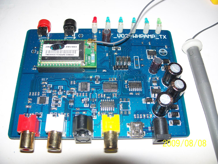

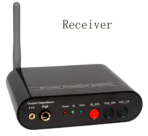

My design, using 2.4GHz digital AUDIO wireless modules, the working distance of 328 feet, 3 Li-ion battery. And converted into a negative 12V. JFET + MOSFET amplifier. DAC with WM8740. Test results:
1.THD at 5 V peak: 0.005%(300ohm load 1kHz)
2.S/N : >86dB
Pls comment, thank !

You kidding? This looks awesome!
I only wish there was more stuff flike this around, they're as rare as hens teeth.
Preferably with better quality analogue-out and a built-in DSP for remixing Dolby formats & the like (using HRTF or better) into a format that sounds realistic when outputted to stereo headphones!
The only other notable one around is that 'kleer-based' adapter from SleekAudio. But it doesn't have a DSP, it's DAC aint that special, & they lock you into their freakin headphones! Grrrr
pcomliu modify yours to do what I suggested above & I guarantee it'll sell like mad. The market's crying out for it! Don't compromise on quality and people will knock your door down!
Use 900MHz instead. Don't have it compete for bandwidth with 802.11 devices.
