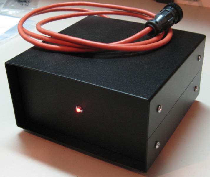

Here the Pearl enclosure. It is recycling of two computer printer port switches. These boxes were very nicely made of strong alu extrusion with nice powder paint. However, the color was the tame computer beige, not very exciting. And the just one channel fits into one box, so I needed two of them. I painted in the case in grey metallic color then connected both boxes using a piece of maple. They are hold in place strongly by 4 stainless steel bolts. I use matching wood veneer on front to hide the original awfull front panel. A blue led will light in the middle.

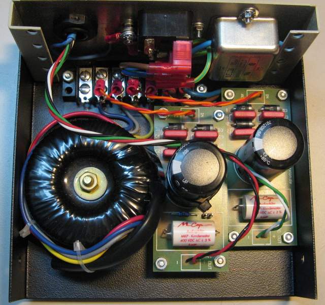

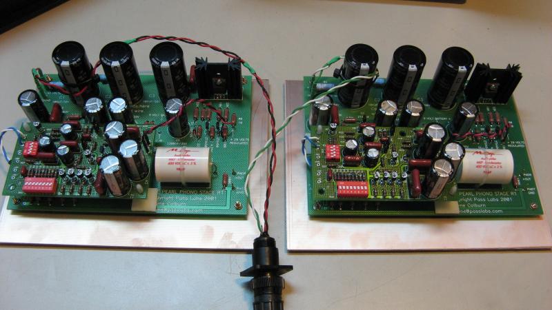

Here a detail of one channel. The gnd lug can be seen just under the power connector. The enclosure has a nice PCB slot already built-in. I mounted the PCB on a piece of bare PCB (grounded to the case in the slot). To mount the preamp, just insert the PCB, connect the wires and you're done. The wires are long enough that the PCB can be probed outside the case for testing. As said before the GND lug has two wires, one per PCB, conencte to each PCB star gnd point.

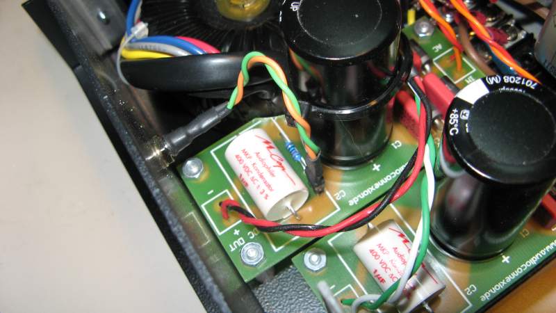

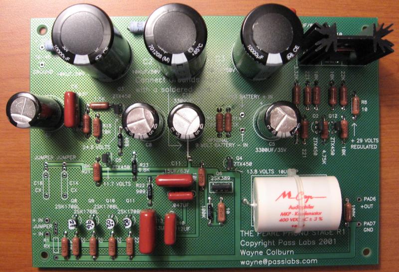

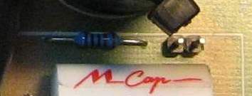

What puzzles me that many (most?) people put those white Mundorf caps into their Pearls (and PSU). To my ears they absolutely ruin the quality of the unit and add some kind of mechanical harshness. Of course your milage will vary.....
I just didn't know any better when I built my Pearl. I'm all for trying something else. Are the Russian PETP's you reference the K73-16's?
