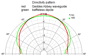

There's a paper by Kates which gives a very precise description how the optimum radiation pattern utilizing "trading" should look like: Kates, "Optimum Loudspeaker Directional Patterns", JOURNAL OF THEAUDIO ENGINEERING SOCIETY, 1980 NOVEMBER, VOLUME 28, NUMBER 11
Thanks Markus, I'm familiar with that paper. As far as I recall the dipole cosine radiation pattern is a fair approximation of Kates findings. But it has been a long time since I looked into the details of that paper.
