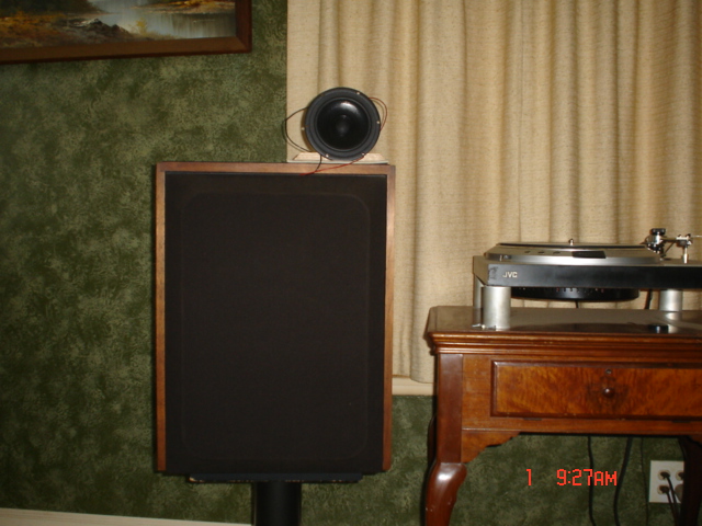

StigErik,
Could you post your measurements of the TPL-150 with open back? It might work in my dipole design. Currently I use the BG Neo3pdr open backed but it is rather low in sensitivity and the PHL 1120 mid I'm using needs to be padded down quite a bit. I'd thought of using two Neo3's stacked in series but maybe the TPL-150 would be better. Do you think the TPL-150 sounds better than BG Neo3pdr?

- My open baffle dipole with Beyma TPL-150
