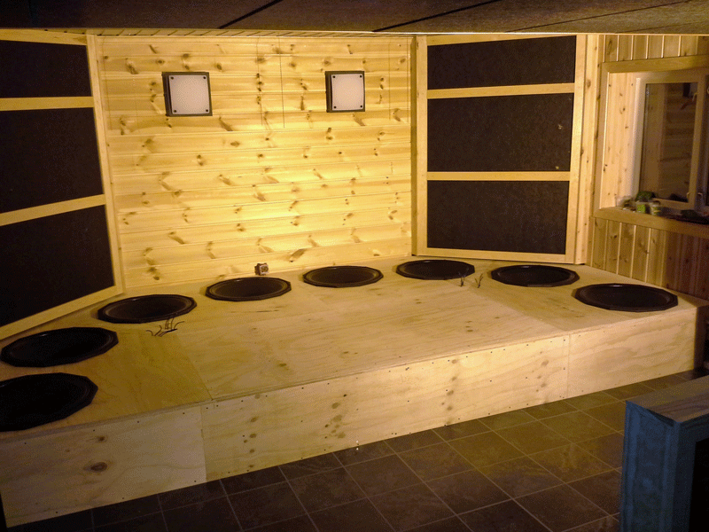

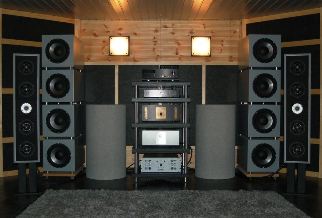

Posting a picture of my old listening room. Listening Distance 2.6m. Slightly over 2m from the rear wall
Dimensions: 2,15m x 4.4m x 6,9m
Midrange and treble section should also be used in the new setup.
Tweeter will change to Raal 140-15d.
It should also be a mid bass system between 60-400hz. It is not decided yet

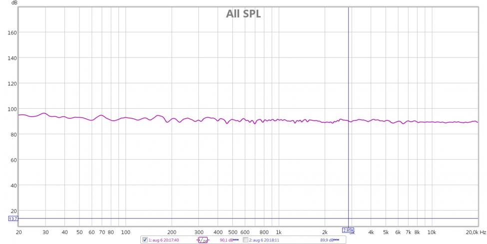

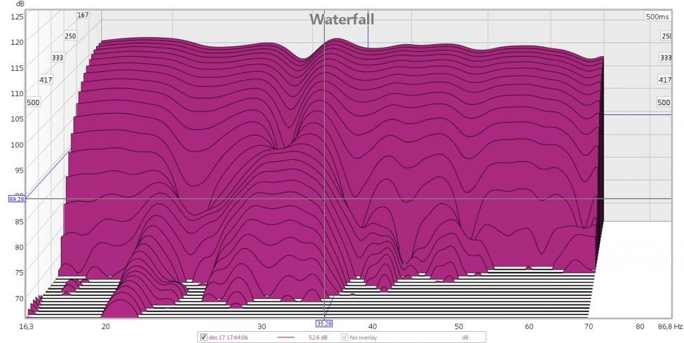

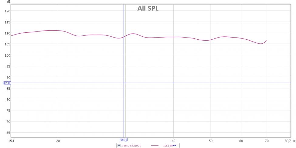

That is a very good response. It is nice to see a subwoofer that offers information below 20 Hz.
For me is a good frequency response important.
This was FR in my previous setup after calibrering with DEQX
1/24 smoothing

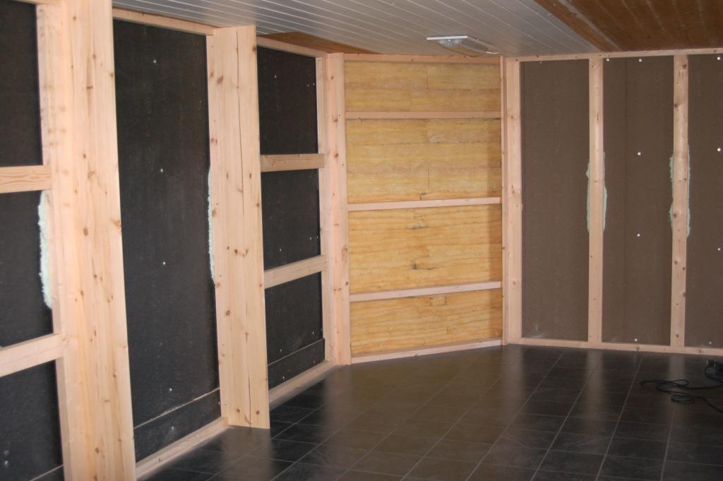

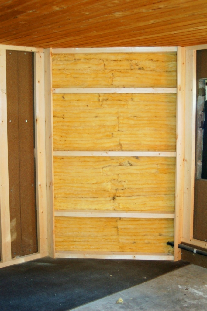

What's behind the black grilles at the corners?
ps. I have zero doubt about the capability of these woofers. Instead, I guess the house would rattle horribly. Maybe the neighbor's house, too. Mwhahahaha ...
From the construction period of the room
The black grilles is acoustics panels of rock wool with thickness 100mm
The corners are filled with Glava = Norwegian glass wool
