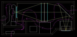

After building my 15" projector, i have decided to begin a new one. First of all, my liquid video is messed up. It has quite a few rows of dead pixels that cannot be fixed. This is very annoying when trying to watch a movie or use the computer. The X and the Resize buttons at the top right of a Window are absent due to dead pixels. SUCKS. Anyway, i am going to keep all of my parts, but use them for a lilliput projector. I am using all my optics from Lumenlab. I am going to switch to a ushio bulb. This projector will be a little bigger than bfourcades and ace's projectors, but will still me small and low profile. I am also looking forward to the longer throw distance and the wide screen. Here is an autocad drawing of my first design. I will probably make a few changes, but this one is still pretty cool. Tell me what you think.

the focus lengths are too long, how can you fit it a box?

Why do you say the focus lengths are too long? There is no such thins as too long as long as the fresnels and objective lens work together. Size of LCD doesnt make a difference. You just cut the fresnels down to size. The focal length does not change.

If you will use a 400w bulb without a cold mirror or a IR filter in the light path I encourage you to review your design to let run a fan over the LCD panel. It is the most important piece to cool down (then the light engine offcourse)
If your lamp hasn´t UV Stop , adding an UV filter will help to protect the LCD.

bfourcade, thanks for the reply. Where can i get an IR filter? I will probably just change it to have a fna on the LCD. That should be simple enough. But an IR filter would be a good addition too. What is a good price for an IR filter, where do you get them, and can they be cut?

made a mistake on the drawing. messed up on the arrows for the airflow. the fan nearest the lamp is the blowing out. the one by the mirror is blowing air in. ill fix it later.
NICE DESIGN!!!!!!!!!!!!!! It makes me want to start my lilliput project over again from scratch. Looks like things should run real cool inside Pj with your design.

how much distance will between lcd/fresnels? what size mirrors? How many fans? I'm seriously considering changing my lilliput Pj to this design.

Hey nice plans!, I have a couple questions for you though if you don't mind...
I haven't actually ever made a projector before, and I'm wondering something about the condensor lens...
Is this just a standard converging lens? and if so, is the first fresnel placed at the exact focal length of the lens?
I know this might sound stupid, but it just seems to me like it would burn a hole in the center of the fresnel, and not throw light anywhere but in the dead center of the fresnel, I just want to know before I start constructing a projector of my own, I have quite the array of lens at my disposal and I just want to know what one to use as a condensor!

Good questions. Thanks for the compliments. I do not the measurements in metric right now, but i will try to calculate them later on tonight.
About condensors. Instead of placing the condensor at the focal lenth og the condensor itself, you will place it at the focal length of the fresnel. You measure from the fresnel to the side of the consendsor that is farthest from the fresnel, and you measure it out to the focal length of the fresnel. In my case it is 8.6 inches.

Thanks, that does help quite a bit actually, one more question though, I know how to get the focal length for a standard lens using this method:
http://www.nasaexplores.com/show_912_student_st.php?id=021230151815
but how could I establish the focal length of a fresnel lens?
