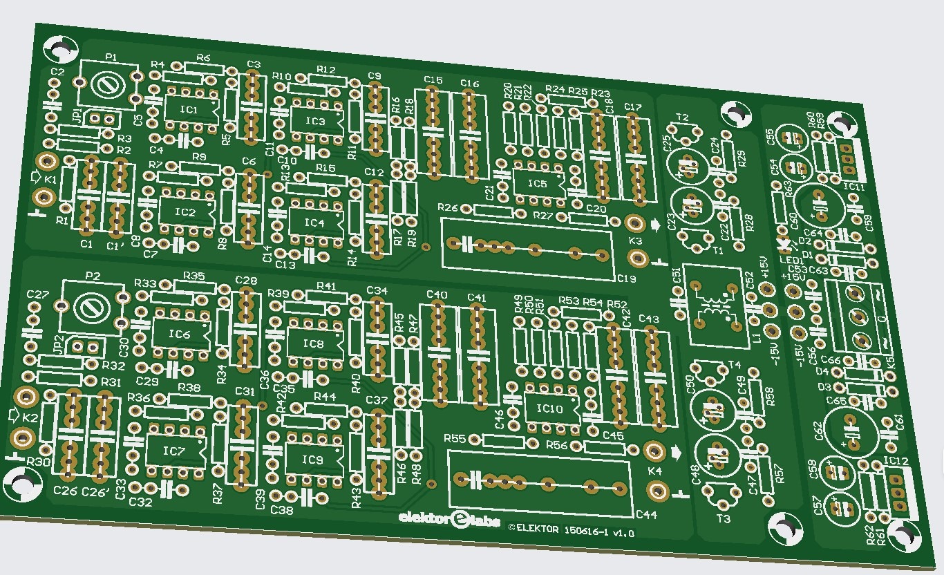

The moving-magnet Supra 2.0, especially the one with LT1028's, is an ultrahigh current noise design made by people who don't understand a damn about noise optimization. Replace the LT1028's with low-noise FET op-amps and it becomes a very decent design.
I pointed that out to Elektor right after they published it (but more politely phrased). They even replied that they would publish my comment, but they never did.

The most suitable single op-amp in a DIL package I can find at the Mouser site is the OPA134. Noise-wise it is fine, its gain-bandwidth product is a bit on the low side for the given closed-loop gain. There would be more choice in SO-8, but then you need adapter boards.

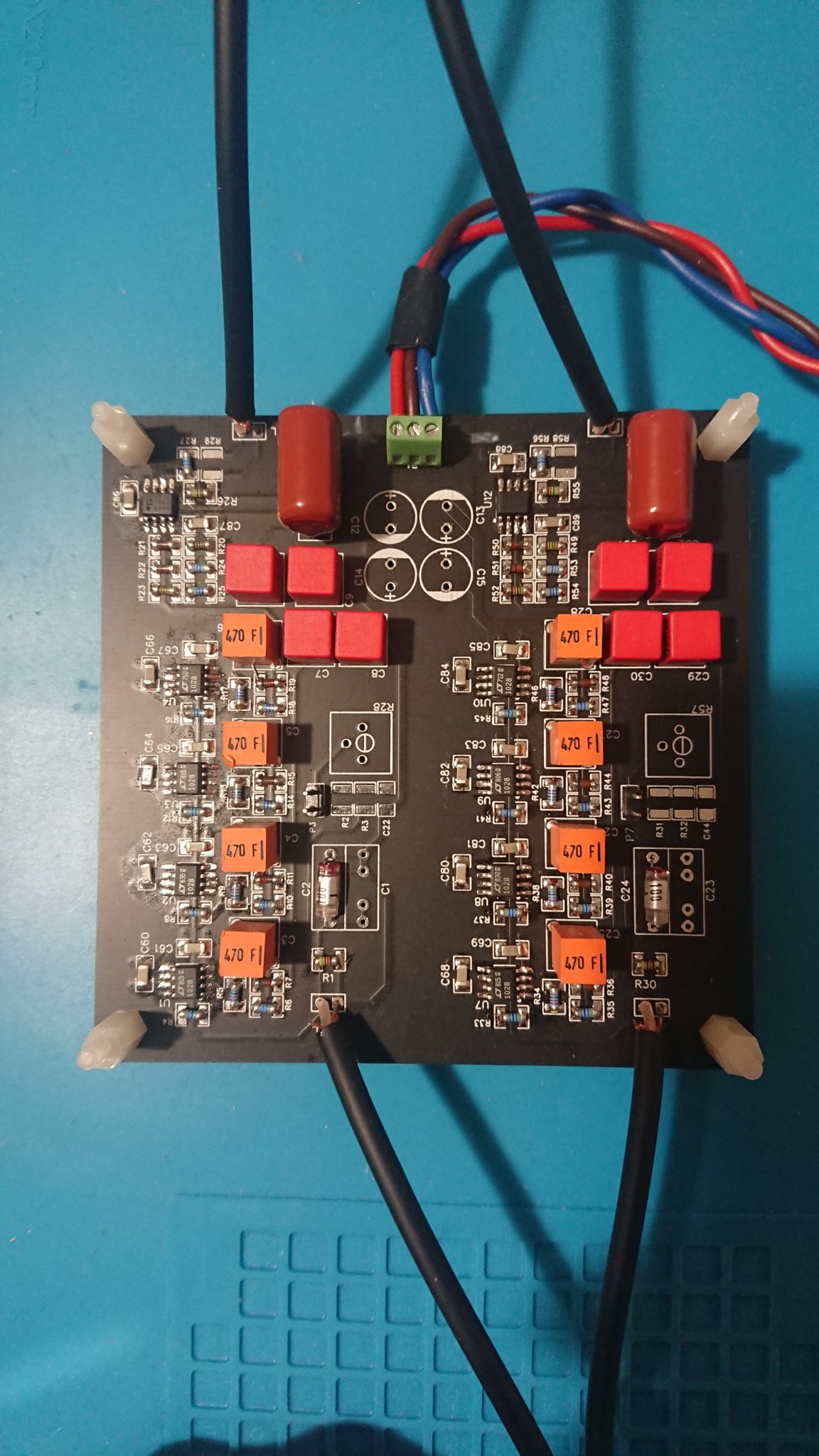

Hi all,
Some time ago I also decided to make a Supra 2.0. I had some problems getting this phono preamp up and running. The problem was the LT1028M, not the AM, as the pcb uses a smd package. I had a high DC voltage at the Op Amp output of about 8-12V. The same problem was when I used an AD797B. At that time I didn't use the DC voltage control on the input of the amplifier because I forgot about these elements while making an order in Mouser, even making a short to ground didn't help. After analysis, I found that Op Amp JFETs would work better here because the source (MM cartridge) is 1kohm and the advantages of LT1028, AD797 are not used here. I used ADA4627-1 and all the problems disappeared.

Because of its huge inductance, a moving-magnet cartridge is effectively a lot more than 1 kohm. See "Noise and moving-magnet cartridges", Electronics World October 2003, pages 38...43, https://worldradiohistory.com/UK/Wireless-World/00s/Electronics-World-2003-10-S-OCR.pdf Mind you, Electronics World drew one of the sections of the gain switch in the wrong state in figure 5 and I mixed up the terms spectral density and power spectral density.
ADA4627-1 is an excellent choice if you can get it to fit on the PCB. The thread starter's PCB seems to use DIP packages.
If anyone is interested in my PCB version, I have 3 more pieces, I can send them after covering the shipping costs. When I ordered a PCB board, the minimum quantity was 5 pieces and now the rest of the PCB boards are left. All my documentation is on EasyEDA and I can share it. I think I still have 22nF 1% Wima capacitors, I don't remember the name of the series, but they are for audio.
