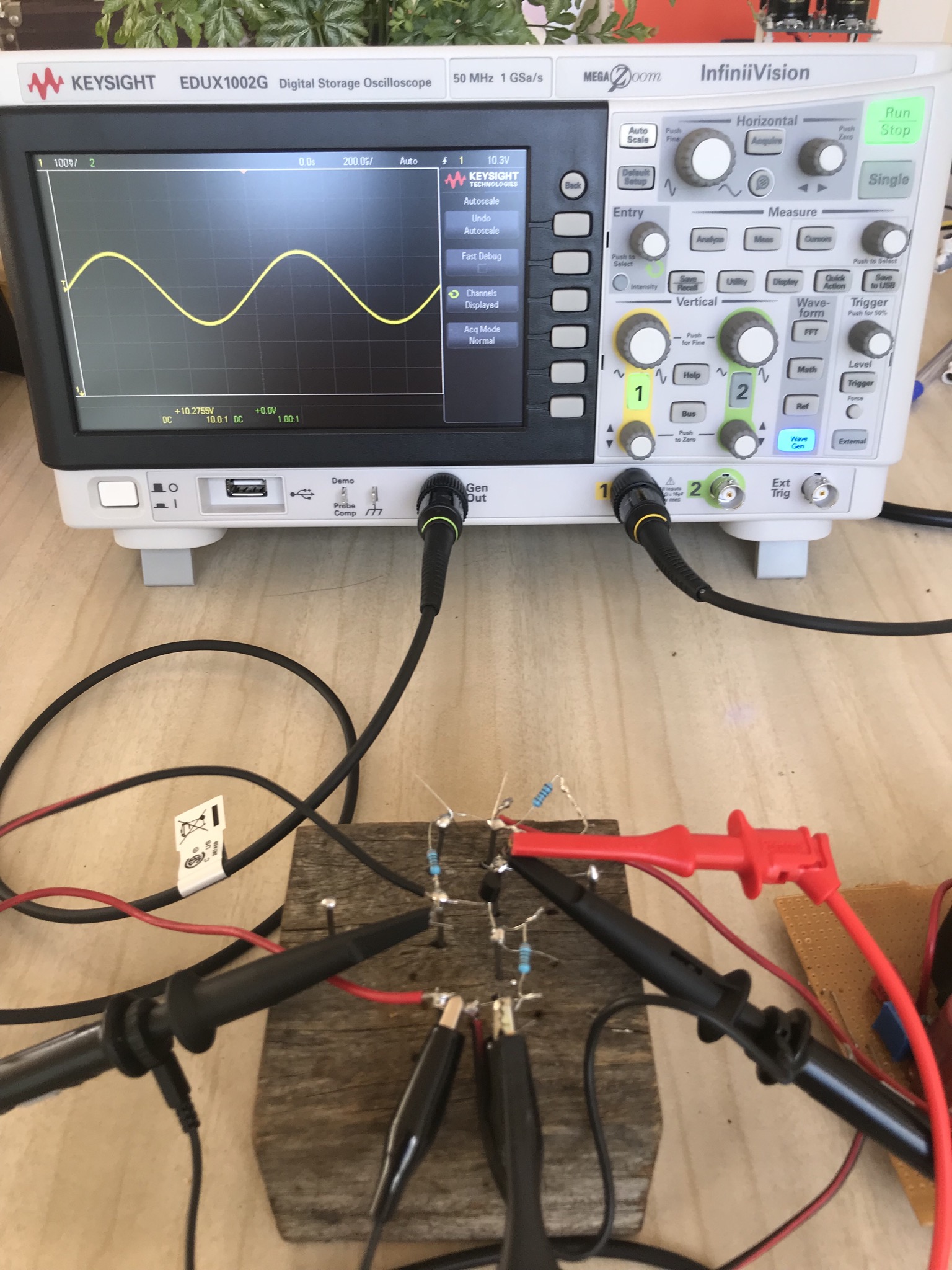

I use a (modded) Rigol DS2072 scope myself (2ch 200MHz 2 GSa/s 56Mpoints). Plus Siglent SDG2042X arb gen and SPD3303S bench PSU. When I worked with a Keysight 2000X at a friend's there was an undeniable jump up in responsiveness, screen contrast and layout, hardware and menu ergonomics, better build quality. Although I could not find the same bandwidth and memory capability in same price from Keysight at the time, the newer 1000X as a package with onboard gen and bode plotting plus superior FFT challenges the sheer value aspect as well. I agree that the Siglent X-E series is the one to go for budget Chinese designed scopes today.
Happy to know you also find it so handy and effective because I originally suggested and encouraged Bix to get this as his first but more complete and better lasting scope although its in a price range beyond his initial target.
By the way, what max dynamic range it offers for FFT in practice?
I’m happy with my purchase, and very grateful for your time and advice. Now I just need more time to put it to good use. I have however got one channel of my FSP running and it sounds sweet!

the Siglent SDS1000X-E series relies on the capabilities of two 2-channel ADCs and a Xylinx Xinq 7020, so its rather a 2+2 channel scope than a 4-channel scope.
The double ADCs allow for 1Gs/s in 2-channel mode .... same as a typical 2Gs/s, 2-channel scope.
The Xylinx combines a powerful Process System and programmable Logic in one Chip, with more bandwidth/more data throughput than with separate devices.
That is a comparable technique to the asic chips the big names use in their upper level devices.
And Rigol btw just released their Phoenix analog frontend chipset, targeting the mid- to upper range scope market.
