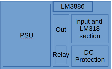

If I were you I would not hurry with the second layout. Take your time, try different strategies, may be even change the layout drastically. Attached is the idea of an easier to route layout which would also be easier to place inside of narrow chassis along the heatsink.

Do you really think it's that bad? I think we're talking about marginal improvements here (right next to the "point of diminishing returns"), and not about crap vs. useable...
IIRC Russ pointed out that he placed the relay as far away from the LM3886 as possible for a reason. Don't remember what it was exactly, but it must have had some detrimental effect if the relay was placed close to the IC.
If at some moment I get to know that the design I use is not optimal I feel the need to improve it I am not saying bad, just not optimal is enough to lose sleep for me
If that's all... I can live with you losing sleep over my layout!

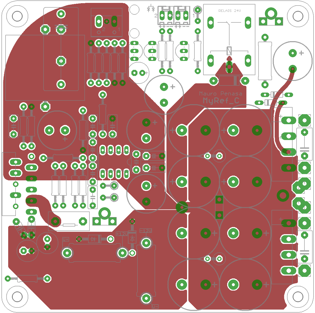

For the best performance, you need the reference/input ground to connect to the power ground at the speaker output ground connection. You can read my rationale for this, as well as see the simulations I use to back up this claim, on my Taming the LM3886 pages. You'll note that AndrewT makes the same recommendation ad nauseam.
Secondly, use the available copper. The board fab charges the same whether you use the copper or not, so I really don't get the idea behind the complicated pour shapes and snaky traces. This goes both for the supply routing and the ground routing. The layout shown in Post #55 gets one of these right.

Regarding magnetic coupling through relays, I suggest reading some relay data sheets. Pick a relay with good isolation between the coil and the contacts. Alternatively, pick a relay and measure the coupling. This is trivial to do with a computer sound card and some software like TrueRTA. I bet you'll find that it is very, very hard to couple anything into the output node of the amp at the frequencies relevant to ripple (48 Hz to a few kHz).

I'll consider this for the routing-remake V.2 TM.
Yeah, but how shall I do that? Obviously I can't put all those parts physically into the same space, so there has to be some copper in between. Okay, one point is to move the relay closer to the IC to shorten that track. What about the layout from post #60? Is that better already than that from #55? What if input ground plane and output ground plane were put together as one plane and connect to the power ground plane at one point? I've read all your suggestions several times now, but it still leaves me with some uncertainty.
I tried to resemble Tom's simulations with the MyRef-schematic and generic models in LTspice. The only thing that really makes a difference is connecting GND_SIG directly to GND_SPK, just like his website proposes. Thus it seems best to include the speaker relay pin into the signal ground pour and then route a trace from that same relay pin to the power ground. The star ground that I've laid out on the fabricated boards simulates rather bad in comparison .
