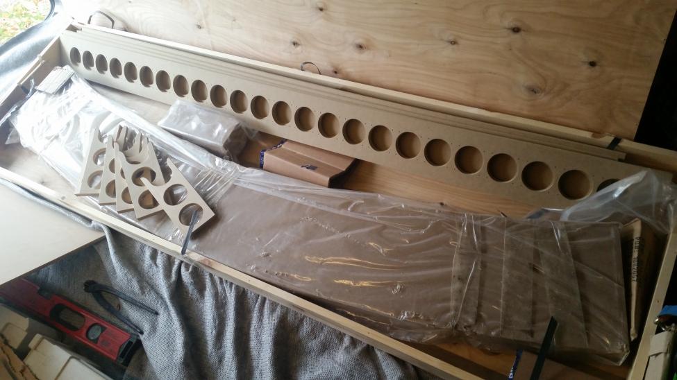

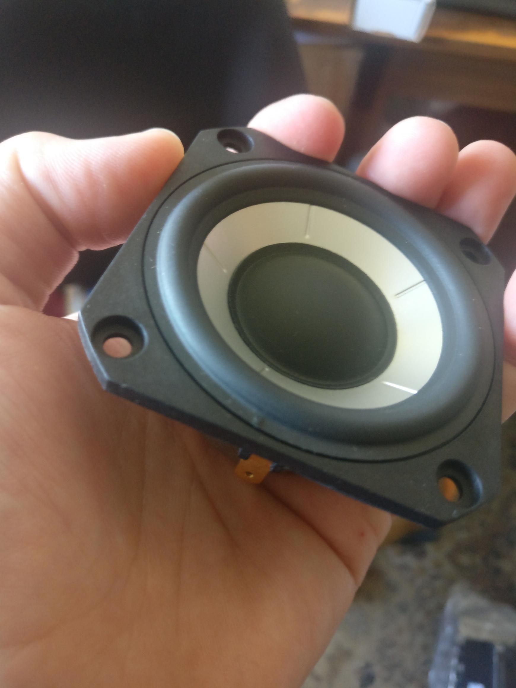

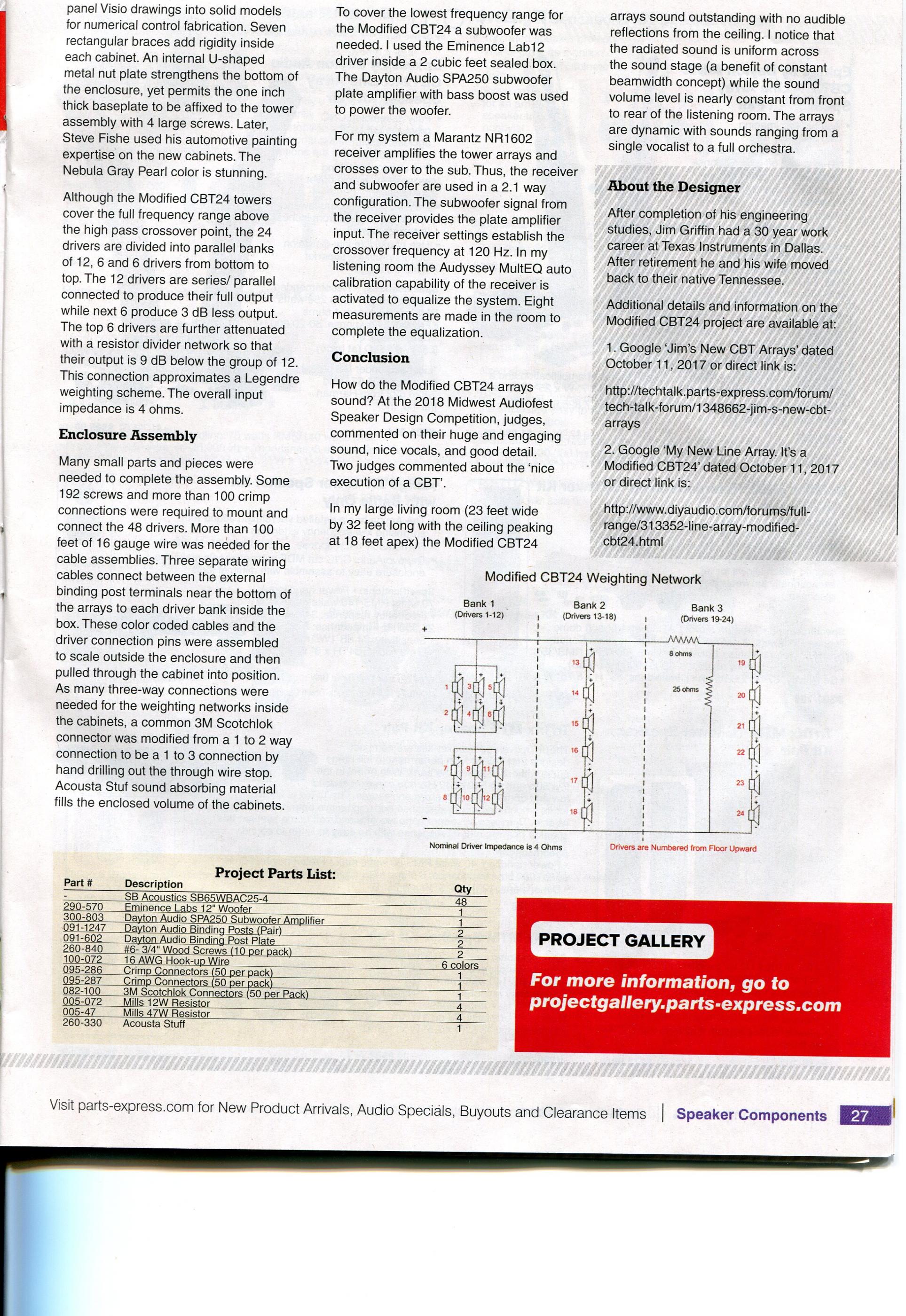

I supplied Parts Express with a write-up on my Modified CBT24 design for their September edition of their Sound Solutions brochure. Volume 9 of the Sound Solutions was mailed to customers a few weeks ago and that information should eventually be saved at:
Sound Solutions
I have scanned and attached my design description for your reading.

Concerning the parts list in the write-up that I did for Parts Express (see message #89 above), there was a mix-up in the final editing by P-E. As listed the resistors for Bank #3 are incorrect. My requirement for these resistors was 8 ohms and 25 ohms resistors in each speaker. The power rating for the two resistors needed to be 20 watts or greater for this application. As I wished to use Mills resistors (which have a nominal 12 watts rating), I decided to use a parallel pair of two resistors for each specified value. Ideally, I wanted to use two 16 ohms resistors for the 8 ohms value and two 50 ohms resistors for the 25 ohms value.
Now reality sets in: P-E did not carry either 16 ohms or 50 ohms values in their Mills resistors stock. The closest values stocked are 15 ohms and 47 ohms. Thus I used these values in my speakers. These values are close enough to the spec values (about 6% tolerance) for application in the CBT.
