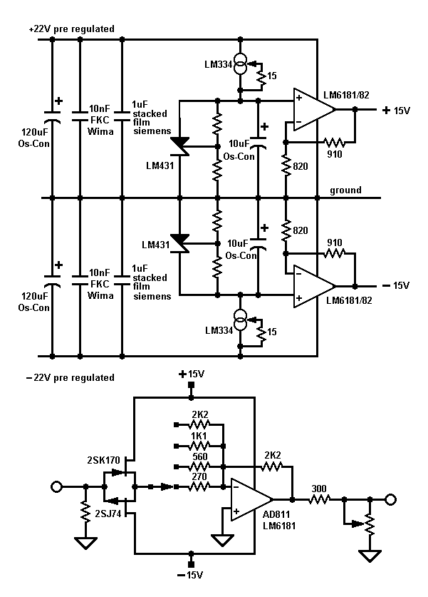

Re: gainclones...
dorkus said:> i am seriously considering using the chip in inverting
> configuration a la Thor (hence my inverting amp thread
> a few weeks ago)
Followed all of this and it did part of making me post....
> but i have some concerns with the compromise between
> feedback and input impedance.
As mentioned in the original inverting amp thread, there are ways around this in the feedback loop.
Another option which I prefer is to simply preceed the inverting mode Amp (or preamp) with a complementary J-Fet Buffer, pretty simple really. This gives you an input impedance of up to a few Megaohm (or even more if you bootstrap the input) while retaining the advantages of the inverting mode.
> i don't want input impedance any lower than 20k or so (i'm using a shunt attenuator before it)
It makes me wonder why?
How about ditching these awfull resistive attenuators that steal at least 10db subjective dynamic range and going transformer attenuator? Drop me a line to see if we can fix you up..
> i'm also unsure of the need for all the extra capacitors shown
> in the Thor schematic.
You can do without many of these. One of the things my schema does is to go "belt and braces". I don't want anyone to build this and find it to have loads of offset and fry speakers, oscillate and fry speakers and so on.
I suspect removing both the input coupling cap and the cap on the non-inverting input will improve the sound.
In case you use a low DCR volume control (like a transformer) you can simply connect a parallel connection of the two resistors for feedback on the non-inverting input to ground. This will both dynamically and statically balance the inputs, removing not only common mode distortion but also killing the distortion caused by the base current modulation with signal in BJT's (one of the reasons why J-Fet Inputs are better).
I can think even of a really interesting bridged Amp using LM1875/3875 and co which would use a variation of the Tom Evans version of what I'd call "feed along" erroro correction.
Here both Amp halves would be inverting, with each opposite halves positive input connected via a voltage divider. As in an inverting amplifier the actual appearing voltage on the inverting input is directly proportional to the difference between input signal and amplified output signal, amplifying this signal and feeding it with inverting phase into the speaker would cancel the distortion.
> i've heard good things about AC coupling the input
I have not, other than that it limits what can go wrong. And unlike Vlave Amp's, when solid state amp's go wrong they often take along the speakers, despite fitted "speaker protection" circuits (the relais have a tendency to arc and thus fuse closed when trying to disangage).
I would recommend to start with all belts and braces in place and later to simplify the circuit if you feel it neccesary. Also, careful choice of the capacitors (I like Foil & Film or metalised Film Polycarbonates for solid state best) can adjust the tonal balance (I prefer changing valves to that of course).
> i think to properly use this chip in inverting configuration, you
> will need some sort of preamp or buffer before it or
> dynamics/noise/distortion performance may suffer.
You may be right, assuming you insist on high input impedance for no particluar sensible reason....
I have attached a copy of a Linestage that uses a similar principle of buffering....
> i'm not so sure about the low capacitance supply thing.
I am. I now also use something similar in my Valve gear. Big cap's mean big problems. Small Cap's mean small problems. Many Small Cap's mean many small problem which tend worse than one big problem....
> other design touches... resistors will probably be IRC tantalum
> chip if they prove to be good-sounding
I like them okay, prefer NI wirewounds.
> i will use a zobel on the output (10ohm + .1uF), along with
> a little bit of series inductance (a few turns of 16 gauge OFC
> magnet wire).
Do yourself a favour - try it ALSO the other way. It may surprise you.
> one thing i'd like to try out is putting a small capacitor on the
> secondaries, before the rectifiers, to reduce RF noise...
Carefull. This tends to form substantial tank circuits with the secondary and/or leakage inductance that ring very well, especially if "kicked" alive by the switching pulse of the diodes starting to conduct.
> a form of AC conditioning you could say.
Yes, you could say it "conditions", though perhaps not entierly in the intended way.
> a good 0.1uF polypropylene would do the trick.
Yup, that should put the ringing nicely low in frequecy with a nice Q to make it never stop ringing.... ;-)
> the biggest obstacle at this point is getting a nice chassis for it.
> another idea i've had is use multiple LM3885's as amps for an
> active loudspeaker.
Good idea.
But in this case consider switching from driving the speakers with undistorted voltage and thus forcing a heavily distorted current (which is after all what moves the voice coil) to driving the speakers with undistorted current which kills several types of distortion and compression in the common speaker drivers quite effectivley. This of course implies the need for a non-reactive rear load to the Low Frequency driver....
> e.g. the speaker i'm using now uses very simple 1st order
> crossovers... would be a piece of cake to incorporate the
> filters using either input or feedback caps on the amp chip.
I'd say feedback for LF and input for HF....
> i think with a nice speaker, the sound could be excellent.
Yup, not that many "nice" speakers exist these days. The so-called "HiFi" drivers are universally somewhere between not very good (some really well respected names go here - all scandiavian) to awfull. And the emphasis in Pro-Drivers for high output capability before anything else compromises these units as much where ultimate fidelity is concerned, though some exceptions still exist.
Anyway, have fun and feel free to either drop me a line or to just consider to switch to antique horns and SE Valves (more milage in that anyway)
Sayonara
Re: Re: gainclones...
hi kuei yang,
thanks for the interesting post and suggestions...
simple really.
was thinking of doing this, but the problem is power supply complexity. the JFET buffer does not have nearly the PSSR of the amp chip so it would end up being modulated by the current demands of the amp if used on the same supply. an option is to use a regulator or a separate xformer secondary/rectifier circuit, but this makes the supply a lot more hassle. the appeal of this chip is the utter simplicity of implementation after all.
i have heard a good thing or two about xformer attenuators but don't know much about them. maybe i could give one a shot.
assumming i do not use an input transformer, i have to maintain high input impedance to avoid loading whatever's driving it. this amp is not for my own hifi rig but for a nice compact 2nd system and will most likely be driven by a portable CD player or similar device.
i like mills wirewound very much but with all wirewounds there is the issue of volumetric efficiency.
whoops. i knew there had to be a reason people didn't do this. maybe i'll skip this then.
i'm not sure how you distinguish "voltage" distortion from "current" distortion. what exactly are you referring to?
no offense but i am not a fan of either tubes or horns. i can enjoy tubes if they are neutral (most are not, particularly SE variety). horns i can not listen to. before studying EE i was a musician (violinist), attended conservatory for 5 years (see my profile). in particular i participated in orchestra rehearsals every week so i am familiar with the harmonic structures of a wide variety of instruments. i know what the sound of live instruments is and tubes and horns distort it to my ears. to me tubes sound nasal, and horns only make that worse. i heard some SE tube/horn combos at a couple audio shows and came away with a bad taste in my mouth. sorry.
as a sanity check, go to a orchestra concert or rehearsal, then compare that to what your system sounds like. granted my system doesn't sound anywhere near realistic but it doesn't deviate from realism in the same sort of colored fashion tubes/horns do. i admit tubes can sound very alluring and euphonic but it simply isn't realistic - real acoustic sound isn't always that sort of ear candy. just my humble opinion.
