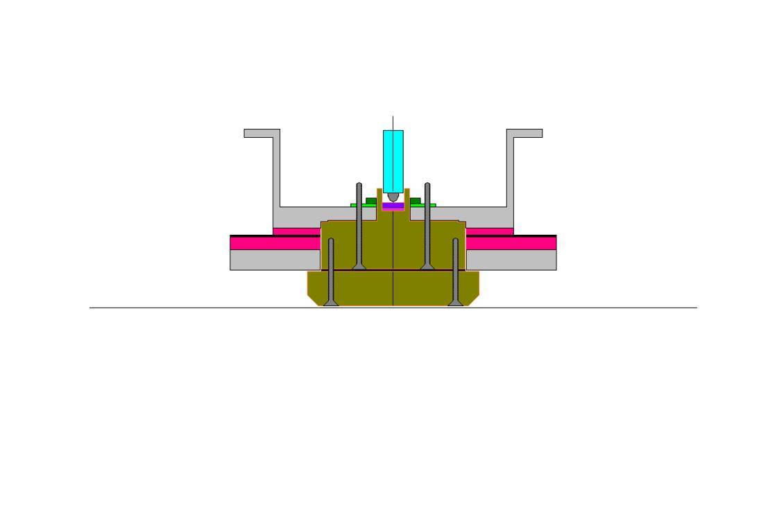

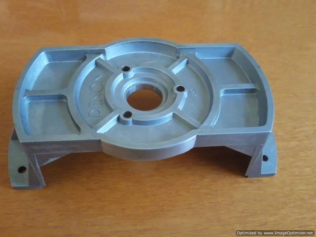

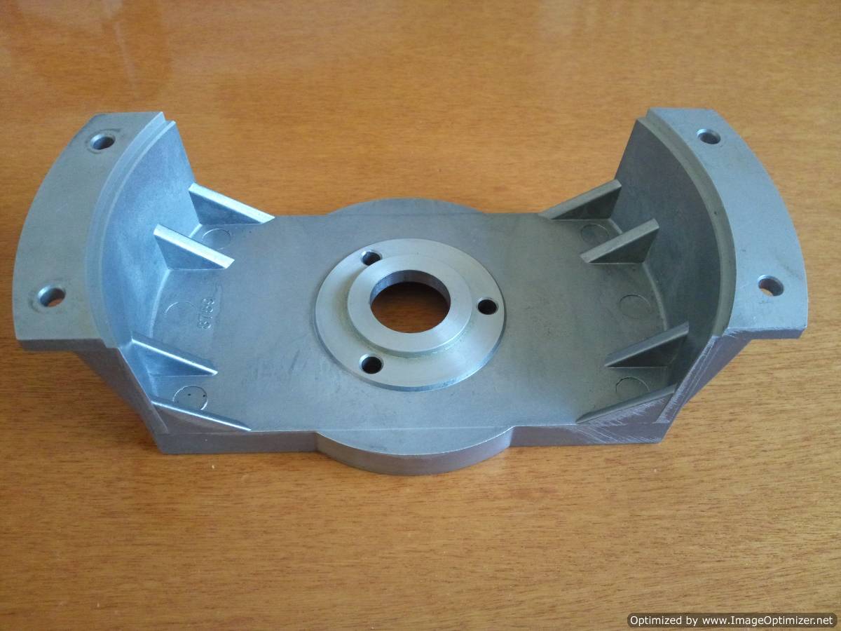

I had decided on the way that i was going to modify the original U part that supports the motor.
The whole thrust plate area was to be ommited and new one would be attached to the U part.
This time it was a teflon thrust plate and a ceramic ball twice the size of the original one.
Under the teflon a layer of medium hardness silicone was used to provide a level of
compliance to the system.
All this was to be placed inside a massive round block of bronze that would go through the original underside bowl and the bottom aluminium plate.
The bronze was to form a "bathtub" for oil up to the height of the ball- everything completely immersed in it.
On the first bronze part, another massive piece of bronze (ballast weight) was to be attached with an intermittent flange
of sorbothane to quiet things down even more.
All this would hang about 1 mm over the turntable's resting platform.
I had to make exact measurements for all these and so i had to test assemble the whole thing together.
It looked nice.

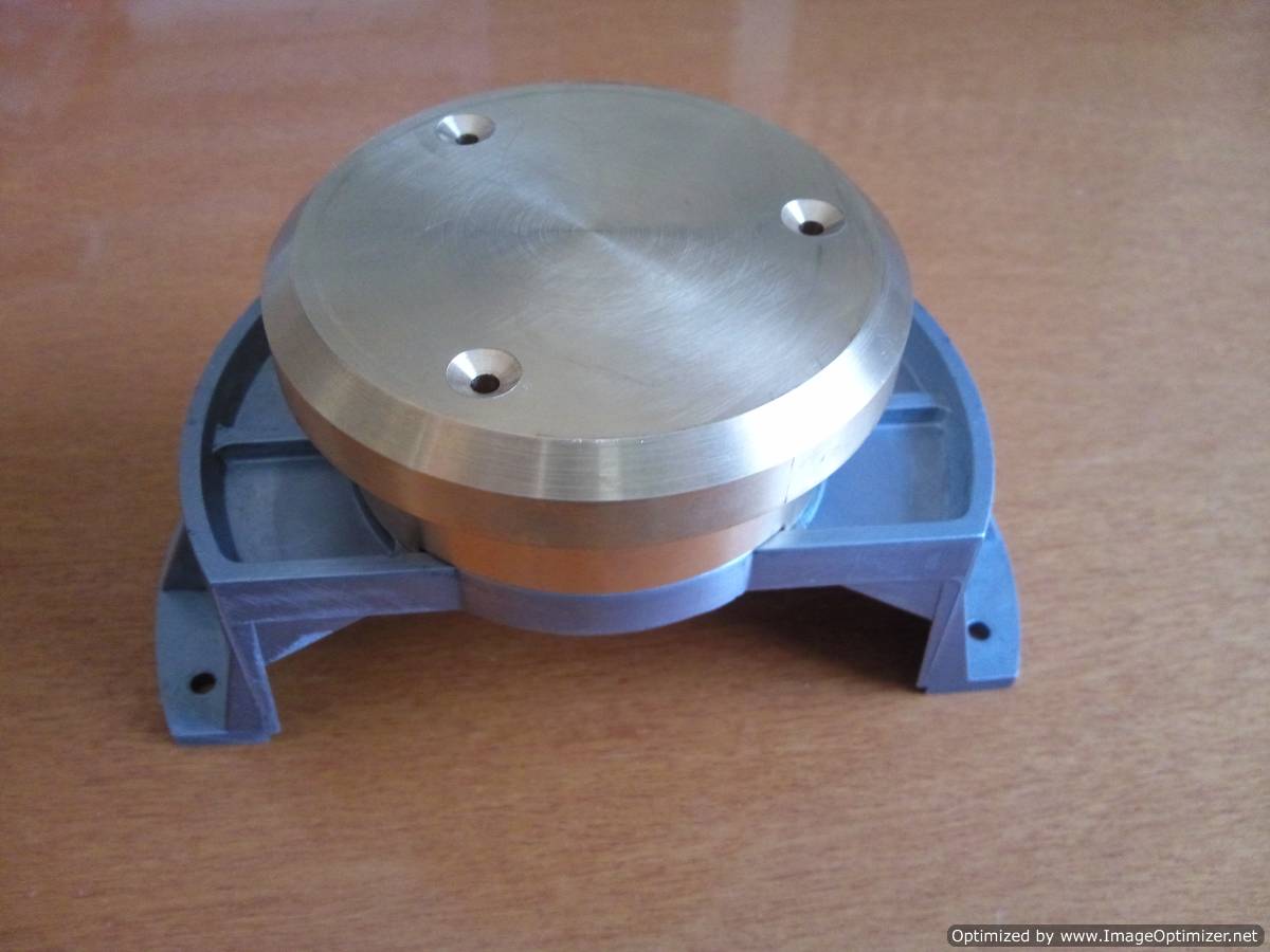

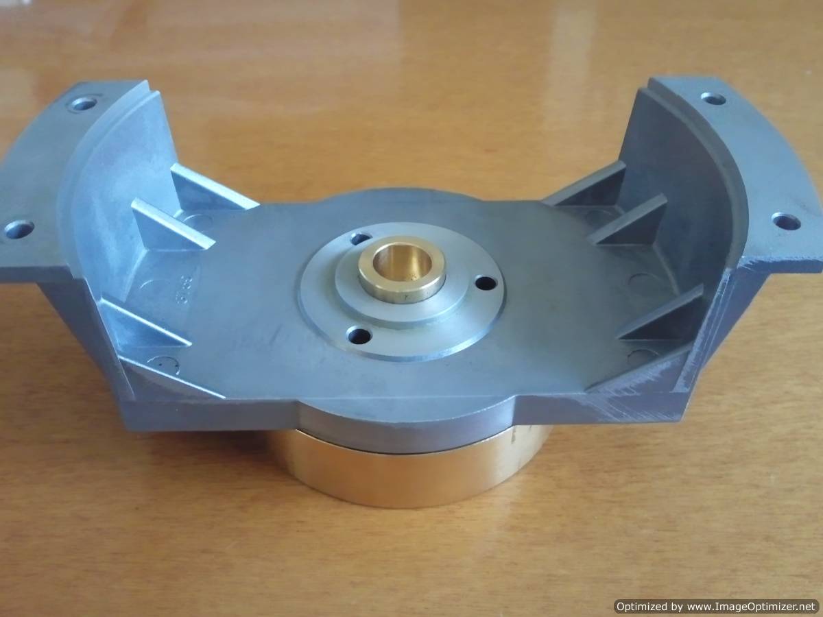

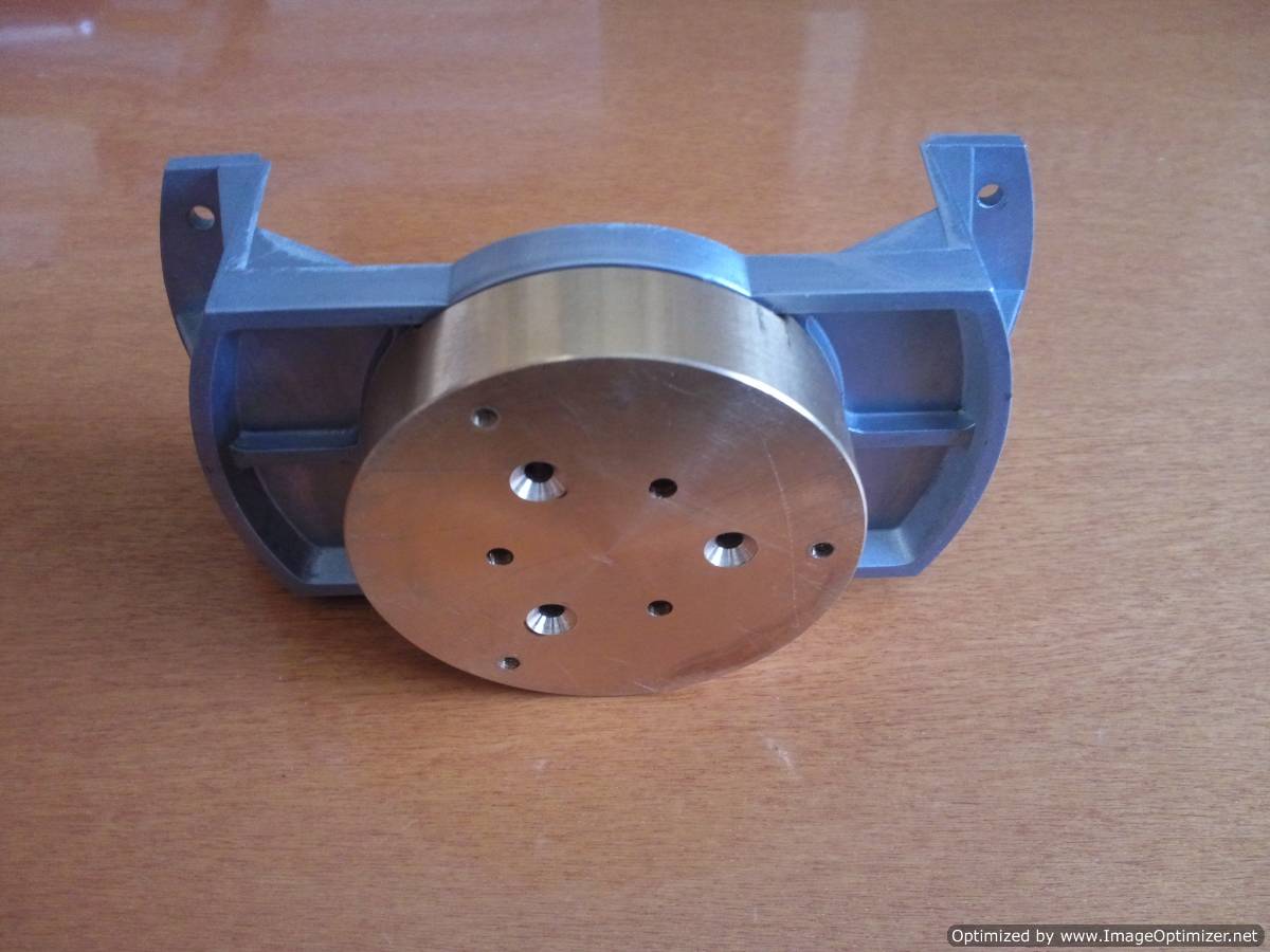

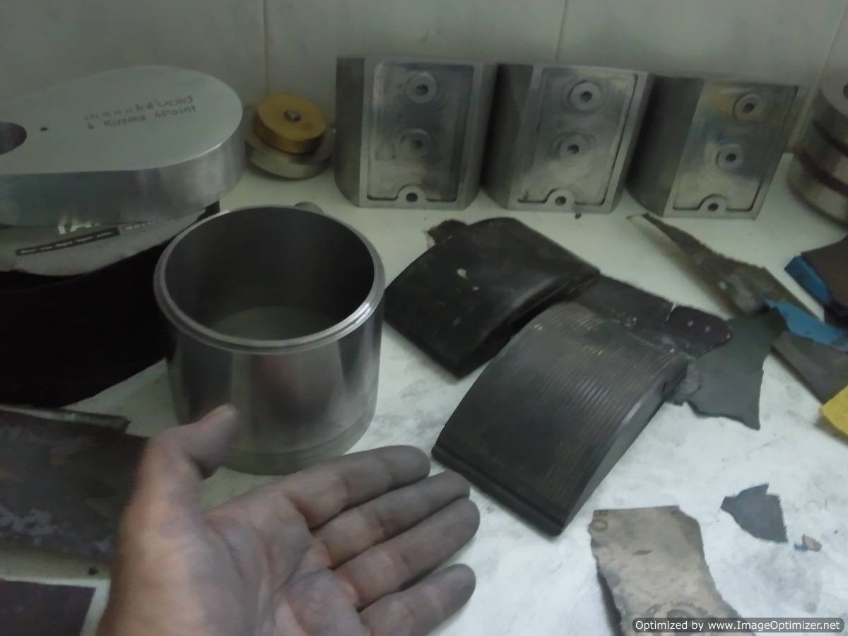

I knew it was a bold move because if something went wrong i would be left with an unusable turntable but stuck to my intentions and sent it out to the CNC and prayed for the results.
A week later i had the pieces in my hands and -thank God- everything went as planned.
The U part was cut carefully and out went the original thrust plate but enough
of the original was left to press the rubber seal securing from oil spill.
Two new bronze pieces were cut, one to substitute the missing part
and form the place for the silicone/teflon/oil tub and another to attach
on the previous one just to add mass to this critical part of the turntable.
Here are the pics:

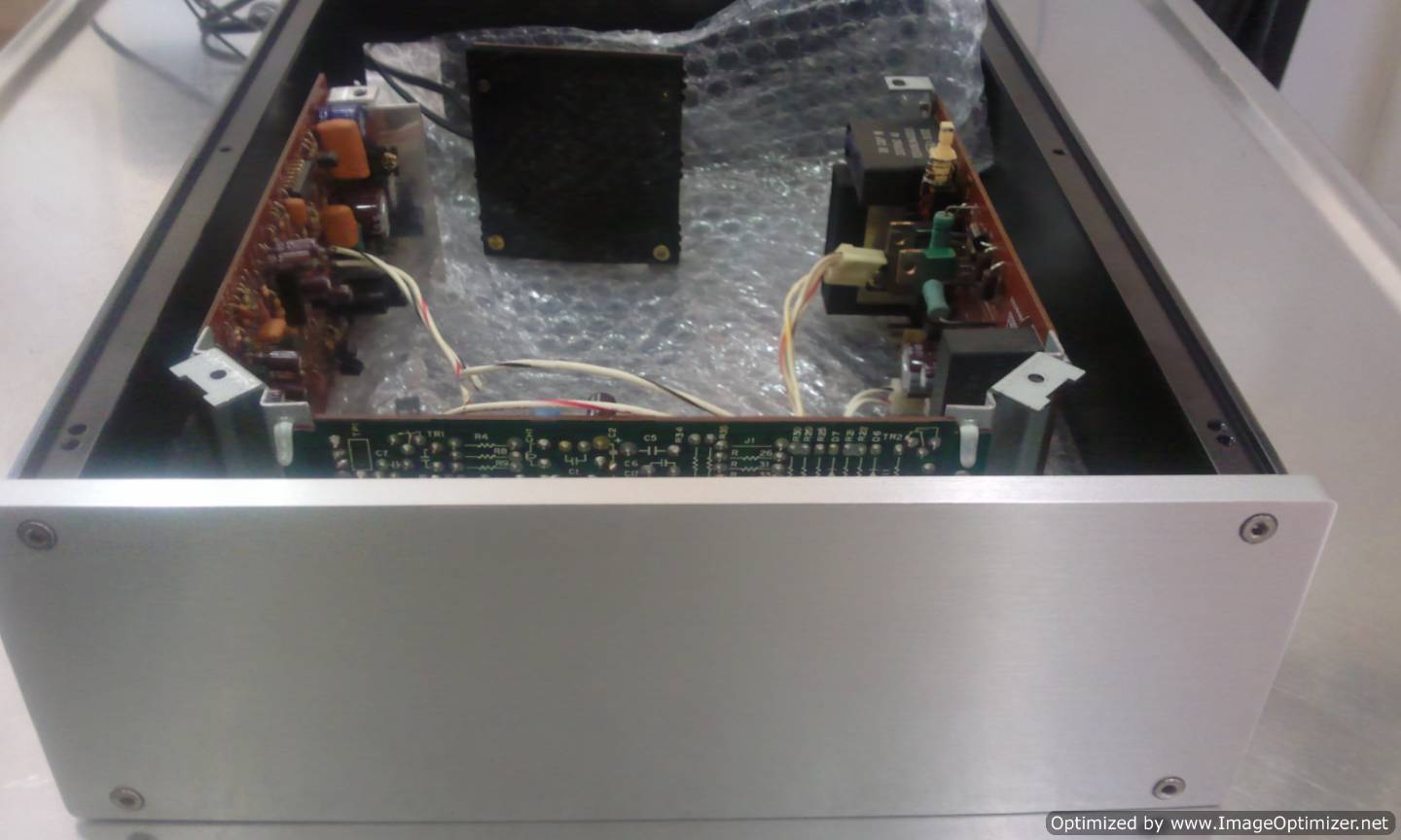

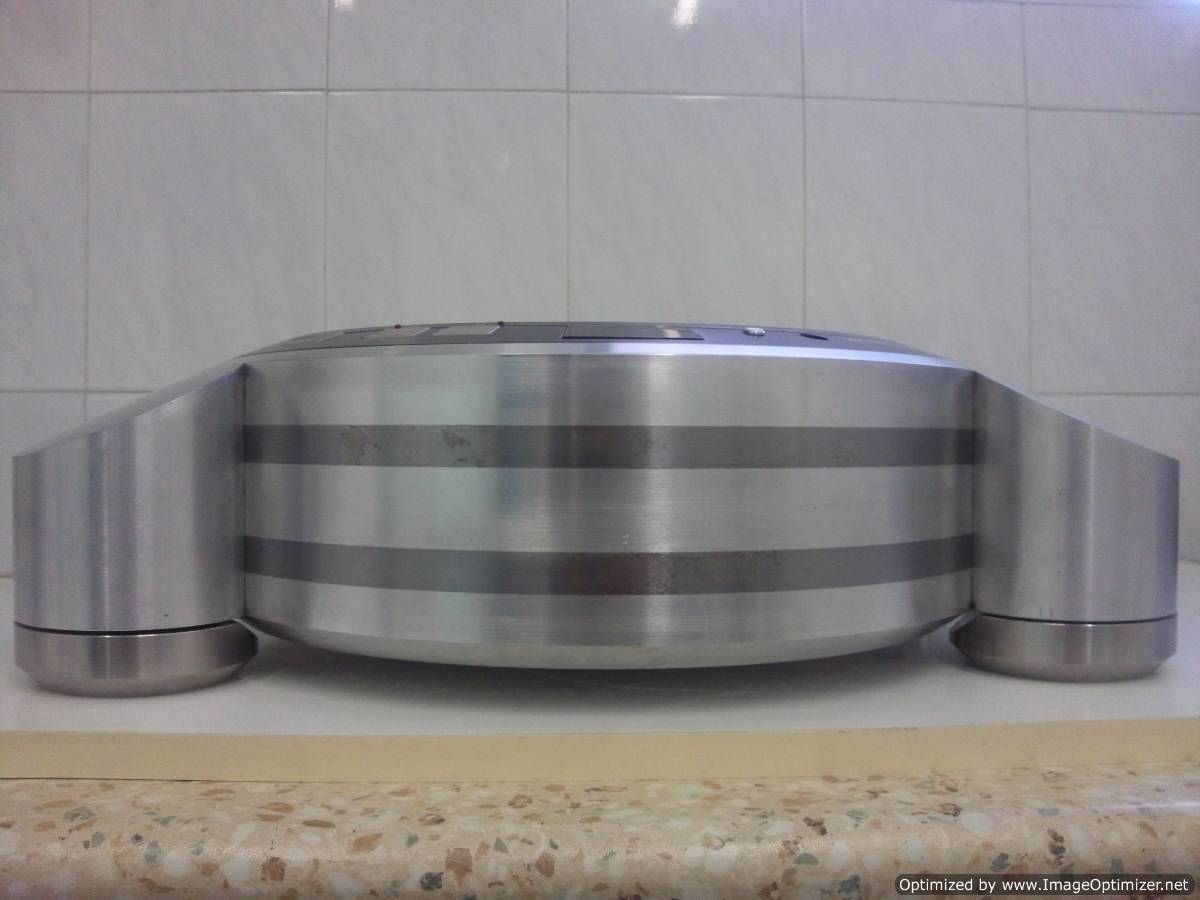

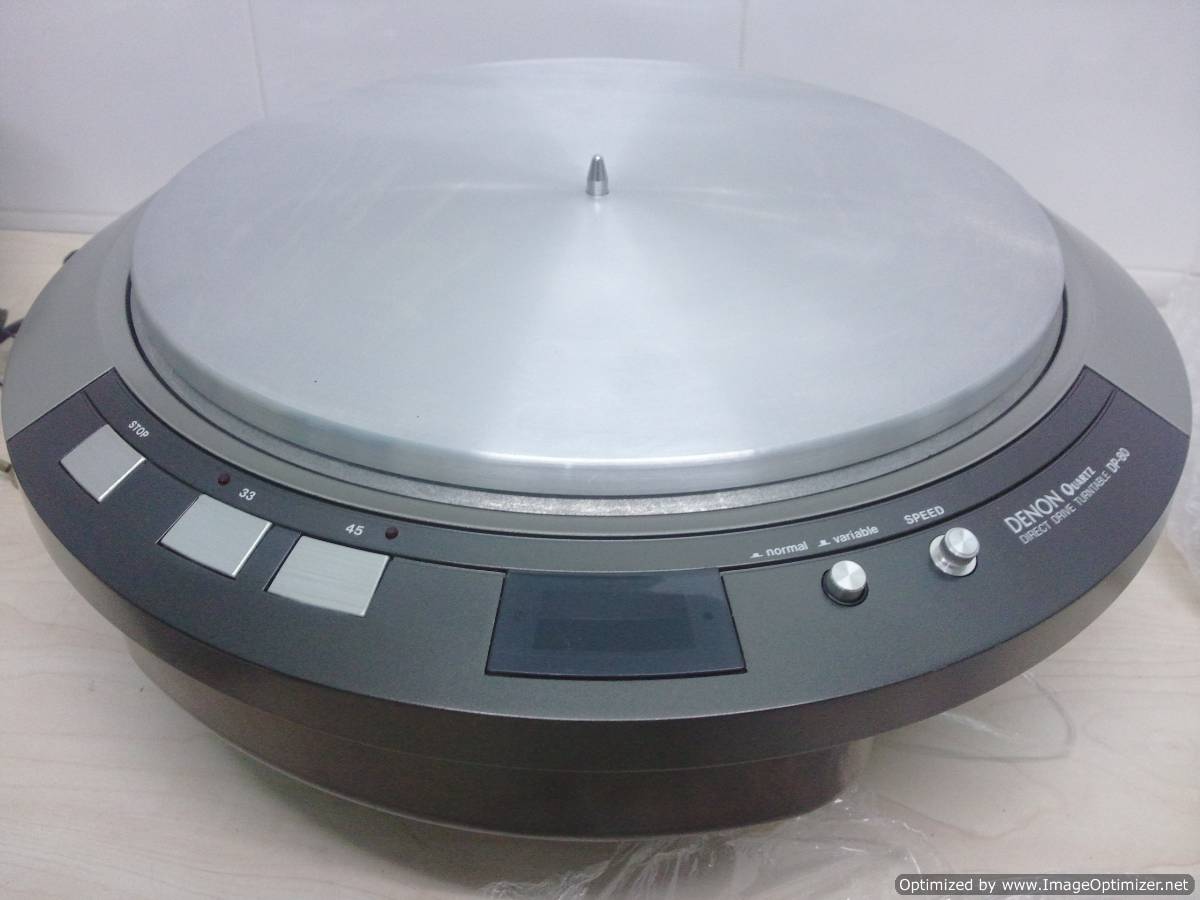

The all aluminium box arrived and looked pretty good.
It had 4mm thick panels all around anodised in black and a nice 8mm thick
front panel anodised in natural silver color.
The fascia was to be modified to my tastes as i wanted things engraved and the 4 screws hidden...
but it was okay for a starting point.

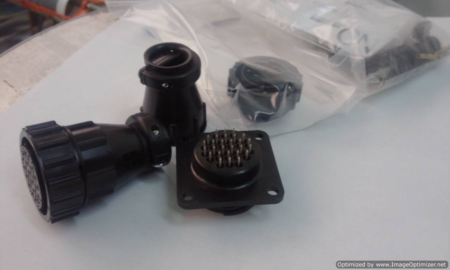

I had made the order on one that could take the whole Π shaped
board assembly as it was placed in the DP's underside plus enough room

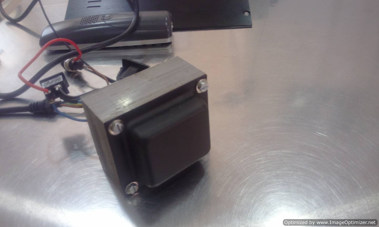

for an 80 Watts down converter to 100 VAC, a new bigger transformer to power
up the motor and electronics plus a generous AC filter.
A massive umbilical cord would exit the bottom of the turntable and fit
to the back of the control/PS box with a twist/lock multipin (28 contacts) connector
with gold tipped contacts.
I had made my orders and things started to gather in...

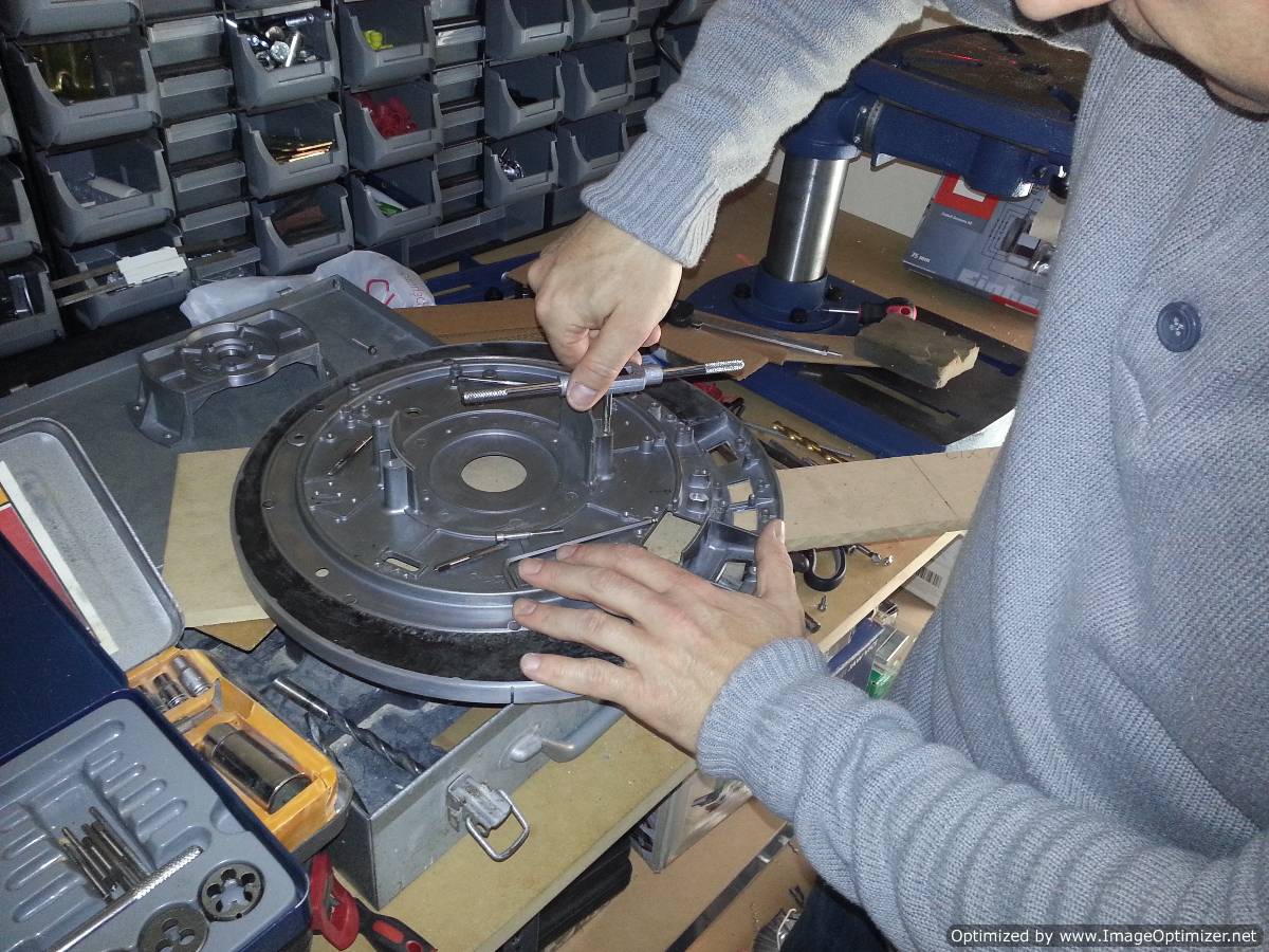

Don't think that everything can be done by machines.
Since it's a mix of the old and the new, many times the process seeks the human labor to make everything fit.
For example parts need to be sanded down, and drill tap and die needs to be done to fortify specific areas that were not supposed to hold the mass that they do now...
There is a lot of my sweat in the details...

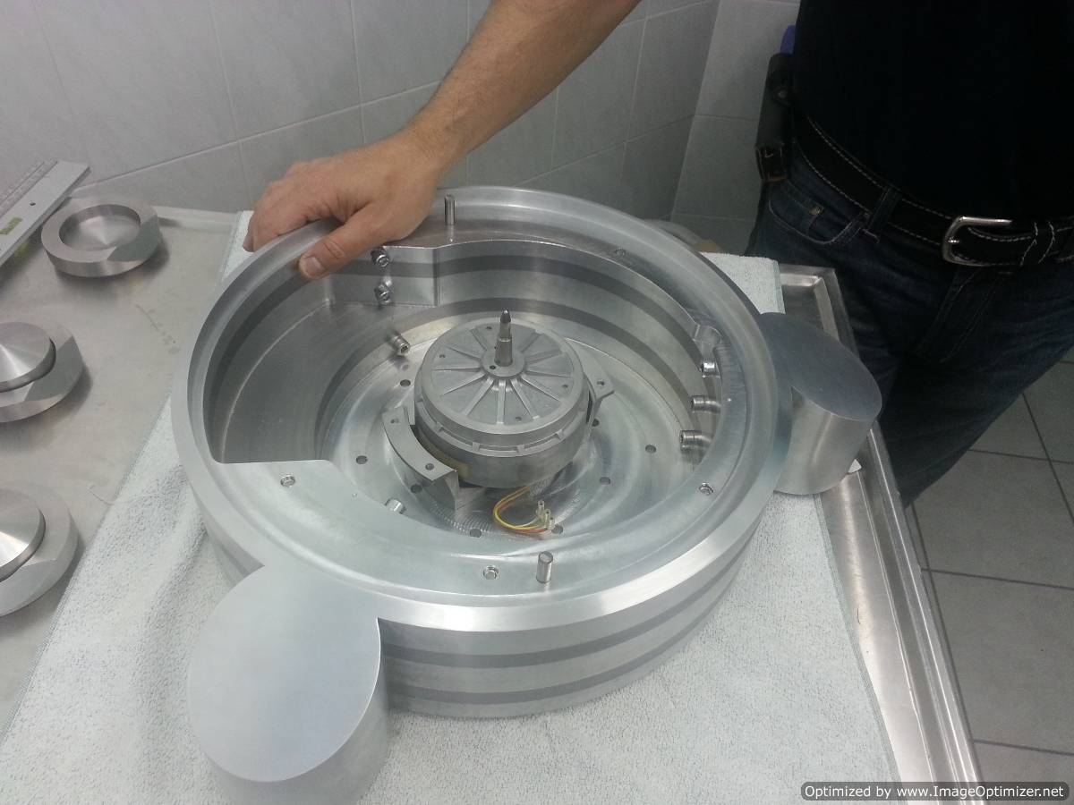

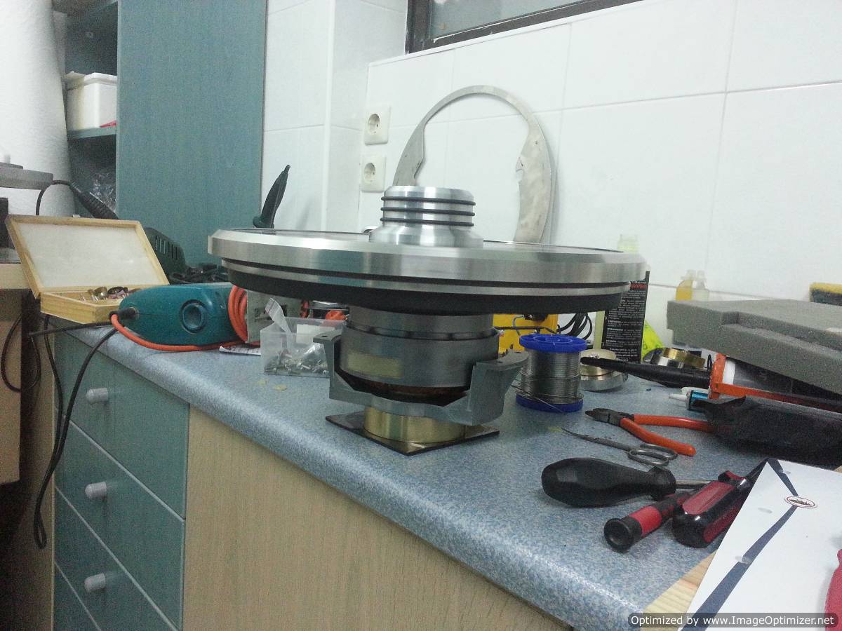

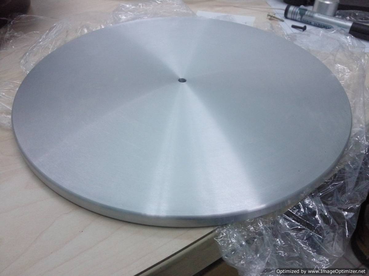

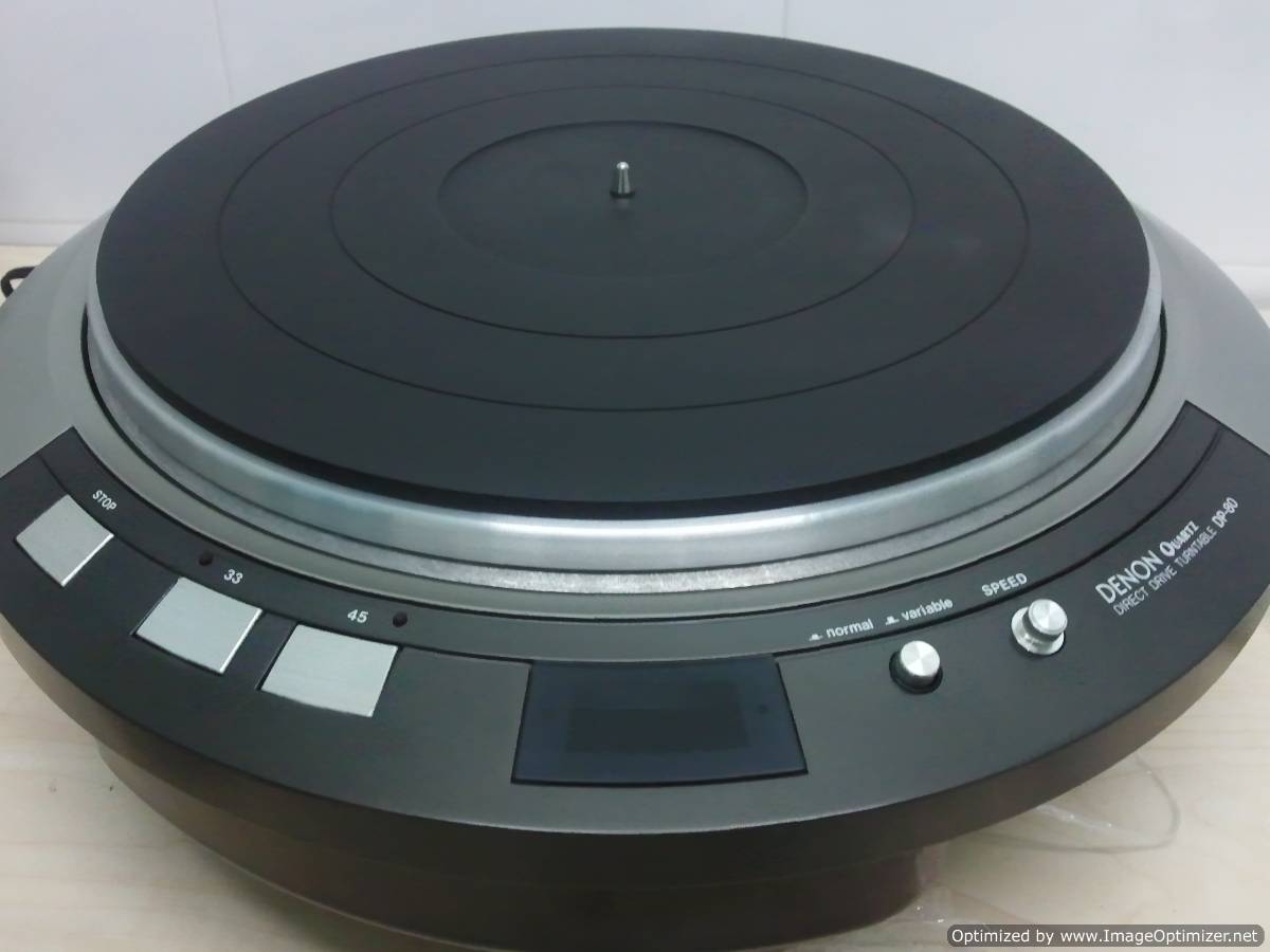

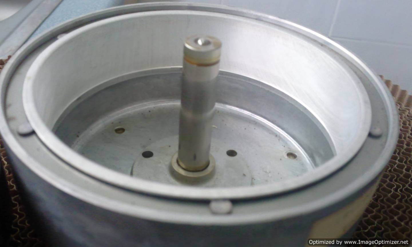

I had a plan about using a periphery ring but the original platter was too shallow
for a competent design.
So i thought about an extra metal mat that would give me enough height to use a periphery ring.
I was aiming at around 2000 grams weight and i needed about 10 mm raise.
I designed it with a curved top edge so that the periphery ring would fit easily on it.
Here's what i got:
Now it was time for the periphery ring.
I designed one out of inox steel and i wanted to keep it under 1.5 kilos.
I had to take into account the extra metal mat as the ring would position itself
by "hugging" around it.
Plus i wanted it to look as an integral part of the turntable so it's external diameter would be up to the point of the dark grey area surrounding the buttons.
I tried to position most of it's weight under the LP level to aid spindle stability.
It came out pretty good and it's weight was right up to 1350 grams
This is what it looked like:

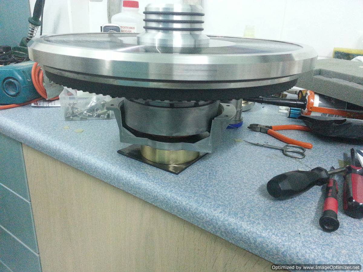

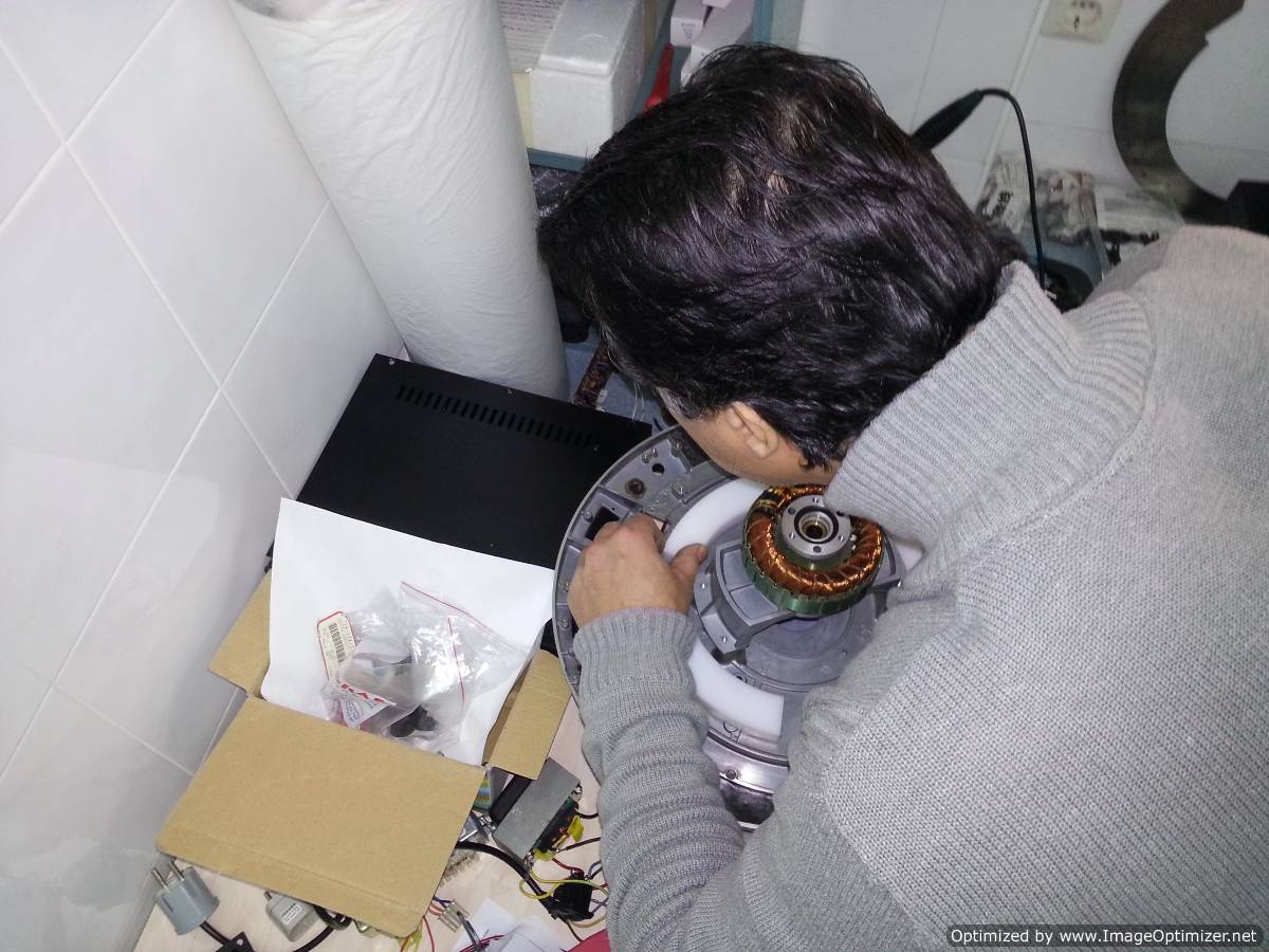

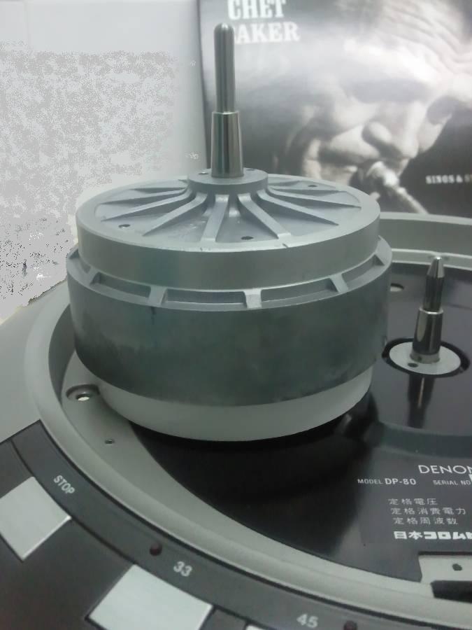

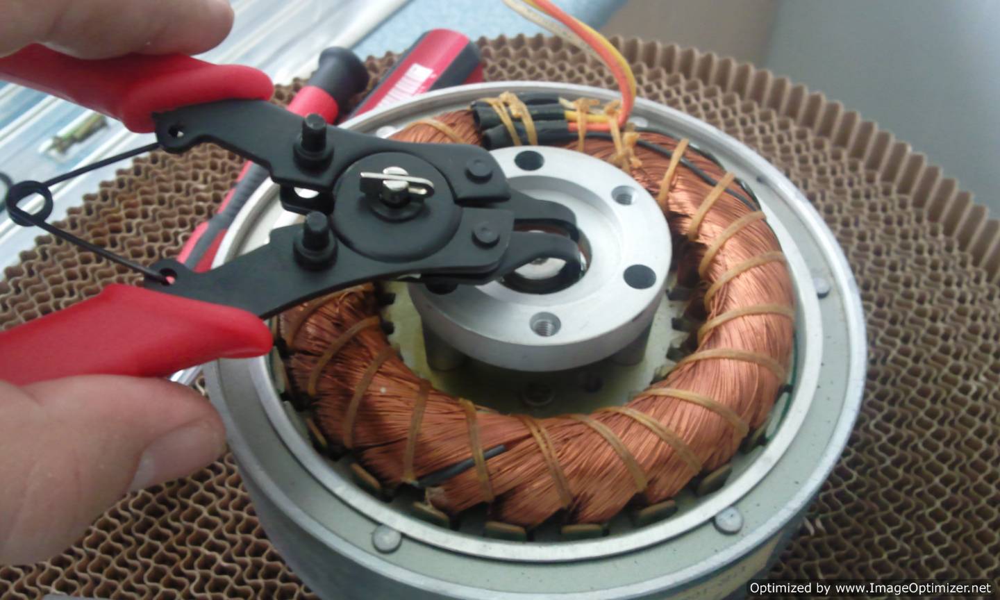

All looked nice and tidy with new metal mat and periphery ring.

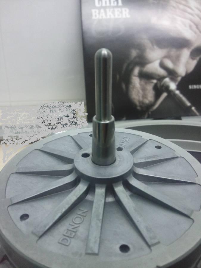

However the increase in thickness of the whole platter eliminated the
protruding spindle for the center of the LP.
That meant that the center axle had to be elongated.
I wanted it a good 10mm longer to clear the record and help the positioning
of a record puck.
So, out came the rotor part of the motor and went for an "add on" job.
It was carefully cut at the point it starts to get conical,
a long hole (about 1.5cm) was cut into the remaining part and the new longer part was tightly inserted.
Now i had the height i wanted.
See it in comparison with the original:

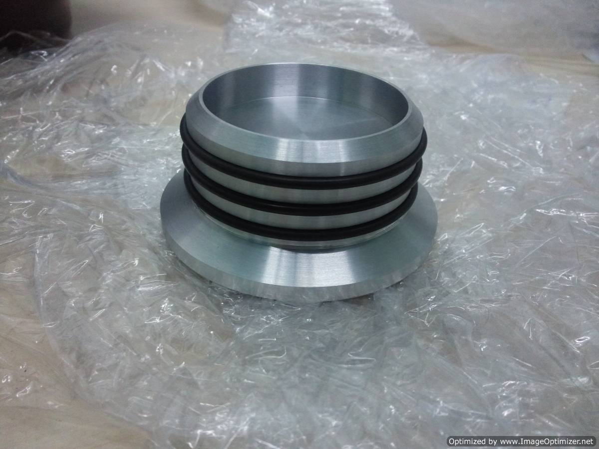

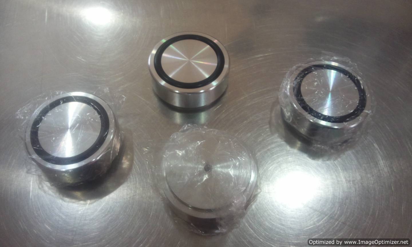

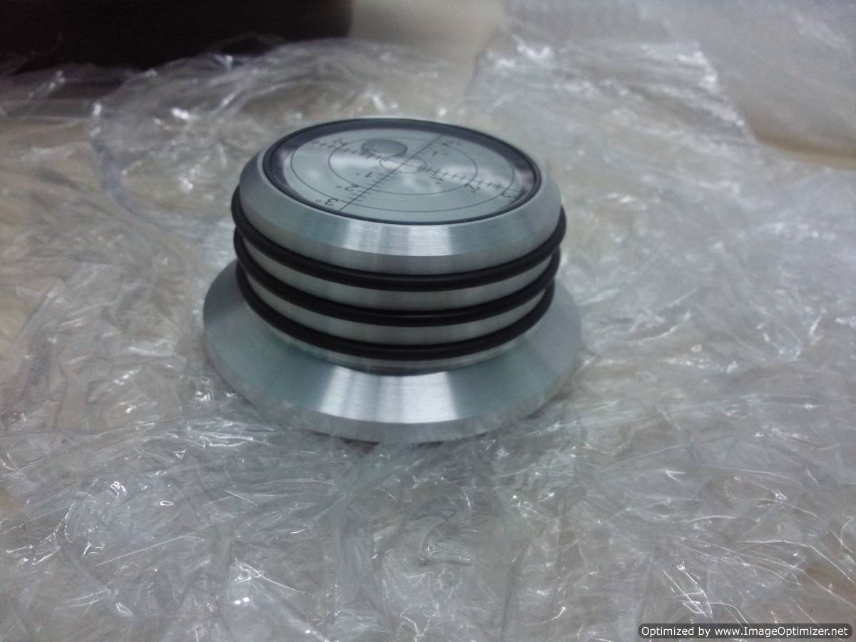

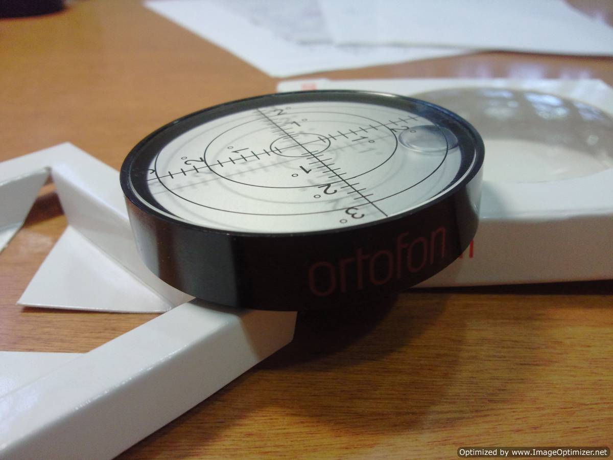

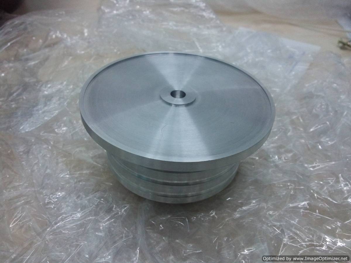

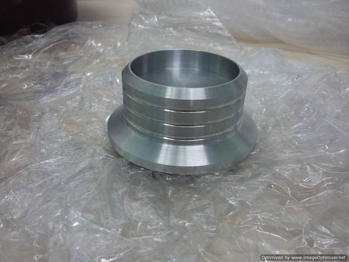

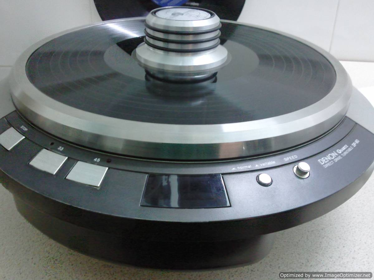

On to the record puck then!Or is it "clamp"?Anyway....
I had the extra length on the axle for it to secure in place.
Usually i don't make pucks more than 350 grams.
This time i had a periphery ring and this changes things.
The ring adds it weight on the periphery and promotes an upward "tension" on the center of the LP.
So the central weight had to be increased and i chose to make it around 500 grams.
At the last moment we decided to add a spirit level on it (i thought it was a nice touch)
and nothing but the best would go in this one.
I opted for the big Ortofon whose almost 7cm diameter dictated for a simple almost Teutonic puck shape.
The puck was cut from billet aluminium with milled places for the securing of o-rings.
A recess was milled in the bottom for a soft sorbothane flange.
I thought it's design matched the overall turntable shape well and went on with it.
Here's the final piece which i admit myself is the audiophile equivalent of jewelery...

Here are some more pics showing how these parts look on the table.
I did some tests to see if there were differences in noise and movement with the new parts.
I even tested it side by side with an ordinary one.
Even in naked form it proved dead silent and kept spinning way past the point that the original would stop.
I knew i was on the right track.
I had almost double the original weight (8860 vs 4730 grams) in rotating masses and even more rotational inertia.
I knew i had superior damping all the way up to the record height AND superior noise drain because the new thrust plate was part of a free hanging 2+ kilos bronze block.
The new ultra polished ceramic ball with twice the diameter of the original steel one and the teflon thrust plate with silicone support played their part too.
At that time i even came up with a crazy idea of using an even heavier platter (around 13 kgs!) with magnetic levitation so that the pressure on the ball would be between 1-2 kilos...to be tested on the next project!
