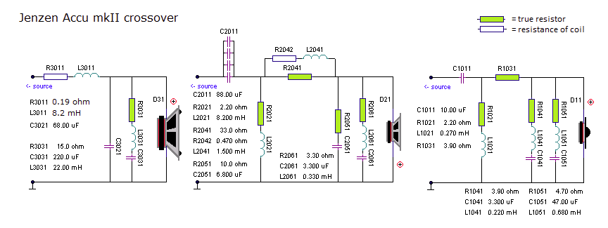

I always need a point of departure when thinking about a design. Troels Gravesen used this tweeter in an LR2 time-aligned 3 way. His 2.3kHz tweeter filter is what I would build around. The 4kHz notch on the metal bass here is straightforward.
Jenzen-Accu
The mid is the considerably easier Accuton C173-6-191E, which rolls off nicely at 3kHz.
I don't suppose it's too hard to adapt that design for the much broader bandwidth Accuton C173-6-090. But that dip at 3kHz is problematic, and the subsequent peak needs treatment, as is phase on the tweeter. You'd think matching polarity on the mid and tweeter, being flat baffle. And because this midbass is so efficient, an attenuator loses most of the possible impedance problems.

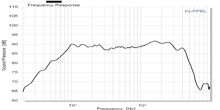

I've been mulling this one over. That Troel's Jenzen Accu C173-6-191E midrange is not hard to change here: accuton® Carefully selected loudspeaker drivers.
I just looked at the HF rolloff and thought, it's like a higher inductance version of the C173-6-090. And it is! Le of 0.7mH instead of 0.19mH. The rest, as they say, is just technique. :cool:

Hi Steve,
Thank you for all the effort . I saw this Janzen Diamond by research in Google for the C30-6-24 crossover some days ago. And came to that if could be suitable for my Tweeter and Mids. With only adjustments in series resistor for the Midds because of the efficiency of this 173-6-90 and also the breaking point on the lower frequencies by make 88uF to 94uF. And on tweeter remove the resistor R1031?!
And can i leave my Bass XO section unchanged ?!
This updated Xo looks nowadays like this:
There are only a few changes to the crossover compared to first launch. Middriver's notch-filter has been fine-tuned at little by the 0.33 mH coil. Tweeter circuit is basically the same, only C1011 is reduced to 8.2 uF and the notch filter has been further improved to provide a smooth reponse roll-off towards lower frequences. Point of crossover has moved up some 200-300 Hz, now around 2.5 kHz. For tweeter attenuation R1031 can take any value from 3R9 to 5R6. My default is 4R7. It depends on associated gear, listening distance, overall room acoustics and not least taste. 3R9 gives tremendous detail but may turn harsh on certain recordings. Don't forget the bass notch-filter. R3031 can be changed from 15 ohms to 33 ohms - or the circuit can be left out.
And don't think there is one final truth to the crossover as can be seen below, but we have to be able to follow what is happening by simulation, measurements - and the ear.
It’s a great news that I have no that hard way to re-design my XO after all. I have I think very Hi-End components to make this kind of 2nd order XO. Maybe I have to buy some resistors and inductors. But his will be not a problem I think.
First what I’m willing to test is to put a zobel on tweeter 1uF and 6.8 Ohm and add my new 50uF Duelund Cast capacitor on the mids. Everything on 1st order concept.

Jenzen-Diamond
This is an LR2 second order approach. The second one uses an entirely different tweeter, so we must be careful with tweeter Fs correction. But my feeling is that adding 0.5mH to the series mid coil will largely do the trick.
BTW, the order of shunt components like in Zobels makes no difference in theory. At least at audio frequencies. And the bass filter will be entirely different for your metal cones.
Steve, and I was already celebrating the success :)
I must say I do not understand the XO – designing. You advise me that add 0.5mH to series Mids (L2041 ) making it 2.0mH will do the trick. I have now 0.5mH in te mids. Strange that the 1st order XO is that different from the 2nd order on that inductor.
Further I have to leave the L-Pad on my Mids and remove the (R1031) from tweeter ? And i`m good for testing ?
The components that are in series will be high-end components , and Zobel networks , but the rest isn’t that important of I’m wrong ? And if so what are the parallel imported parts in this Janzen Accu mkII crossover ?

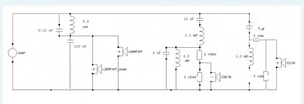

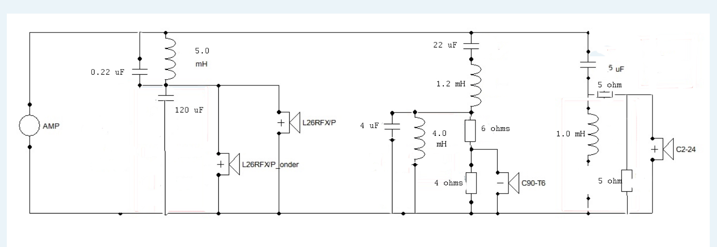

Hotel guys. From another forum i got a 2nd XO that may work with my project.
Here's my XO suggestion -
2nd order HP w/L-pad: 5uF series cap, 1.0mH shunt coil (higher DCR OK), L-pad: series 5ohms, parallel 5ohms
2nd order BandPass w/"L": 1.2mH series coil, 22uF series cap, (2 shunts) 4uF cap, also - 4.0mH shunt coil, L-pad: SR = 6ohms, PR = 4ohms
"tanked" 2nd order LP for parallelled Seas woofers: 5mH low DCR series coil, 120uF shunt cap, a teeny 0.22uF (notch) cap needs to parallel the 5.0mH series coil.
Fcs near 450Hz and 2.3kHz. Normally, only the mid would be connected reverse polarity.
