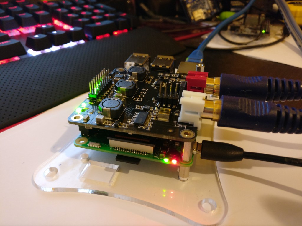

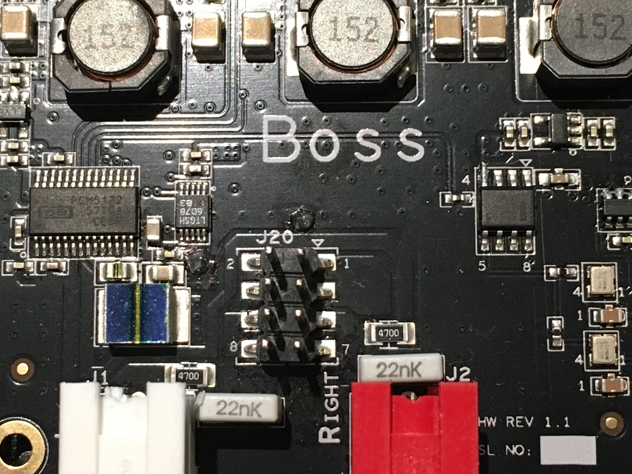

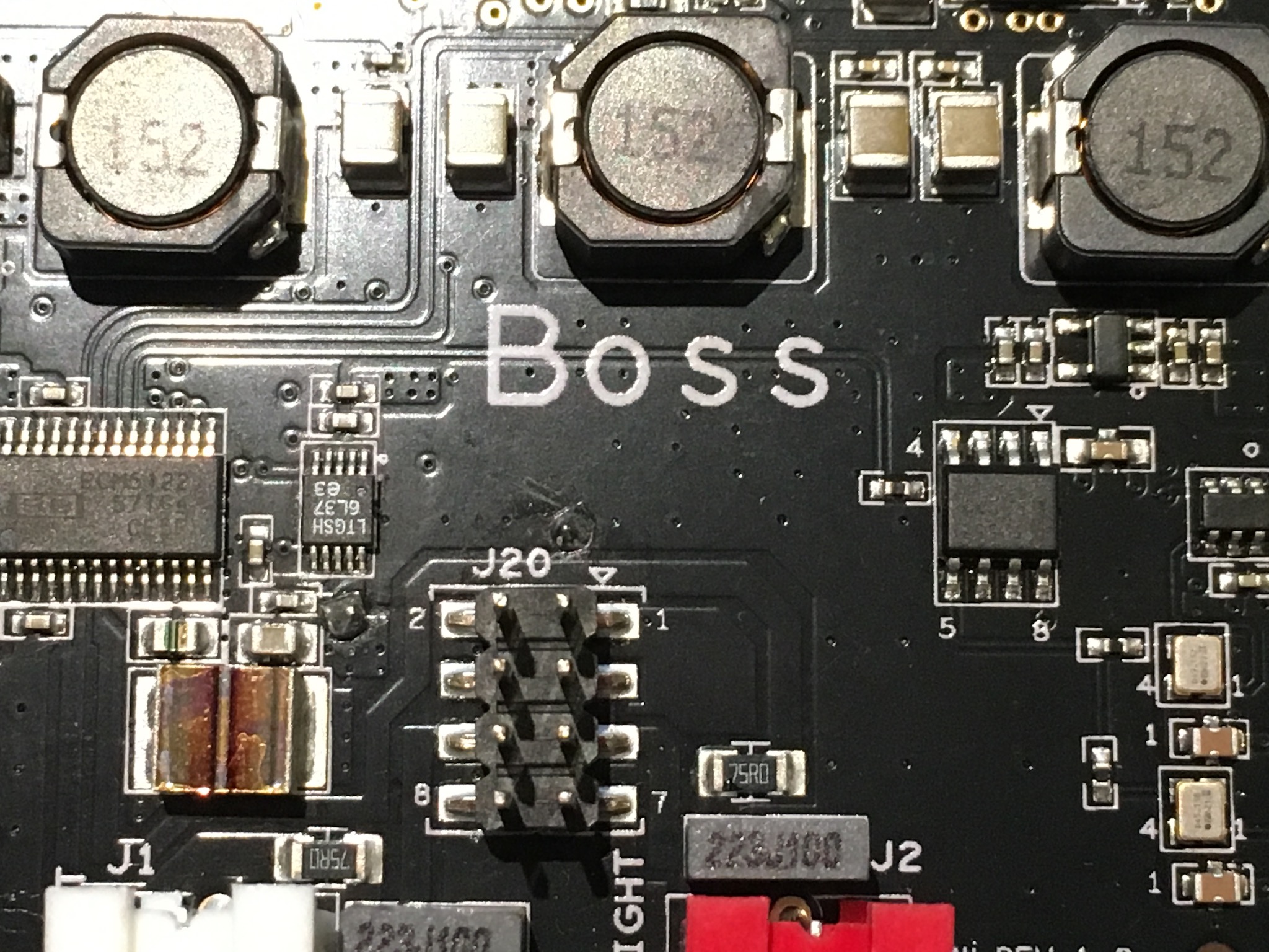

Hi folks.
Allo provided me with a production unit now. They now got the output filter fixed. Nice.
However.
I was quite disappointed to find out that they didn't do anything about the external power option.
1. Desoldering a resistor is a NoGo from my side. (all others offer a jumper)
2. Power-inlet on the wrong side of the board.
3. No standard jack or better a terminal similar to what the rest of the bunch provides.
And Allo still hasn't managed to get their Boss driver into the most current RPI kernel (4.4.50)
That's not good.
For now. It requires fully committed pi-audio distro maintainers to make that
driver available.
And that's quite some extra work - free of charge - done for a company that makes (or going to make) money of that HW.
BUT - on the other side there are also device manufacturers like the one who's providing the Mamboberry HW,
who just uses competitor drivers or trusts that the community will handle it.
Something I'd call a very questionable (short term) business model.
Bottom line.
The Boss is quite a good sounding DAC. There's a good chance that you don't even need the Kali.
The external power story gets a "NotAcceptable" from my side.
And. As long as Allo hasn't managed to get their (rather complex) driver into the RPI base kernel, Allo and potentially their customers might face serious problems.
It's the software and its availability which makes a product a product. Without it it's useless.
No to forget. SW has to be (long term) maintained. And that's as critical as general availability!!
Allo still has to prove that they're able an committed to provide.
Enjoy.

Hi.
Allo just came back with a boss patch update for the latest 4.4.50 kernel.
THX.
They also underlined that they are contentiously pushing to get the
code into the RPI kernel. ( as PM to me)
And that means if you just received your shiny new Boss you have
to find a distro that comes with a custom audio kernel supporting the Boss.
For those capable of making kernels:
Here you'll find the boss patch for download.
Meanwhile I'm receiving PMs asking me, if I could make a preliminary Moode
release with Boss support available.
Folks. No - I can't and No - I won't! Check with Tim!
Enjoy.
