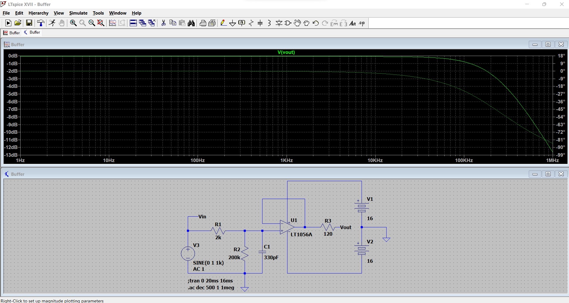

So this is the buffer. X1 gain, DC coupled and non inverting. One practical point is that bjt opamps like the 5532 will show a significant DC offset due to the 200k input bias resistor.
The input filter rolls the response off as shown here.
Yes Mooly, it is exactly what I did. As you know, the corner frequency is Fc = 1 /(2x PI x R xC) where R is 2000 Ohm and C = 330pF. So Fc = 241 kHz. I did write above Fc is below 250kHz. Your plot shows the same thing. I did choose that frequency because the power amp has a cut off frequency (I did measure it for both channels) of 170kHz.
In the power amp, a significant DC offset generated before the input is blocked by the C1 = 10uF that you did put at the input. So even 1 volt of DC offset will not be a problem for your very nice and good sounding power amp. So do I believe. If somehow I am wrong, please say it, I will be very happy to learn something new for me.
As you see, I have taken no interest at the phase generated at higher frequencies. As said, I don't hear frequencies above 10kHz. The stereo impression I have in my lab is so good that I have no doubt it will be more than OK when I will have my Mooly's amp driving my Canton's speakers. Let me say that better so in bad english : I expect to get "a more better" stereo effect with them later in a better sounding room with better placed speakers.

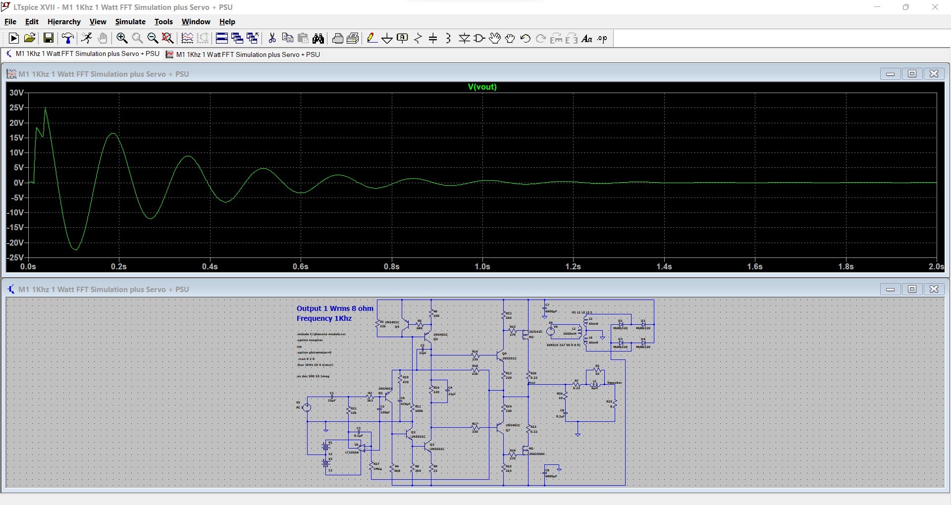

By the way, I would like to point out a point that seems to be a purely circuit problem.
I noticed by looking at the "relay delay is required for 6 seconds" simulation waveform of # 1215, but if the actual circuit is equivalent to this simulation circuit, there seems to be a large peak around 6 to 7 Hz outside the audible band.
This can lead to unwanted woofer cone vibrations. Mooly may not be using but, for example it can be a problem when playing vinyl records.
The DC servo is returned to the non-inverting input side using an inverting integrator. However, this method is affected by the time constant of the input low-cut filter and the passive servo on the inverting input side, in addition to the time constant of the integrator circuit. Since it becomes the low frequency characteristic of the secondary system or the tertiary system, a large peak occurs depending on the arrangement of the poles, and in the worst case, low frequency oscillation occurs.
It also has the disadvantage that this characteristic is affected by the signal source resistance of the connected equipment.
For example, it would be good if the circuit placed in front of it taht was fixed, such as the Integrated Amplifier
I recommend that you check it out.

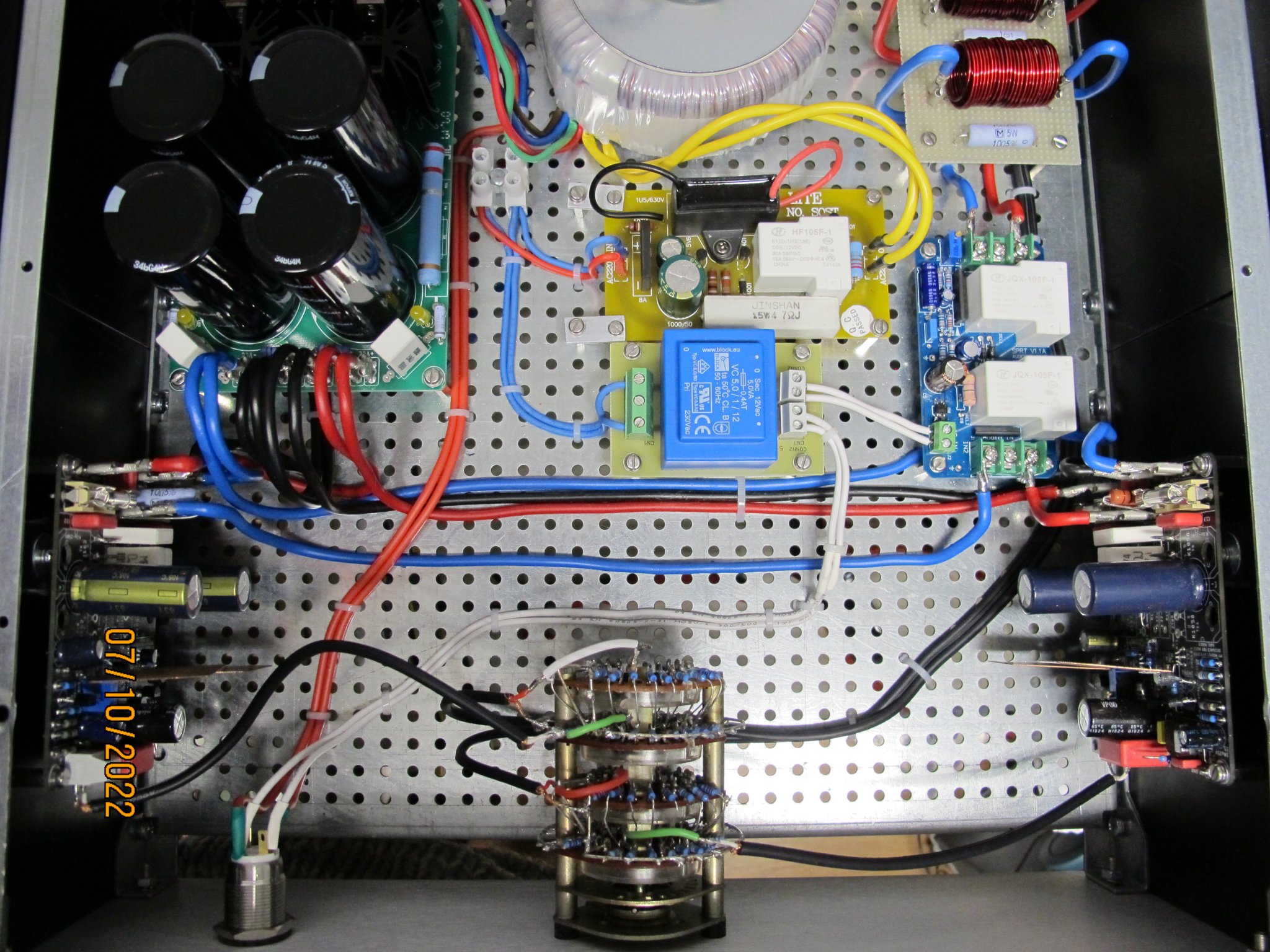

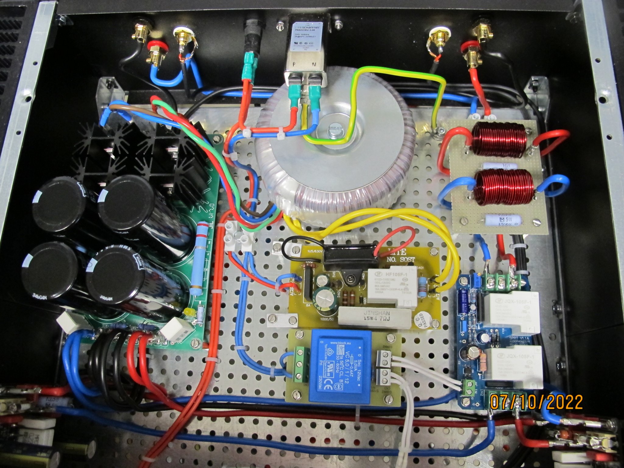

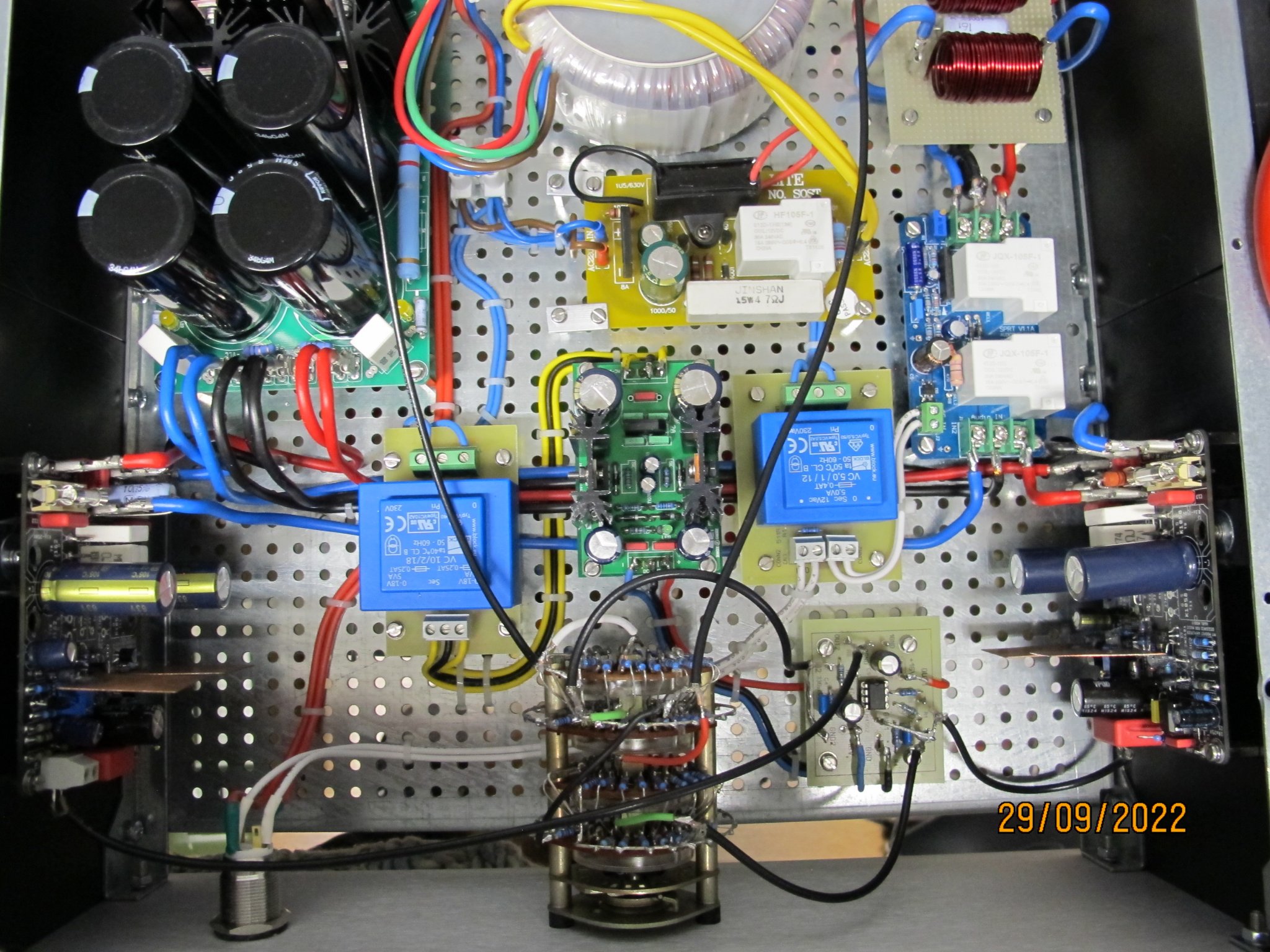

Hi Mooly
I have had some problem in order to get the reason why I did measure a bandwith of around 90kHz, coming from 170kHz when all the circuits were not placed inside the chassis.
It is a strange reason I did find for this attenuation of the bandwidth. I have used all RG174 for the connection at low level, from the RCAs to the PCBs amplifiers. This RG174 wire was very old, more than 40 years home. The gnd part of the wire did not solder in less than more than 20seconds, and it look bad soldered ... As it is to much heat, I did check that there was electrical continuity, there was. Then I did clamp the RG174 with a metallic part in order to solder new RG174 at the gnd part of the wires, so I did get a better bandwith of around 145kHz. Already better, but not what I had before. Look at the 'old built with RG174 and other stuff not needed.jpg'. The last part has been to substitute the RG174 with another wire I did buy at the same time (around 40 years ago) as the RG174, but all Cu inside, and the gnd part did solder easily as you would expect it. I have provided a Bode Plot.pdf of what I have now : it shows an healthy 172kHz. All OK for me.
I have modded the internal of the amplifier taking away what is not needed for the power amp using CD reader. You get a picture of what I had built before with the RG174 and all other stuff not needed. With the very friendly help of the good Thimios, I have arranged a bit the internal of the road of the wires that substitute the RG174.
It follows in the next part.
Best regards
rephil
Best regards
rephil

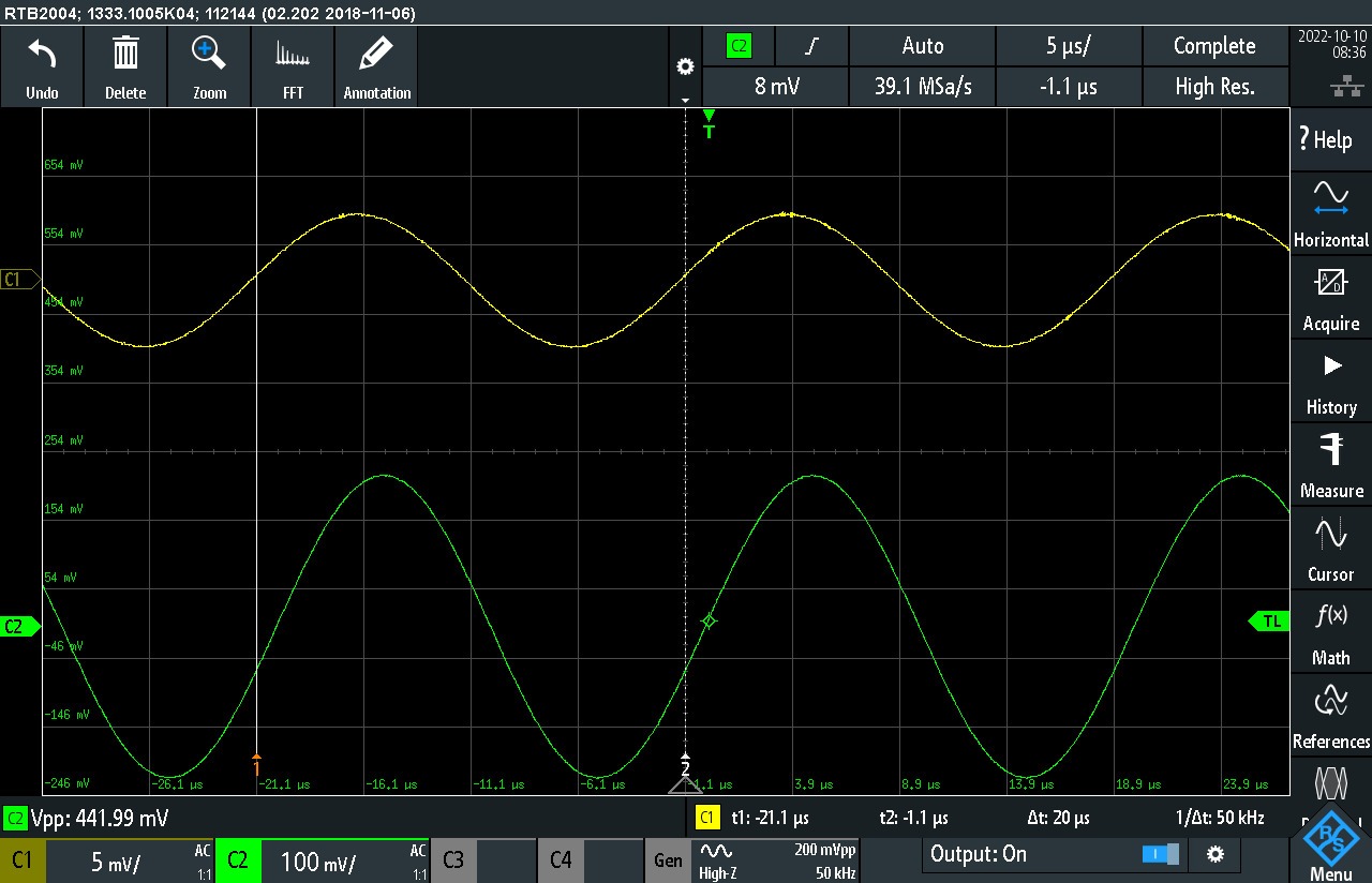

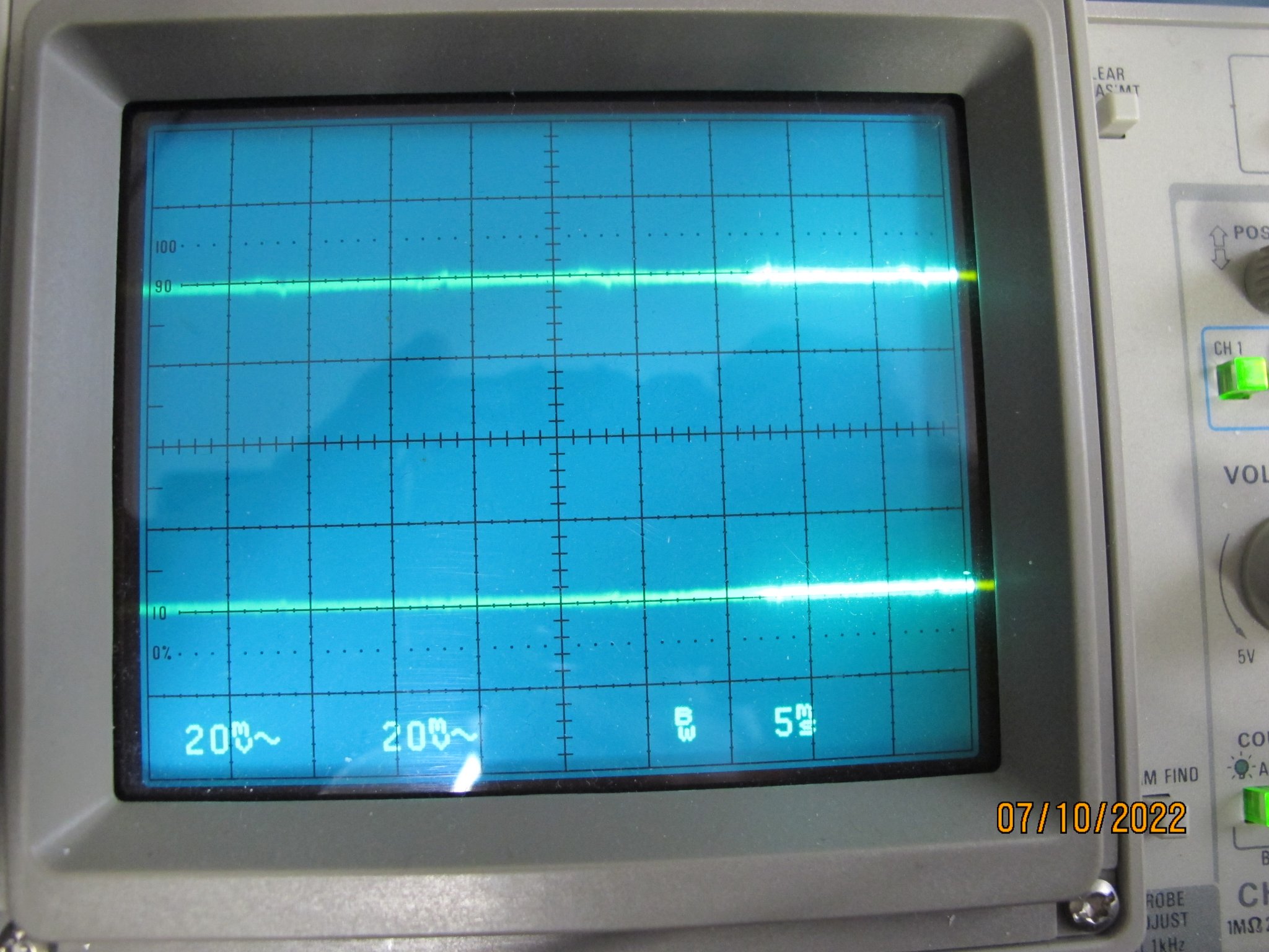

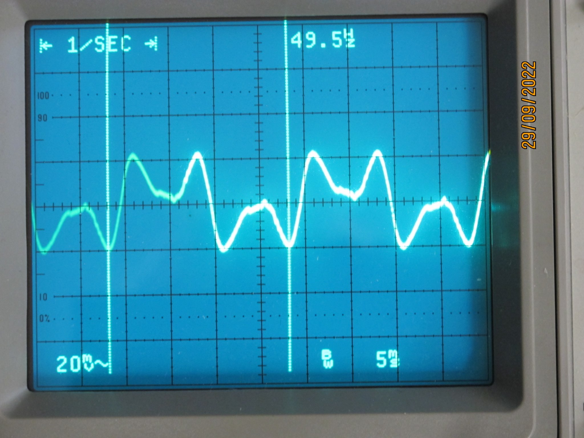

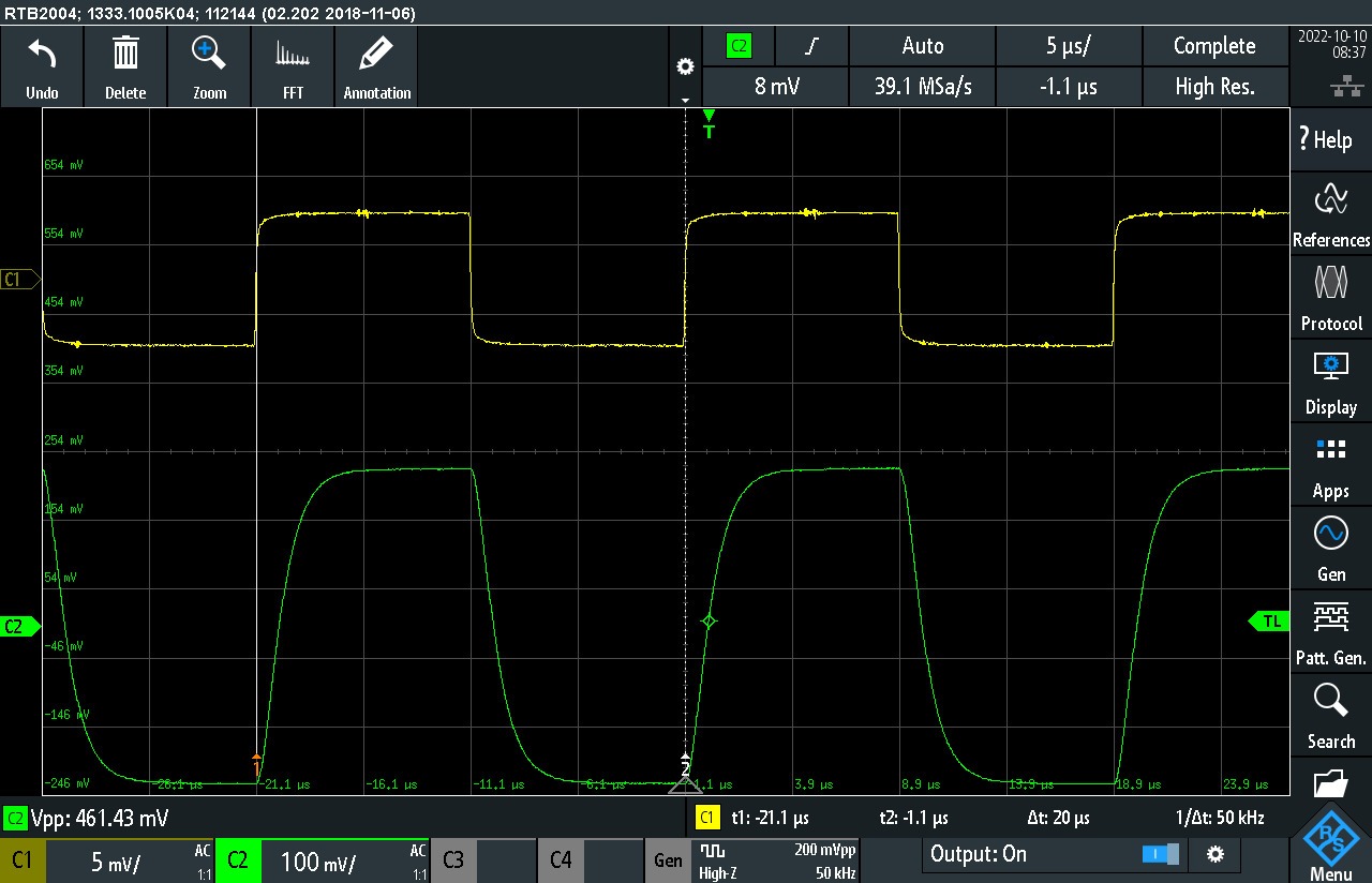

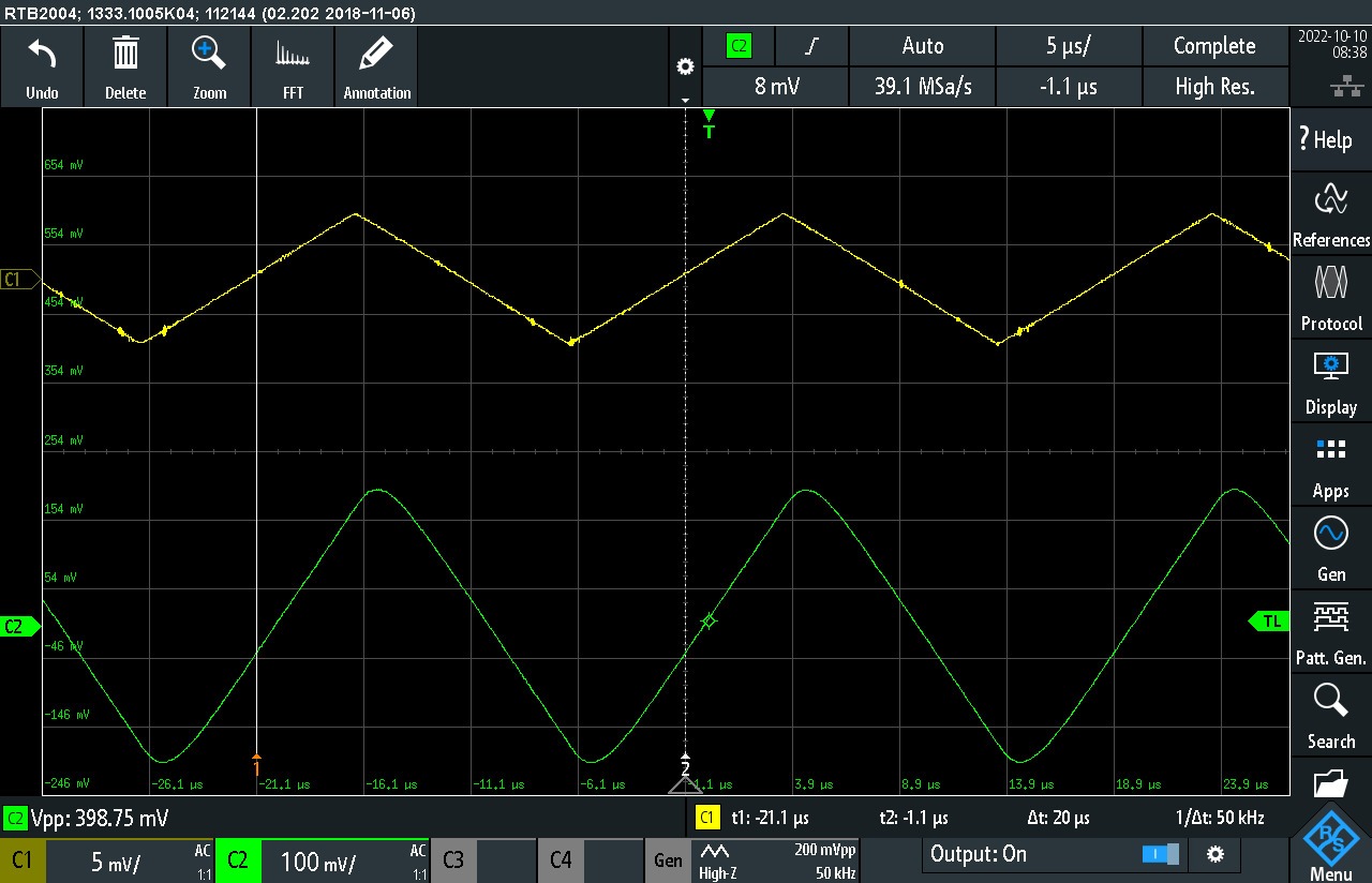

Hi Mooly
Here is the second part.
As you see, the no input from the nasty built did provide bad sound : it is possible to hear it with the music. The new buit does not provide anything out of my speakers at all levels. Without input they are silent.
Here, please find the Bode Plot of the new built, the input probe is placed at the input of the amplifier PCB, the output probe is placed at the output of the amplifier built. The gain is obviosly not the one that is written as between the input of the generator placed at the input of the power amp built, so it gets attenuated at the PCB input. I did put a bit more volume as <hat I normally use for the CD when connected. The blue track is the gain, the brown track is the phase.
Some other pictures, one that shows with more details the no input situation at the output, the others are sine, triangular and rectangular at 1kHz and 50kHz : Yellow track is measured at the input of the PCB, green track is the output at the outside of the power amp.
I have problem to download pictures in diyaudio : they don't accept .docx and .bmp files. So I did have to let the files translated in .pdf and .jpg using free available programs on the webb. They are around free as when you have many pictures to translate, they ask you to pay ...
If you thing it is a good built : don't believe that, as I would do it a lot different today with what I did learn. As did Thimios say : I would group the RCAs together at a better place as they are placed now. But what I have got is a very good working amp without disturbing sound (buzz and others), and as I have so much pain in my bones, in particular in my hands, I have to consider it veery well done and finished ...
Don't hesitate to give your opinions in order to get a better done power amp : it is not my last power amp, and other good guys here are doing their best in order to get good music where they are living.
Dear Mooly, this amp sounds great, and in the next days I will test it on my principal speakers, and if all is OK (if it sounds at least as good as in my lab), it will be my only principal power amp ! Thank you Mooly, it is the best amp I have heard.
Best regards
rephil

It all looks a very neat build you have done RG174 I know as 50 ohm coax aerial cable so maybe not the best option What I see in the pictures looks much more suitable. Your test results all look good.

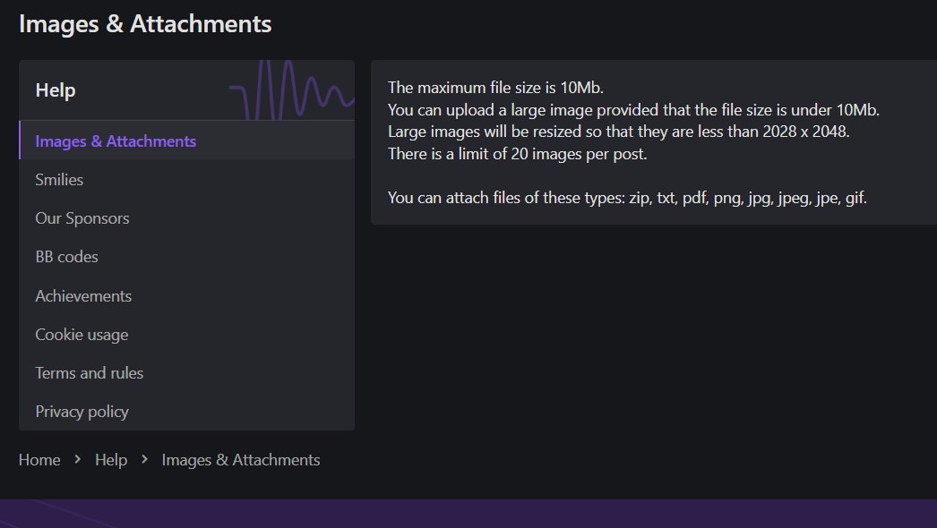

They will attach if you put them in a zipped folder provided it is within the attachment file size limits.

That's strange If you go to the bottom of the page and click on 'Terms and rules' there is a button for attachments. Zip is in there.A zipped folder to attach the files not accepted by diyaudio
