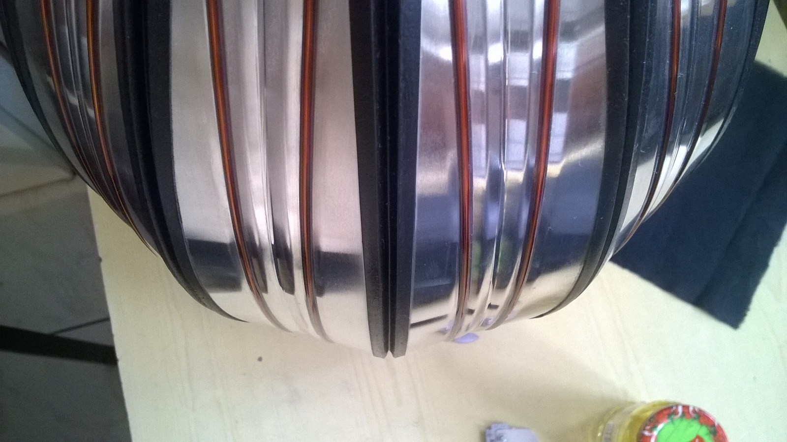

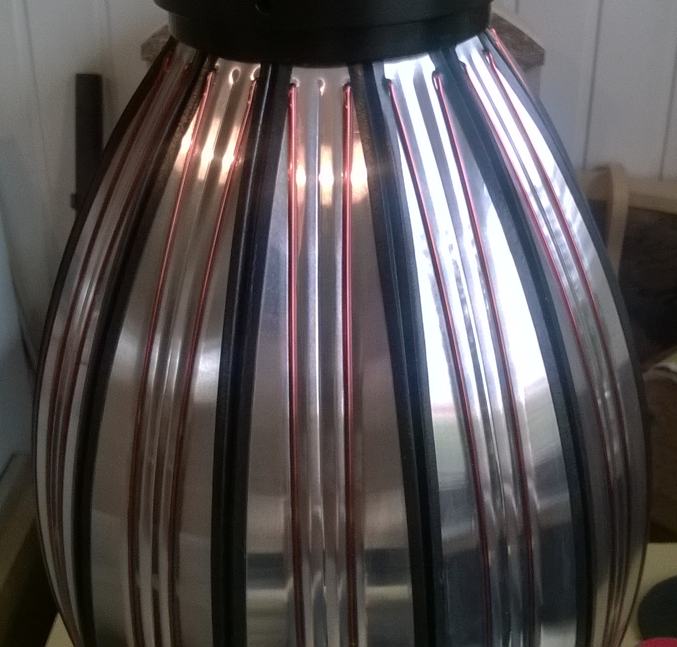

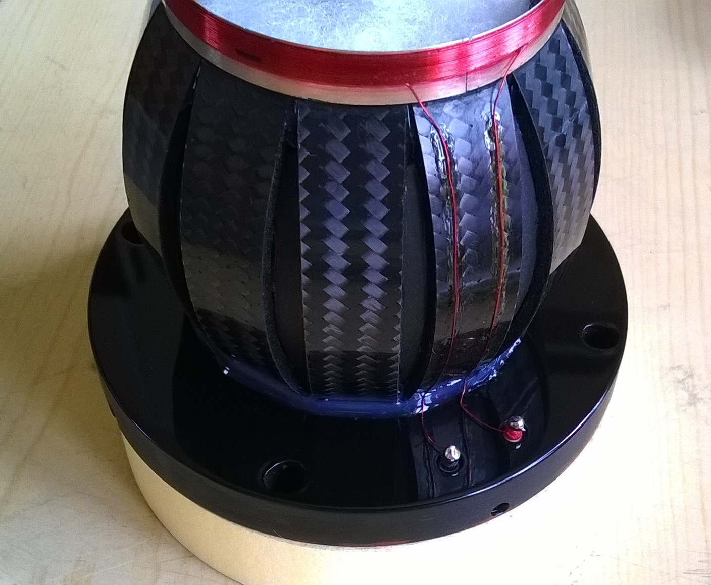

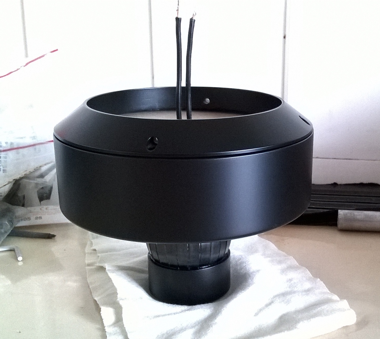

My MBL 101E replicas

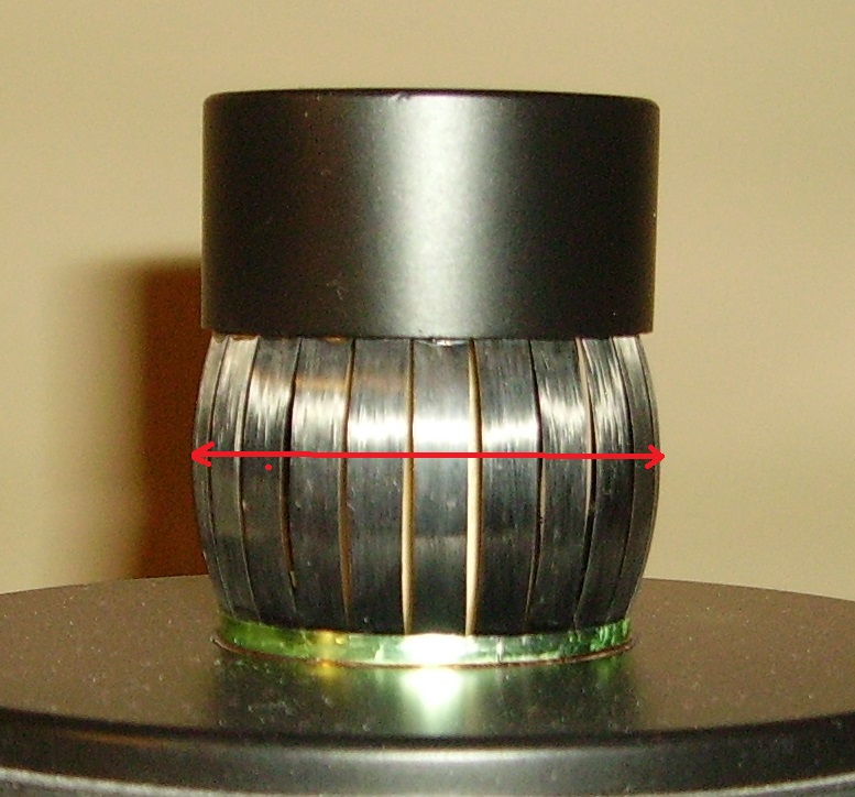

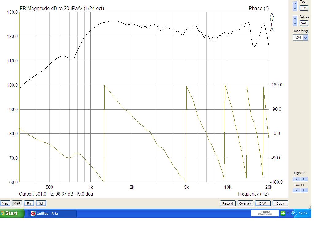

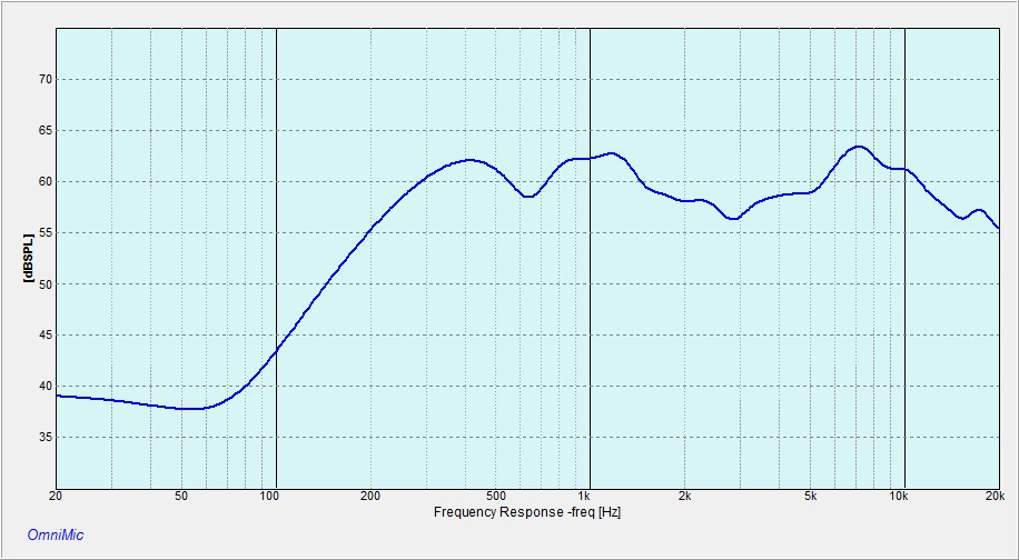

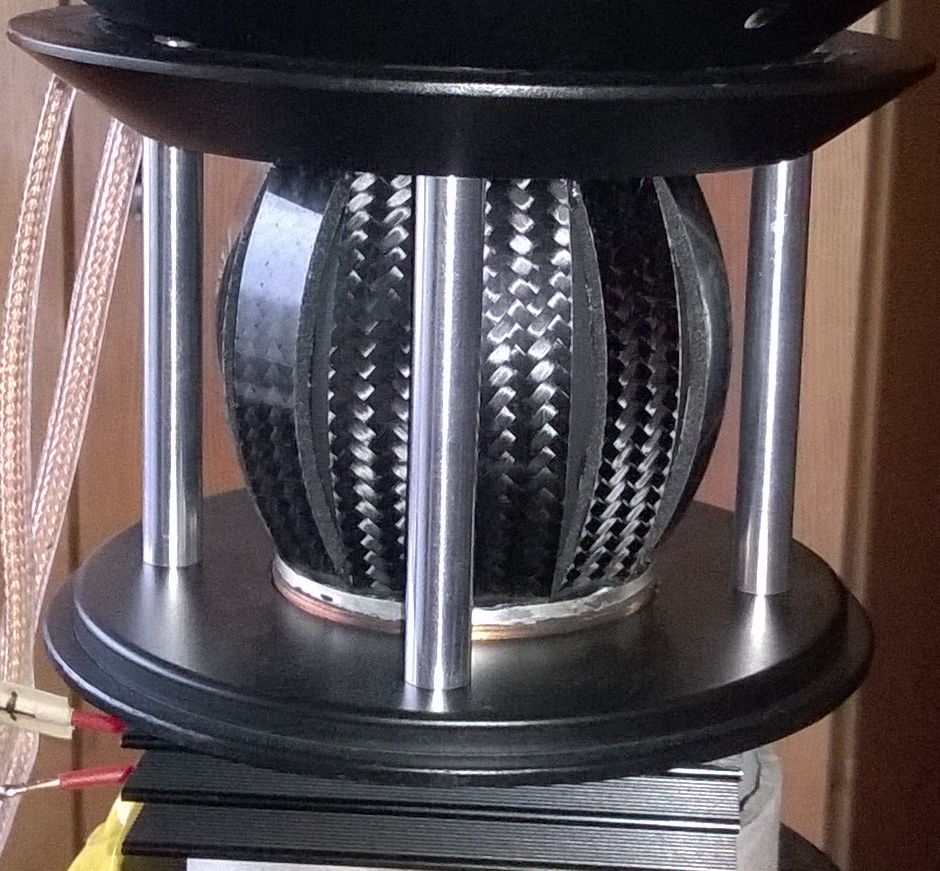

New tweeter continuation.
New tweeter...

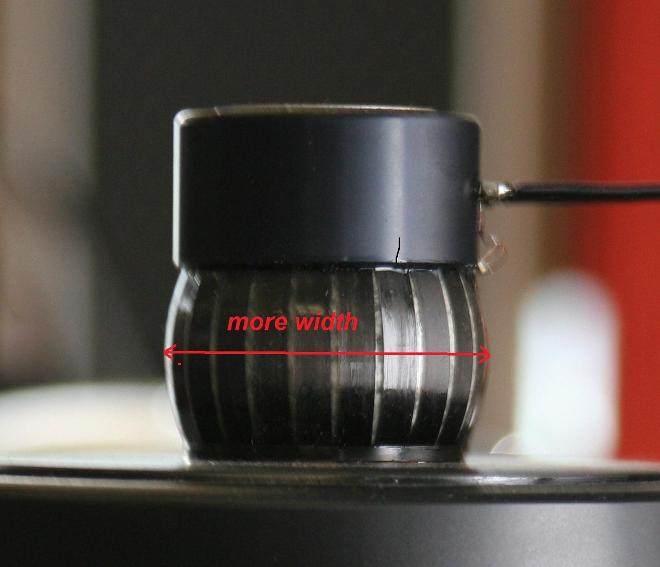

Balloon closed and filled with a silencer.

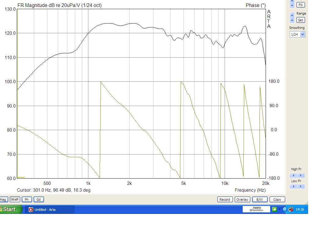

The new speaker is a little thicker "fins".
Therefore, the jump to 15kHz.
Nice I see that you are doing it the mbl way. I have a very different way which results in a different bulb shape. Where as the mbl is the ice-cream too small for its cone my approach gives a bigger plump so the "ice-cream" over flows the edges of the cone. Even with the same exact carbon slat size.

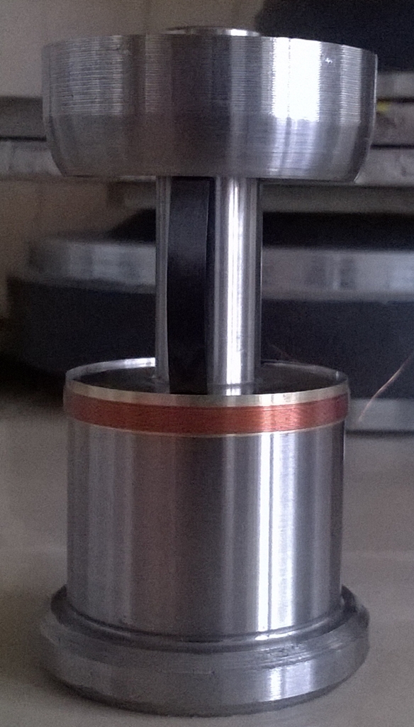

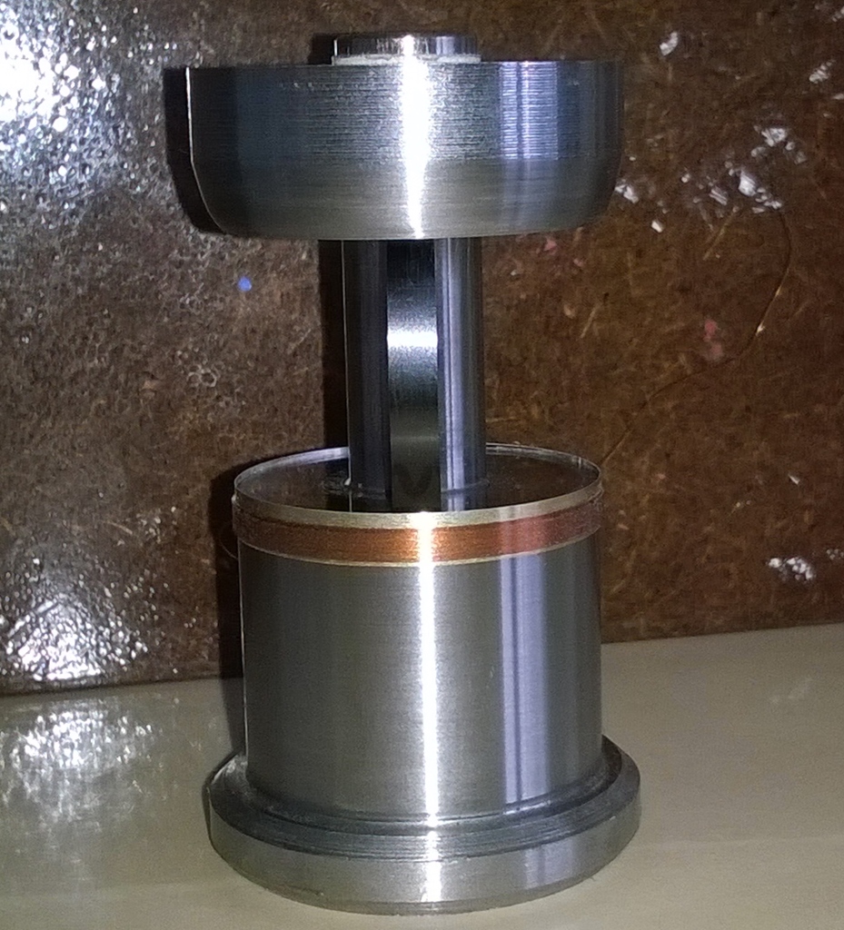

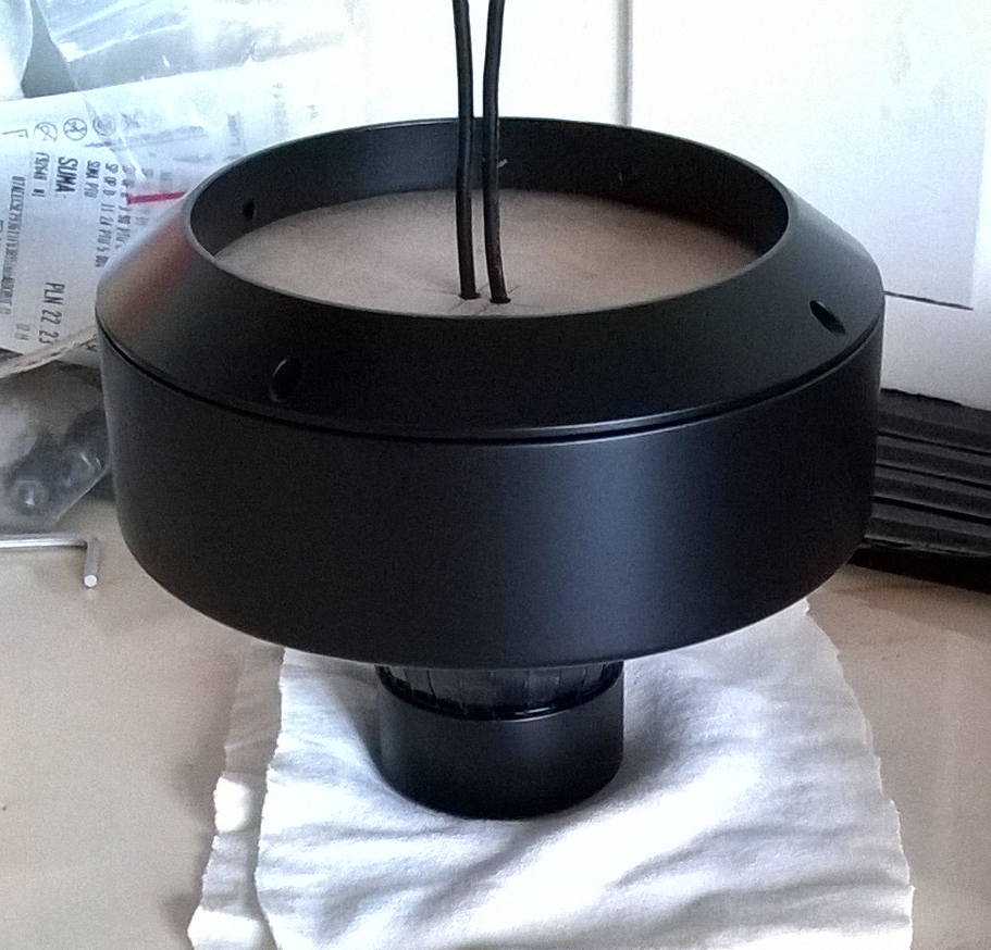

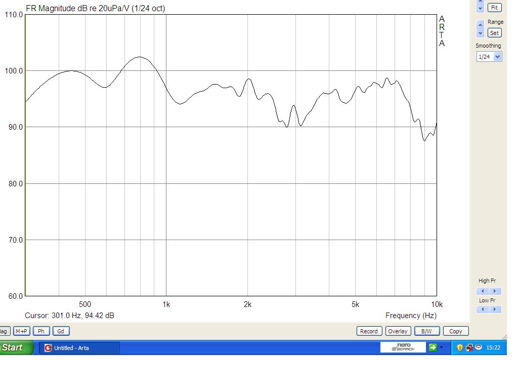

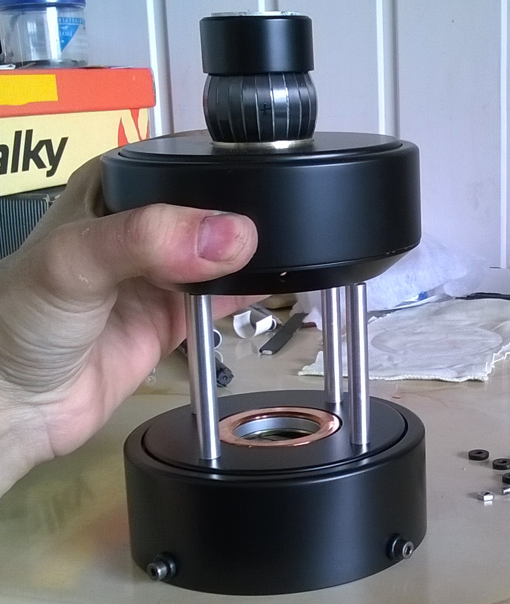

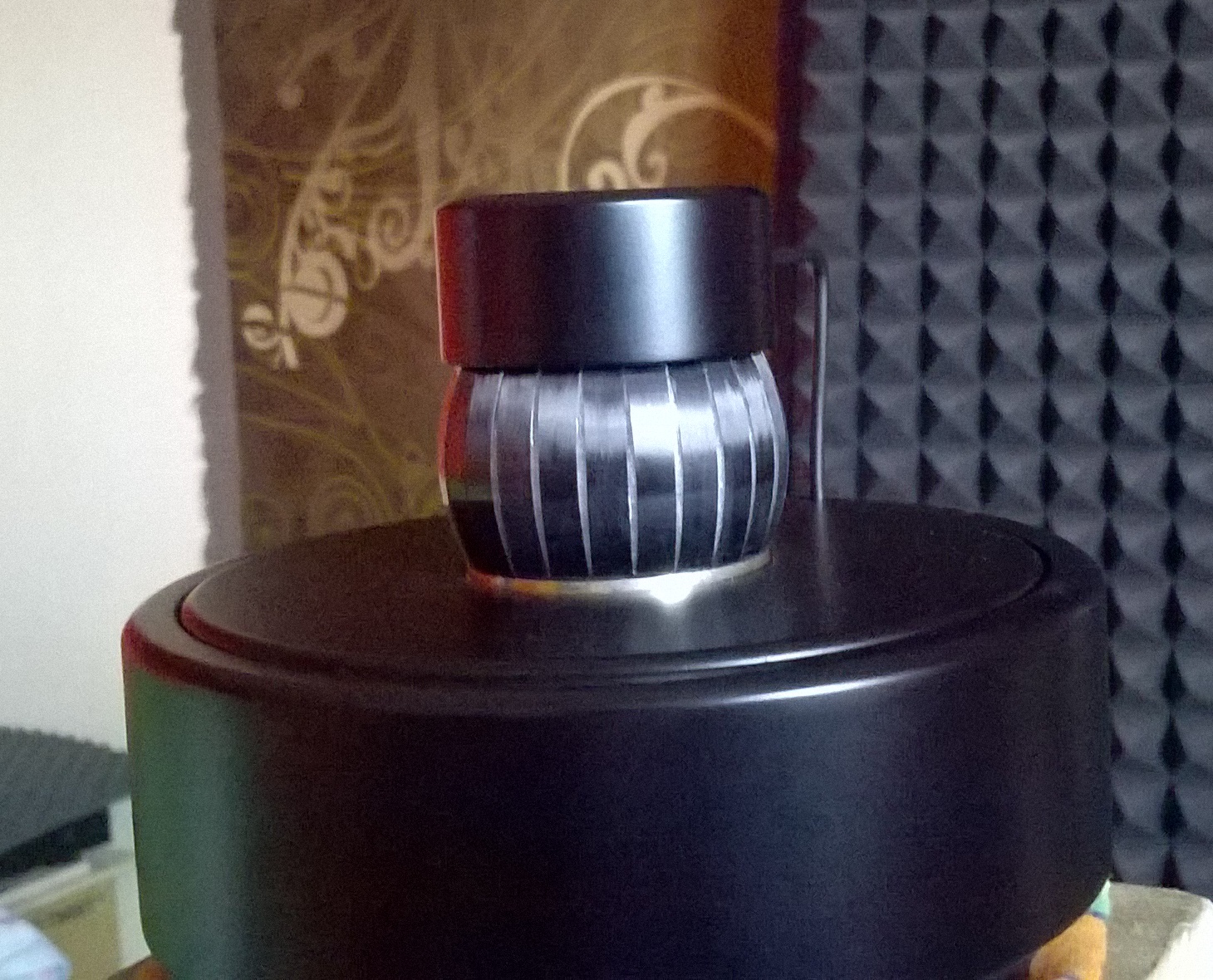

New midrange.
The new midrange.
Extraordinary sound!Perfectly sound with the latest high.I am happy and moved.
I'll make a small patch and will remain so.This will be used to columns.

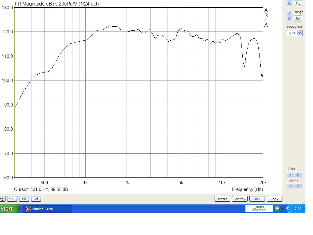

David Salazar measurement midrange.
Showing measuring David Salazar.Our measurements are similar.
David reports that his speaker system also plays fantastically.
Incredible,haha.
David, we're good league!

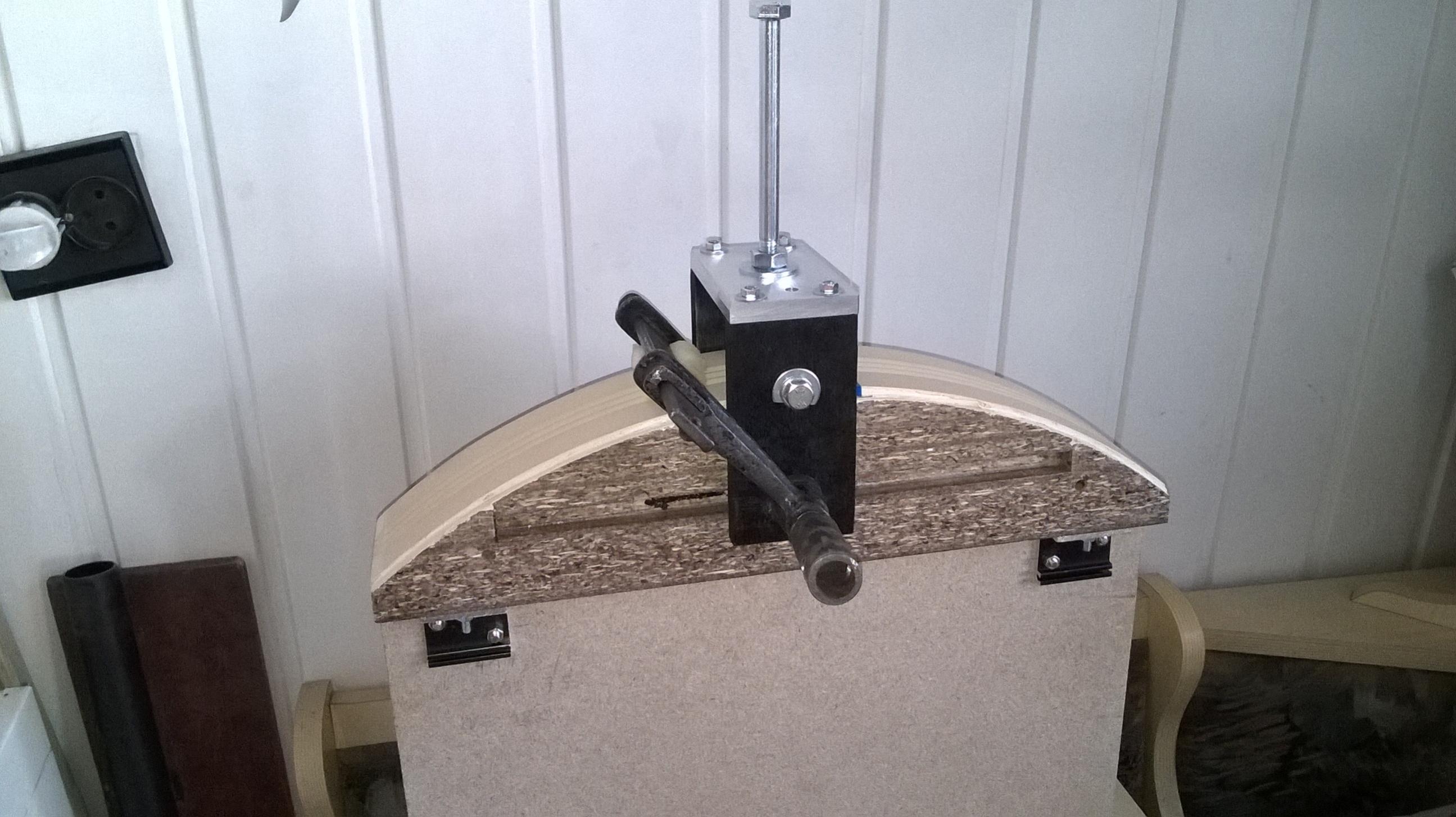

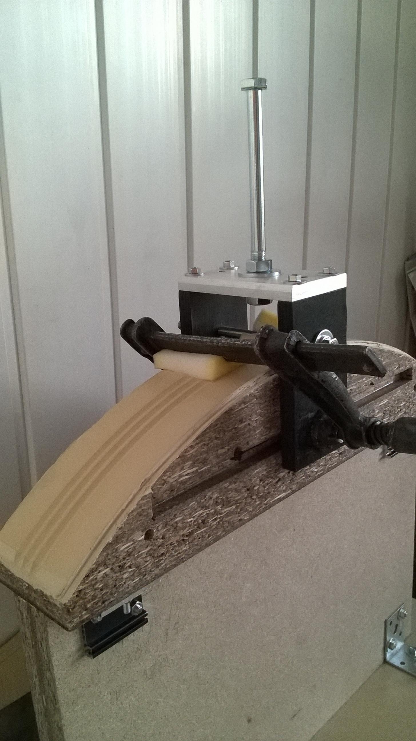

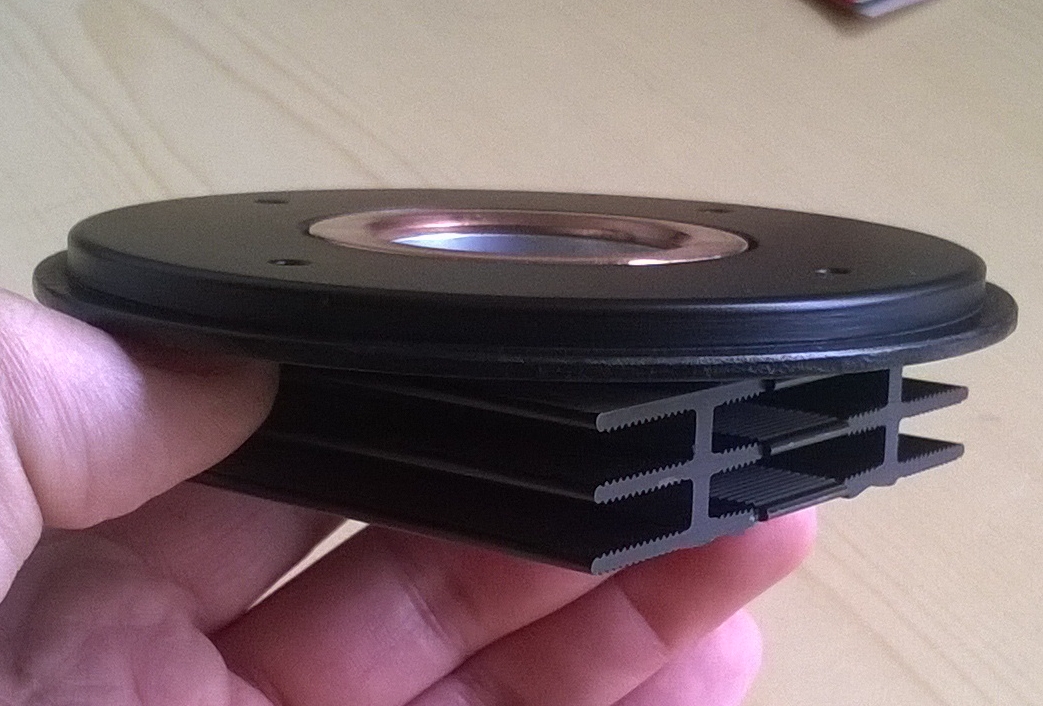

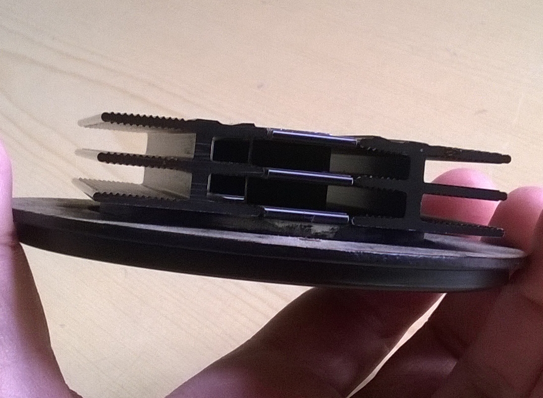

Matrix build.
The die build ...
Previously, I had a simpler matrix.
New will be practical and painless.:)
The company MBL uses hoof of textolite plank.I can tell, my foot is made of putty universal car NOVOL.
I have reduced the cost of making the hoof by about 90 percent.
