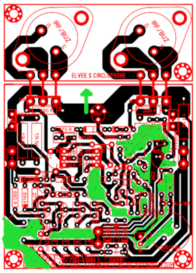

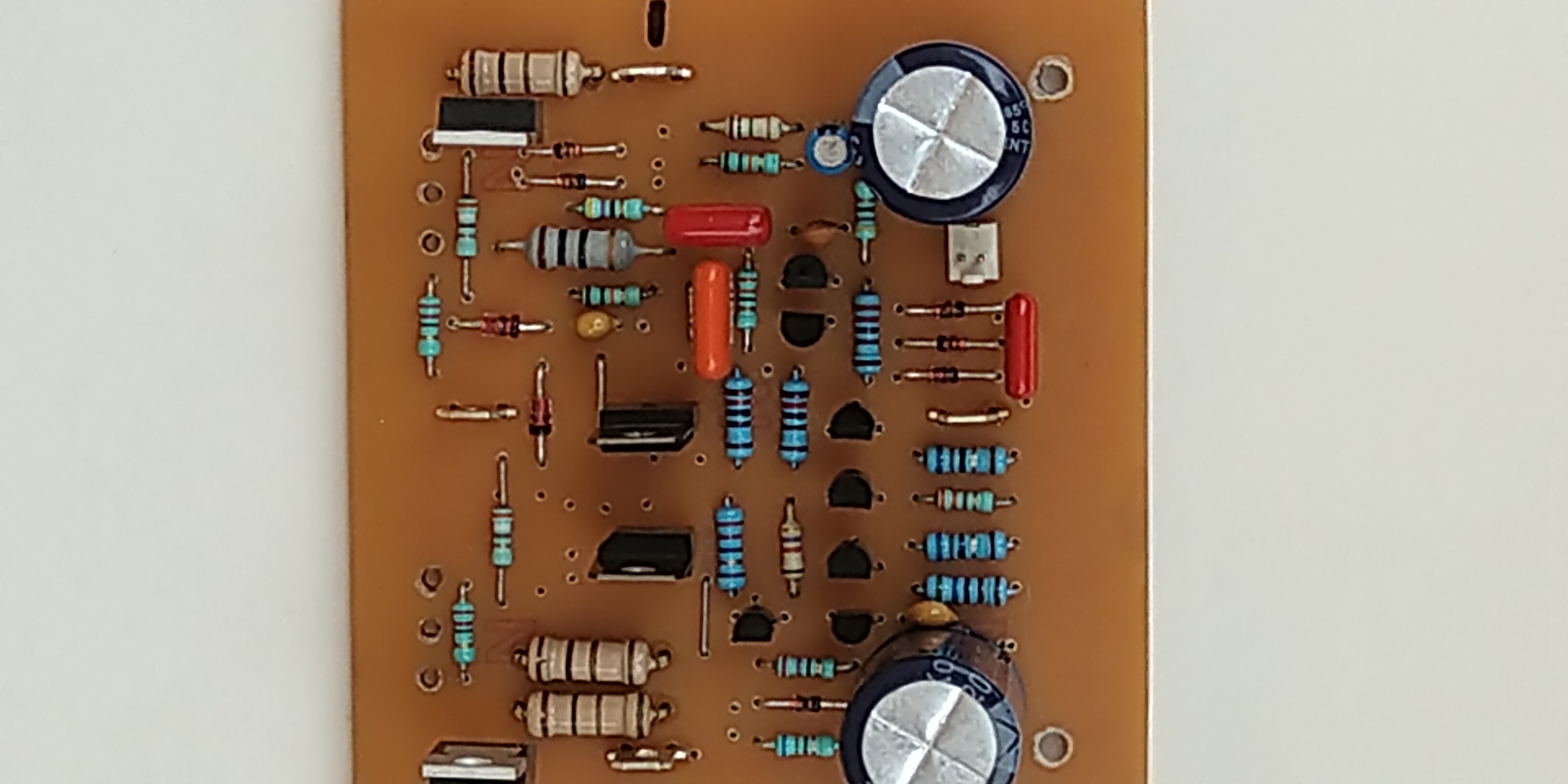

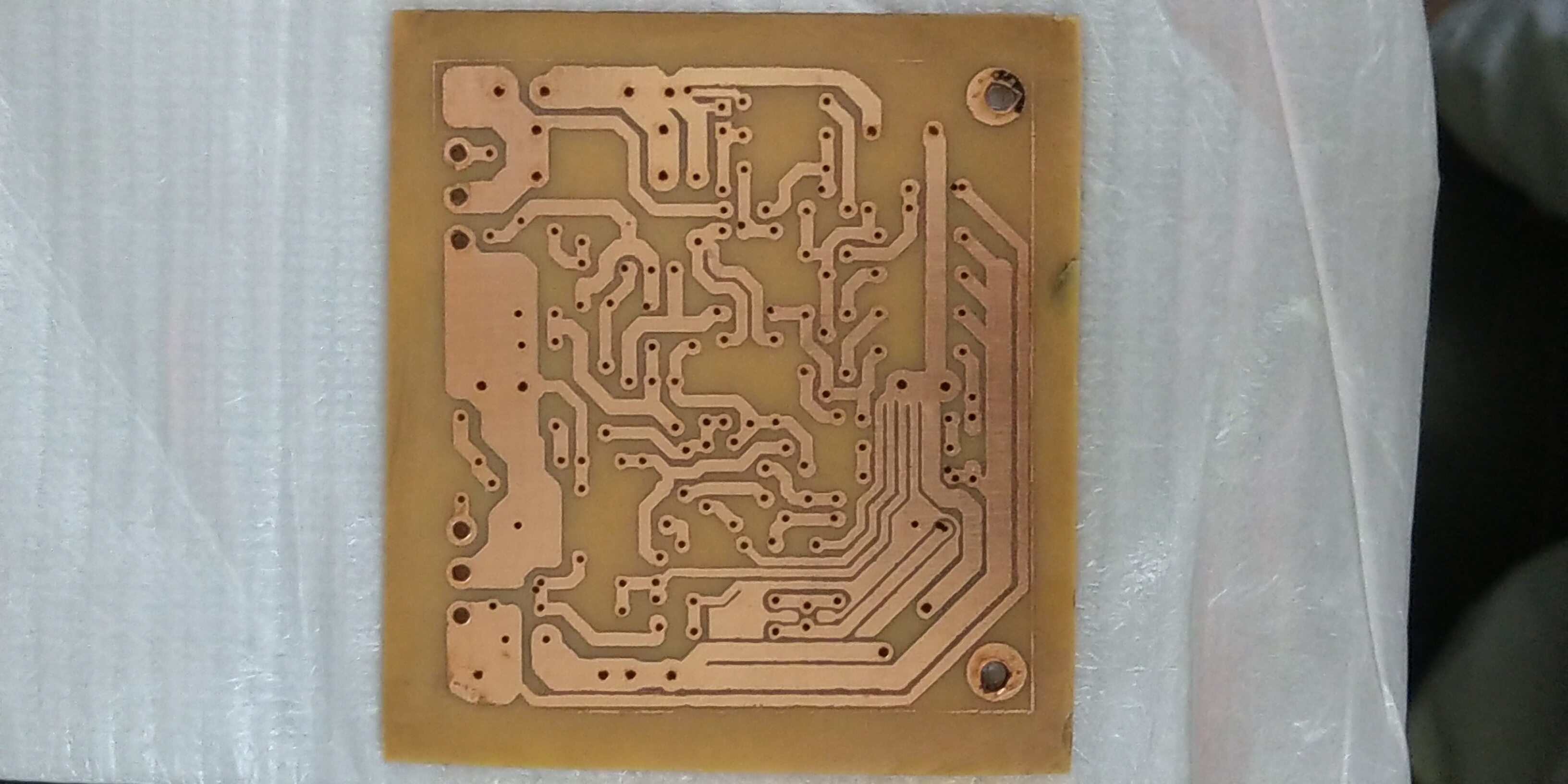

I have tried to get the layout of the board modified from BJT to HEXFET as per simulation schematic. I am not very sure for its correctness. Layout is attached.
It seems you flipped the original layout according to the rails. This is rather a cosmetic change except you don't feel right when negative rail is at upper or left side. This flip may cause wrong polarity and wrong orientation issues on silkscreen (as you mentioned on last post). Thus you have to strictly check active part orientations.
Other thing that I have to notice is unnecessary gap fillings. I would avoid filling those blank spaces which I think highly counter productive. I don't see any benefit of them either. You can move parts a bit upper and relax the layout since there is no driver transistors anymore.
You can check-out Bagla H's pcb at post#1810 . It is double layer but very well done in my opinion.

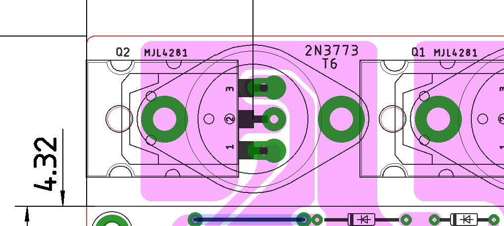

When you use TO3 transistors, you should consider good fitting of "L" shape angle heatsink attached top of the PCB. Your layout is suitable for such use but those wire jumpers prevents proper fitting of the heatsink.
I suggest you to avoid those wire jumpers and build two versions separately. I think that there is no practical benefit of the modular design here but contrary.
If you really intend to make a single modular design you may start from avoiding those wire jumpers first. It is easy for Drain and Source pins by directly making a via between them at bottom. For Gate, you can use a small wire jumper or another via at bottom.
Even the pads of to-3 can be used with some imagination to fit to-247/264

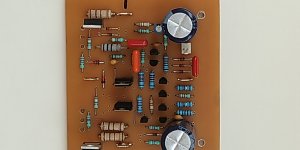

I have modified the Circlophone BJT board to HEXFET as per simulated schematic. I will assemble the circuit on this paper phenolic board. I intend to use following components:
Power Mosfet: IRFP240 / IRF350
VAS : BF470
Supply Transformer 24-0-24 V AC.
Picture of etched board attached.
VAS : BF470

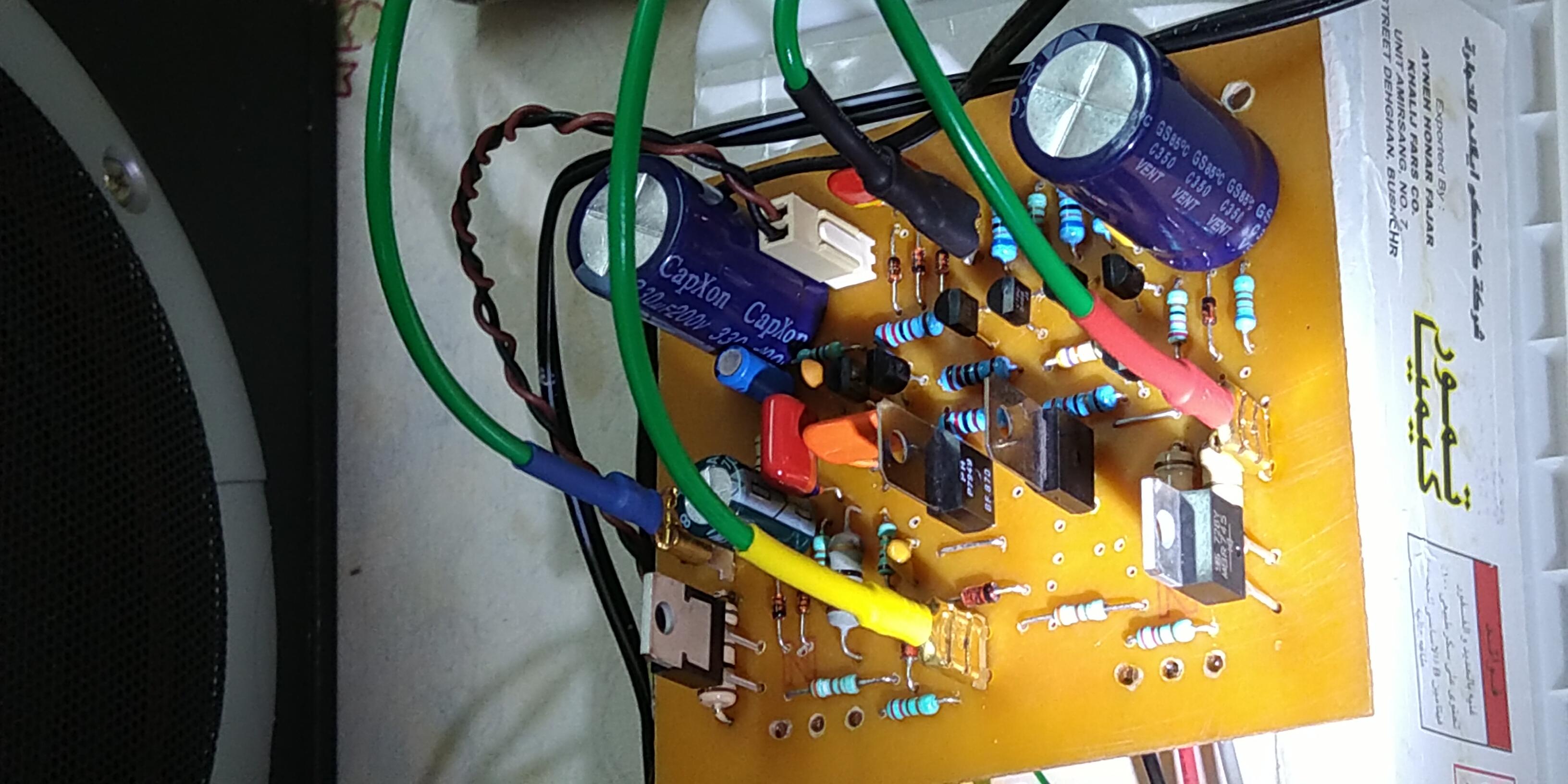

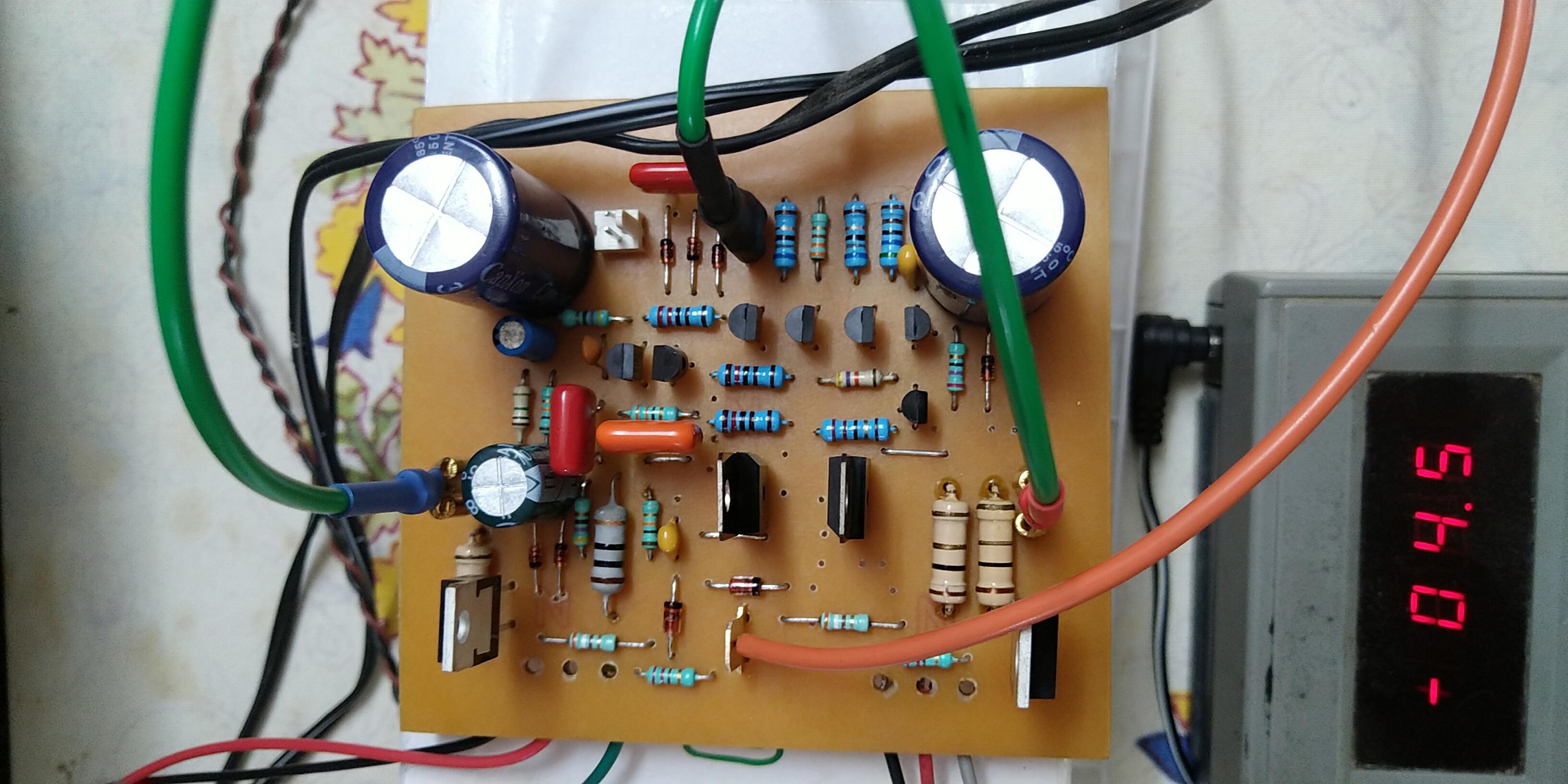

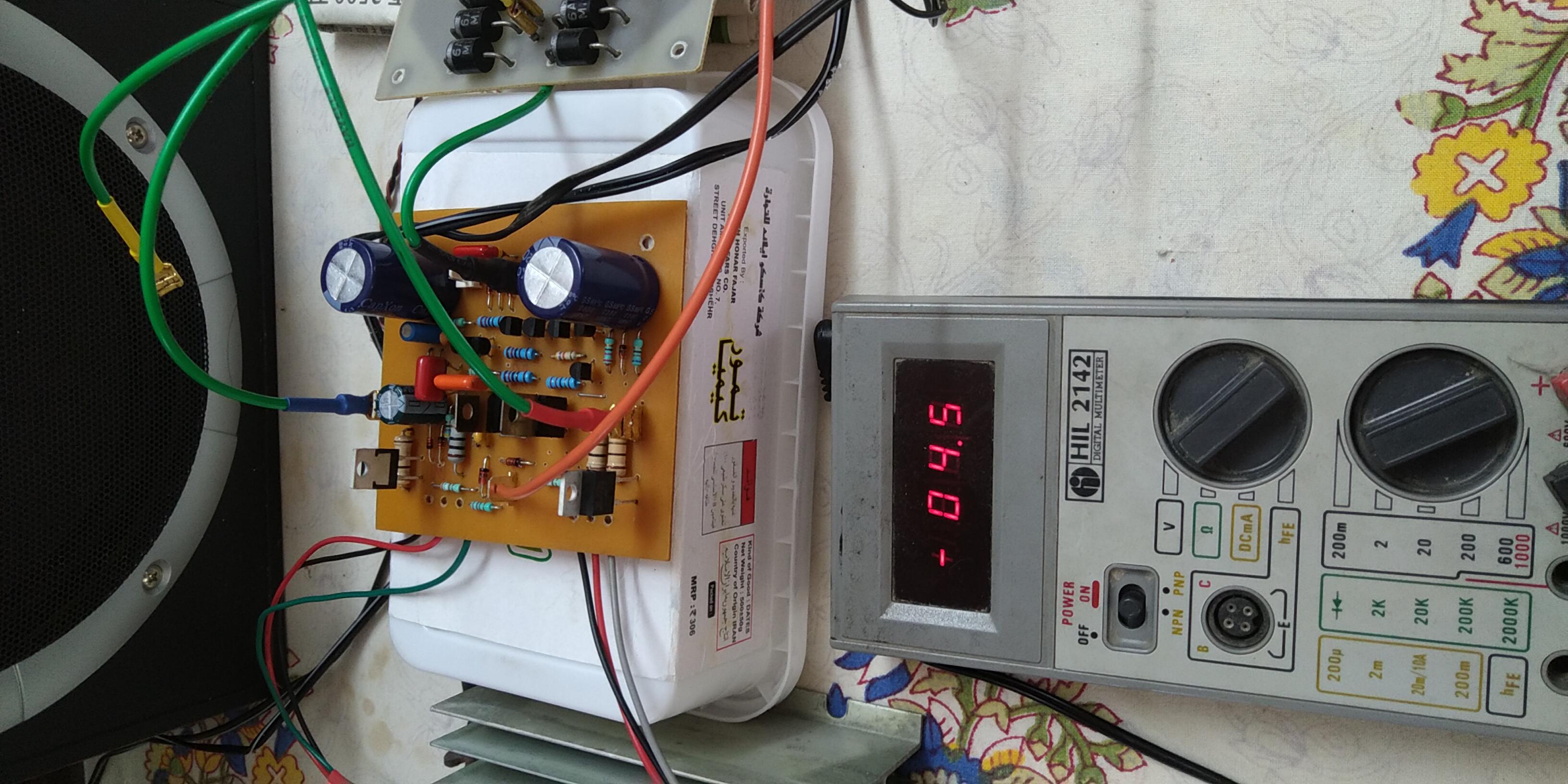

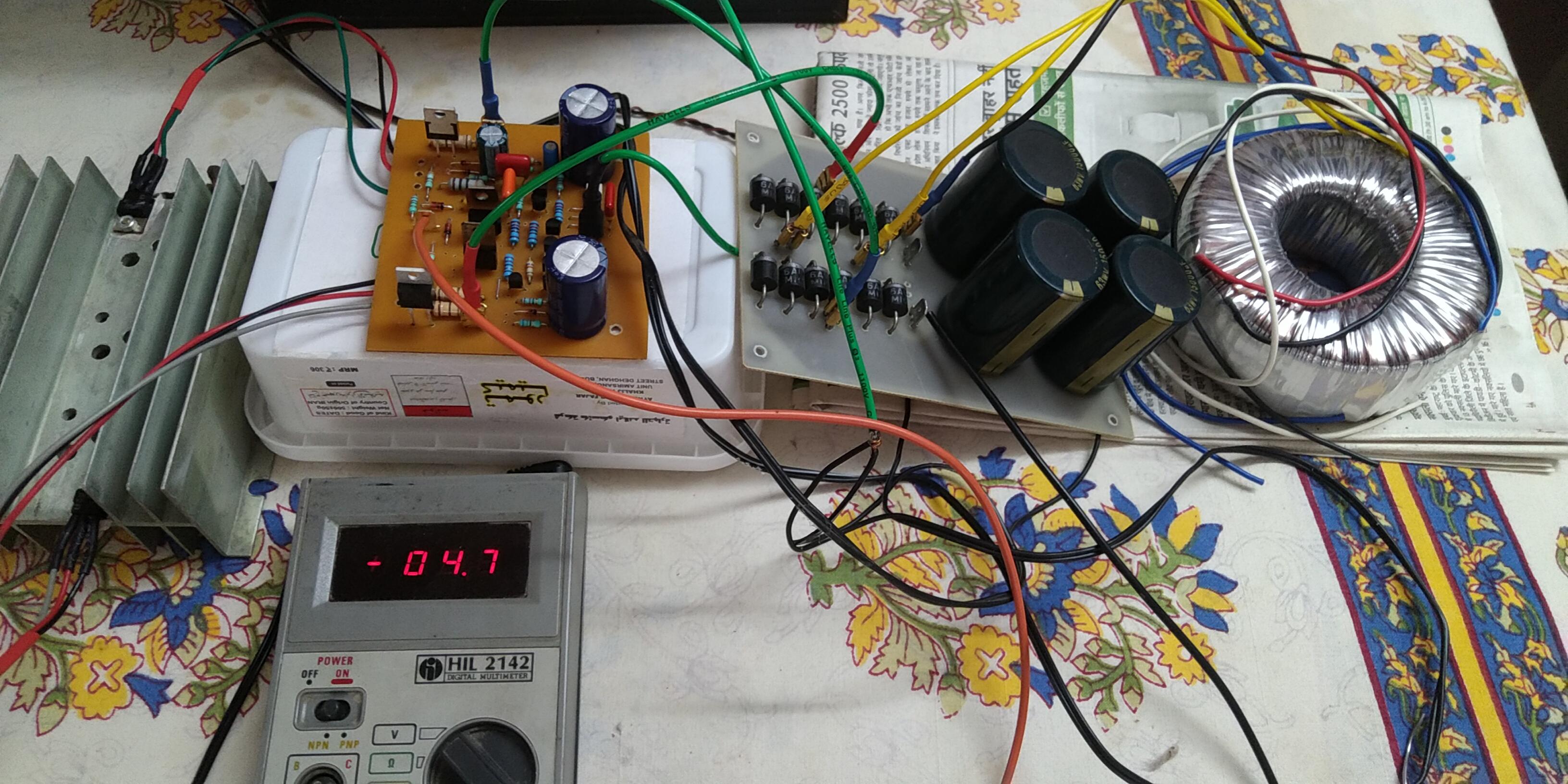

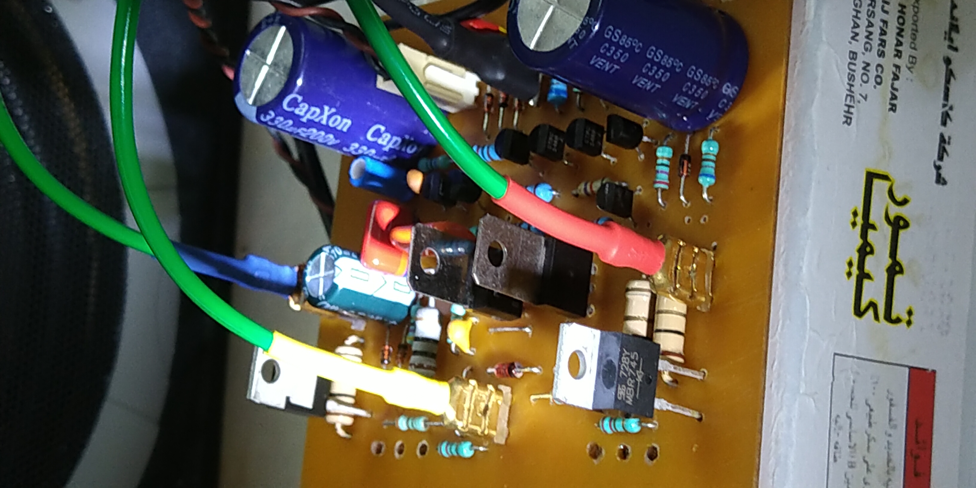

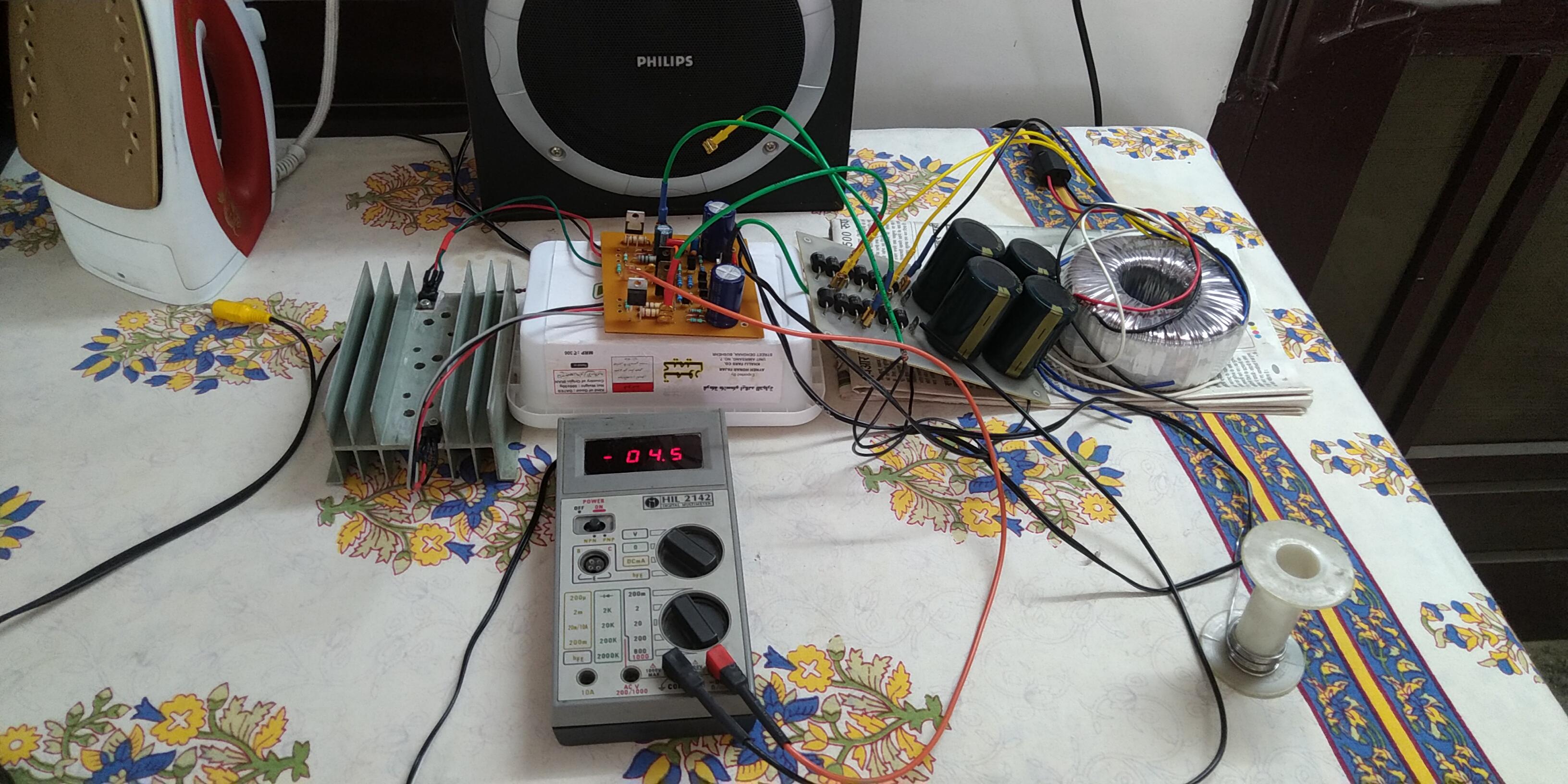

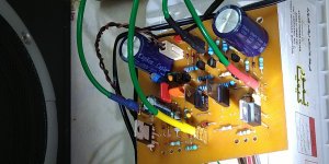

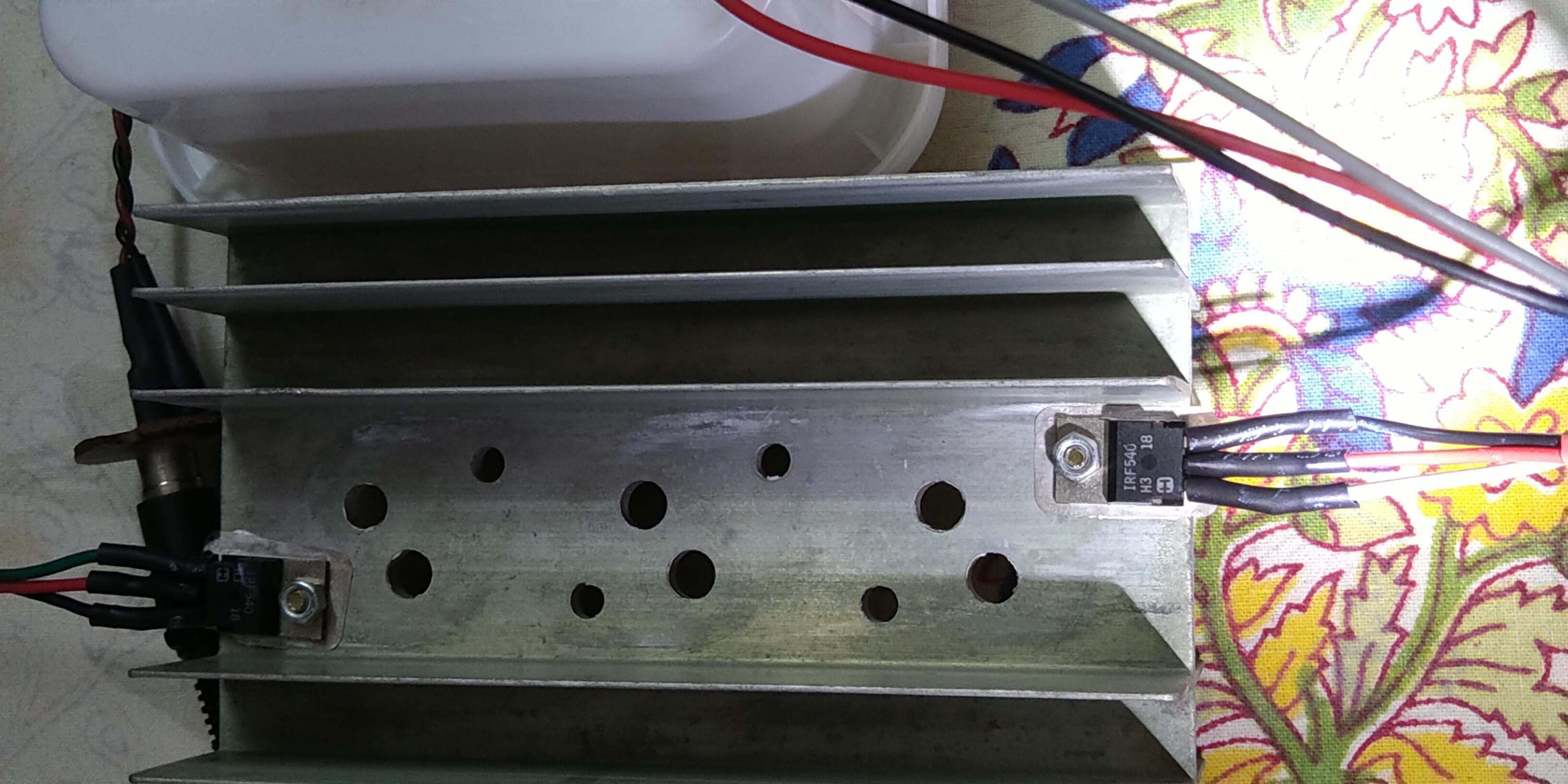

Wow, what a conversion from BJT to MOSFET version. I assembled the prototype today and was astonished with the performance. You are really a genius. Output offset is only -4 to 5 mV. No noise, no oscillations and no motorboating. The build is as follows:
Supply Voltage 24-0-24 V AC Toroidal with 30,000MFD capacitor bank.
1. BC 546 - CDIL India
2. 2N5401 - KEC
2. VAS BF870 (4.7 pf not used since I did not have with me)
3. BAT 54 Schottky - SMD under the board
4. MOSFET - IRF540 (Harris) purchased about 30 year back
4. MBR745 - Taiwan Semiconductors
5. Capacitors Polyster - Philips
6. Zener - 15V + 15V
7. R21- 47K
The only change from your circuit is addition of 220R gate resistors. Since I do not have scope, I cannot see the behaviourial change by this inclusion. I think it stops oscillation in the MOSFET at some stage during conduction.
Photographs are attached.
Thanks again
Katiyar

Nice build. I think you're the second one after me who built and shared a MOSFET Circlophone in this thread. I don't remember any discussion regarding gate resistors here. I highly suspect that they needed in Circlophone and I suggest that build other channel without them in order to observing any counter effect. Elvee would say best if they are safe or not.
EDIT: I forgot that Bangla H actually built and shared mosfet version too. So you are third at best.

The sonic clarity of This build is just similar to my first BJT build with 2N3055 as output transistors. Crystal clear sound with no distortion and dead silent with input short condition. The original pcb layout was developed by "Project16". I have tried to modify this layout to relocate the placement of available components and to avoid any possible earth loop which may cause instability and noise. Incidently the output offset voltage of both builds are within +/- 5mV.
I read some where that gate resistors reduce oscillations in MOSFET's during conduction at some stage, but I am not sure. I also request Mr Elvee to please check the effects of these resistors in simulation.
Any way I am extremely happy with this build and encouraged to make another build with higher voltage (+/- 50V DC) and IRFP240 MOSFET's.
