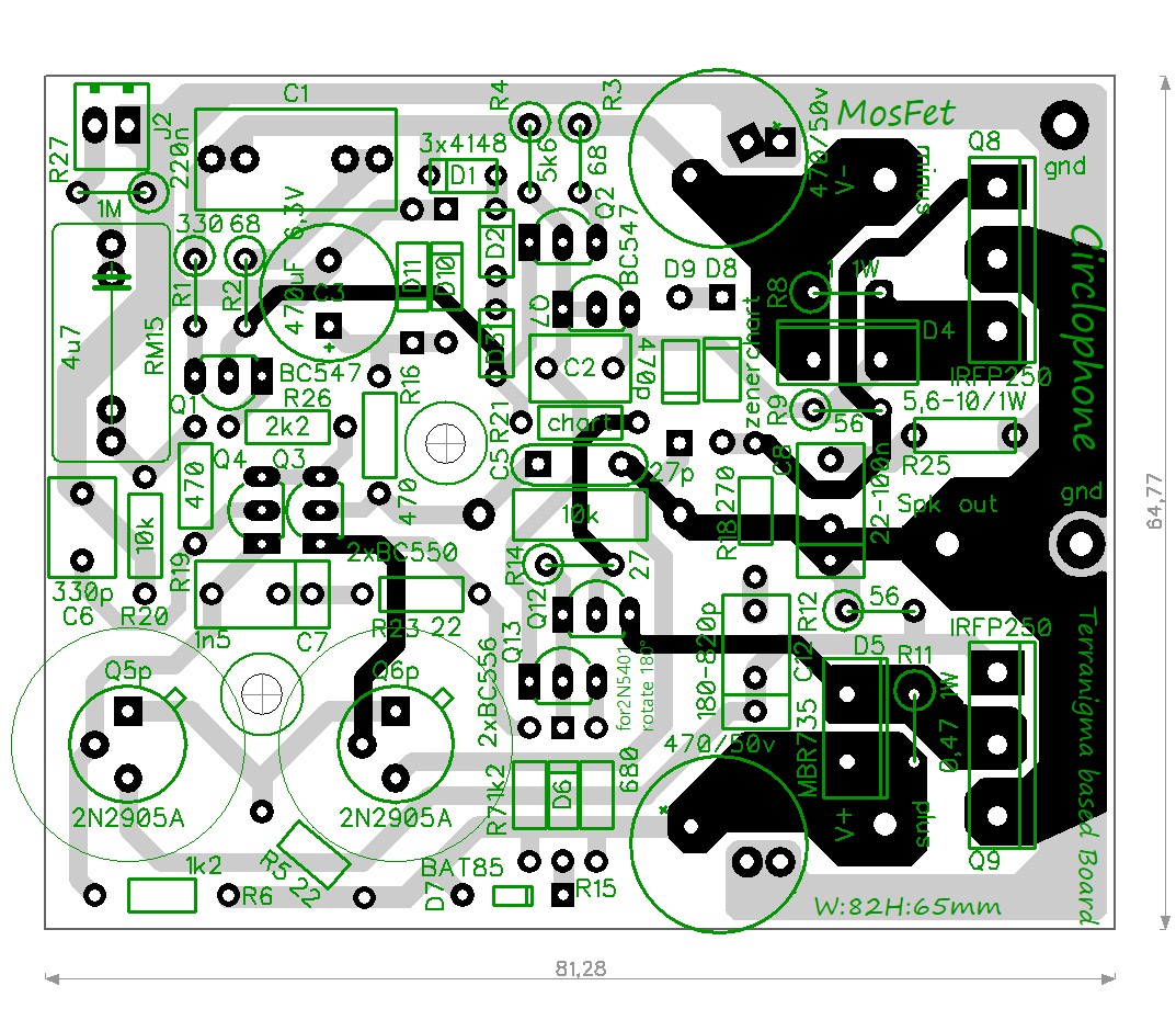

Hello Terranigma,
i use Diptrace.
And it's a pleasure to share the Gerbers.
Yes, there are, not to forget, other members who inspired to make compact layout.
I have also build a MosFet based with FQP24N08 for use with only 15VAC
supply.
A bit tricky TO220 to TO247 Pins.
It isn't finished yet...but close.

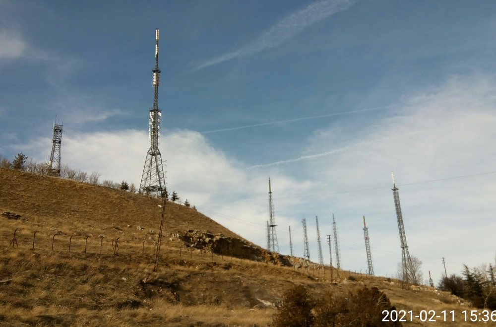

Except discarding the C5 from circuit completely. That was the most significant difference that I tried. It seems like that this cap introduces more noise when it is there. Amp is not dead silent but at least I can't hear the noise when I close to the speakers.
This clearly points to a strong, SHF (multi-GHz) pollution: C5 probably closes a small, local loop acting as an antenna. When it is not present, the input circuit is closed through lossy impedances which helps reducing the unwanted signal seen by the input transistor (and the resulting envelope rectification).
If you have no way of turning the source of pollution off, you need drastic measures, like an EMI-resilient PCB layout, a really tight RF shield (using conductive gaskets), etc.
Certainly not an easy task.
A ferrite bead directly threaded on the base conductor of the input transistor might help, but that is far from certain.
Hello Terranigma,
i use Diptrace.
supply.

There is no strict EMI regulations for residential areas here thus the photo that I took today tells much more than I can say. Thank you for valuable information. I will consider them for my next project. If I didn't experience the flat dead silence of the Circlophone before, I would consider the current noise level of amp without C5 as "silent enough" but certainly not.

Nice environment: with a bit of ingenuity, you can probably dispense with an electricity utility subscription completely, and harvest all the energy you need from ambient fields.... some people are really spoiled: everything for free.
There might be some minor downsides, but who cares really?

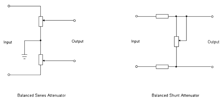

Elvee, I have a plan about building extra two channels (4 channels total) in order to feed the amp with fully balanced sources. I can't decide which balanced analog volume control option suits best for such use: two independent C's for each channel.
I found simple solutions as shown in the attached schematic. According to the "Balanced Shunt Attenuator" solution, I can make it using a stereo potentiometer for both channels. Other one requires a matched quad channel potentiometer.
Besides these solutions, have you any other solution for such need? You always come up with some very original and simple ideas. I wonder your evil mad scientist instincts tell something about this.
For now, nothing springs to my mind but I'll think about it
Other thing that I forgot to mention is that keeping output impedance as low as much possible, if it is doable without buffer when balanced source is used.
If a buffer needed (4 channels in my situation) anyhow, using my DAC's digital attenuator seems more reasonable option. The drawbacks of connecting the DAC directly to the amp are; dangerous instantaneous pops that may appear and reduced resolution at low volume levels.

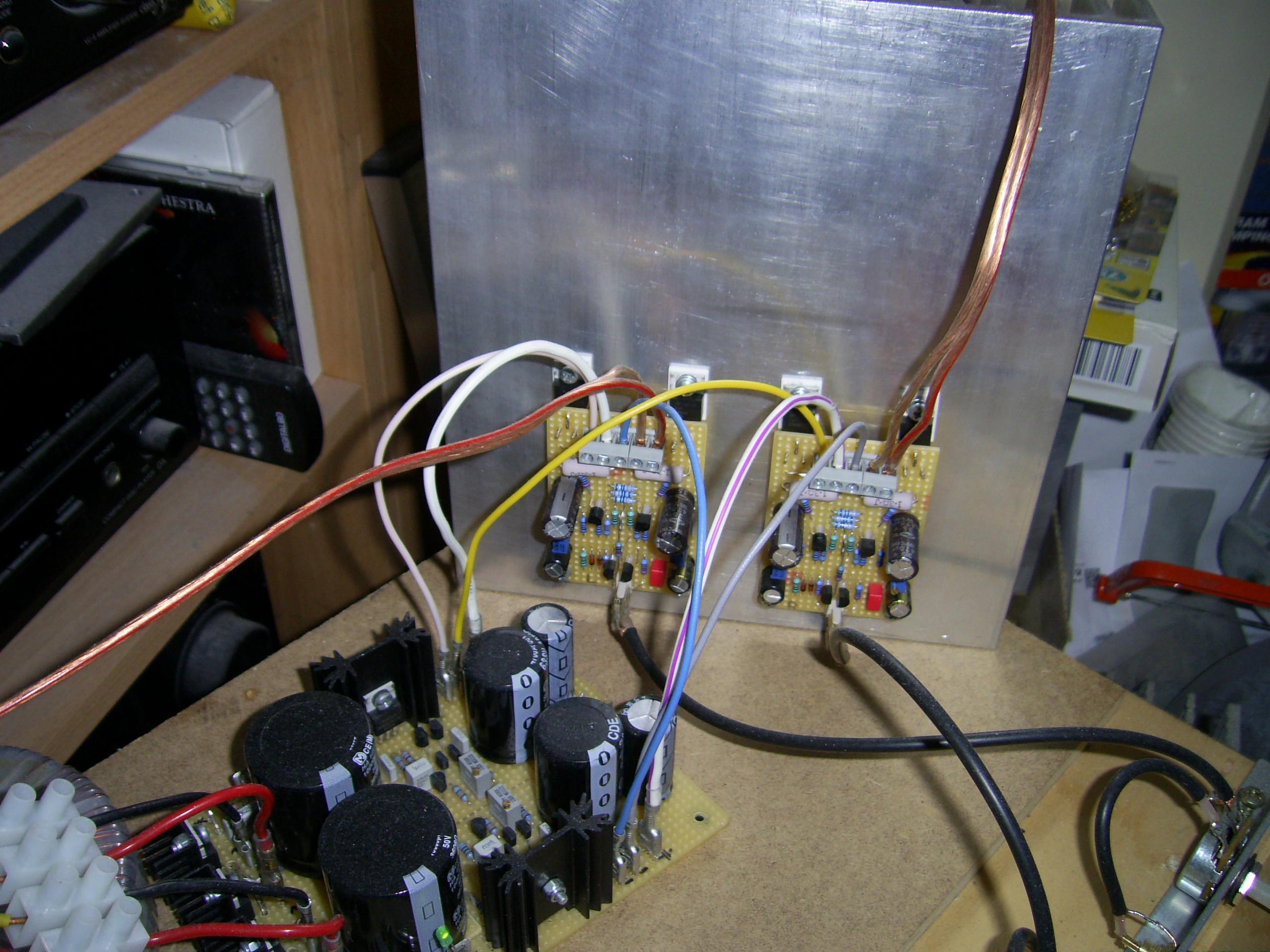

Hello Peufeu,
don't know if it needs that.
I have seen a pic with LU1014 doing that for Pass Amp.
As i said not finished, but the FQP was tested in a Juma F5 HA as mighty F5
with 18VDC biased to 0,5A. P-Typ: FQP27P06
The MosFet dissipates well and worked stable for any weeks many hours daily.
I have done some rework to the Terra MosFet Board ,so be careful to previous
showed, not sure about failures i have done.
Use Gerber Viewer for control. (GerberLogix)
Regards to All
  • Circlophone MosFet_Terra rev03.21gerber.zip
Regards to All
Very nice looking PCB. I couldn't see any layout errors but I can suggest one thing to consider: Can you add solderable track between vias of power ground at bottom and speaker output track at top? They seem quite thick but we can support the tracks with extra solder with no cost. I think ~3mm solderable track is enough. The long ground track that goes to the input section doesn't need that.
Thanks Terra for kind comment. I know i'm not an expert anyway.
About to do these option also in other boards i have to take the hard way to solve how many steps will work (described) as they should.
But next Time i will not find time to work on, because i move 700km away where i now live...new job, new people...new place.
Many more things to organize, you maybe now.
But i keep that in mind as to do soon as possible.
I am also curious if i can find out how to do...think with much scratching my head, sometimes with any words, not for every ones ears.
We will see. :eek: :mad: :2c: :scared: :crazy: so on.

BTW, I didn't have a light-bulb moment regarding your balanced volume problem (except weird ones that would only work in theory), thus your best bet is to stick with one of the conventional solutions
