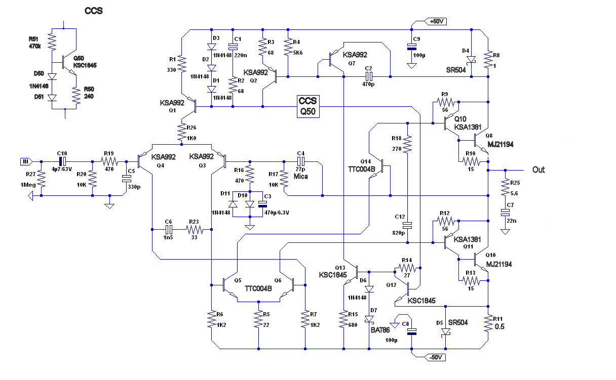

Few things I learned:
a) Circlophone is not "little" - it actually has 'normal' number of components/devices, especially when compared with 'prehistoric' kinds of amps
Compared to the 4-transistor Archosaurus, it looks complex, but most of the additional actives are just signal semiconductors, and the result is an adjustment-free amplifier, needing no thermal couplings.
Its performances are also vastly superior
b) it's also not "cheap" - especially heatsinking. Unless one happens to have drawers full of old stuff (like original 2N3055s) and scarps of thick Alu profiles gathering dust in the garage
Yes, transformer, heatsinks, reservoir caps and case are the most expensive parts of an amplifier, but since the C is not picky about the components, it is generally possible to recycle a number of parts
c) "warm" class AB actually means "very hot" class AB. Good thing winter is coming soon.
d) my PCB design assumed much cooler temperatures, otherwise I would mount all transistors on the main heatsink.
The quiescent normally establishes itself somewhere between 150mA and 300mA.
Your 270mA is therefore in the range, a bit on the high side, and with 100V total supply, this means 27W/channel of quiescent power, certainly not negligible, but if you think it's bad, imagine what it would be for a full class A amplifier running from the same rails.....
You can safely reduce the quiescent current if you need to by increasing R21, or reducing the set current of the CCS playing its role.
200mA would already make a difference, and should have no audible effect, except the pure class A range will be slightly reduced
With both channels running for 3 hours (idle), with rails 50V, temperature of the heatsink (drivers + vas) rises to 83 C.
A bit too hot for comfort, and unfortunately your options are limited: decrease the supply voltage or increase the sink size
Main heatsink for output transistors runs at 50 C.
That's perfectly OK: warm class AB, but if you want, you can reduce it by modifying the Iq
Not sure if my infrared termometer works correctly - it gives higher temperature readings on black/dark surfaces, and lower readings on shiny aluminum surfaces..
83 degrees is measured on black anodized clip-on heatsinks.
A thermocouple inserted in a small hole would give much more reliable measurements

This is my circlophone "As Built"

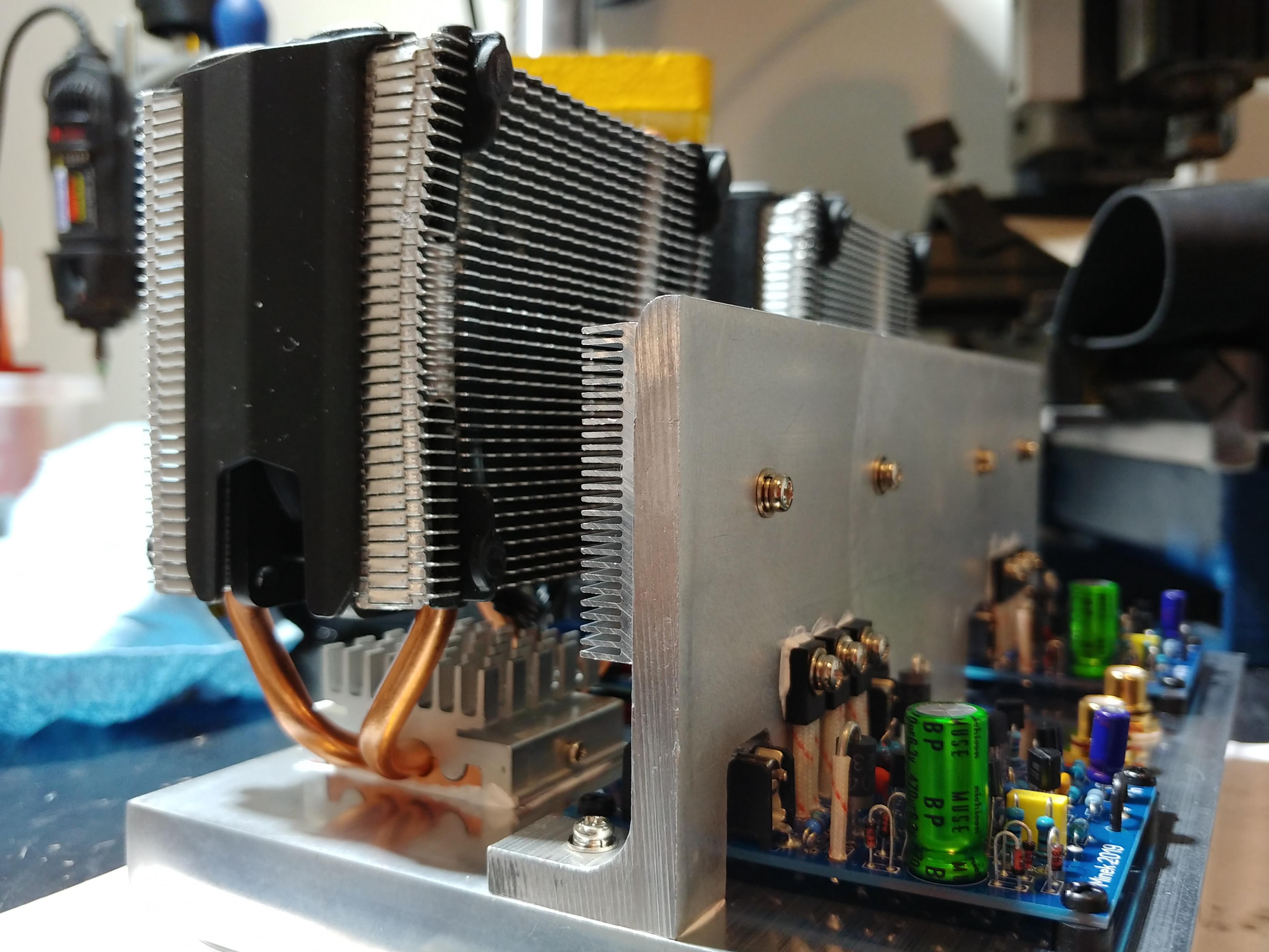

Here it is: more beefy circlophone with bigger heatsinks for drivers/VAS,
and 2 active fans with heatpipes (speed controlled by temp sensor).
Output transistors (MJL21194) are mounted on the main aluminum plate (0.75inch thick), directly under heatpipes.
If this setup runs too hot, I guess the only solution remaining is liquid nitrogen
cooling :)
I'm OK with temperatures up to 60 degrees C when idle.

I've been testing bigger circlophone for the whole day.
Since it was built exactly the same as the first one, it also sounds the same.
Which means GREAT. Definitely the best amp I ever heard (again).
Runs COLD now. Fans are barely moving (very quiet!), and all transistors
are at approx human's body temperature.
For some reason, it draws more current than 1st version, when idle.
If it's more in the A-class zone, that's fine with me..
Differences between previous build and this one:
a) Added: 2 fans + fan controller + Lm2596hv (50V ==> 12V)
b) Q50 (CCS replacement for R21) is 2N5551 instead of KSC1845
c) R17 is 2 x 4k7 instead of 10k (didn't have 10k 0.5W, and 0.25W runs hot)
d) output transistors are MJL (plastic) instead of MJ (TO-3)
Conclusion? I don't see much sense now in building any other amps.
Circlophone is so EASY to build. Just solder all the parts, and voila - plug in speakers blindly, and it's gonna work. No need for any adjustments, measurements, etc.. Don't even bother with speaker protection :)
The quality of sounds it delivers is unbeatable.
Rich bass, all frequencies perfectly present; I didn't even know my speakers were so good (JBL studio 590).

Elvee, can you confirm if this schematic of Mosfet circlophone is correct?
No
All mosfet circlophone schamatics I found in the forum, are 'upside down' schematics, and got me confused :)
Yes, because they use NMOS: that's the opposite polarity of the CFP's in the regular C.
You could in principle use PMOS, but they are rarer, less effective and more expensive.
The sensible solution is to reverse all the polarities
Perhaps 390Ohm resistors should go BEFORE gate stoppers, not after?
In a correct schematic and if you use them, yes, but it preferable to dispense with them: they will introduce a small parasitic pole and eat up some of the stability margin.
In principle, as the MOS are driven from a high impedance source feeding the 390 ohm, they are not necessary.
If you need to connect the MOS via a significant length of wiring, a better alternative is to thread a ferrite bead on the gate lead

To avoid doubling the DC offset as in Rod Eliott's circuit, you can add a 22µF cap in series with R61 and make the bridging connection to the base of Q18.
Now I'm kind of wondering (it's a general question, not specific to Circlophone):
How will speaker protection circuit work for bridged amp?
I mean I trust circlophone 100%, no offense, but I'd still use speaker protection circuit :)
Is it OK to detect DC between one of the speaker terminals and the ground?
Or detect DC between speaker terminals (no ground reference) ?
Also - Zobel network (coil) is only needed on one side of the speaker, I guess?
It will be one big *** amp - bridged Circlophone with 50V rails, TO-3 output devices, 3kg of aluminum chassis, and 2 big fans with 4 heatpipes each :)
One is not sufficient: you need both
That could work too, but I am not sure it is going simpler
In principle, yes, but I wonder how it would behave on a very long cable
