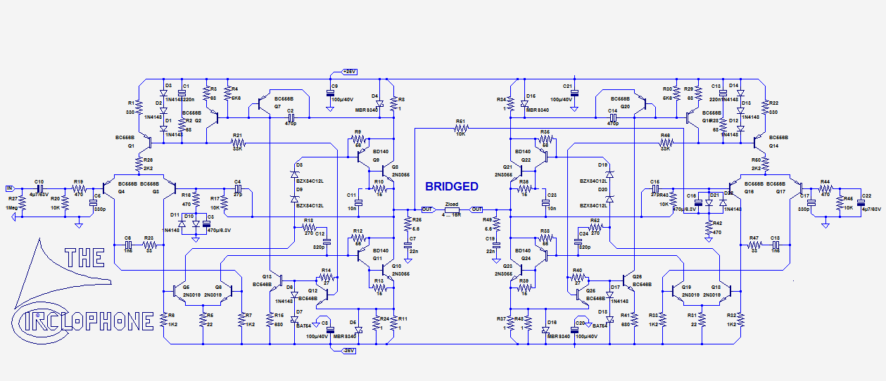

Just like the majority of modern amplifiers, the C. can be bridged: it has both inverting and non-inverting inputs, the rest is a question of resistors and topological optimization.Hi Elvee,
Is it possible to bridge two Circlophones to get more power?
Thanks,
Bibin
I will try to offer something effective and sensible.
Note that the C. can work with voltages as low as 10~12V (must be somewhere in the thread, I don't know exactly where), but as there are no miracles or free lunches, the output power will be limited by Joule's law.
For a modest yet significant upgrade without the complications of a full-feature regulated converter, you can always turn to Boostor, a simplistic unregulated charge-pump converter:
http://www.diyaudio.com/forums/power-supplies/212945-boostor-ideal-companion-circlophone-move.html
Here is an example of bridging; it does not particularly shine for its originality, but at least it should work without problems:Hi Elvee,

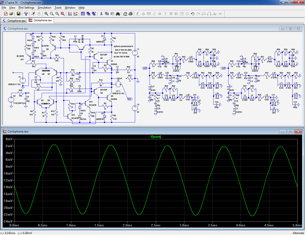

Here is the test using your 3 way model, first the "normal" way. I have paralleled two networks to push the amplifier to its limits in order to show possible problems:Setting the Amplitude and frequency variable in sine gen of LTSpice to {inlvl} and {fre} resp. for ex. then Spice command .step param inlvl 0.01 1.1 0.05 and .step param fre 100 5000 500 give one logfile with all of these combinations for .four {fre} V(OUT)
The basic Circlophone behaves quite good but one can observe there is still crossover distortion left . One should plot the 3rd and 5th harmonic. However another very popular DIY amp does not so well - i don't mention which one. Preferably the load should be a Spice model of a 3 way passive speaker. What happens when a signal is fed in the output via the voice coil model -inductance and resistor in series. Hum...it attenuates 10 volts sine gen to just 0.8 Volts at output and oscillates. Provided the simulation is about correct then Circlophone cannot cope with the emf signal of a speaker. Try yourself - don't forget input must be grounded

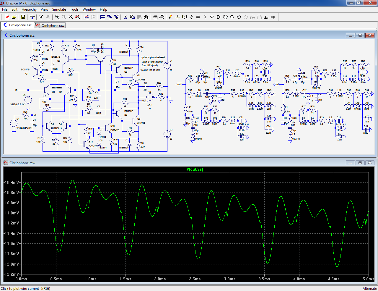

The trace shows the distortion residue extracted by subtraction from Vs.
Most of the THD is pretty mundane, mainly 3rd and fifth, and a small Xover residue-like is also visible. It is caused by the high current flowing through the 2N3055's causing an accumulation of charge carriers that aren't evacuated perfectly, in spite of the circlo-engine. The engine has a limited loop gain and manages to reduce the artifacts without eliminating them completely.
We have to keep in mind that these are extreme stress condition and that the THD in these conditions is 0.002%, of which a very small fraction only is due to these artifacts: well below the ppm level.
Now, let's see what happens in the conditions you described: here, the output is driven from an external 22V sine source (10% higher than the supply rails) through your doubled model network (which is not particularly gentle, as it drops to 3Ω at some frequencies).
V(Nout) is the residue present at the output now acting as a virtual ground: it shows nothing abnormal, just a very low and slightly non-linear impedance, something to be expected from a decent amplifier driven well beyond its limits.
No sign of latchup or similar pathological behavior.
These are sims of course, but the actual tests I made and the experience of circlophone builders seem to confirm the good behavior of this amplifier, even under harsh conditions
