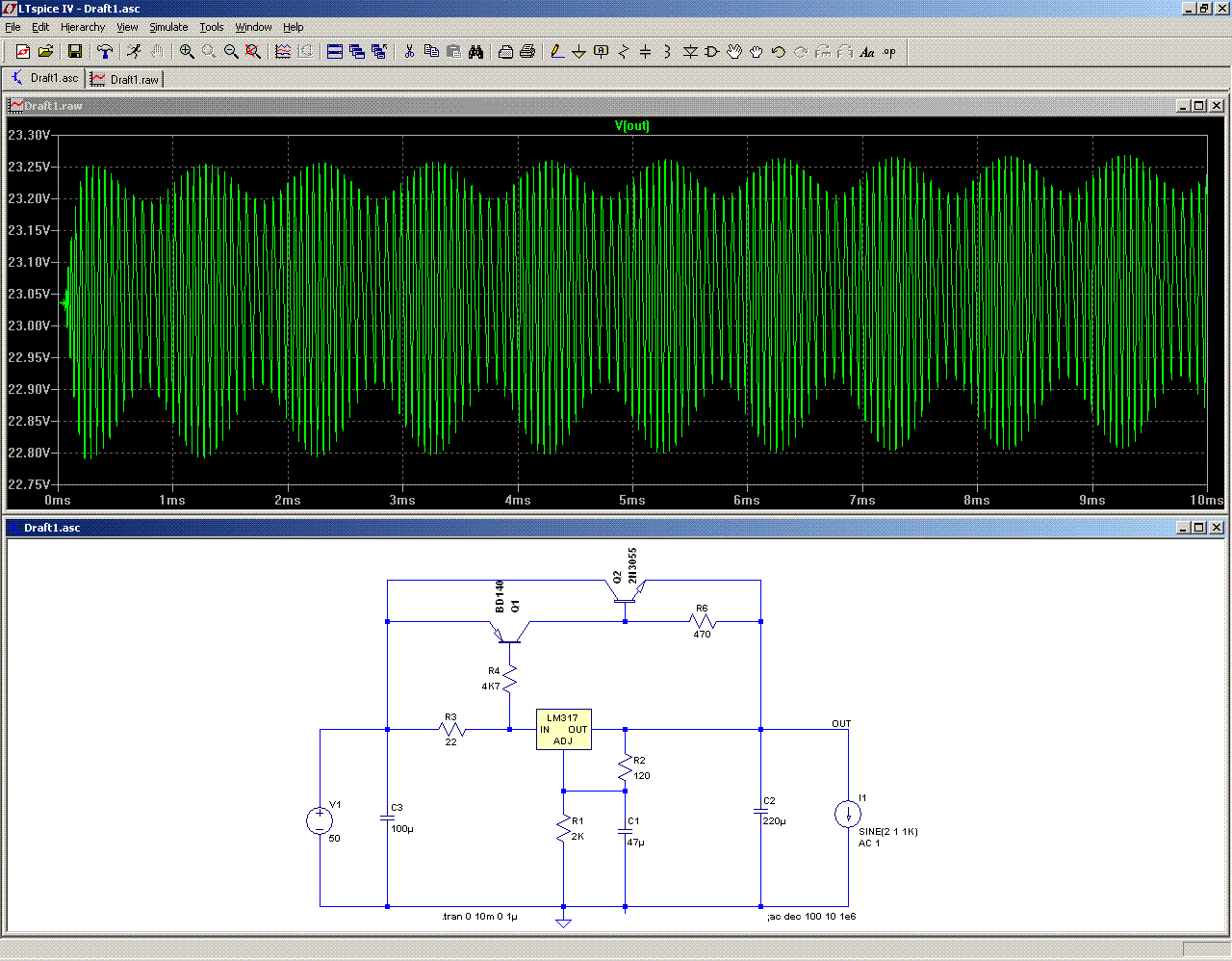

At best, a regulated power supply will not change anything, but in most cases (that is particularly applicable to "audiophiliacs" supplies), it will do some harm, because of an uncontrolled output impedance or downright instabilities, like in this example.
I guess this one must seriously "enrich" the harmonic balance of whatever it supplies:

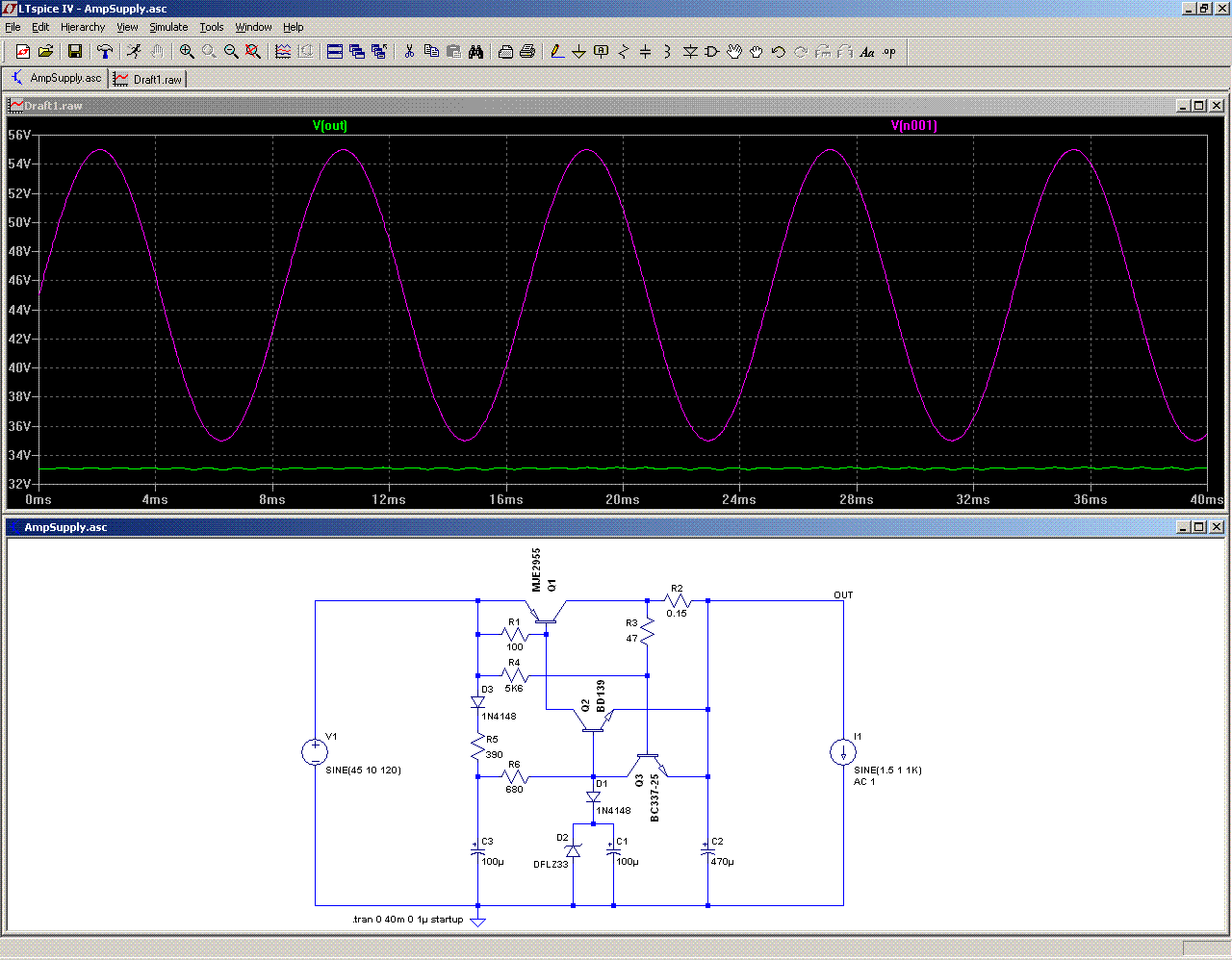

If one needs to limit the voltage to a level safe enough for the transistors, here is an option (but, of course, it shifts the Vceo requirement to the supply transistors).
It is crude, minimal, but will not play silly tricks unlike the previous example.
It also includes a foldback limiting.
Hope this settles the matter once and for all.

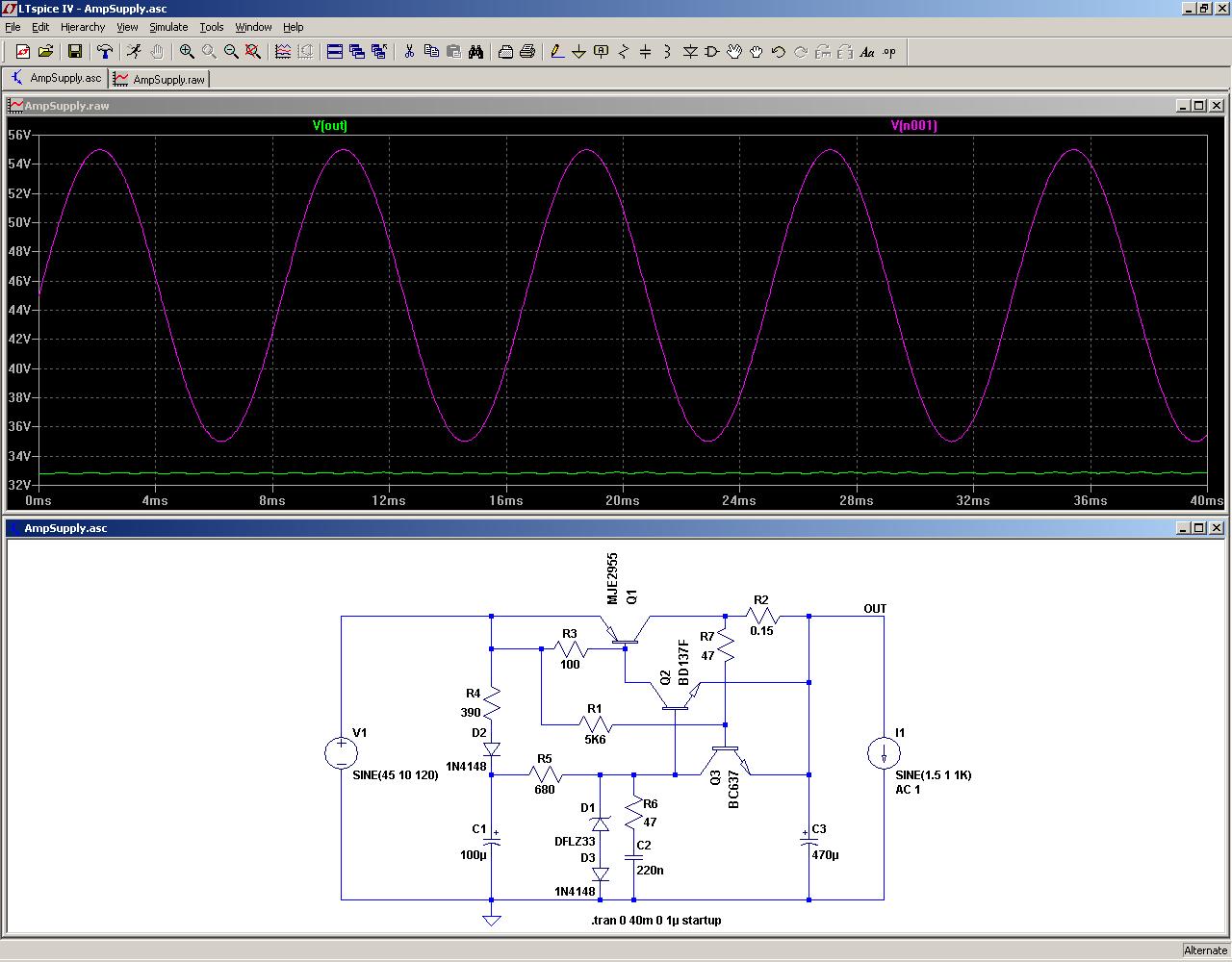

That is looking really elegant.
I've got a few questions:
Does it reduce ripple?
Yes, the sim shows the circuit in full action: the magenta trace is the input voltage having a 20V/120Hz ripple level, and the output is simultaneously loaded by a current varying from 0.5 to 2.5A at 1KHz.
Even under those conditions and a 2V operating margin, the rejection remains good.
Can it be set to 40v?
Yes, any zener or combination of zeners giving that voltage is suitable: 39V if 1V is not a problem, or two 20V, or 18V+22V, etc.

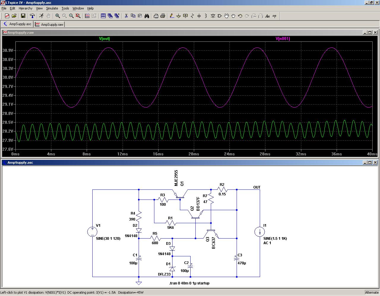

What happens if input voltage is lower than the zener?
It degenerates into an electronic filter (not with the insane level of ripple shown there: with a more normal level of several volts):
