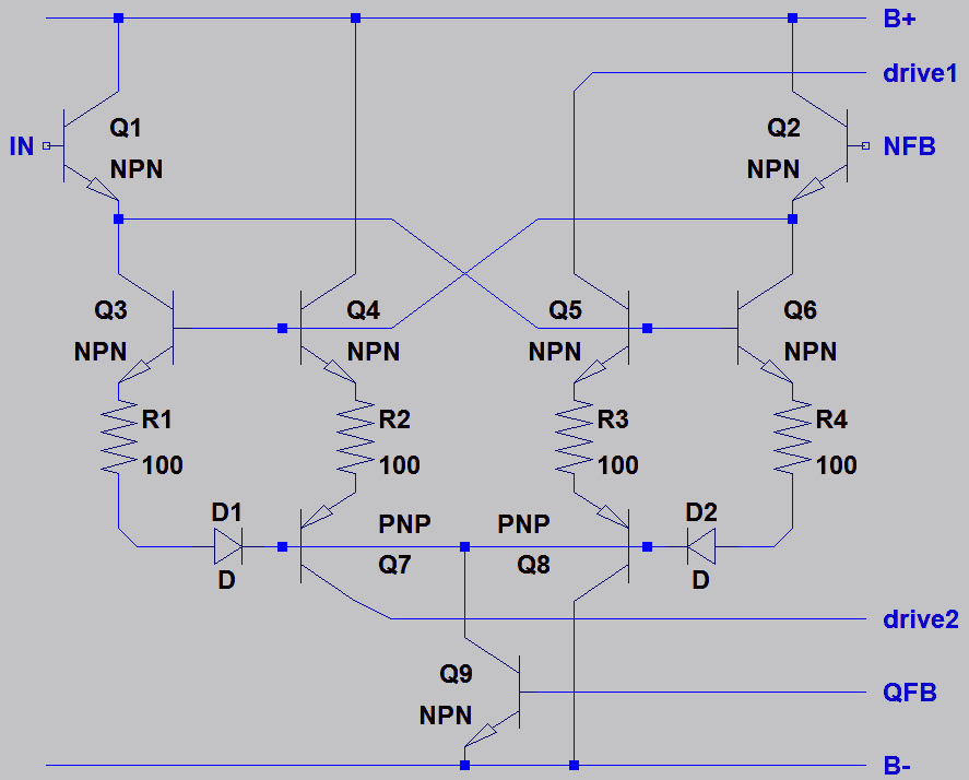

http://www.diyaudio.com/forums/atta...little-cheap-circlophone-circlophonekpmod.gif
Q14?
We wouldn't have to source various zeners? One transistor instead of a mess? Now, that is nice! Has this been tested? Can Q14 be the 2n5551 or a generic BD139 (est~30pF) or the 2sd669a (14pF)?
It has not been physically tested , but there is little that could go wrong there. And since the transistor is cascode-operated, its characteristics are almost irrelevant, you just need transistor-action with the right voltage and power ratings.

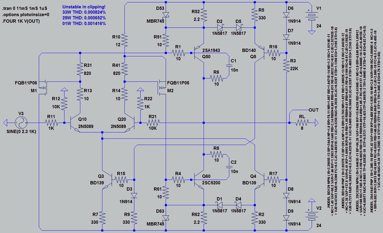

I have made another type of low power amp, it is the Tringlinator, based on the Tringlotron topology:
http://www.google.be/url?sa=t&rct=j...lFb6uHQRg&sig2=oTF1jGTUaM1SUuf9RixcLg&cad=rja
This is much more stable in clipping with all BJT,
BJT distortion figure becomes nothing exceptional...
How to fix it to have best of both?
I wanted to use IRF9610, for the 200V standoff.
But that .model makes it crazy unstable! Maybe
high standoff not ncessary? As this one crosses
GND, easy to cascode the three affected devices.
M1,M2,Q5. Cascode not making any more or less
stable, nor changing the distortion that I can tell.
Ring of Two (BJT BJT) or (BJT MOSFET) also not
stable for threshold detectors on the right side.
Diodes references for unknown reason, not giving
me the same grief...
8 Transistors (including the MOSFETs). But the
supporting part count is still higher than I was
shooting for... Some of the stoppers clearly are
not stopping much, and could go if the main
problem with stabilty was solved. It goes full
triangle by 40KHz, but even thats not got it...
Those Taylors are made not to ever shut off.
I don't know if thats part of the problem?
  • Draft77.asc
  • IRF9610.mod.txt
Actually, a diode bridge between gates seems to fix the clipping instability.
Limits gate voltage difference to 1.4V, now hard clips and recovers clean.
Guess this also limits the maximum error stored in gate charges, thus the
quick recovery?
Still can't get this thing past 40K. If I ease up on comp, goes banannas.
Lessening the open loop gain helps stable bandwith, but hurts distortion.
Like for example: source resistors, or using a BJT limited by beta. Going
other way, to a MOSFET with even higher gain, stability is unobtanium.
Maybe I am pushing too few transistors for way too much open loop gain?
Feels like xquad again, though I doubt any negative resistance is at fault.
