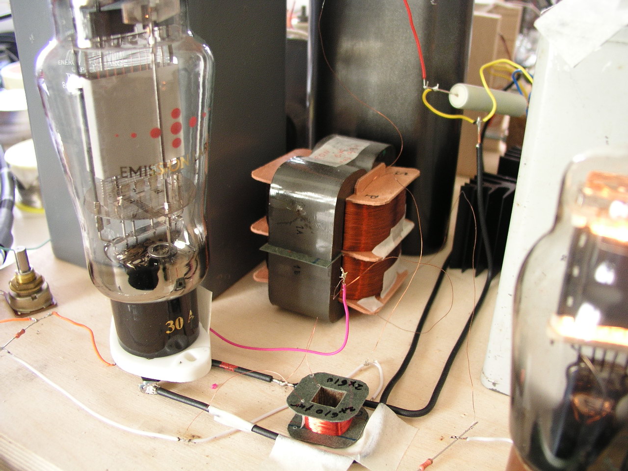

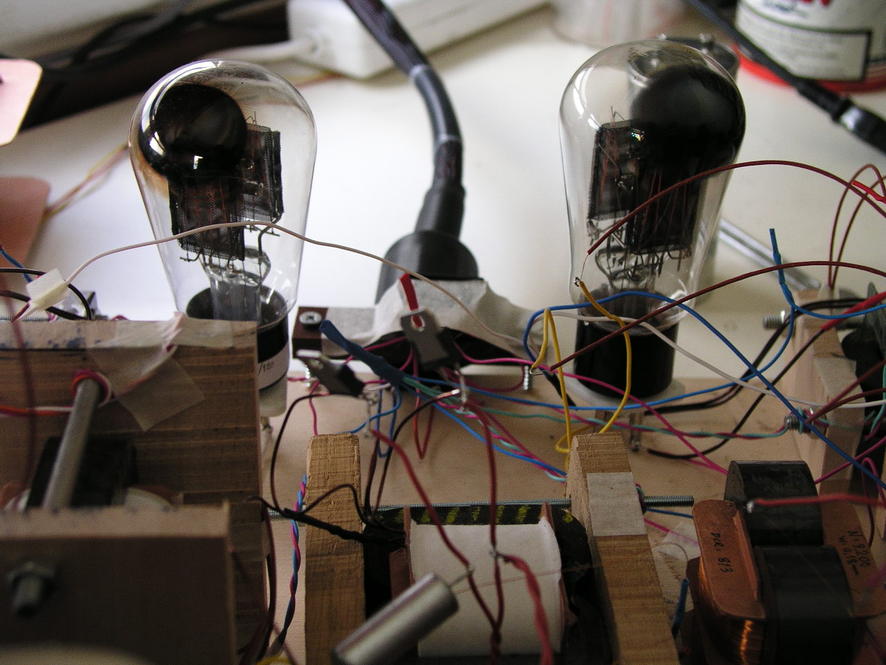

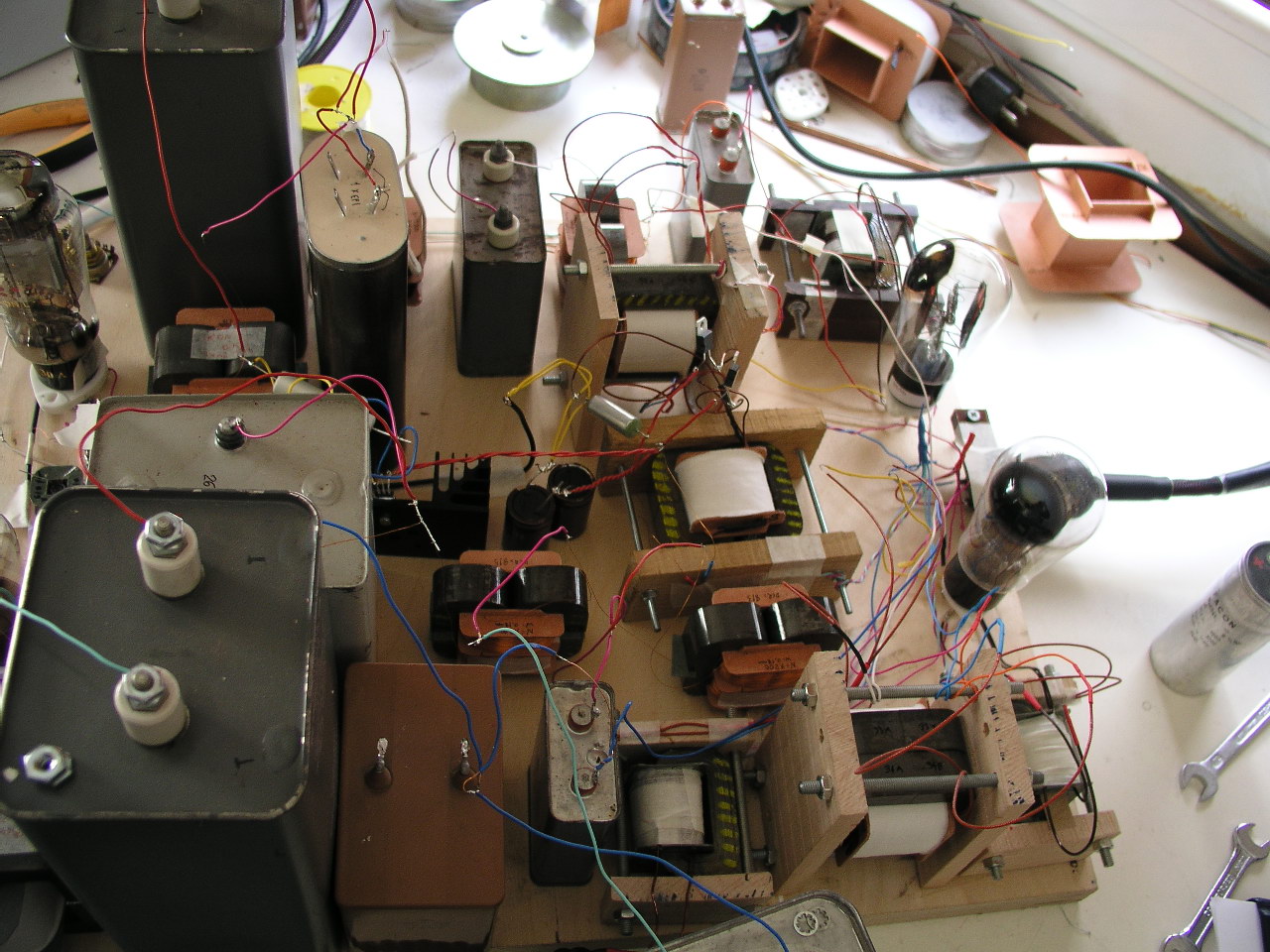

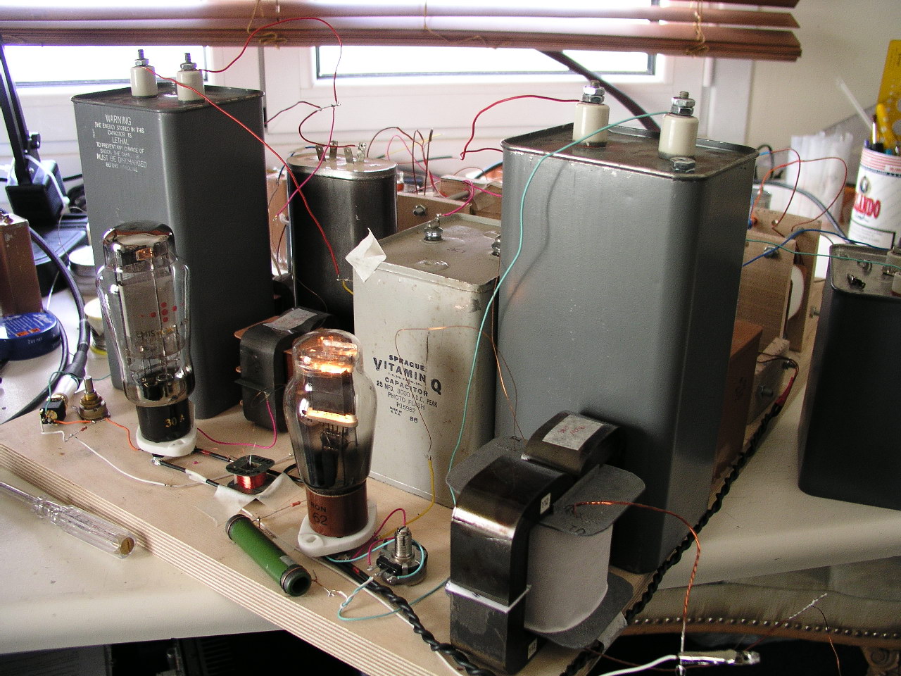

I decided to share with you my last project, to build a power amplifier around the american 801A tube manufactured by RCA.
The amp is a two-stage design with directly heated triodes throughout. The power tube gives around 4 watts of A1 power at full bias but is a small giant, as it can be driver further than 0V Vg, so you need a good driver to squeeze A2 power.
The driver is Emission Labs 30A, with a gain of 32x and good plate impedance to drive 801A in Class A2.
All power supplies include only vintage oil capacitors, there is nowhere any electrolytic or modern "Hi-End" cap, their sound is rather mediocre against those beasts. The only electrolytic found is on the filaments of 30A, current source driven, where 801A is AC heated, with only 14mV or ripple on the speaker.
The tubes are power by double Pi filters, rectified with my favorites RGN4004 by Telefunken, quite possibly the best rectifiers ever made!
All power supply transformers, rectifier filament transformers, power supply chokes, interstage & output transformers are wound by myself exclusively, signal transformers are made of 0.1mm CRGO c cores. Even the cathode resistor of 30A is bifilar wound non inductive, with monocrystalline enameled copper wire. Only C Core transformers are used, there is nowhere any crap E-I iron.
I'm now fine tuning the sound of the amp with different brands of oil capacitors. This amp will drive a pair of 8" Telefunken field coil loudspeakers, powered by one Telefunken RGN4004 each.
I hope this project will give really good sound. I will be posting newer pictures as the project goes on.

Hi!
Wow! Impressive, with all those DIY transformers. The 801A is my favorite tube!
I agree with Gluca, DC fils on the 801A might be wirth trying. Toss the curenst source fil supply and go all passive LCL. Since you can wind your iron yourself, give it a try.
I plan some new 801A amps in the near future too. I plan to use a driver which is switchable between 26 and 801A.
Step up input transformer to get enough gain

Thank you very much for your kind replies.
This project is based on some ideas expressed through the Sakuma System approach. Transformer coupling, AC heating on the last stage and self-bias scheme. I have experimented and found that Mr. Sakuma has a very interesting approach, at least to my ears I have not yet listened to anything better. AC heating of the last stage is best to my ears, 14mV is not that high but for speakers less than 97-98 dBs it is good. I can lower it further but this is going to be tried later on.
I have gained adequate experience during the last years in the field of transformers winding, so I decided to finish up this amp. I have tried several transformers with mixed results, from mediocre to good, but not exceptional. I know that there exist some old Tango designs originating back from the 80's, they are considered to be the best ones around. These are all hand wound by myself and are fine tuned to the maximum degree for this design. OPT is a rather big load for 801A (16.3k) and the output power can be raised further, the Anode-Cathode voltage is only 530 Volts but the current is raised to 37-38 mA through one 1kOhm cathode resistor. All these are done for maximum sound quality and not maximum power.
The passive CLC solution is something I would like to try on 30A filaments, but I am expecting something better and something worse. To my ears, nothing beats AC heating on the last stage, if you can tolerate or manage the slightly increased output hum. The diodes quality affect the sound of the 30A driver, I currently use discontinued GaAs diodes with very good results, but have my old selenium diodes handy for my next listening session.
What I have learned from this project is that the 'tone' of each capacitor is of great importance, I could say unexpectedly high importance. All power supply caps do not have the same sonic signature, so far I have mixed american and russian caps with better results, but have not yet finished.
This is the starting point of this project. When the amp is finished, I will disconnect the output stage and mount my beloved Telefunken RS241 triodes. Tubes are pretty interchangeable, different filament voltage/current, different biasing but same OPT. I have some dozens spread around and would like to compare their sound against 801A. And the last step is replacing RS241 with RS237, the king of all triodes. We'll see, I have much distance to cover till then.
Vinylsavor, have you experimented with passive CLC filament supply? I guess I will need a hum balance pot on the driver and it is quite difficult to find a low value carbon film, as the cathode resistor is only 100 Ohms of maximum attainable quality, remember the resistor is DIY bifillar wound with monocrystalline copper! If I replace a great part of this value with crap wire wound pots, the sound quality will deteriorate too much! Do you have an idea here?
Thanks again for your kind comments. I will be back soon...

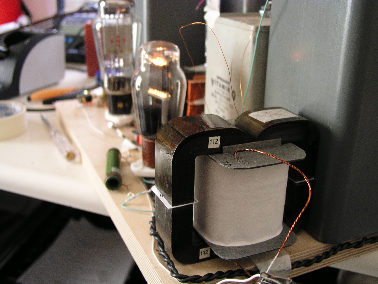

Hi Peter,
as Gluca pointed out LCL is the way to go on filaments not CLC. In fact LCL sounds better than AC heating! Make sure to have high enough inductance (several 100 mHy). You will not need a hum pot if you get the DC very clean.
No more intermodulation artufacts from AC filaments, sounds way better to me!
With regard to input transformers: You are right of course about the impedance raise. Of course I drive such power amps with input transformer with a preamp with very low output impedance which is adequate for the job!

Hi Peter,
also for the driver LCL is sufficent, if the inductance is high enough.
I used 801 drivers in this 45 amp with LCL fils:
VinylSavor: Making of an 45 / 2A3 amplifier
PSU:
VinylSavor: Making of a 45 / 2A3 amplifier, Part 2 - The PSU
The fil chokes are 0,4Hy with 30.000uF between them.
With such inductances LCL is even sufficient in preamps:
VinylSavor: More photos of the 801A / 26 linestage
Here I used 0.4Hy - 40.000uF - 0.4Hy
No hum. If it is good enough in a preamp it will be more than adequate as a driver in a power amp.
