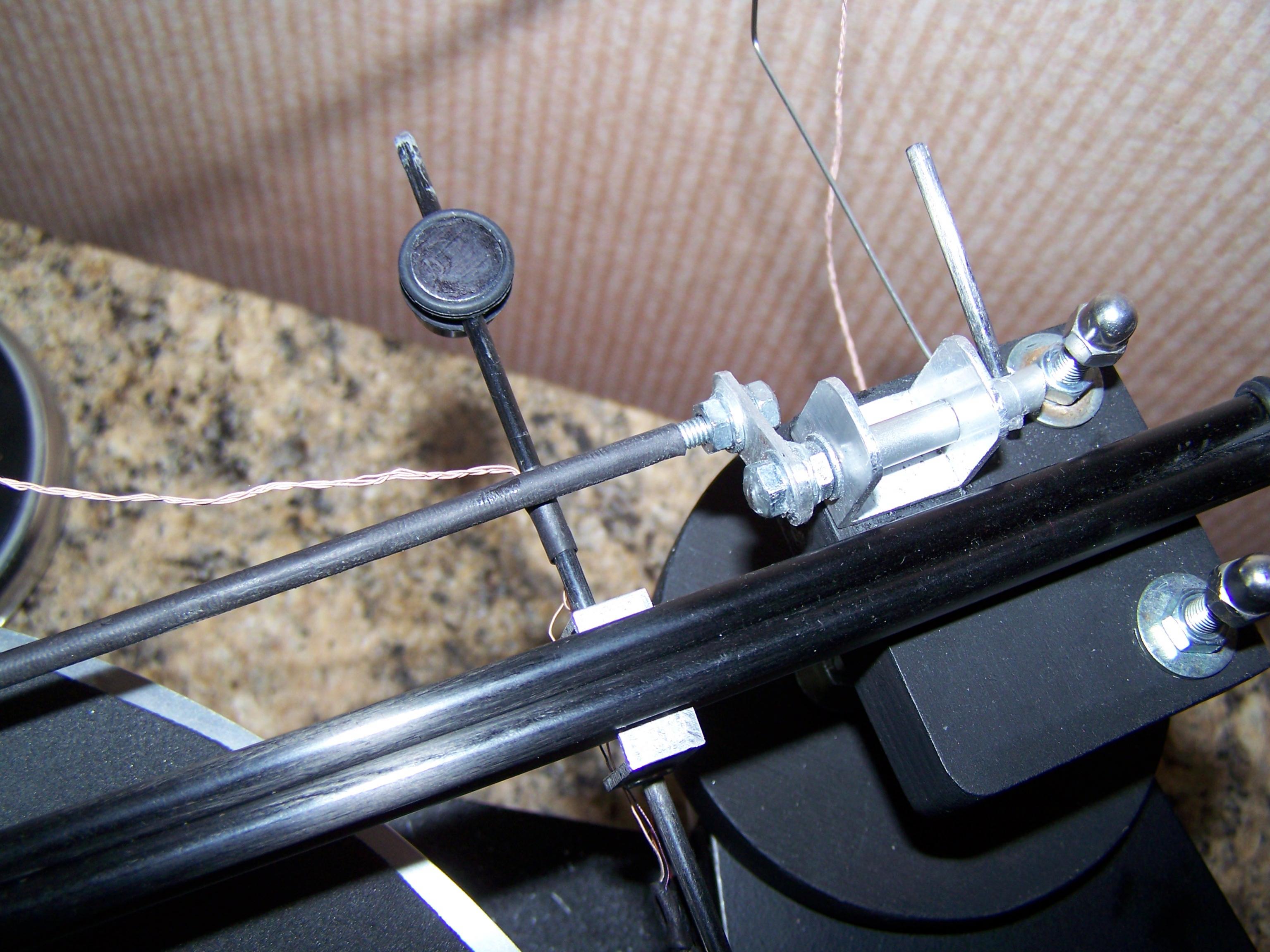

Hi
The tubes are 6mm aluminium. Top tubes are also 6mm but carbon fibre- I just had it lying around. How does it perform? Flawlessly. I had continual problems using ball races but with this, it has tracked everything I've thrown at it with no problems. And I have a few more improvements up my sleeve-when I get the free time of course!

Chris... Is the CF tubing thick walled, or a rod? I am considering a similar top carriage as I believe the low weight is important. Is it quite smooth?
Yours has a nice clan aesthetic to it, and allows me to see what's going on, but I'm looking forward to more pics. The lifter is a beauty 😉

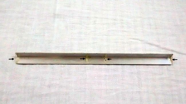

The Soyuz Linear Tracking Arm - Yet Another Version.

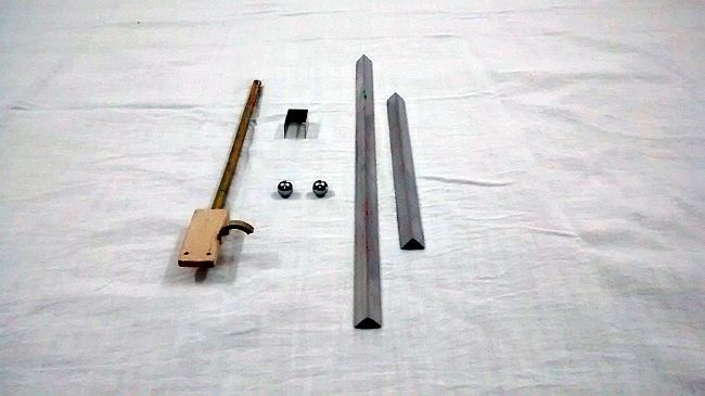

I got this design from an old British Radio and Electronics magazine from the early 1960s that has been in my possession for good number of years now. I found that the basic design and concept was similar to Soyuz's brilliant design and also to the Percy Wilson design - the same two rail and two ball and four contact points design was used here. Though this design appeared to be more stable as far as the run-away balls were concerned. Lack of time and availability of the correct size of vee-channel and ball bearings prevented me from trying out this design earlier. I had to use whatever size that I managed to procure locally. Finding the right size of ball bearing, too, took a long time. The validation of the design was carried out a couple of days back and I am reporting my findings so far. Soyuz's latest post #123 provided the impetus for me to post and share this version of his LT arm design.

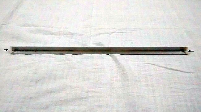

There are no changes to the basic design and only the lower and upper rails were replaced with lengths of aluminium 90° vee-channel or angle in place of the tubes that were used so far in the Soyuz design.
The components –
The lower rail had two stops glued to the ends to prevent the ball bearings from escaping from the open ends. The upper rail was divided into three sections by gluing pieces of triangular stops to ensure that the movement of the balls remained within the limits. Like so -
bgruhn had made an observation about limiting the balls' travel in his post #61. The original constructor of this design had used these stops in his design. Fifty years on Jezz-the-Fezz also suggested as much in Post #11 Para 2.
Hmmm, something about great minds thinking alike.....? 😀

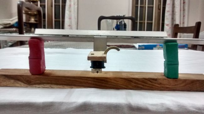

This is a frontal view of what I constructed for validation of the design. The gap between the upper and lower rail can be seen quite clearly.

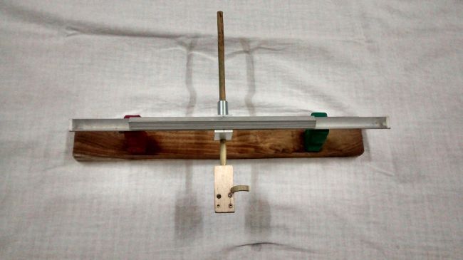

Another view -
More details and images to follow soon.

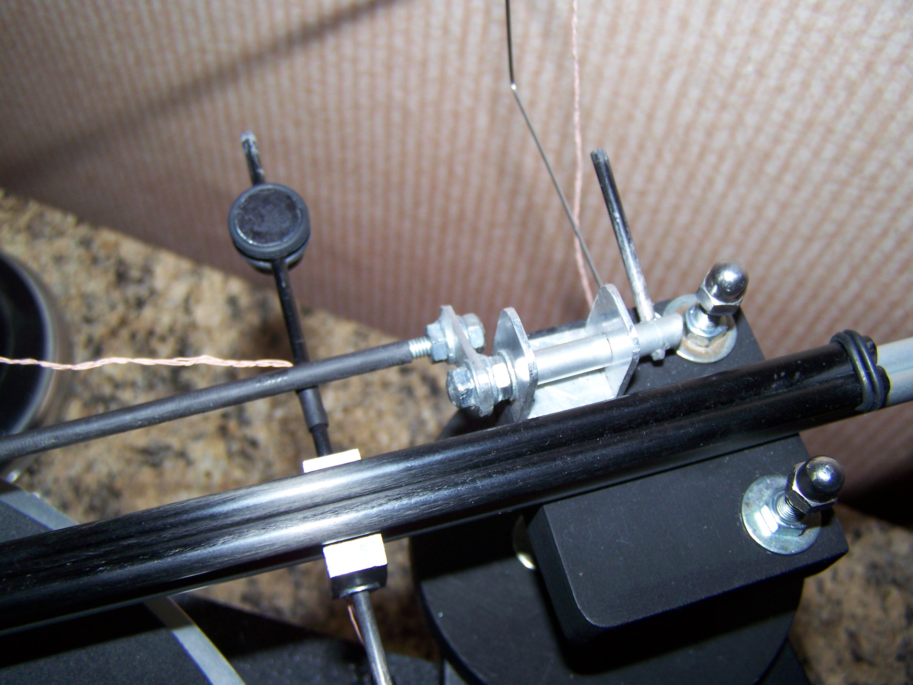

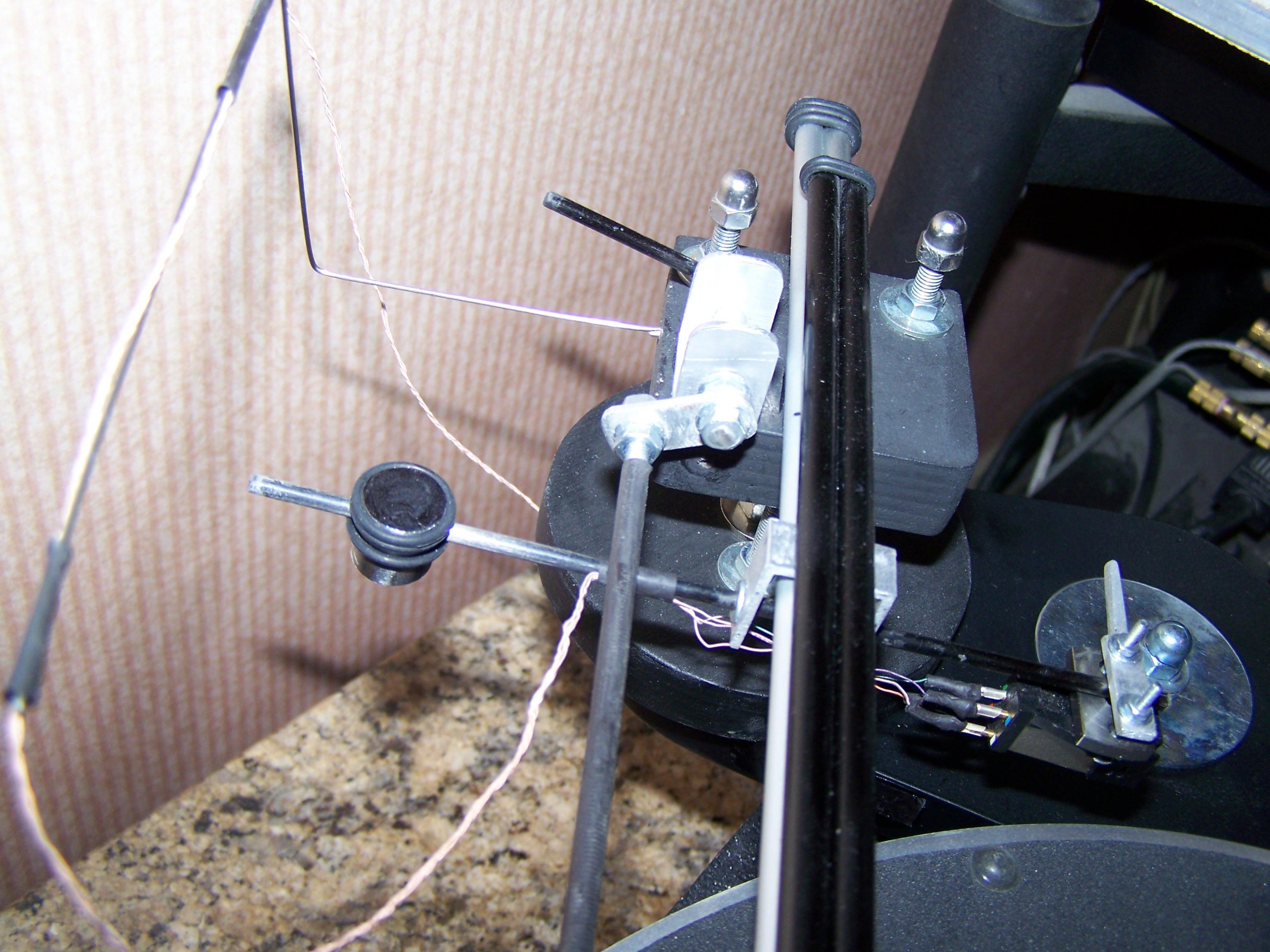

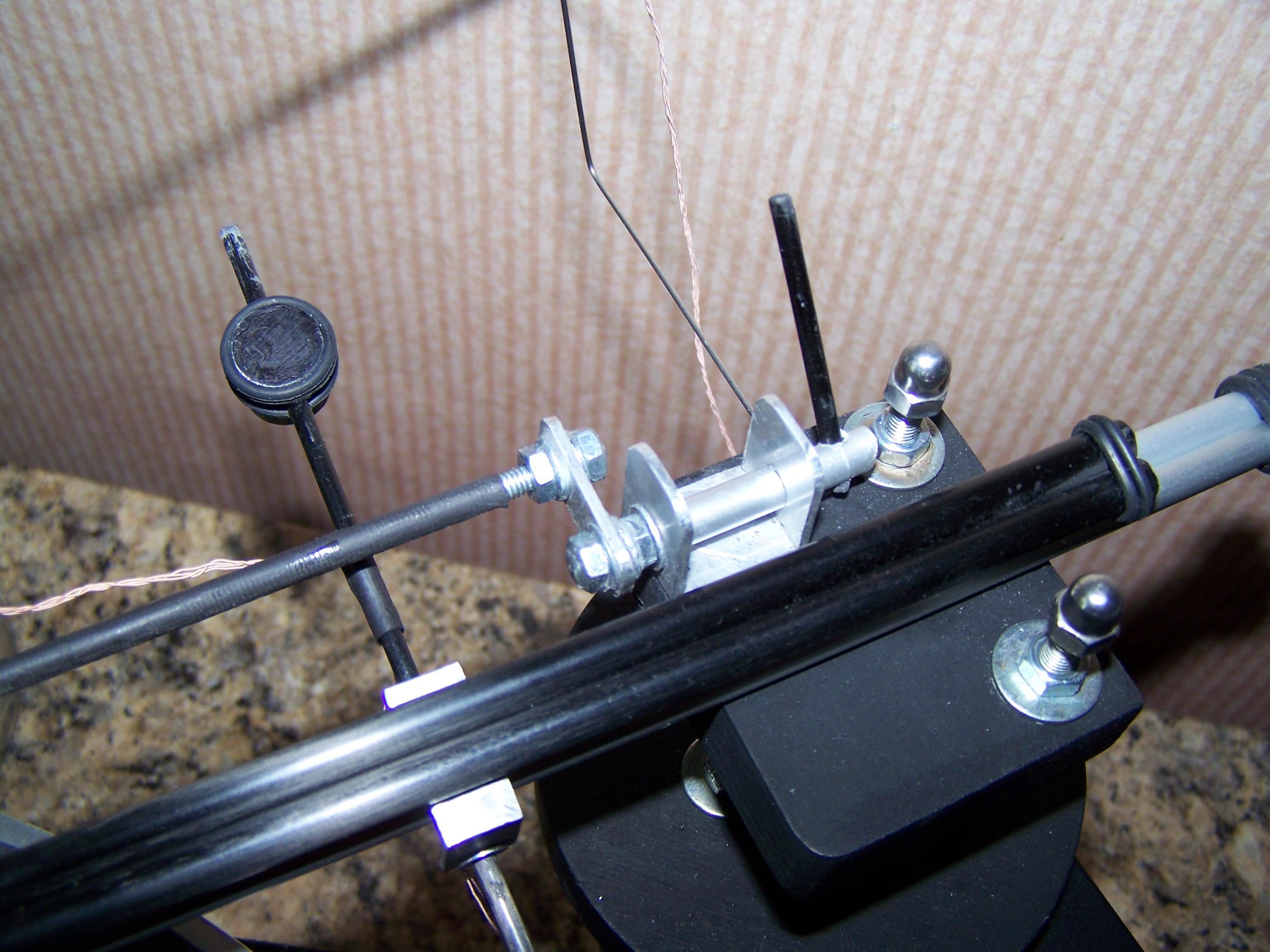

Lift/Lower Device
Hi Mortron
As promised. The carbon fibre tubing is some I had lying around. Very smooth surface and works a treat. I don't believe weight is a particular problem with this design as long as you don't go overboard.

To Muziklava-What size is the v-channel and what size bearings do you use?
Chris
Hi Chris,
½” x ½” (12.7 mm x 12.7 mm) size vee-channel
0.438” (11.15 mm) size ball bearings.
This gives a clearance of ~ 2 mm between the upper and lower rails. You can use standard 11 mm size ball bearings. I used what was available.

The Soyuz Linear Tracking Arm - Yet Another Version (Cont'd)
The construction of the rails and the bracket was done accurately for conducting trials while the tonearm ( headshell, wand and counterweight) is a mock-up made for the measurements.
The Materials:
For the Rails -
½” x ½” (12.7 mm x 12.7 mm) size aluminium v-channel or angle
Upper rail - 200 mm
Lower rail - 350 mm
The V-channels I used had only 0.5 mm thickness and felt quite fragile when handled so I cut two lengths of each rail and glued them together with Araldite for strength and rigidity. Allow about 24 hours for the Araldite to set.
Weight of the Upper Rail = 12 grams
The Upper rail was divided into three sections as shown in the third photograph in my first post. Four triangular stops were cut to the size of the channel and glued to it. Any thin, hard material like plastic or hardboard can be used. A pair of tweezers becomes quite handy here.
The measurements for the sections in my validation model were -
Left and Right sections - 3½" (89 mm) each
Middle section - ¾" (19 mm)
Note: The size of the Middle section can be made according to the width of the bracket used if one so desires. I have deliberately erred in favour of safety by using slightly larger measurements.
Two pieces of plastic tube were cut and glued to the ends of the Lower rail. This is to prevent the ball from escaping as well as to act as stops for the Upper rail. In any case the second use is not critical because the stops in the Upper rail serve the same purpose too.
Ball bearings - 11.15 mm diameter. Standard 11 mm diameter balls can also be used, if available
Weight per ball bearing = 5.6 grams
The Bracket was made out of a piece of aluminium and weighed ~ 2.4 grams
The Tonearm is a mock-up though made to actual dimensions. An old Shure 44-4 cartridge and stylus was used. Only the fitting, perhaps, may not be as accurate as desired. I only wanted this section for measurements and weight.
Weight of the headshell + cart + wand + CW = 26.2 grams
Total weight of Carriage = 51.8 grams
Weight is not a criteria for the Validation phase but I have left ample scope for weight reduction. The ideal weight for the entire carriage should be about 42.5 grams including the weight of the ball bearings.
The support for the Validation build are two blocks of Plasticine. Yes, those hideous red and green coloured ones. Quite convenient for setting up height and correcting the levels of the X and Y axes though! 😀
