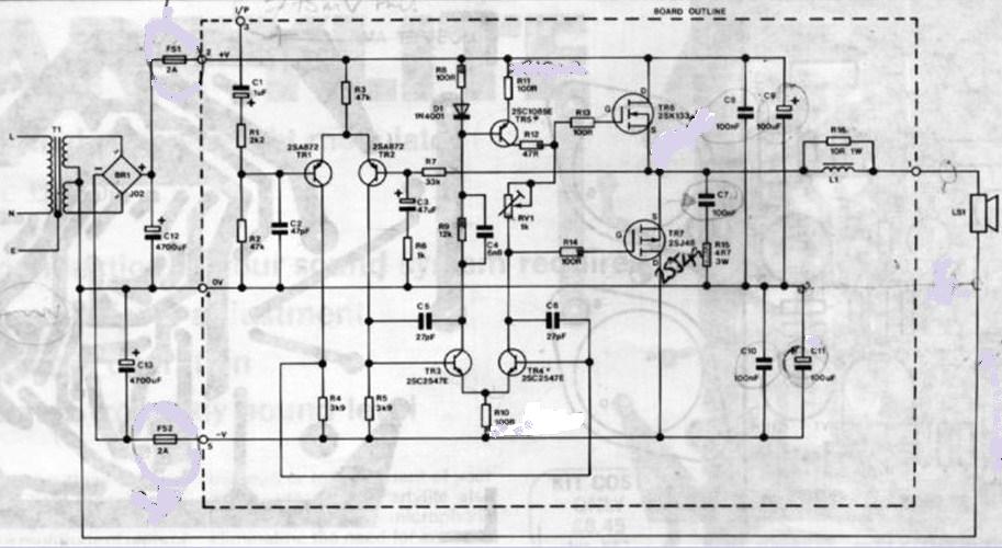

Any thoughts on that claimed slew rate ? It just doesn't seem possible to me on a number of counts. Designing for slew rates approaching even half the claimed figure is a monumental exercise. Is the slew rate "symmetrical" I wonder ie same positive as negative going ?

djk said:"I have suggested that the rail fuse rating be selected to pass about half the peak output current into the specified load. "
Which is what I mentioned:
"With ± fuses, the RMS speaker current may be 1.414 times the rail fuse rating "
Each rail current is exactly SQR(2)/3.14 times the RMS current in the speaker/load, or about 0.45. Which means the RMS load current may be about 2.2 times the rail fuse rating (assuming a resistive load).
AndrewT said:
It's not Rds on that is the limiting factor.
It's the gate drive voltage which needs an overhead of between 5V and 8V when delivering maximum power.
Actually no, it's Rds_on because with it being a fairly high value at approx 1.2 ohms, when passing current this creates a voltage drop from drain to source by simple ohms law, which at currents of several amps forces the source to be several volts below the gate which is swung close to the rails (drain) by the driving stage.
It is for this reason that higher voltage driver rails make little to no difference to overall swing when driving high currents with these type of output devices.
Not good for my brain cells. Will it hurt?
EDIT: how come RDS_on is 1.2 ohms? Current Hexfets like the IRFP240 have 0.2 ohms at 12A and I wouldn't expect that it changes so much when cutting the current by half.

h_a said:EDIT: how come RDS_on is 1.2 ohms? Current Hexfets like the IRFP240 have 0.2 ohms at 12A and I wouldn't expect that it changes so much when cutting the current by half.
These are 2SK1058/2SJ162 lateral MOSFETs. According to the datasheet they have a VDS(sat) of 12V at ID=7A and VGD=0 (an ugly way to spec Rds...) which renders Rds(sat)=12/7=1.4ohm.
Now, this is at the saturation limit (VGD=0). At small VDS, Rds is about half, or 0.7ohm.
Two devices in parallel will of course have 0.35ohm.
