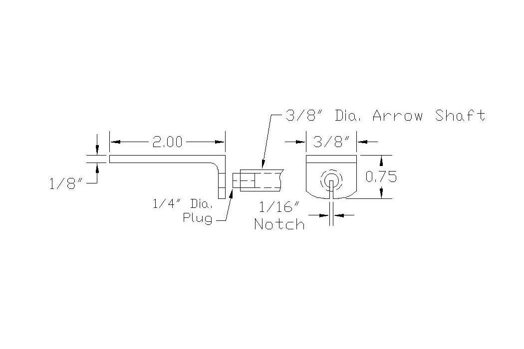

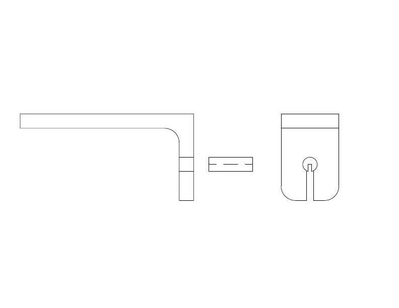

Yeah, the Dowel Thing is what I've been Pondering...I'm thinking of a Snug Fit, with a Notch for the Wires...Then Gluing it into the Hand Crafted HeadShell...Which would Also have a Notch, so that it could be Removed...
Like this...Really Fast ACad...

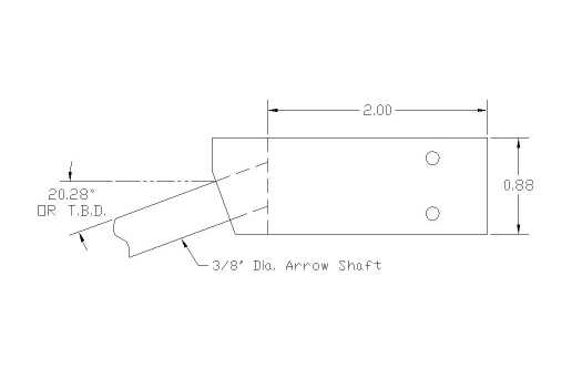

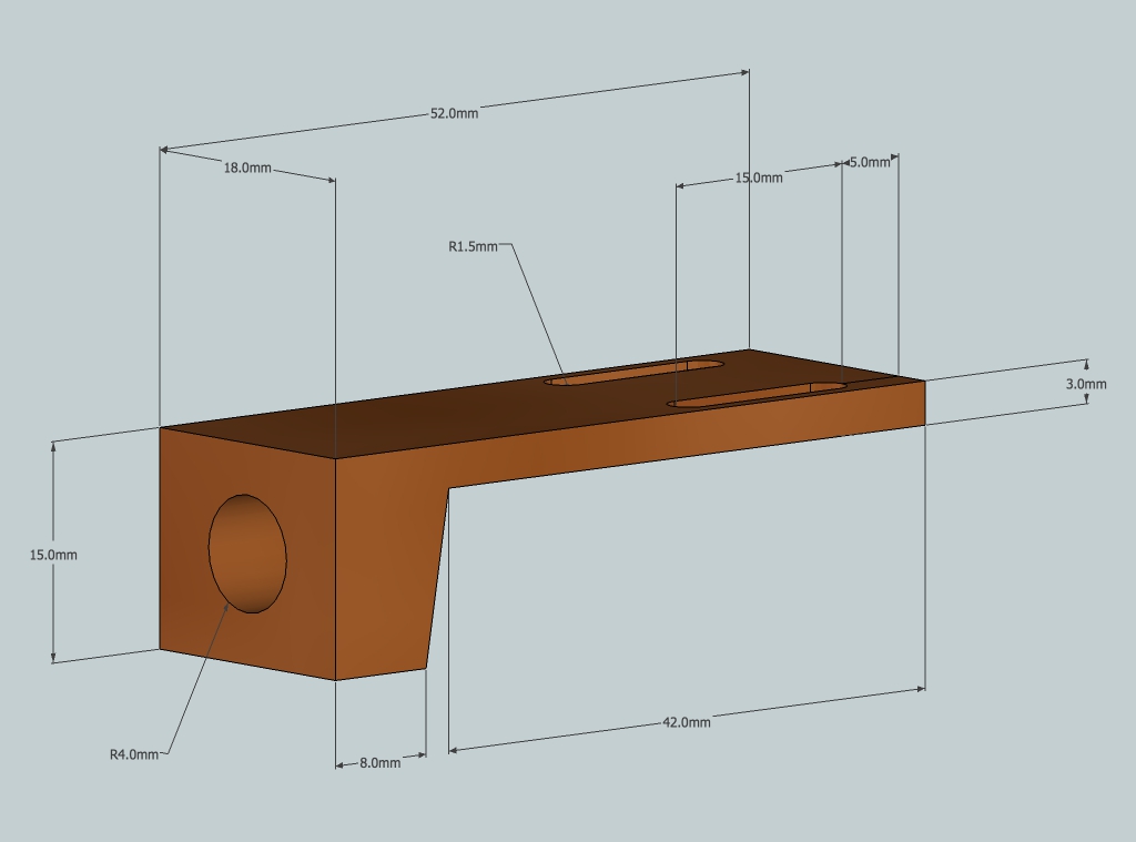

I modelled my headshell from one on an old Kenwood turntable. Almost any thing will do. Just remember that almost all headshells are made so that the mounting screws approximately 1/4" behind the stylus tip.
sled, I tried that, but if made correctly, there should be no need to use a dowel as you suggested (I tried it with varying degrees of success or lack there of).

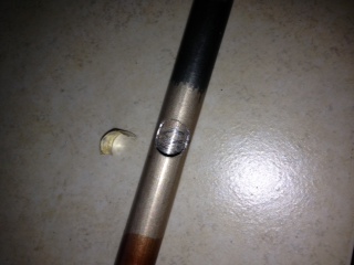

I've gone for what might be termed as the fancy one lol
It's actually the end cap from a fuse! As it happens to be made of brass & it's about the right size & shape. All I had to do was smash the glass & cut the cap with a stanly knife, so about two thirds of it was left, so it resembled a semi circle. Insert into arm tube with a drop of 5 min Epoxy. And a tiny center pop, Job done!

I did state earlier that I had used smaller cartridge mounting screws so that I could "twist" the cartridge body with respect to the headshell to get the correct O/S angle, and the cartridge mounting holes are also slotted. What's important is the ability to adjust the cartridge so that you may use the alignment gauge of your choice. The intent of this thread was to provide the basics to make a similar tonearm without providing a blow by blow constructional explanation.

Nanook 219 knockoff.
Ok hear we go, AT OC5 about 20 yrs old no idea what it sounded like when I stopped using it.
Litz silk covered wire kit with pins etc, £ 7.00

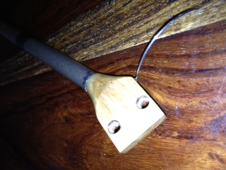

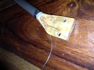

Bit of hand crafted cherry wood Head Shell, was nicer to make than I though it wood be.
Spring steel Finger lift, from old floppy drive.
5BA bolts, fit better than the normal metric ones, but nuts need making smaller in order to fit cartridge.
Arm tube is Eastman XX75 Aluminium arrow.
Female part of bearing is a Brass End cap from a glass fuse cut in half & epoxied into tube with Center pop to form F/ bearing, So very simple.
Male Bearing is a New metal ball point Pen refill had to bye 2 at £ 5.00.
base of pivot a bit of old compressor.
2x RCA Phono sockets £ 5.00 (still to purchase)
*£17.00 in total so considerably more than Nanook's !
