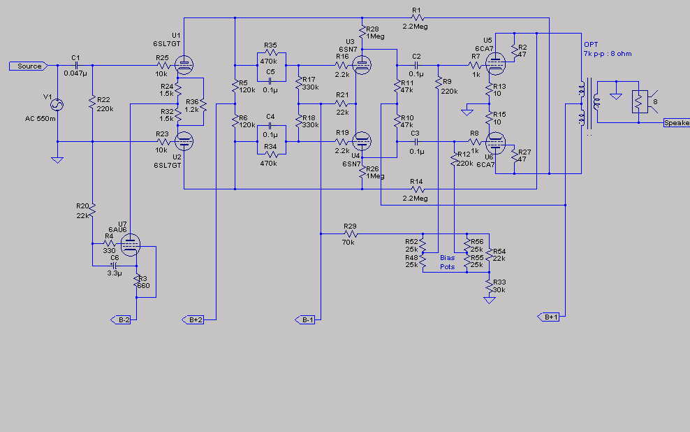

Here is my new born babe !

Ray_Moth, could you please check if feedback loops are right? I changed the values proposed by you.
No, padamiecki, I'm sorry, what you have drawn is not what I suggested.
Firstly, the ECC82 plates are connected through their load resistors to the plates of the EL34s. That's a well-known form of local feedback ("partial" feedback) across the EL34s but is unnecessary IMO because you already have cathode feedback both through the separate unbypassed EL34 cathode bias resistors, which you have retained, and also through the cathodes being connected to the OP secondary, the mid-point of which is grounded. You will not have enough B+ to get sufficient swing with the arrangement you have drawn.
Secondly, you have done the same thing with the plate loads of the ECC83 and that will give you positive feedback because it's not cross-coupled.
Rather than try to explain my ideas verbally any further, which is difficult and likely to be confusing, let me show you the circuit I use for my own amp. It's based on the same principles I am suggesting but uses a 6SL7 instead of your ECC83, a pentode CCS instead of SS, 6SN7 instead of ECC82 and triode-connected EL34s with fixed bias. Please see attached:

Just a few more comments:
6CA7 is the equivalent of EL34; I only used it in this schematic because it's a Spice simulation model (using LTSpice) and my model for that tube is called 6CA7.
I use a step network, instead of direct coupling, between the first and second stages, because it gives me easier operating points to work with and is less sensitive to imbalance between the two halves of the double triodes. It provides sufficient stability for the long cross-coupled feedback loop, which direct coupling would also do of course.

ray_moth said:
... let me show you the circuit I use for my own amp. It's based on the same principles I am suggesting but uses a 6SL7 instead of your ECC83, a pentode CCS instead of SS, 6SN7 instead of ECC82 and triode-connected EL34s with fixed bias. Please see attached:.
looks very promisive, I am sure that sounds perfect!
Why do you prefer 6SL7 instead ECC83 as voltage stage? Because of higher transconductance or linearity?
When I decided to build an EL34 amp, I decided to use all octal based tubes. This decision was based on the opinions of several people that 6SL7 and 6SN7 are more linear than ECC83 and ECC82.
anyway, if you would ommit C1, you will get only 1 capacitor in signal path, that would be cheaper and probably better sounding.
I'm sure you're right (although the difference would not be great) but, when I tried that, I found that my 6SL7s were not well balanced, leading to a DC offset which became quite large when amplified by the 6SN7. In addition, the voltage on the grids of the 6SN7 were too high. The step network avoids both of these problems.
Why do you use high-pass filters during coupling to the second stage?
That's not its purpose - you're referring to the step network, which I addressed above.

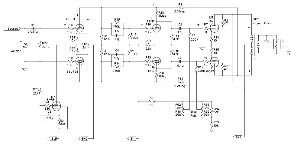

Dear Ray_Moth
after careful studying your circout I can see a positive feedback between second stage and output tube: (upper part) R1 - R28 - C2 - U5 - transformer - R1. Upper pin R28 meeth the same feedback signal in phase, like bottom pin R28...
Please see attached scan of signal feedback phases,
Why am I wrong?
