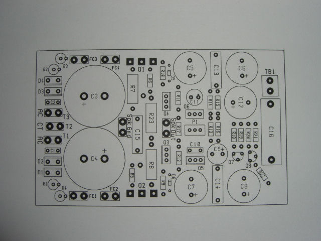

Here's a pic of two new prototypes boards on one heat sink. All I need now is to order some professionally made boards to complete my 8 channel home theater amp. Know I could place all of them in one enclosure, but that would make one heavy mother, so most likely I'll divide it into two 4 channel amps. For those that have expressed interest in some boards I'll be contacting you as soon as they arrive.
The amp in the pic is the same as the original boards, accept I added about 0.4" to the board length to accommodate for two more power supply caps. This way you can increase the capacitance to 10000uF per rail when using +/-50V rails.

hi AAK,
These are looking very good.
I like the idea of PSU to the left of the output transisitors and amp circuitry on the right.
How do you mount the output transisitors to the heatsink? Do you do it before soldering to the PCB or are there holes that I can't see?
Also, having separate PSU for hi quality audio is a good idea but are you going to have separate PSUs for all 8 channels?
I've seen lots of people mount amps like this on the heatsink. Is there any problems having the PCB so close to warm heatsinks? I imagine you are running them with relative low bias to keep things from getting too hot.
How many transformers are you going to use?

Hi Greg,
Thanks for the complements. There is no mounting holes on the PCB, the transistors are first mounted to the heatsink then soldered to the board.
<<Also, having separate PSU for hi quality audio is a good idea but are you going to have separate PSUs for all 8 channels?>>
Yep, 8 mono channels.
<<I've seen lots of people mount amps like this on the heatsink. Is there any problems having the PCB so close to warm heatsinks? I imagine you are running them with relative low bias to keep things from getting too hot.>>
No problems. The spacing between the board and the heatsink is 0.5". The bias is set to about 25ma.

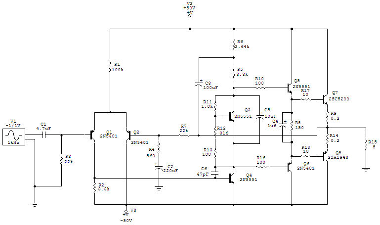

Interesting design you have. I have a couple quick questions:
1) Have you run this amp using lower rails? I have a 15-0-15 RMS 225VA, 20-0-20 RMS 225VA and 25-025 RMS 225VA toroid.
2) If one was to use lower rail voltage what, if any, changes in resistor values might be required? If there are changes required I have a preference to knowing the formula used to determine the value.
3) What ballpark rail loss does the design have? I am not as familar with BiPolar losses. I am not a amp expert, but so far I have learned there is about a 12V RMS drop from the Toroid rating.
4) If I understand correctly you feel the schematic from Post #2 sounds better than from Post #37. Correct?

Hi John,
15-0-15RMS is about +/-22V rails. The amp should work at these voltages, but it will involve changing some resistor values. I'll simulate it, then test it on an actual board, and get back to you. I figure sometime next week.
I measured about 8V RMS drop.
I've not compared the two amps, but when I do I'll post the results.

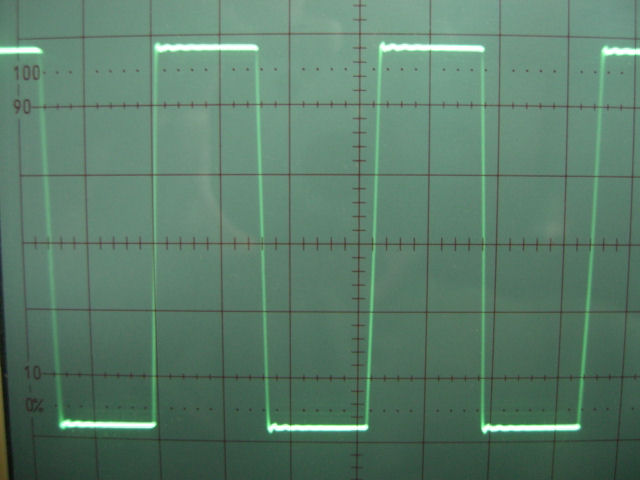

Here are some THD measurements of the 100 watt version.
Into 8ohm @ 1khz
50 watts: THD = 0.008%
100 watts: THD = 0.01%
Into 4 ohms @ 1khz
150 watts: THD = 0.017%
Here's a pic of a square wave into 8||4.7uF at 10Vrms @ 10khz without
using an R||L on the ouput.
