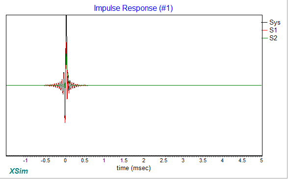

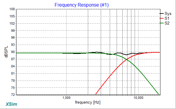

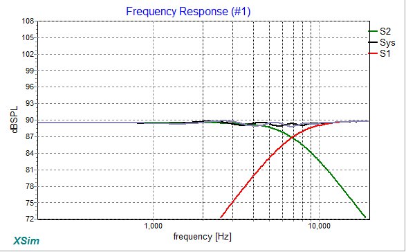

To illustrate the above:
1) APC crossover @ 7kHz (2nd order L-R), with aligned acoustic centres:
http://www.diyaudio.com/forums/attachment.php?attachmentid=487574&stc=1&d=1433886759
and the corresponding impulse response on axis:
http://www.diyaudio.com/forums/attachment.php?attachmentid=487575&stc=1&d=1433886759
So far, so good.

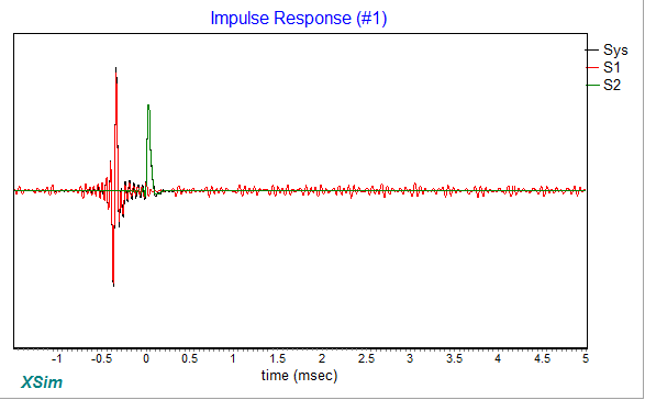

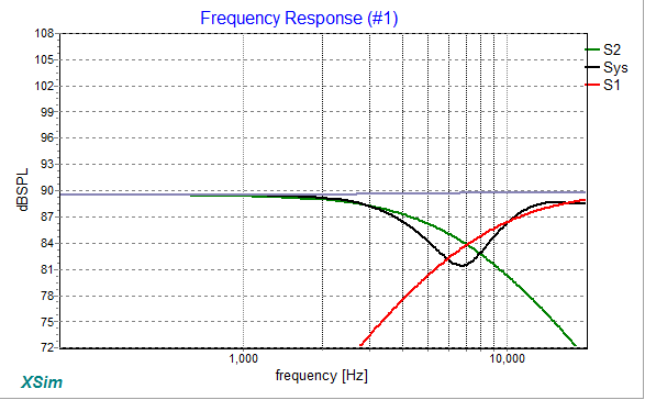

But let's see what happens when slightly off-axis, so as to introduce 1 inch of mis-alignment:
http://www.diyaudio.com/forums/attachment.php?attachmentid=487576&stc=1&d=1433886759
Ugh!

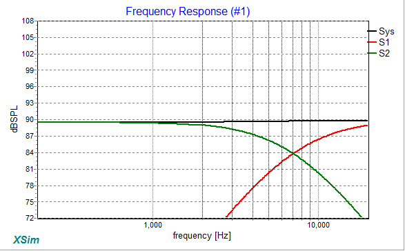

2) CPC crossover @ 7kHz (2nd order Butterworth), intentionally grossly mis-aligned (5 inches):
http://www.diyaudio.com/forums/attachment.php?attachmentid=487577&stc=1&d=1433886759
(system response 1/3 octave smoothed to better approximate human hearing response, which is insensitive to narrow "comb filter" notches at high frequencies)
The corresponding impulse response shows the two peaks indicative of the mis-alignment:
http://www.diyaudio.com/forums/attachment.php?attachmentid=487578&stc=1&d=1433886759
But, let's see what happens when slightly off-axis, so as to introduce 1 additional inch of mis-alignment:
http://www.diyaudio.com/forums/attachment.php?attachmentid=487579&stc=1&d=1433886759
The response remains essentially unchanged.
Hence my doubt: is it better to optimize the frequency and impulse response on axis, and just live with the relatively major response aberration that is produced when even slightly off axis (1), or to accept a bad time alignment of the impulses, but at the same time ensure a more consistent (and essentially flat) frequency response both on- and off-axis (2)?
