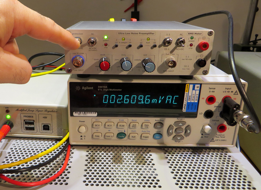

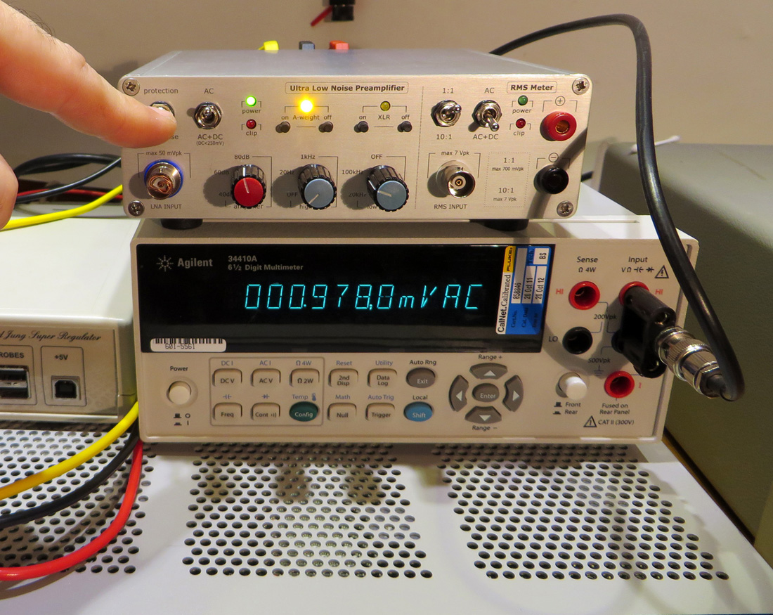

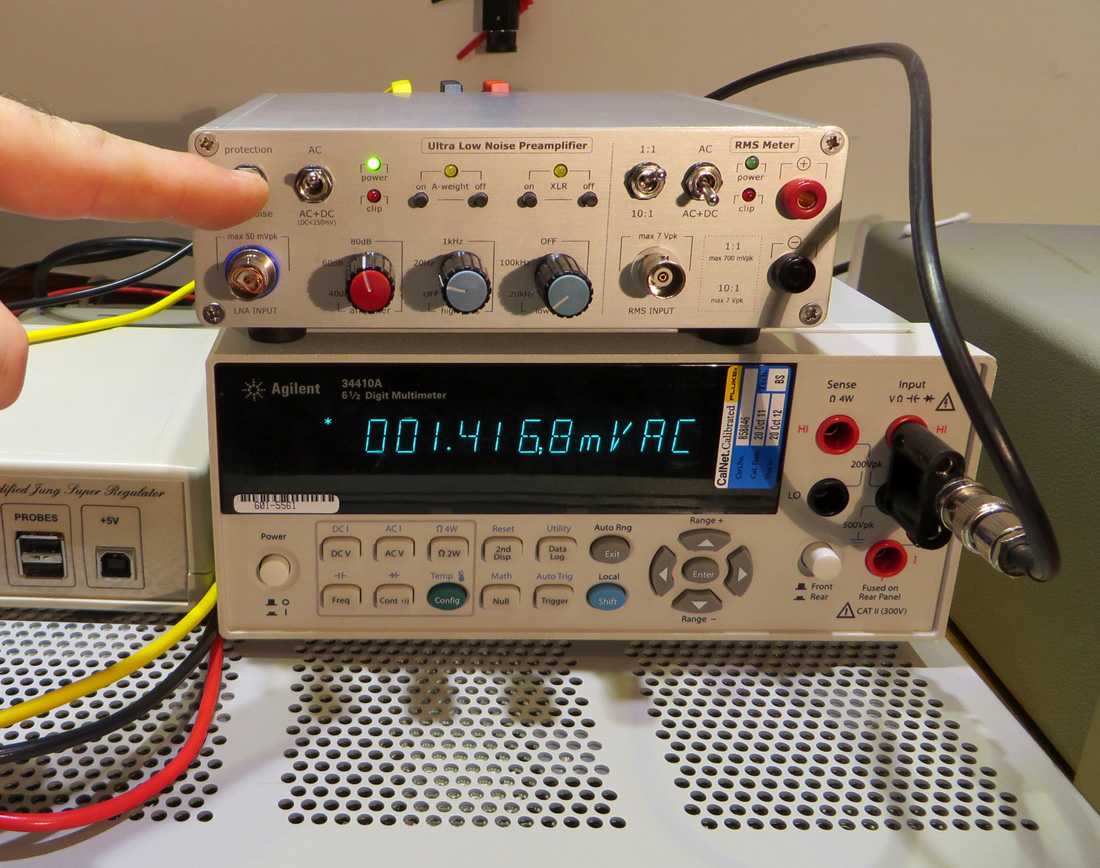

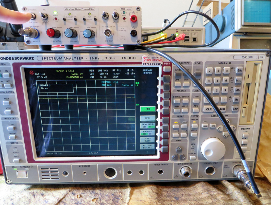

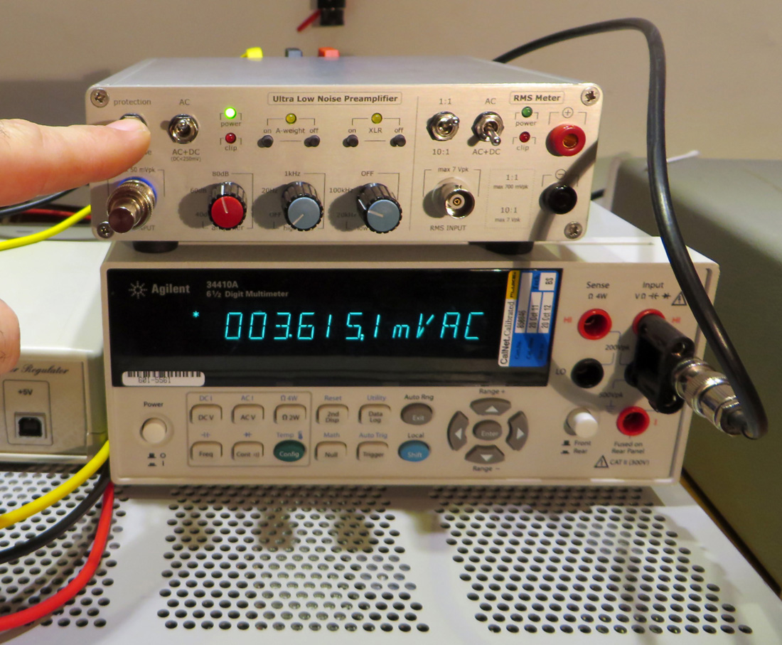

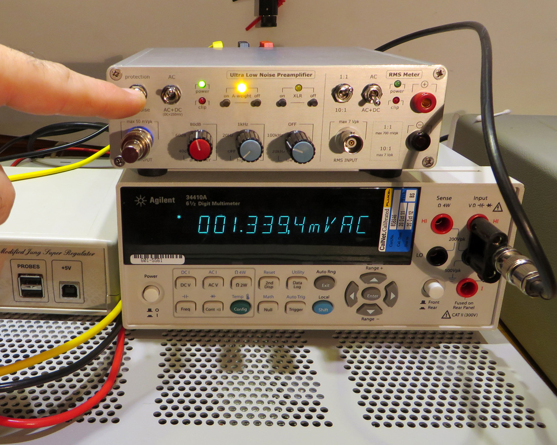

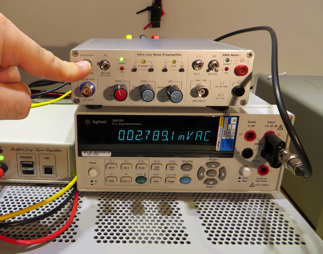

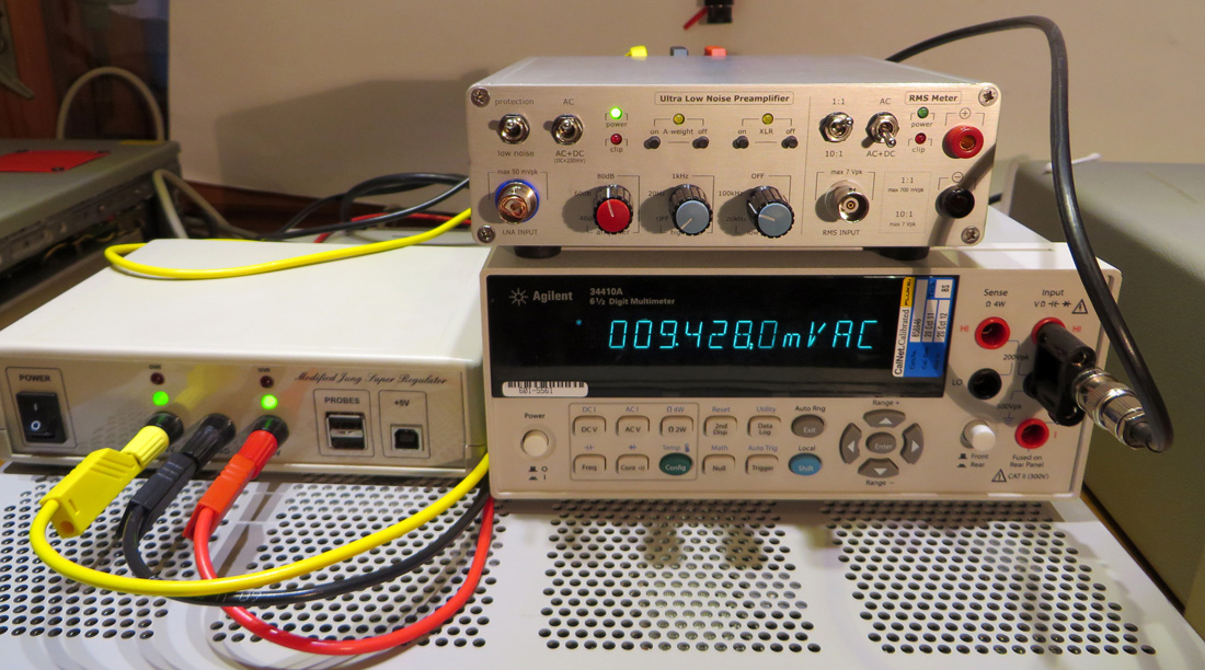

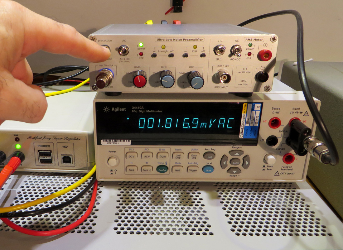

LNA noise measurement with Agilent 34410A:

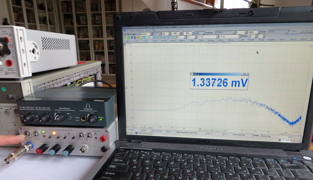

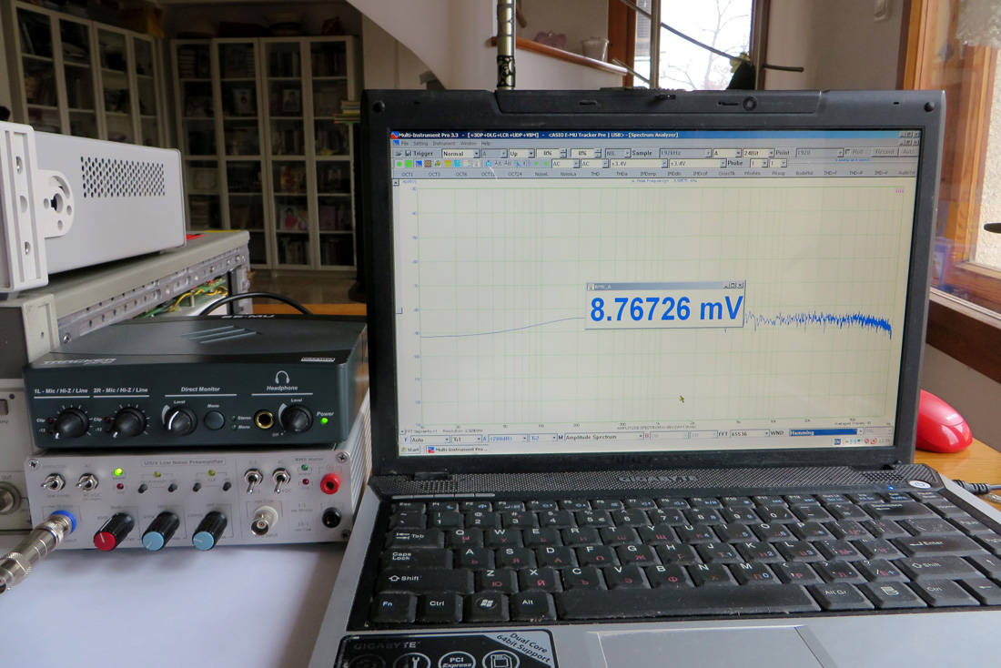

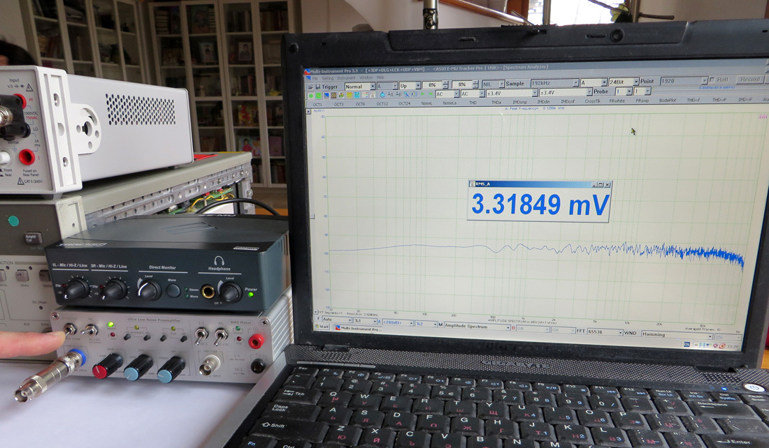

LNA noise measurement with Multi-Instruments
Some measurements with Multi-Instruments of Virtins and Emu-tracker PRE (ASIO). The initial calibration is made with an external generator (HP3325B) and Agilent 34410A (TrueRMS). Metering is done in the following settings: Sample 192kHz, 24bits, FFT 65536, Average 10. The vertical scale is in dBV. Received lower values for RMS: 332nVrms (50ohms input, 0-100kHz). I do not accept them many correct. I believe much more of measurements with 34410A for different frequency bands. I have photographed noise at protected input to see the noise of the 499 ohm input serial resistor.

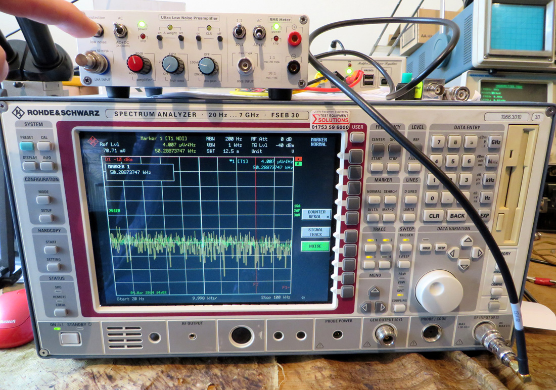

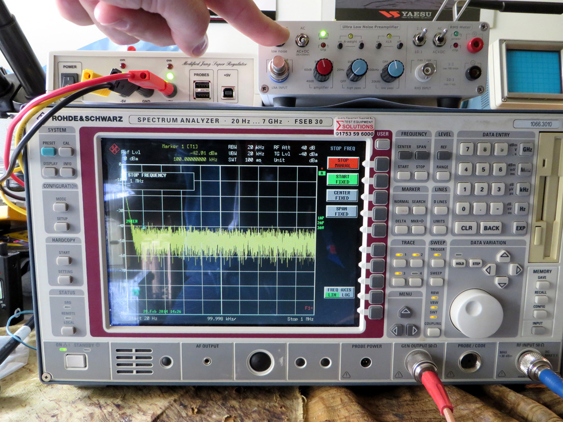

LNA measurement with Spectrum Alalyzer
Here are some measurements with a spectrum analyzer, which I did with friend. I do not know how far are correct b.p. that is my first work with Analyzer, a miracle and I do not know if they need any calibrations or normalization before measurement . The results are similar (slightly reduced ) . Analyzer has a built- RMS detector, which measures directly RMS at specified bandwidth . The result at RBW 100kHz is RMS average = 1.816mV. Since the output of the LNA have 50 ohm series resistor and it along with 50 ohm input of analyzer formed divider of 2. Therefore the real value of output of the preamplifier is 3.632mVrms. Referred to input at 80dB gain : 363nVrms.
When measuring the Noise Power Density I get 4.007μV / √ Hz. Multiplied by 2 for the output divider: 8.014μV / √ Hz. This referred to the input and 100kHz bandwidth: 270nVrms. For me there is something not very correctly. Value is lowered. And I do not know where exactly this bandwidth of 100kHz, where the measurement becomes.
I could not measured the frequency response at low frequencies. This analyzer want any special settings and calibrations in a mixers and tracking generator to run correctly under 3kHz. All I can do to make it work from 100Hz on. The tracking generator level is -74dBm (6 dB lower) for divider 2 at the LNA output and analyzer Input. At the input LNA I have a 50 ohm feed through terminator.

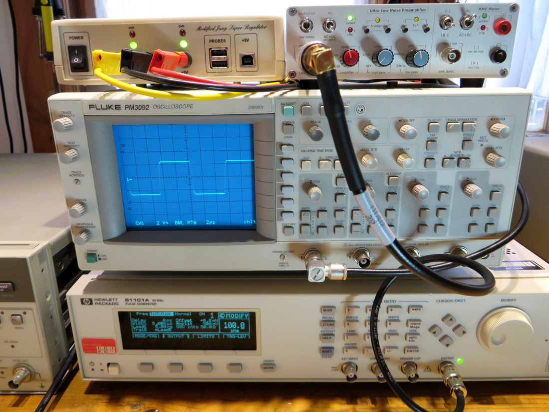

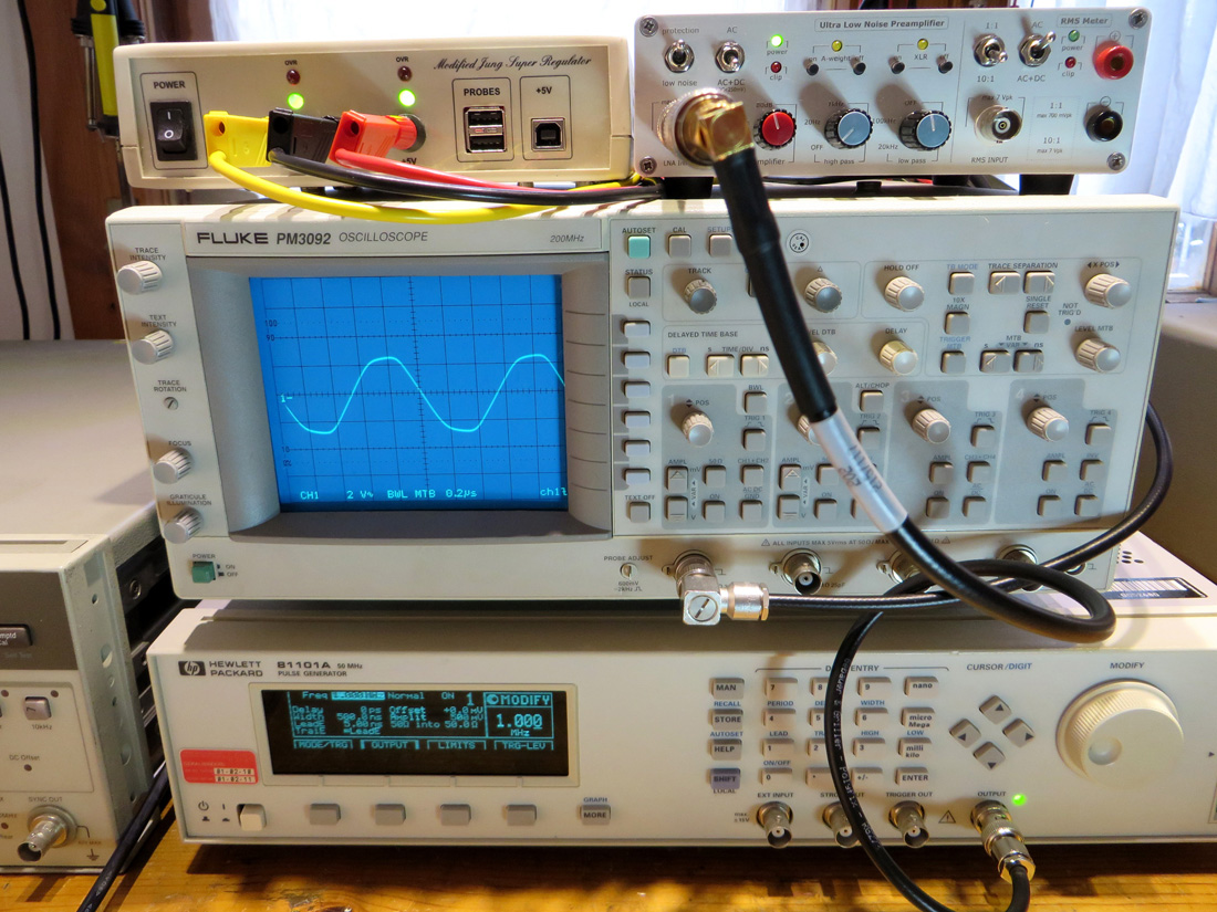

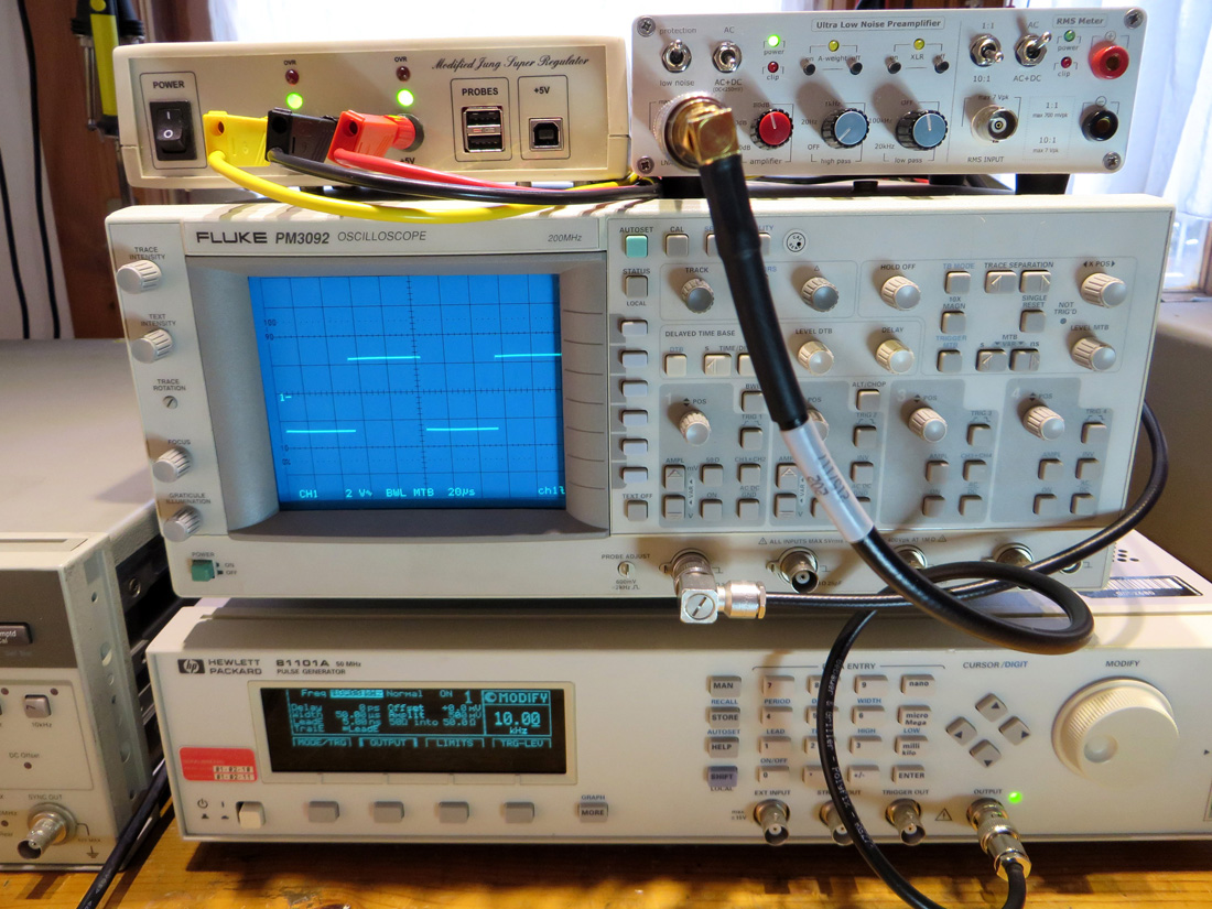

STEP RESPONSE at: 10kHz, 100kHz, 500kHz, 1MHz
At the input of LNA I put 500mVpp signal from generator reduced by attenuators 1,000 times. This signal is amplified 80dB (10000 times), and is supplied to the oscilloscope. Not exactly 1000 because of the accumulated error of the three attenuator and 50 ohm terminator. But this is not important, because examine only the waveform.

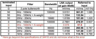

There is something wrong in this.Here are some measurements with a spectrum analyzer, which I did with friend. I do not know how far are correct b.p. that is my first work with Analyzer, a miracle and I do not know if they need any calibrations or normalization before measurement . The results are similar (slightly reduced ) . Analyzer has a built- RMS detector, which measures directly RMS at specified bandwidth . The result at RBW 100kHz is RMS average = 1.816mV. Since the output of the LNA have 50 ohm series resistor and it along with 50 ohm input of analyzer formed divider of 2. Therefore the real value of output of the preamplifier is 3.632mVrms. Referred to input at 80dB gain : 363nVrms.
When measuring the Noise Power Density I get 4.007μV / √ Hz. Multiplied by 2 for the output divider: 8.014μV / √ Hz. This referred to the input and 100kHz bandwidth: 270nVrms. For me there is something not very correctly. Value is lowered. And I do not know where exactly this bandwidth of 100kHz, where the measurement becomes..
Are you getting nV and uV mixed up?
The first paragraph going from 1.816mVac to 363nVac looks right.
The second paragraph seems wrong.
Calculated using this formula:
Analog Devices | Spectral Noise Density to RMS Noise
Vrms = EnV (sqrt / Hz) *SQRT (bandwitch*1.11)
(1.11 for butterworth)
Vrms(nV) = 8014(nV) *SQRT(100000*1.11) = 2669997
That is Output. Referred to input: 2669997/10000 = 267nVrms
However to me also seems unrealistic value (too low). This I wrote in the previous post.
regards
Ivan
regards
Ivan
What is the actual output noise voltage that you measured?Calculated using this formula:
regards
Ivan
With which device?
Output voltage is 3.6151 mVrms.
Referred to input (80dB gain) : 361.51nVrms (Agilent 34410A, 0-100kHz, gain 80dB, 50ohms in Input)
Look at the table (measurements.jpg) and other photos.
AndewT. Do the photos opened in full size? I see thumb only.
Is that the 1.11 you are using?
I expected a correction of around 1.6
1.57 1-pole
1.11 2-pole butterworth
1.05 3-pole butterworth
1.00 Brick Wall
