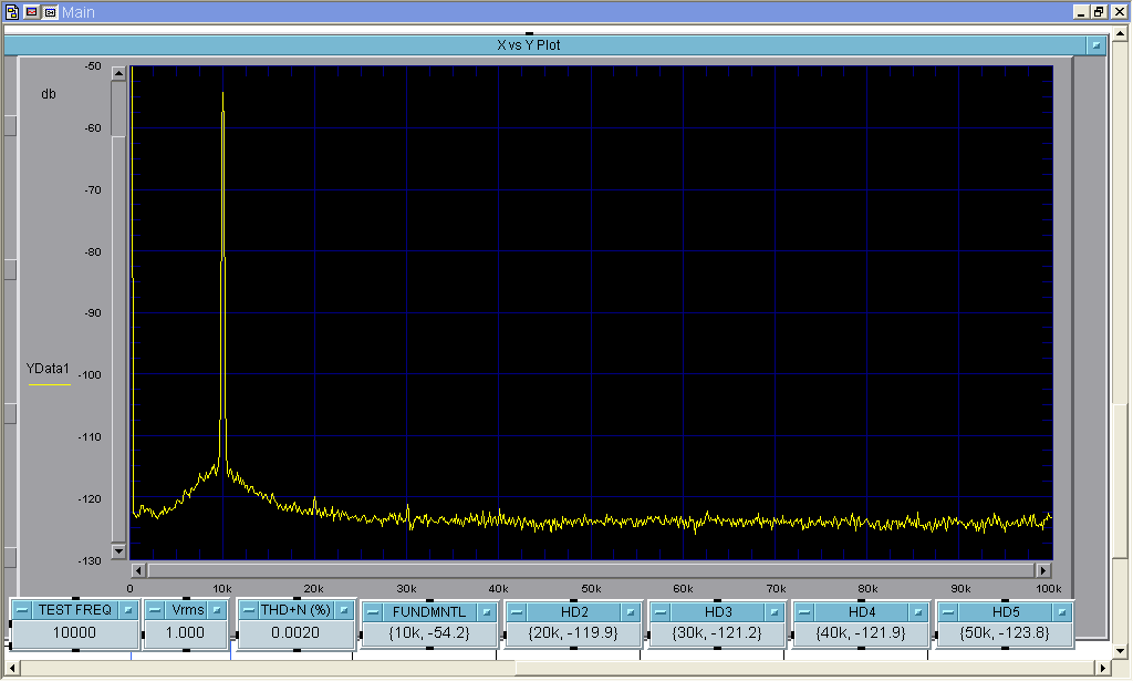

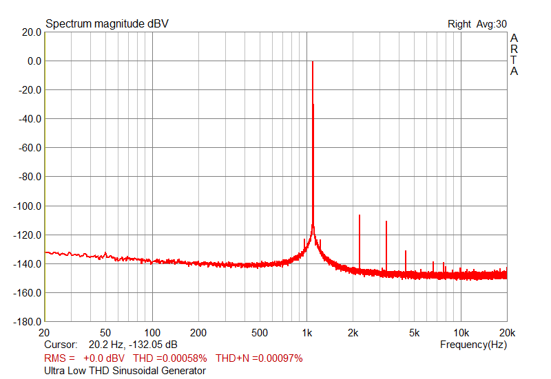

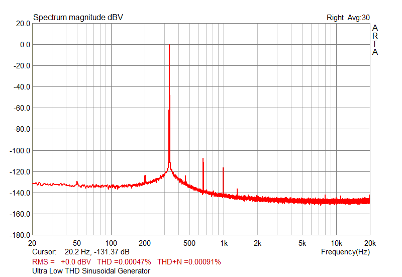

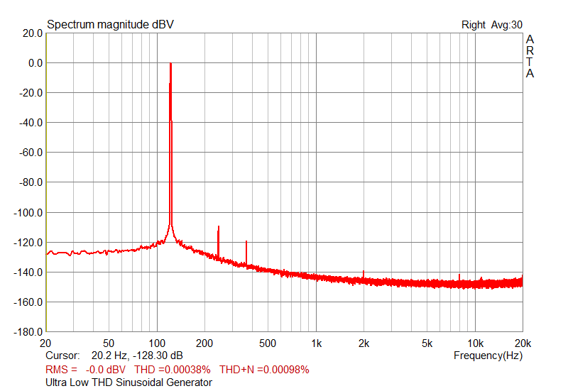

Hi Bob: been there, done that 🙂. I've been playing with SVF generators and my EMU 0202 for about a couple of years: tried almost every kind of peak detector (1/2/4 phase; sin^2+cos^2 via a multiplier; T&H+S&H scheme a-la HP, Boonton, AP...) and gain controlling element (LDR, FET, analog multiplier, OTA). These spectra refer to one of my last prototypes (well, it's still a prototype after 1 year...) viewed thru ARTA+EMU 0202:
and this last one is acquired thru a SVF notch with auto-nulling (post notch gain: 40 dB):
THD @ 1kHz, 3Vrms out seems to be somewhat lower than 0.0001% (or -120 dBc - notch input level is scaled down to 1 Vrms), while ARTA says it's more than an order of magnitude higher - I'm likely looking at the EMU's intrinsic THD, which falls in the 0.0005-0.0003% range below 1 kHz - EMU says: THD+N (1kHz at - 1dBFS, min gain): -103dB (.0007%).
The SVF generator is based on a T&H-S&H peak detector and uses an OTA (LM13700) as level controlling element; output level is stable within +/- 0.1dB from 50Hz to 110kHz, settling time at startup is about 5 secs @50Hz (too high, imho), and almost instantaneous above a few hundreds Hz (say 300 Hz). Though this prototype is almost 1 year old it's still in an early stage of development, and needs to be optimized in almost every respect: I'm not fully satisfied both with the OTA (planning to use a FET-based multiplier) and the level controlling loop; ripple from the peak detector is somewhat too high, which means that THD (and THD+N...) can be lowered a bit. Well, it's a long and winding road, you know, and I'm a little bit short of spare time to work on it - nevertheless, it rocks 🙂 : the T&H-S&H peak detector is probably the best choice if you are looking for low THD, continuous coverage and fast settling. Surely you can manage to obtain even lower THD levels with a standard peak detector (maybe a 4-phase) at the expense of slower settling and trickier range switching...
