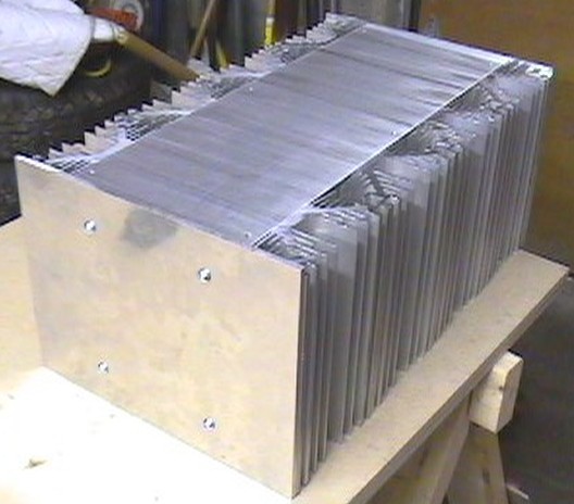

François said:Transistor assembly is like this

Believe me, the heat transfer between the device and the heatsink is not the problem. All the chassis is hot after a few hours. The problem is the surface exposed to the ambiant air. I need bigger heat sink with more fins.

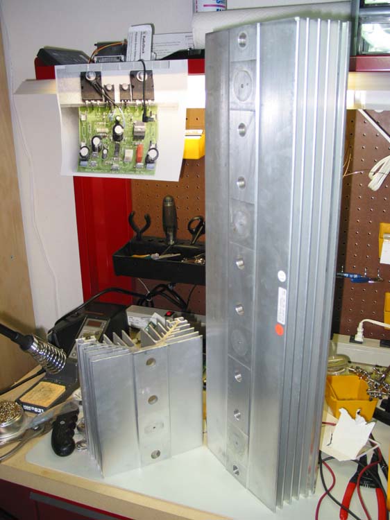

Heat Dissipation ?
Please comment on the possible heatsinking problems shown in the photo. Somehow I don't like the idea of extending the transistors off from the PCB (makes like an antenna) so I have thought of mounting them on to a common bottom plate chassis where the heatsinks are attached to.
Where i've placed a circle in the diagram, would this be a concern of how much heat dissipation will transfer to the heatsinks from the bottom plate? Of course the heatsinks will have the silly white heat transfer compound.

IMHO , the chip temperature will be way too high , expecially if your bias intention is 2 amps.
