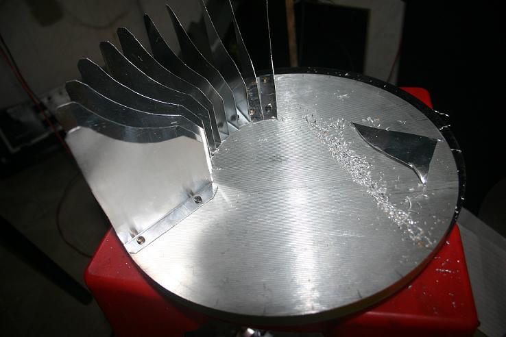

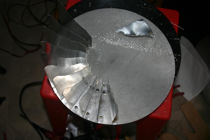

i am now on the construction of the heat sink. it is as i told you.
it is now i am making. hulf of the way i took picture let you know how i am making. center will be quiet type mid speed fan. i have nothing so special tools available. only dril and scru driver....pencil and calculator. today probably will be finsh.
all metals are aluminium.
metal of the plate = solid aluminium
diameter of the plate = 12inch
plate thickness = 10mm
fins thickness = 0.3mm
fins height = 4 inch
fins length = 3.5inch
what do you think about heat disipraion? how many watts can put on it?

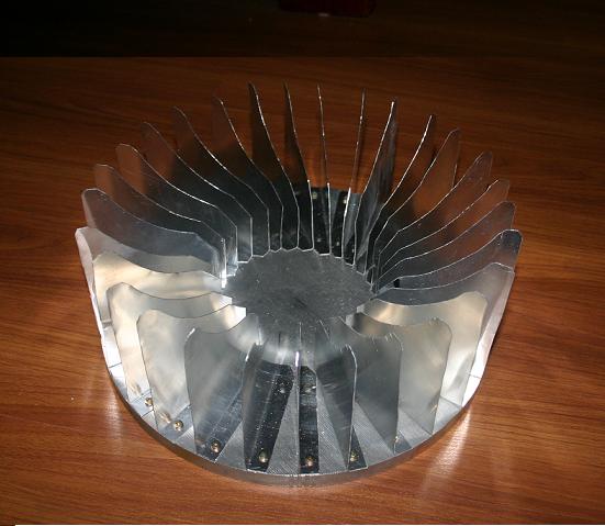

It's not looking bad, the efficiency of those fins may be less than you might like if they're not extremely well coupled to the base. It might be worth trying to find some transparent PTC and putting a thin layer between them and the base. If the metal the fins is made out of is thin, you can also improve how well it clamps down to the base by adding a thicker strip of something like steel between the screw heads and the top of the folded bit on the fin - so it spreads the squeezing out more.

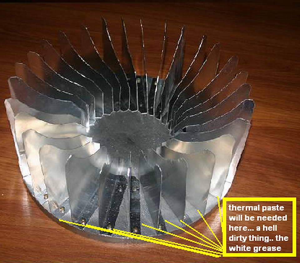

just finished the heat sink construction
hi,
just finished the heat sink. yes i will put some tharmal grses under those fins to have proper contact. here is the finsihed pic...but still there are more to be done now.

Very nice Flying Sauce heatsink.... a nice UFO (unindentified flying object)....hehehe.... i like that.

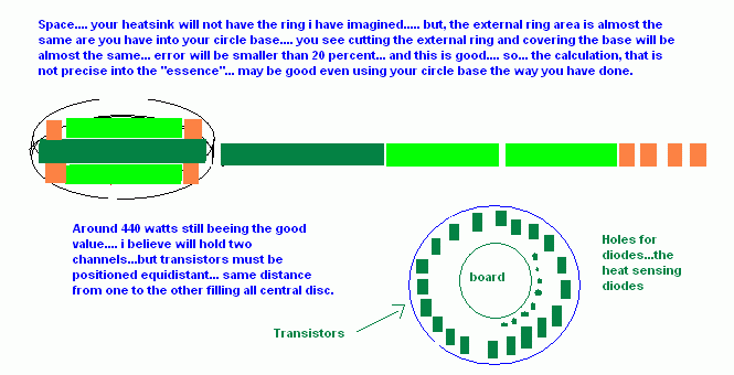

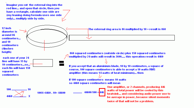

The power, in my experience, will be 446 watts.... or ... a 446 watts rms amplifier (or amplifiers), producing around 650 watts of heat, will be "controled" by your flying sauce heatsink.
How to calculate.... i have learned that observing what is good for a 10 watts power amplifier, a RMS clean power, sinusoidal power, undistorted, continuous ..... i have found an aluminium square of 10 centimeters side and 2 to 3 milimeters thick would work fine..... so..... based on that....... it is just a very easy calculation.
If 100 square centimeters can hold 10 watts amplifier... then..... XXXX square centimeters will hold (W)

Without that dam dirty thermal paste you will not have good results
Clean the thermal paste excess using cotton swab, clotch with petrol diluting material, alike gasoline, thinner, Kerozene, or paint remover.
