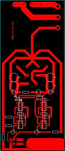

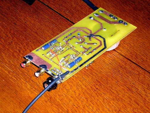

Here are some pictures of yesterday's project, a headphone amp I designed around the popular OPA627 and BUF634 from BB.
Note I could not find my box of metal films so the carbon films I had lying around had to do. Yes, I know for audiophile devices they are not prefered but I can't really tell much of a difference audibly anyway. :)
Sounds really good, good rail filtering and lack of ground loops = no audible noise at all even though I am not using regulated supplies.
All caps are misc Panasonic FC electrolytics and 0.1uF 1206 SMT for decoupling. The OPA are in sockets so I can swap between OPA134 and OPA627 to see the difference in sound quality.
Rails are +/- 15V.
