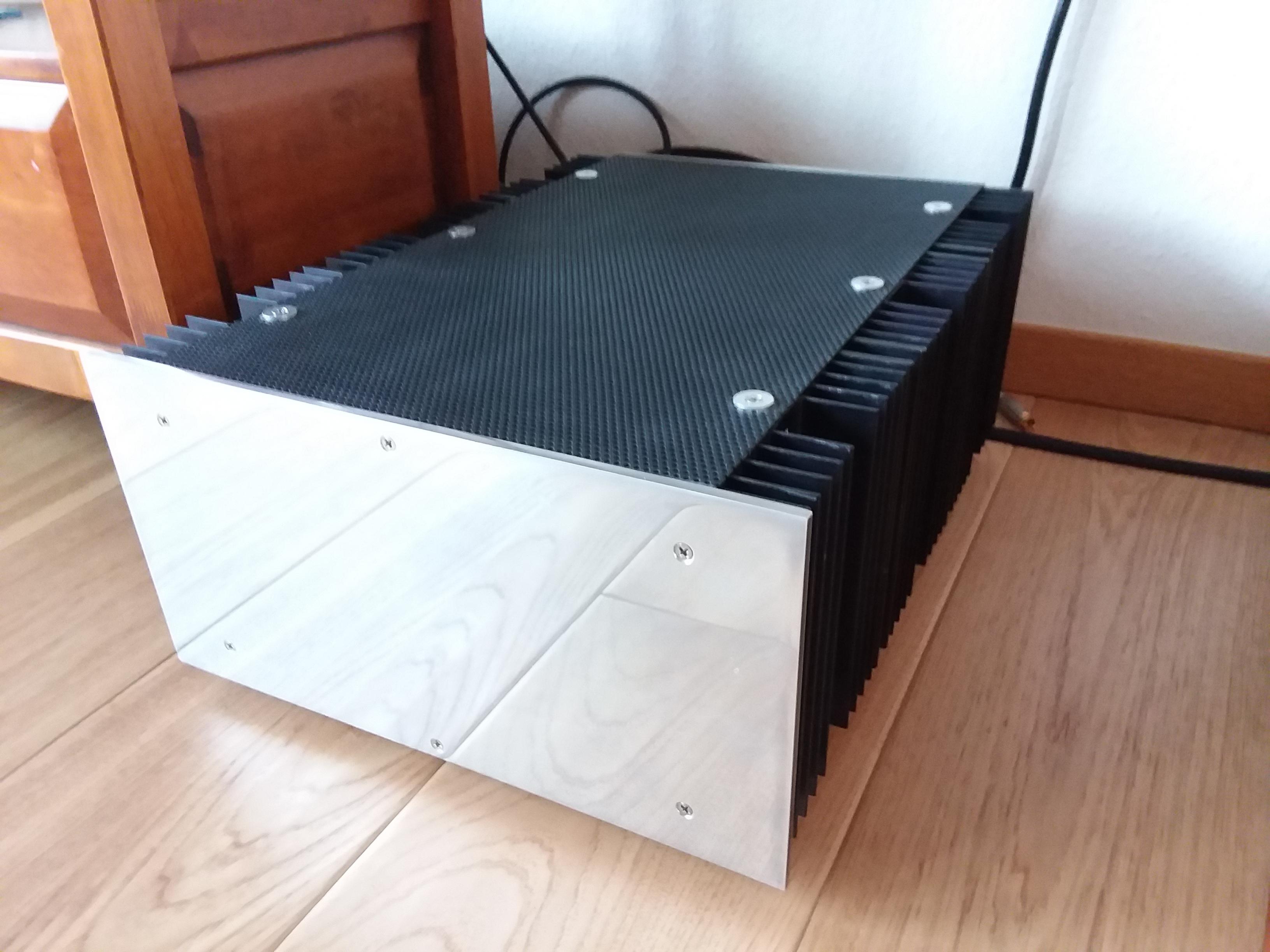

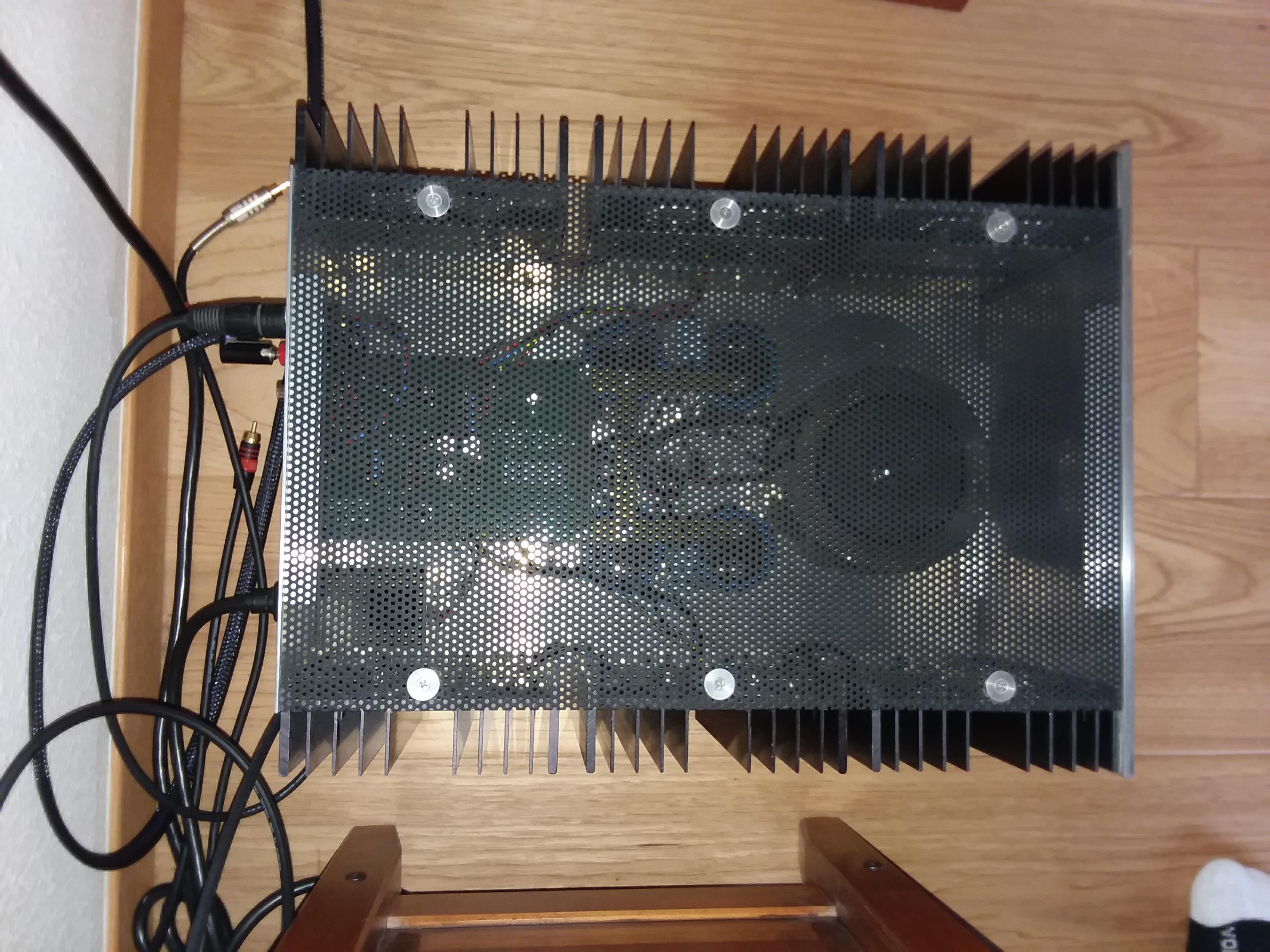

Dug out the old Aleph Mono block amps after years of sitting idol. They are 20+ years old now. :rolleyes: :geezer: Dusted it off inside and out. Put power to it through my variac and everything still works, Offset less than 25mV. Still sounds very good, even after all the other "better" amps.
500 VA Transformers, 32 volt rails, 6 output devices/rail, 12 total each Mono block, 2.5 amps bias/rail. Even still has the IRF 9610 input Mosfets.
Single ended, high bias, balanced input, lots of heat, very heavy. What's not to like about DIY audio building.

Well, these are quite convincing pieces.
But, can you use these as a welding machine? ;)
The heat sinks I found at a surplus electronics store and bought all they had. The first batch went to an A75 build then the Alephs then F3's.
At the time the Aleph's were built I had Mid-Tweeter-Mid Scan-speak loud speakers, so a fairly low impedance load.
Fast forward 20 years and my loudspeakers are backloaded Sonido drivers with an easy load for amplifiers.
No need for welding! Maybe light dimmers?

Hmm... are you willing to sell that amp?

That amplifier looks horrendous, terrible, incredibly old... are you sure you don't want to sell it?
